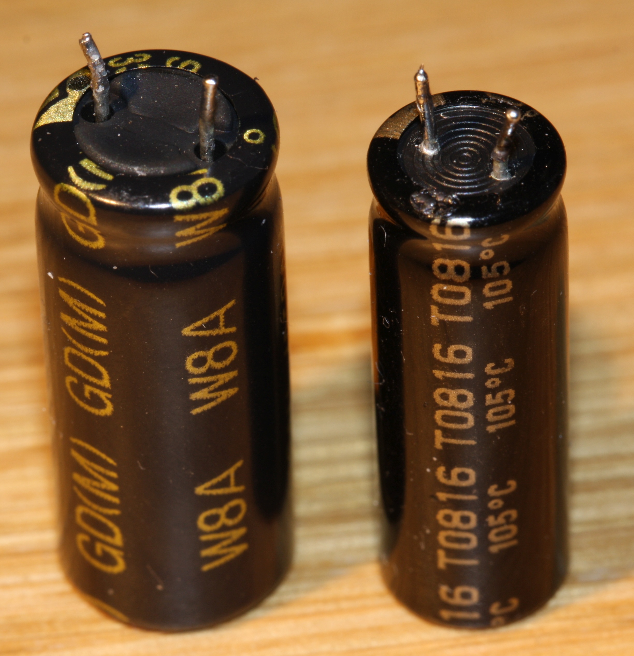

              I never replaced the original Samxon GD 3300uF cap or the Rubycon MCZ 820uF cap next to it by the memory and it's still working fine like this over 7 years later.
              System is still in use 24/7 as my firewall with only a tiny silent fan on the chipset heatsink.
              Originally posted by linuxguru
              I should add that the 820uF/6.3V MCZ pulled from the near the DIMM slot looks fake - the bottom bung is the one with concentric circles, which I've never seen on an authentic Rubycon on ammo tape or bag before; and the ESR measures about 40 mohm, which seems to be a bit high, but that's after 6 years of intermittent use. OTOH, the 3300uF/6.3V Samxon GD seems to be within spec at 10 mohm.
              Did Intel China knowingly use fake Rubycons, or did they also get conned by a flaky vendor? Or alternatively, did Rubycon outsource production of (some) MCZs to a volume OEM producer in China?
              Well, curiosity killed the cat!
              I just could not have this board sitting on my desk infront of me each day without checking how the remaining caps looked
              And it's just like linuxguru says, the 6.3v 820uF Rubycon MCZ at the edge of the board by the memory has a cheap bung with concentric circles on mine too!
              And the 6.3v 3300uF Samxon GD cap next to it looks weird too, the bung looks collapsed inwards, never seen anything like it before!
              My guess is that these are fakes that entered the supply chain, probably Intel was shooting for a very low price point so allot of corners had to be cut.
              I replaced the Rubycon with a Samxon ULR 2.5v 820uF polymer. (It just sees VDIMM so 1.9v so it's fine).
              The Samxon cap sees 5v though and I did not have a suitable polymer in stock so I took one of my ancient Rubycon MBZ's and reformed it and then soldered it in the Samxon's place.
              I also replaced the 5x 10v 470uF Nichicon VR 85°C caps with Panasonic NHG 16v 470uF 105°C caps, the one by the southbridge was starting to go bad due to the heat.
              I also replaced the 2x 25v 22uF Samxon GS 85°C caps with UCC KMG 50v 22uF 105°C caps, the one by the onboard NIC had been well baked and was significantly out of spec!
              Finally for good measure I replaced the 5x 25v 100uF Samxon GS 85°C caps by the audio controller with UCC KMG 16v 100uF caps, they all measured perfect though.
              Since I don't use the onboard audio and the caps are not in a hotzone they survived, I measured 2.5v on four of the caps and 5v on one.
              Obviously the voltage will go up with increasing volume but since I don't care about the onboard audio it will be fine like this anyway

                  #48
                  Re: Intel D945GCLF Bloated Samxon GC due to overheating
                  Originally posted by Wester547
                  I'm beginning to wonder if certain manufacturers were too cheap to buy Rubycons with a thicker bung so they specified a cheaper, flat bung (though why Rubycon would use that el cheapo concentric bung is well beyond me - the residue on it is proof enough that it causes more problems than not).
                  Just seems strange that Rubycon would agree to that, it's their reputation on the line after all...
                  That Rubycon is a custom order, which tend to be more expensive, so that could be part of it. Rubycons tend to be comparatively expensive anyway.
                  Which begs the question: why put a Rubycon on a board if you are cost constrained?
                  Why not one of the cheaper first tier brands or even second tier brands...
                  It also looks like the bottom of the sleeve sustained some damage.
                  That was me during desoldering, as linuxguru mentioned it was a quite difficult cap to desolder...
                  Seems to me that they just didn't use as thick a stand-off for the rubber so the bung has a flatter appearance.
                  Yea maybe, I attached another photo with the old caps standing next to two new unused caps.
                  There it's more clear to see how much the bung is collapsed inwards on the Samxon.
                  It's also striking how similar the print is on the old Samxon and Rubycon caps!

                      the fake rubycon has a slip of the maker,
                      rubycon uses a coma "," for sub voltages - 6,3v
                      the others all use a stop "." - 6.3v
                      also the relative height of the "v"

                          #52
                          Really good catch STJ!
                          I'm just more and more convinced that the whole lot of caps on this board are counterfeit.
                          Too many odd things with the caps are wrong...
                          Just did a Google image search which brought up some old posts with similar looking caps:
                          https://www.badcaps.net/forum/showthread.php?t=14198
                          https://www.badcaps.net/forum/showth...412#post101412
                          The print on the Rubycon MCZ and Samxon GD isn't as clear as the print on the Rubycon MBZ, that's for sure
                          Compare the print of the known genuine Samxon GD with the one found on the Intel board.
                          The one on the Intel board has more shitty quality of the print, and the edge of the stripe is jagged.
                          Now compare the known genuine Rubycon with the other one, coincidence I think not!
