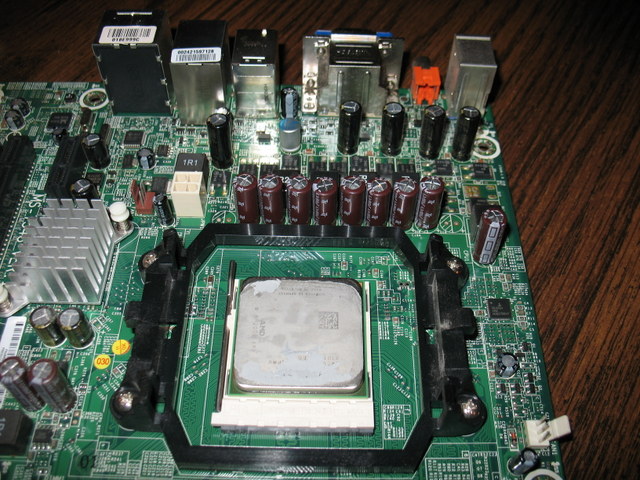

                                  Howdy, I have one of these HP machines with the MS-7548 boards in it and I replaced all the cps in it. Everything seems to work but I think maybe my CPU is shot because I don't get anything out of the video. I even bought a Faster video card for it and still no video. The computer was given to me for junk, but if I can repair it it would be a very nice machine once all the bugs were fixed! Come on an icore 4! Heck yeah! Great gamer computer! The least expensive CPU I could find was $135.00 and that's a lot of money if it doesn't work even after I replaced it. I replaced all the caps on the board after reading this site, the caps should not be a problem now. I only found two caps blown closest to the CPU but again I replaced all the caps all over the board. Is it possible that this thing could have blown the memory and or the Video chip? If so, then I'll have to replace the board altogether. I'm just guessing here and don't really know what's going on with it now. When it was working, it was a great system, I even had to clean out all the junk files and remove some trojans for the lady that originally owned it. After it stopped working she bought another one and gave me this one. It's only about three years old or so maybe 4 years old and the replacement boards are extremely hard to find except from Sever.com. I could still have a bad CPU and or bad Memory sticks. Any thoughts? Help? Thank you
                                    #57
                                    Re: MS-7548 Failed TK Caps
                                    What seems to be working? Is the CPU fan spinning? Does it stay on, or cut out after a second? Are you getting any beeps when it powers on? Have you tried a different VGA cord and monitor?
                                    You can pick up a used AM2 CPU on eBay for around $15-20 to test it. Wouldn't hurt to have one on hand for testing purposes in the future anyway. It's pretty rare for a CPU to fail though.
                                    What type of caps did you use as replacements? Have you double-checked to make sure none of them are in backwards (i.e. reversed polarity)? You can compare your board to the pics at the beginning of this thread to make sure the stripe on the cap is facing the right way. Also make sure you didn't miss any spots that are supposed to be populated.
                                    Sure, it's possible, but unlikely. This board doesn't use an nVidia chipset, and those are the ones that seem to be more prone to failing on AM2 boards. If there was a problem with the RAM, you'd probably get some POST beeps. Try installing only one stick of RAM, and swap it to each slot. I recently fixed one of these boards, and there were some failed MOSFETs on it. If I remember correctly, I think a couple were by the RAM. Let me look into it and I'll see if I can give you a pointer there.
                                    If all else fails, there is a board on eBay right now. It's only got one bid, but a lot of time left. Not my listing, just trying to help.
                                    http://www.ebay.com/itm/HP-Desktop-M...item416e606c91

                                          Great Success! Well, it has been a YEAR since I originally sought guidance on here regarding failed Vcore TK caps on an MS-7548. I originally quoted a few weeks turn around, HAHA, life got in the way!
                                          Anyways, I finally got around to the task and brought new life to the MB. The TKs looked like mazade's pics on page 1 of this thread. I replaced them with Nichicon's I bought thru this site.
                                          Thank you all for the help!
