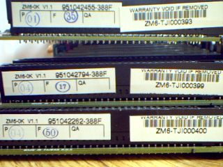

    This boards can handle only celeron cpus (66,100) FSB
    max as of final bios "SU" celeron 600, 2000-09-05
    max RAM 256MB using 3 dimm slot.

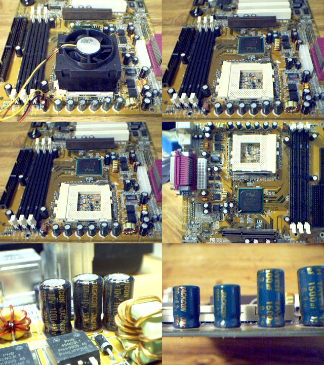

    Currently I got 3 boards from machines that died, there might be more on the way, for sure there is 1 more that is toast, and a few others that show sign's (buldging caps, etc)
    Most of the buldging ones are near the atx power supply input, and the group or 3 shown in one of the pictures.
    Capacitor's above 1000uf
    (1) 6 - 1000uf 6.3V 8mm X 12mm Jackcon Green/Gold writing
    (2) 16 - 1000uf 10V 8mm X 15mm Jackcon Black/Gold writing
    (3) 2 - 1500uf 6.3V 8mm X 16mm Tayeh Green/Gold writing
    Location on board
    (1) EC5-8, EC19,EC21
    (2) EC1,2, EC11-18, EC20, EC22, EC23-25 and C32
    (3) EC3,4
    [Pictures]
    sorry kinda low quality took them with a web cam.
    Are these boards even worth replacing, 22 - 1000uf capacitors and 2 1500uf?

    It depends - is the chipset a 440BX, ZX or i815? I'd probably recap them all and put them back in service as file-servers or routers if they're 440BX.

        Chipset is i440ZX - the same as BX except number of memory banks and PCI slots is limited. You should be able to have 512MB RAM by using two 16-chip 256MB modules.
        IIRC, these boards are intented only for Mendocino Celeron CPUs. But they can be easily modified to work with Coppermine too (by adding one wire to the bottom of CPU socket) - so you can use Coppermine Celerons and even PIIIs with 100MHz FSB.
        I'd fix em all and then sell

          if nothing else they are good practice boards.call it cheap education/experience.you can then put the survivers back in service.

              billse, if you want cheap replacements then e-mail Jackcon about these bad Jackcon caps and then if Jackcon is nice, they will send you replacement caps. Topcat tried this, got his caps when he wasn't expecting in the mail, and used them. willawake has PM'd him about this a long time ago and he said a few caps that Jackcon sent him failed, and some didn't. Jackcon's e-mail address is jackcon@ms14.hinet.net
