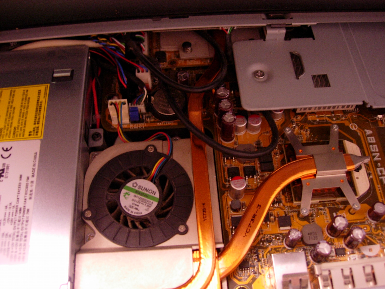

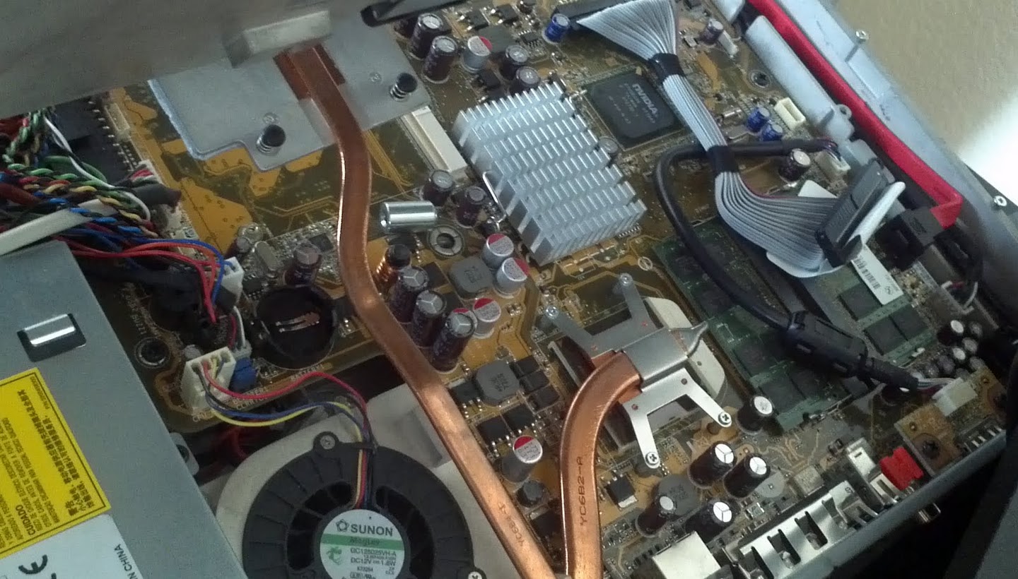

    This is my first post and I am asking for some help regarding Asus A8SN-CF mobo part of HP IQ775 touchsmart desktop. This computer does power on, but no video on display, no BIOS splash, all fan running on high speed. Can be turn off by press and hold power button for more than 3 sec. I removed the power cord and hold the power button for 30sec to drain the system. As soon the power cord was plug-in the computer starts with same blank display.
    The next step I removed the cover and I noticed on the motherboard 3 swollen capacitors- United Chemi-con KGZ-820uF/ 6.3V (near CPU and video card) and I did replaced only those one with new same capacity value …but same results.
    Question: what is the easiest way to verify which is defective … do I have to replace all of them?
    I am aware even I will change all capacitors still have the same problems !

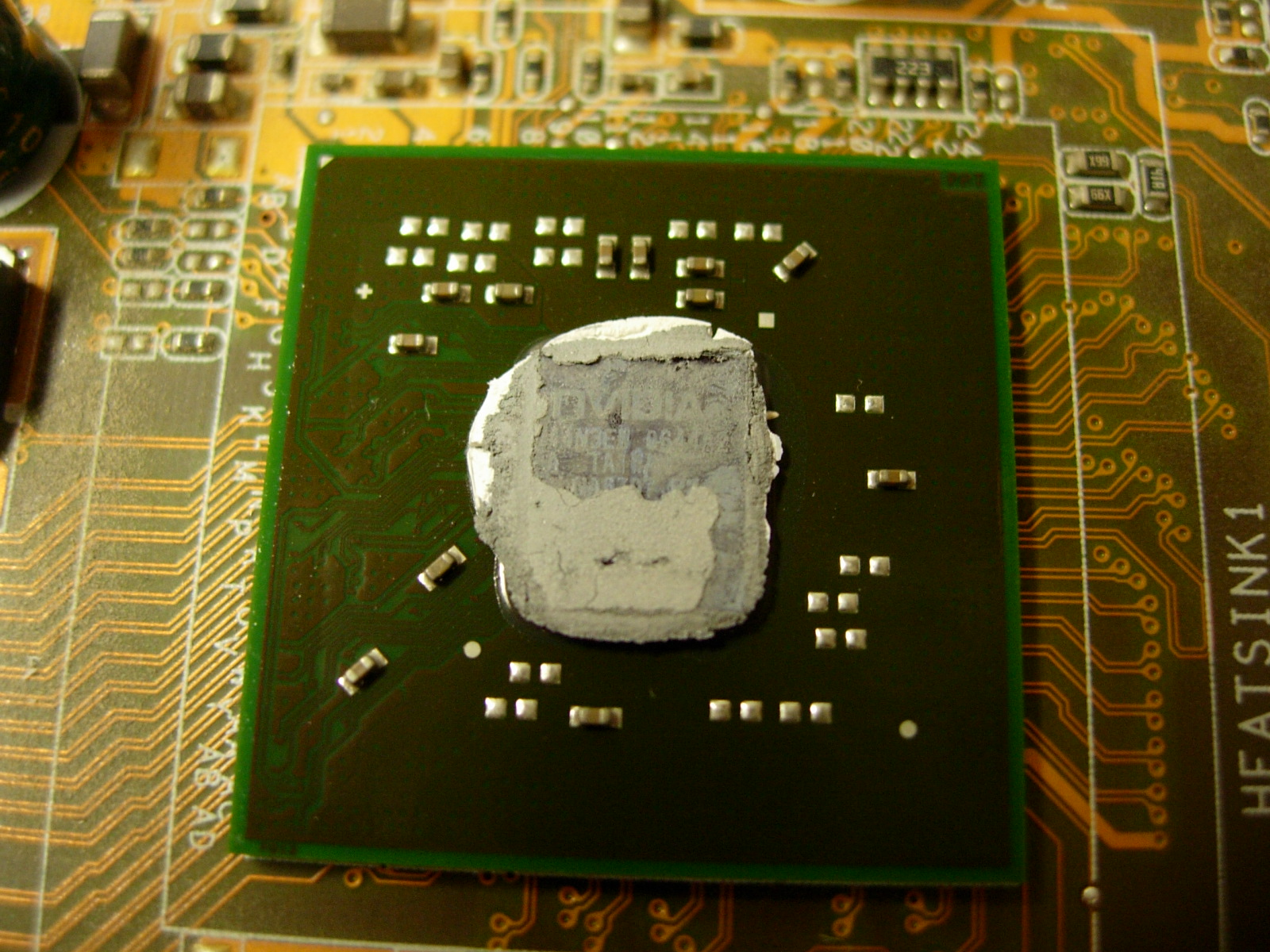

    Re: HP IQ775-Asus A8SN-CF motherboard
    you might be the victim of the nvidia 6100 northbridge solder going soft. reflow or reball
    or it could be some of the other KZG's, sometimes they die without bloating
    but most likely, its the nvidia chip
      This is one odd looking motherboard:
        no wonder.. it's one of those odd all-in-one thingys..
        http://www.ovi-online.com/bigpic/438...0703022223.jpg
        to see if the board still has some life left in it, remove the RAM and power it up. it should start beeping at you about missing RAM..
        if it's not even doing that, it doesn't look too good for this board :/
          Hi guys
          Thanks for advice , and yes I agree with you about weird shape and basically everything is odd: the power supply , power supply connector , the video card (MXM connector) and there is no room for air flowing.....reading other forums those HP touchsmart PC are notorious regarding video card Nvidia 7600 which require reflow (reball) ...
          So I did remove the video card and RAM and unfortunately no change..no beeping...same thing it starts without pressing the power button...I will try to check the power supply voltages!?
            It's not just the videocard, it's the northbridge. I think the 6100 northbridges are the defective ones but better double check to make sure. 7100 I know for sure are defective.
              ^the point I was trying to make. if the chip isn't dead, try to reflow or reball it
                Uranium and mockingbird are 100% right..the northbridge is failing due to high temp, poor airflow and useless thermal pads (like all those HP laptop DV6000-9000 series) ...and hard to believe even after I "succeed" to damage the motherboard (see "cap"photo), the computer is running after reflow-ing Nvidia 6100 !
                Thanks guys for your help !
                  congrats! I prefer reballing cause 80% of reflows iv'e seen revert after a few weeks
                  but then again, i've never reaballed anything before, something I hope to start doing in a few weeks

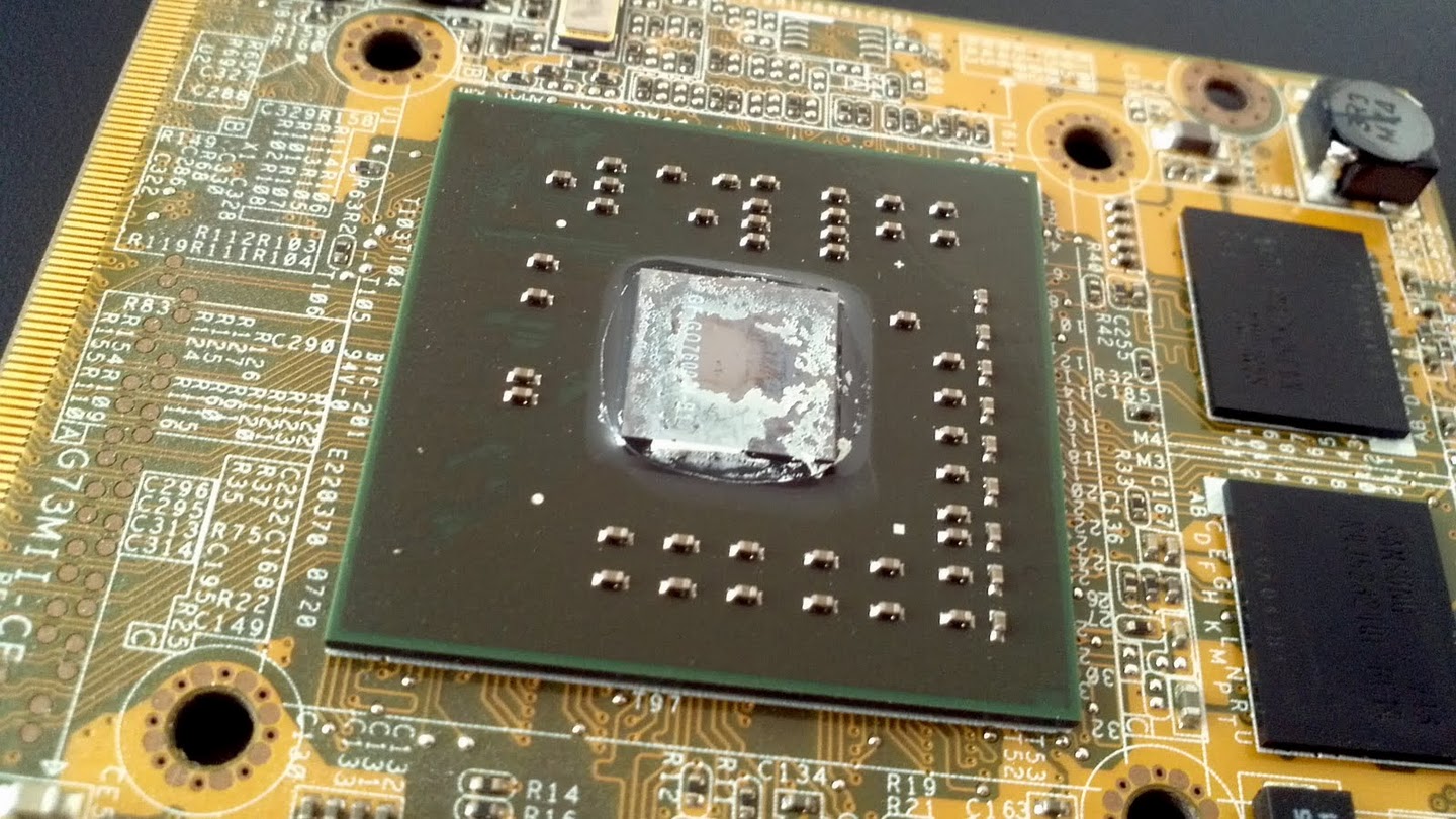

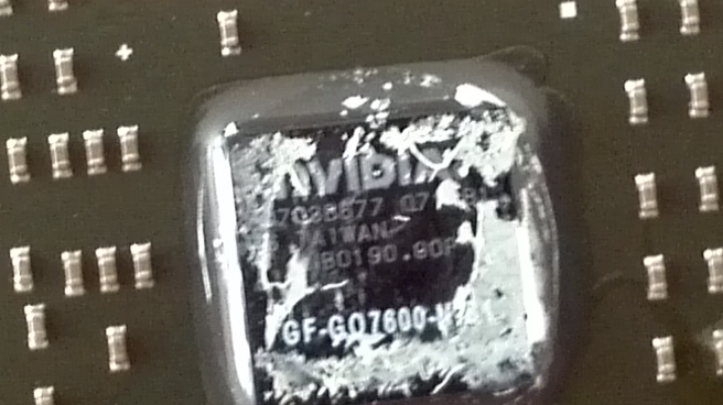

                        Just came across this thread. From the looks of the last two posts I would'nt expect to get much help either but its worth a shot.
                        Problem: I have a IQ775, at startup the screen immediately turns on but just has horizontal lines and never changes from that, no boot screen or anything. I did a quick search and followed a disassembly video on YouTube. So I removed the video card but now I don't know whether it'is the card or the motherboard since reading this thread.
                        Question: Now that it has been torn down, how can I pinpoint the problem? Should I jusr replace the video card and hope for the best or not?
                        Thanks for the help.
                        Edit: Added some pictures for reference and maybe you experienced ones can tell whether if something looks good or bad.
