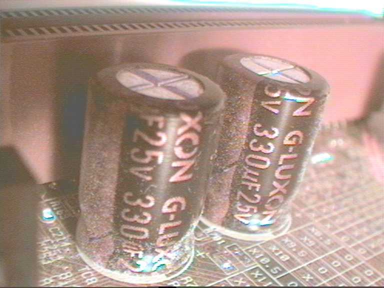

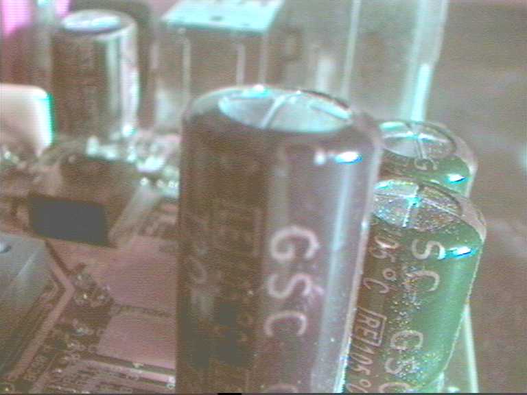

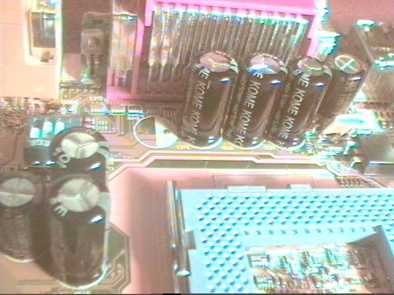

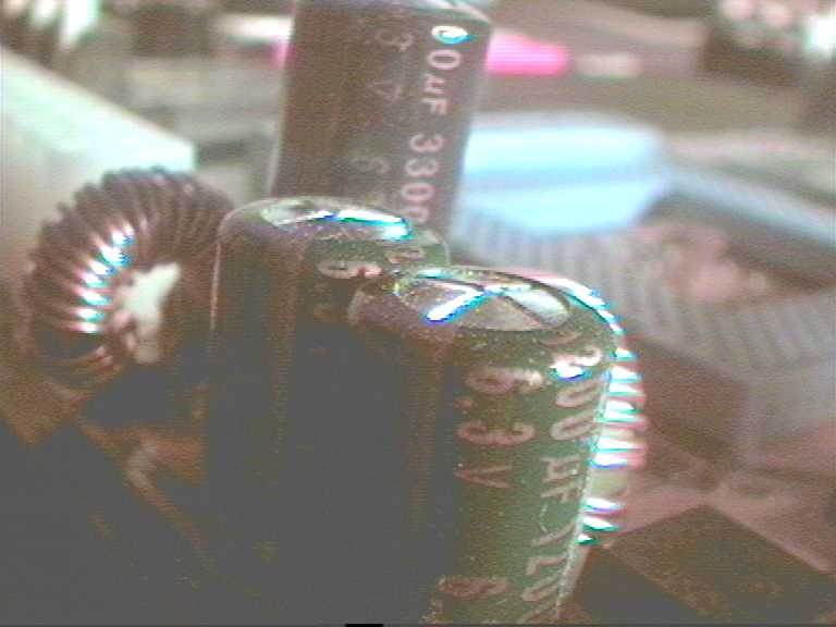

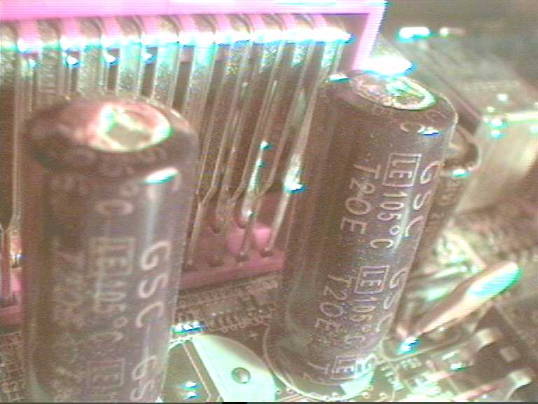

    Bad all 4 GSC 3300uF/6.3V and all 2 GSC 1200uF/6.3V. Luckily, the 330uF/25V caps are not Choyo but G-Luxon so they're not bad. There are free spaces so I'll use more 2200uF caps instead of those 3300uF.

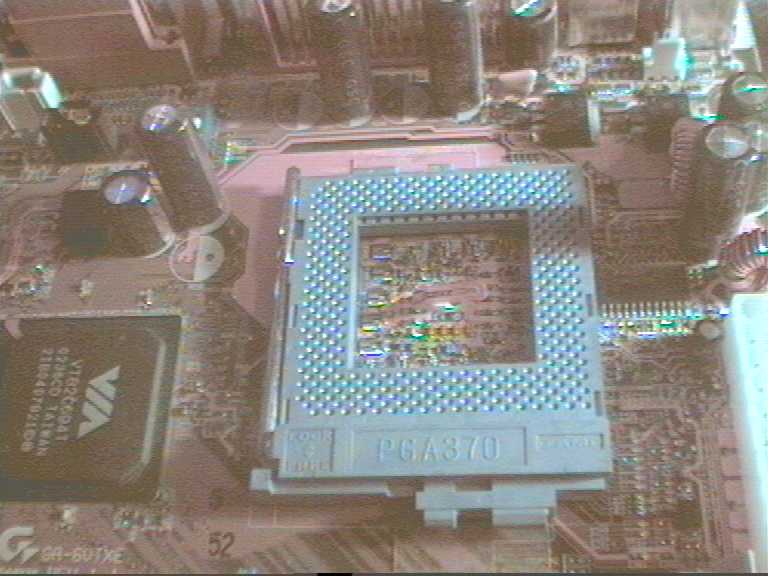

    BTW. Yes, the CPU socket is blue The camera is not that bad.

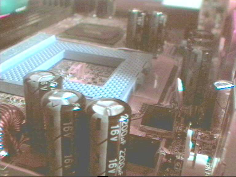

    Replaced 4 3300uF with 6 2200uF/16V and 2 1200uF with 2 2200uF/16V. The free spaces for caps were not all connected to VCore - one is for 5V line - I left that free and used all other - 6 2200uF caps are exact fit for the same capacitance - the board was probably designed for that.

      New caps - perfect fit. You can also see one free cap-space for the 5V line. I've already upgraded two 1200uF to 2200uF so I left this one free.
      The VRM runs really hot because there are only two mosfets (measured 72 degC on the upper mosfet!). The heat might be a problem for the new caps. Fortunately, most of them are away from the mosfets.

        Blue Socket-370 sockets generally denote Tualatin support, although there's no change to the pinout. The Northbridge (Via 8601T) confirms the Tualatin support. With a careful choice of low-ESR caps, it might be possible to do a 'golden overclock' on Tualerons with this board - 100->133 FSB with no other mods. Perhaps a good application for those Samxon ultra-low ESR caps that Big Pope is promoting?

          And the board does support Tualatins just as linuxguru says
          http://www.gigabyte.com.tw/Motherboa...t_GA-6VTXE.htm
            Re: Ga-6vtxe
            I know that it's Tualatin board - tested it with Celeron 1.3GHz.

              the g-luxons are bad.you just dont know it yet.
              you can use 1000@6.3 to replace them.do it now or wish you had later.
