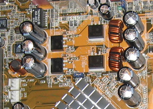

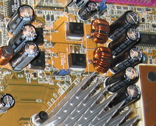

I receive instant reboots with no error msgs, minidumps, or eventlog data when I try to encode video or even rip a cd. Sometimes, the box will just reboot while idle as well.
There have been some instances of BSOD, randomly and different msgs each time.
Due to the case and power supply, I have never had any problems with cooling or voltage. I never overclock anything, and the system has always been rock-solid up until about a month ago.
I have run memtest86 (latest) overnight (I think there were about 7 passes) with absolutely no errors. I have also run Western Digital HDD diagnostics on my 4 drives with no errors there either. I have even tried system restore back to a time when I know I was able to encode video, and the issues persist. All of my drivers are current as well as the latest (1009) bios for the mobo.
After removing a couple of fan controllers and a Promise Fastrack IDE controller (I thought maybe i was drawing too much power from the PCI bus), I noticed that the board had bad caps (see photo)
These look like Nichicon - is this correct? - I thought they were supposed to be good?
Well, anyway, I am sending the board in to badcaps.net for a recapping. I have my fingers crossed and my breath held.

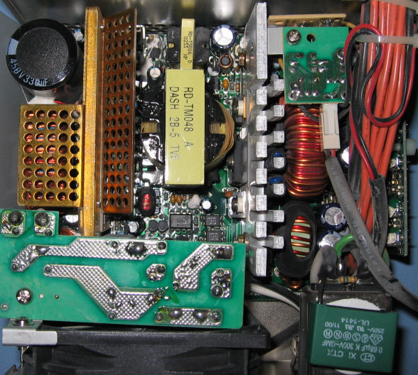

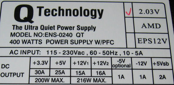

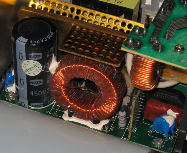

ATX Q Technology 400W PSU (Dual fan, Low noise)

. "Quiet" fans usually means slow speed and low airflow.
