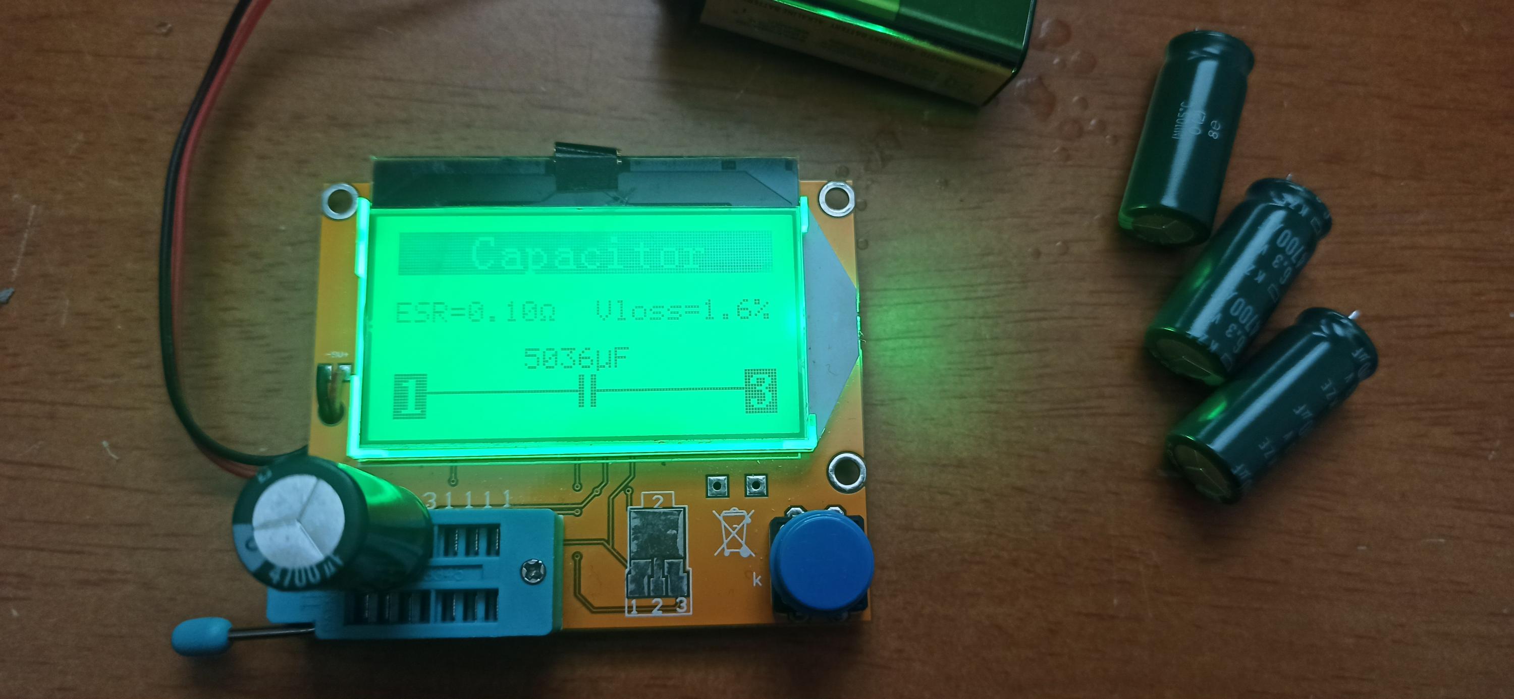

      Okay, I removed those four other big caps and all of them also show more than 4700uf, three of them over 5000uf and one was 4900uf...
      I replaced two G-Luxons before and when measuring they also showed more than rated capacity so I guess none of these electrolytes were good. Tayeh caps were definetely bad.

        This is the tester I use.

          Electrolytic caps have +/- 20% tolerance for their capacity, meaning they can show 20% lower or 20% higher than the stated capacity on their sleeve and still be considered OK.
          Of course with crap cap brands such as Tayeh or 2nd tier brands like Teapo, I'd say anything reading over +15% higher of the rated capacitance on the sleeve should be considered suspect and replaced, regardless of the ESR shown. Teapo SC in particular have a bad habit of deteriorating with high internal charge leakage... which usually results in them showing higher capacitance on a meter.
          On the other hand, the green United Chemicon KZE should still be OK. KZE series are very good. Their reading of 5036 uF is only about +7% of stated (4700 uF) capacitance, so they are well in spec.
          Probably best to focus on the rest / any remaining Teapo and Tayeh caps on the board, including small ones under 470 uF.

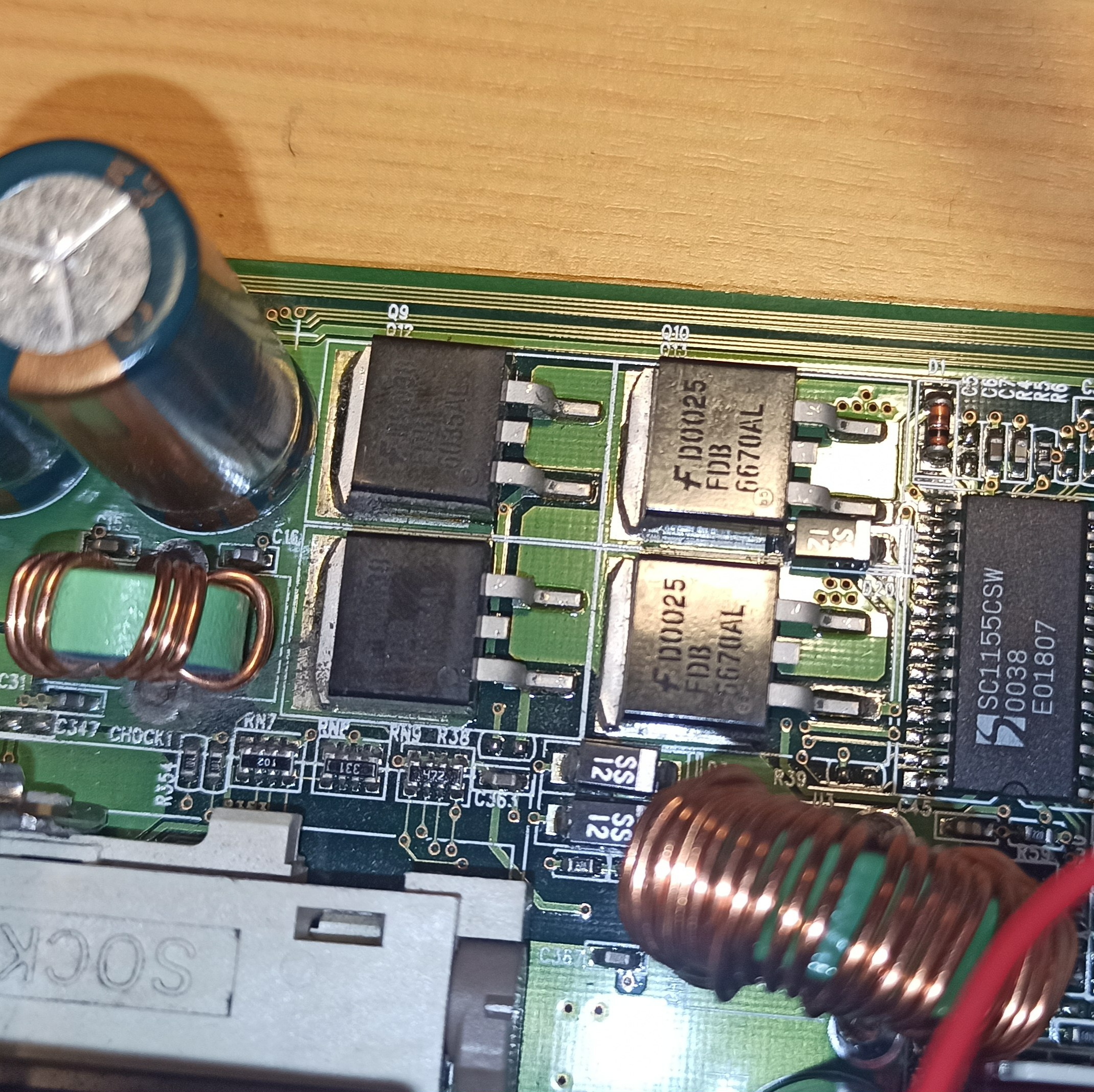

                  Unfortunately I lack the knowledge how to measure mosfets etc., but I decided to try something... I did put multimeter in DC mode and place negative lead on the center pin and then tried poking left and right pins. I did get values approx values -3.3v and -5v with 2 left mosfets but nothing on the 2 right ones, picture attached.

                      You only need to measure the voltage at the Drain (pin 4 is usually easier) and Source (pin 3) with respect to ground. To measure properly with respect to ground, place the black multimeter probe on one of the metal screws that's holding down the motherboard in the case. Or, if the motherboard is not in a case, use the pad around any of the screw holes on the motherboard. All of these are Ground points.
                      And also, just beware that some TO-263 and TO-252 devices on the motherboard may actually be linear voltage regulators / LVDO's and not MOSFETs. On older motherboards like this one, you can recognize these by the part number on the device - anything with *1084, *1085, *1086, *117, *217, *317, and *1117 will usually be a voltage regulator. These have different pinout configuration from what was described for the MOSFETs above.
                      Usually, but not always, pin 3 (right pin) = input and pin 2 & 4 (middle pin or tab) = output. These are really the only two pins you need to measure with respect to ground to see if the voltage regulator is working properly. Input should always have greater voltage than output. If not, the regulator might be bad or could be using a non-standard pinout. The 2nd most common pin config is middle pin / tab is tied to ground and output is the left pin.

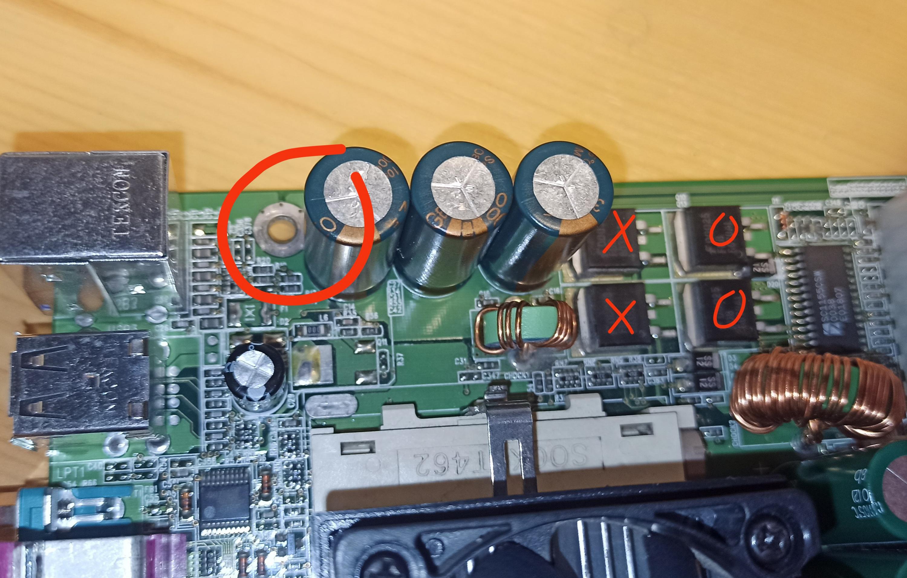

                        Brief update, I now used screw hole pad as ground and measured.
                        Picture attached, ones with X I get 5v on the center pin but nothing on any other pin, ones with 0 there's absolutely nothing on any pin.

                          That confirms the CPU VRM (CPU V_core voltage rail) is not running.
                          This could indeed be caused by the bad caps. But I'm more inclined to think either dead CPU or something else wrong on the motherboard, which can prevent the CPU VRM controller from getting and Enable signal, thus why it's not outputting anything.
                          Do the following troubleshooting steps next:
                          1) Try another CPU (with heatsink, thermal paste, and fan, of course) and repeat these voltage measurements on the MOSFETs. Report what you get.
                          2) If you get same voltage readings like last time (5V on the MOSFETs with X and nothing on the ones with the "O"), disconnect PSU from motherboard, remove the CPU, and measure resistance with your multimeter between the tab (pin 4) of the MOSFETs marked with "O" and ground (screw hole). If your multimeter is manual range, use lowest (usually 200 Ohms) scale. Report what resistance you get. If it's auto, report what resistance you get with the units - i.e. Ohms or KOhms or MOhms.
                          3) If you can, do as Per suggested and measure the voltage on each cap with the board turned upside down, then report these voltages here. Before the CPU VRM can get an enable signal, first the Southbridge and LPC / SuperIO need to have proper voltages up and running.

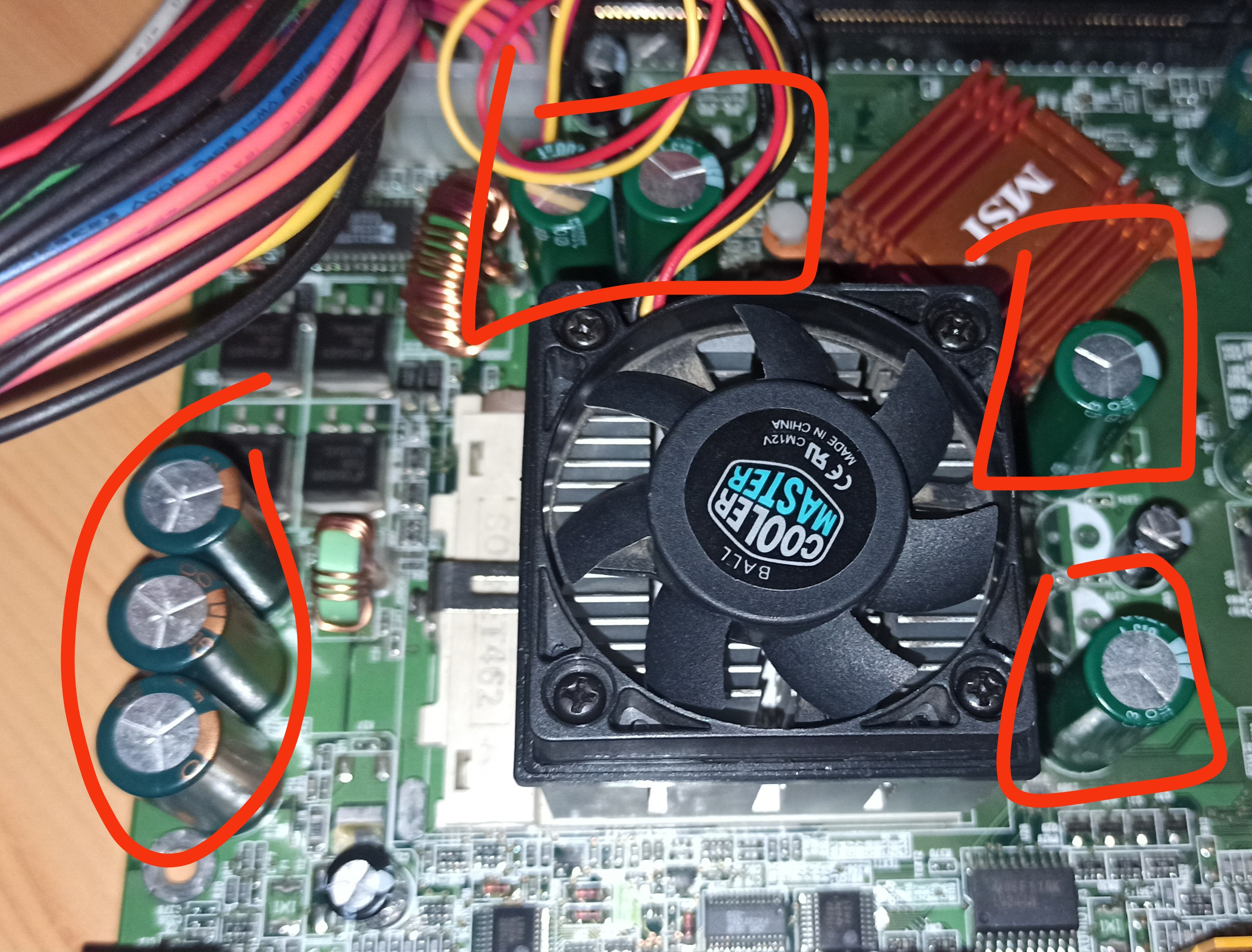

                              Brief update, the three Yageo caps (circle) are all 5V and Chemicons (square) are 0V.
                              Two caps next to ram slots both show 3.3v which I think is the correct voltage for SDRAM.
                              When measuring around AGP and PCI slots I get either 3.3v or 5v depending on cap.

                                Update: Replacements for Yageo and Chemi-Con are installed but the situation did not change, 4 caps which surround the CPU and the 2 mosfets show 0V.
                                So I guess this board has other problems than capacitors, atleast now since it definetely had bad capacitors in the beginning of this repair attempt.
                                  Re: MSI K7T Pro2 Ver1 - capacitors have higher values?
                                  Do the tests I outlined in 2) and 3) in my last post above and show the results here.
                                  There should be more than just 3.3V and 5V near the PCI slots. If you check all of the MOSFETs and/or voltage regulators on the board, you should also find at least one that is lower than 3.3V - typically 2.5V, 2.1V, 1.8V, 1.5V, or similar. It's usually for the southbridge Vcc and possibly LAN chip too.
