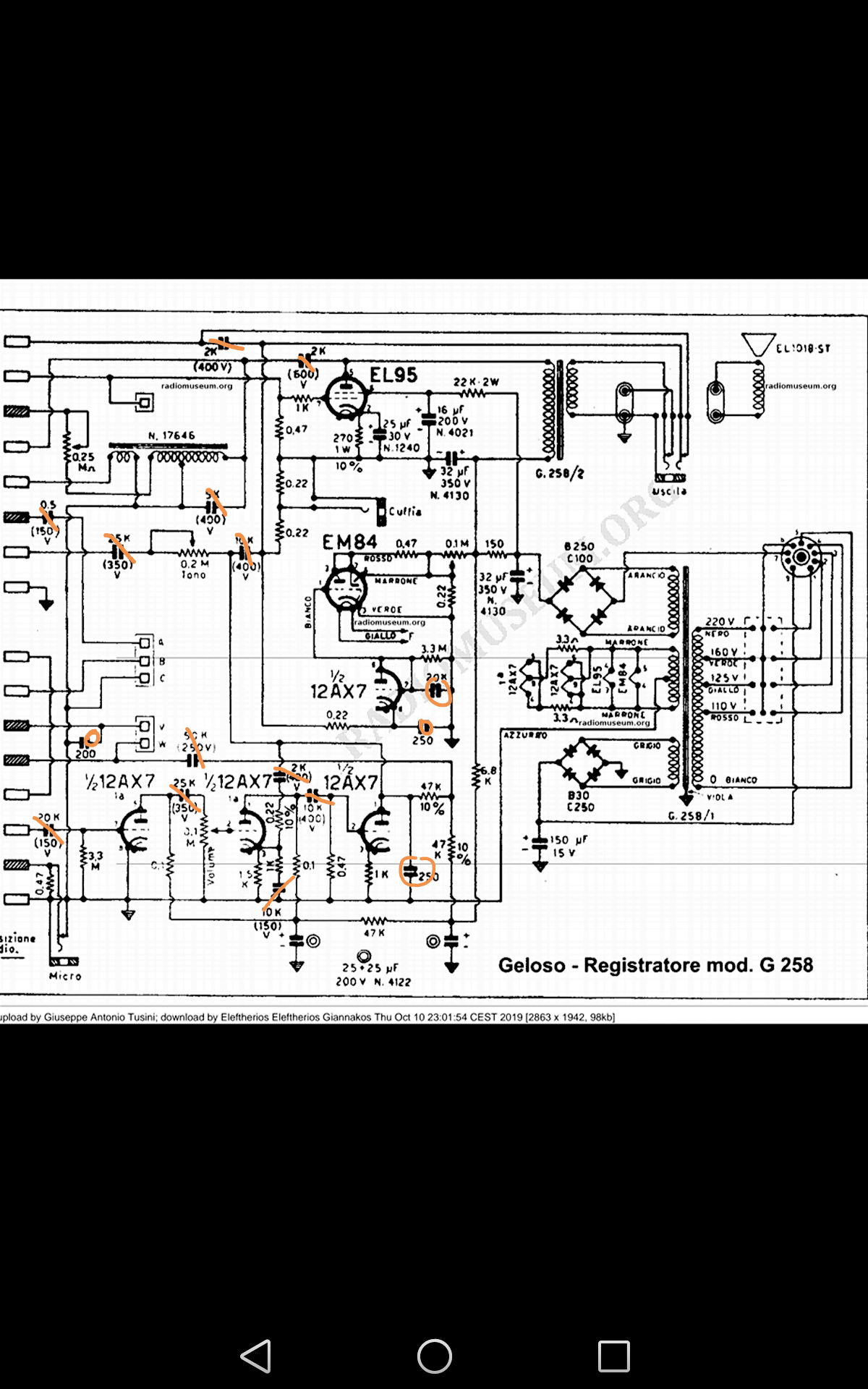

    For sure i have the correct schematic.
    At the end i have used the values from the sassi and everything works perfectly.
    Any idea why this happens?
    I believed that the schematic always corresponding with the real machine.
    I really need to hear your opinions .
    The first picture show the values of the sassi capacitors.
    The second the schematic.

    Some capacitors can be higher or lower value, or voltage, they are not critical. If you need minimum 20K (0.02uF) but you have 25K (0.025uF) parts in stock, then you use them. Sometimes improvements are made during production, so the parts are different because the schematic did not get updated.

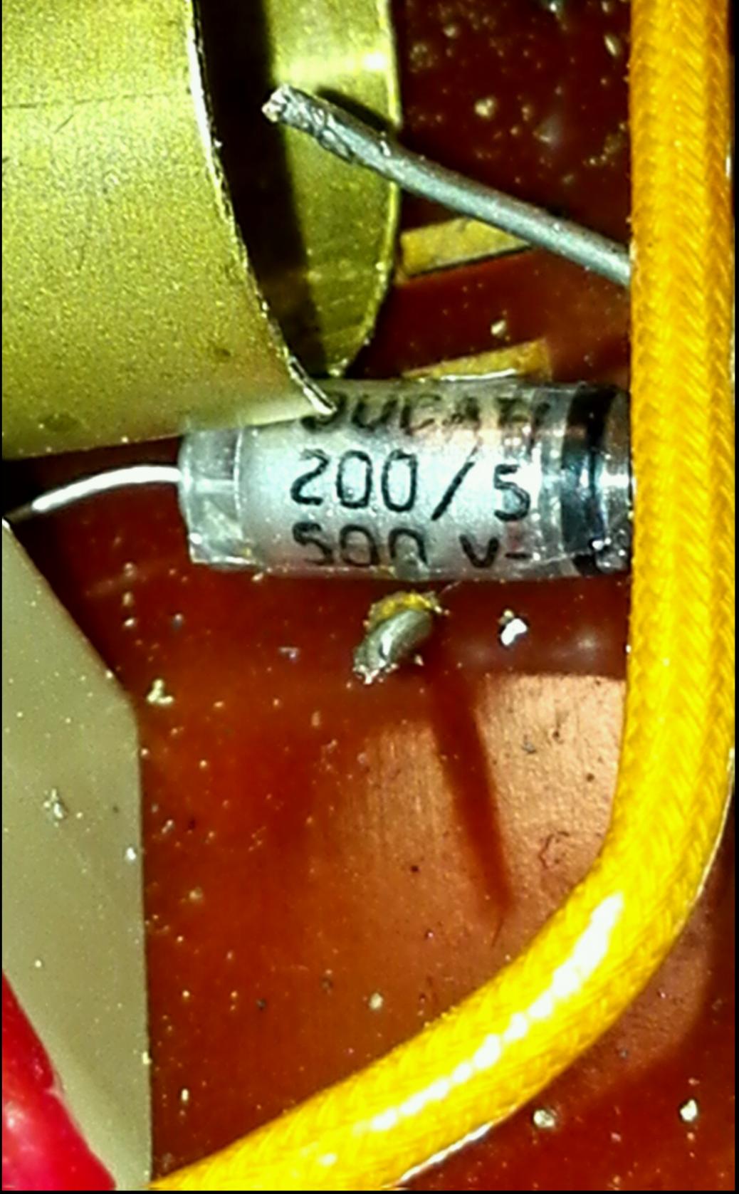

              Or this capacitor . Is 500v , 5% tolerance
              The 200 in what unit is ?

                Looks like a polystyrene capacitor, possibly 200pF.

                  Yes it's polystyrene capacitor. So it is pf

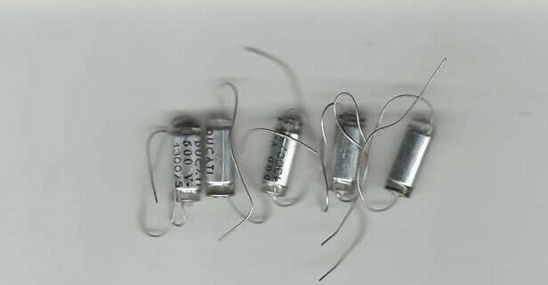

                    They could be 200pf 500V Ducati Axial Electrolytic Capacitors
                    Here is a picture of 1300pf 600V Ducati Axial Electrolytic Capacitors
