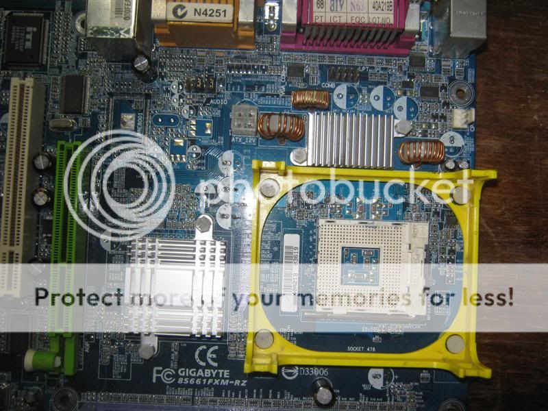

    Would a bad Ethernet Controller stop this board from posting?
    Please have a look
    If anyone has one of these boards can you please identify the missing cap values?
    If you have a board like this can you please identify the missing cap values thank you

    I think I have one of these in the rubbish pile at work - blown caps, it's not worth repairing to me.
    Will check Monday.
    I think the missing component in that location is normal.

      Actually, I was referring to the surface of the ethernet controller, does it look like it may have got hot?

        Oh right, I can't tell it looks like a shadow.
        You're missing a hell of a lot of caps, that's probably one reason why it's not starting.
        I can't see any CPU mosfets either... hmm.
          No it wouldnt post before the caps came out.

            Possible that the bad caps have caused a mosfet to short. Got a multimeter handy?
              Re: Ethernet Controller 8S661FXM-RZ P4 and mssing cap values
              Multimeter at the ready suh!

                  The LAN IC looks fine.
                  Not likely a bad one would prevent booting. Could, but not likely.

                                Thank you SEANC for that great picture
                                I will bung the caps n and see what happens.

                                      seanc is that board in your photo a dead one? I wouldn't mind the bios chip if I can get some money to you for post to OZ?

                                        It's only dead because 2 of the Nichion HM have blown - it does actually still POST and boot.
                                        BIOS chip is soldered on - not easily removable.
                                        I'd still expect yours to power on with a broken BIOS, just wouldn't expect it to do much.
