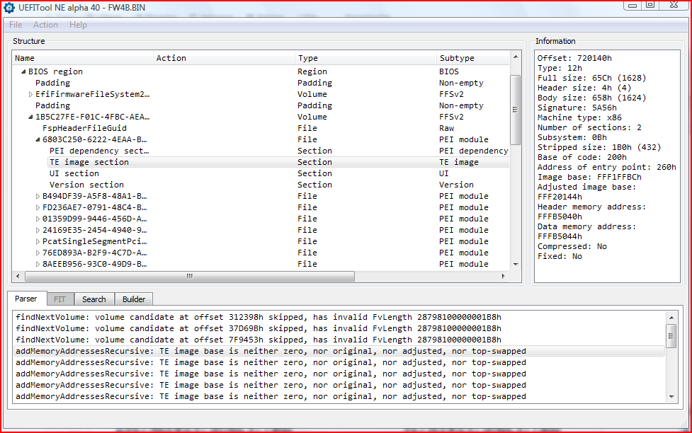

    Hi, need a bios for Protectli PC/router model FW4B-0-8-120.
    It uses a 8 Mbytes coreboot bios.
    The one attached seems to be corrupted after a bios upgrade.

      Re: Protectli PC/router model FW4B
      Thanks peste it doesn't work.
      Seems that problem is located in bios section, according to UEFITool:
        coreboot is not UEFI, it can run a UEFI payload though.
          Hi stj, do you mean that UEFITool can't manage this bios?
          Is There a tool to open this bios and correct the damaged data?
          I have downloaded a coreboot binary file from pcengines.github website but is only 2 Mbytes. (it has some code that is the same as original bios but shorter in size)
            contact the coreboot people about editing tools.
            https://www.coreboot.org/
            the thing about uefi payloads is they contain a filesystem that can have programs added to it.
            so they can change in size.
            that's also what makes them a security risk, you can insert malware into a uefi bios very easily compared to a traditional "blob of code" type bios
              Finally I have found a bios for it.
              I have googled for FW4B, and luckily found a zip file with the 8 Mbytes rom. (protectli-firmware-updater-main.zip)
              There are a few rom files for other models and the *.exe file for upgrade the bios from an usb drive.
              Just for someone who need this bios, I have attached it.
