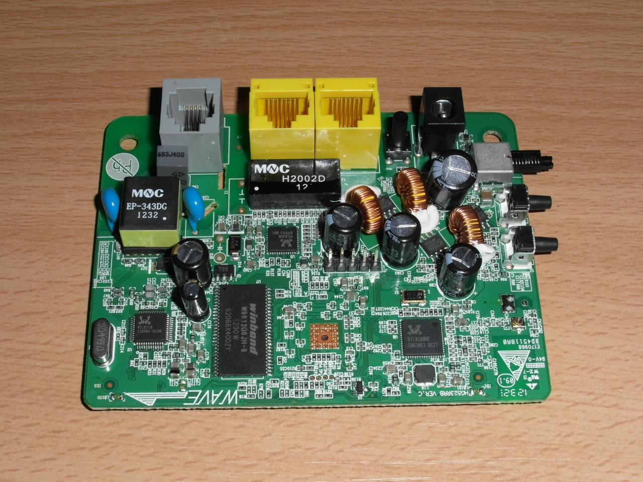

    Hi.
    I hope you can help me choose some replacement caps for my router.
    The original capacitors are:
    Lelon 100uf 10v RZW - 0.58 impedance, 210 ripple
    Lelon 220uf 16v RJA - unknown impedance, 180 ripple
    3x Lelon 470uf 10v RXJ - 0.25 impedance, 410 ripple
    Lelon 1000uf 16v RXK - 0.052 impedance, 1112 ripple
    I was thinking of replacing all of them with Panasonic FR series:
    100uf 10v - 0.3 impedance, 280 ripple
    220uf 16v - 0.13 impedance, 455 ripple
    470uf 10v - 0.056 impedance, 950 ripple
    1000uf 16v - 0.03 impedance, 1560 ripple
    Will the lower impedance and higher ripple of the Panasonics be a problem?
    Thanks in advance.

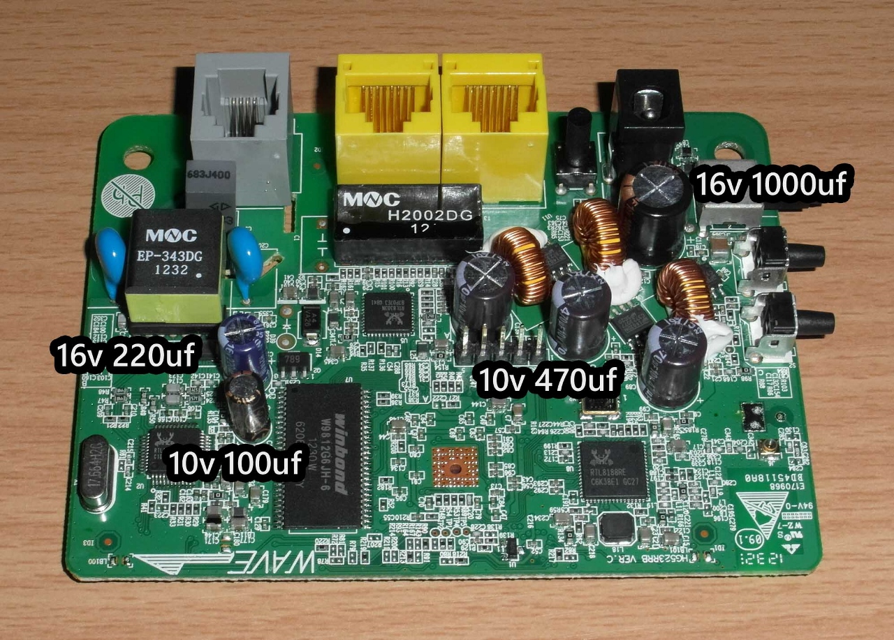

          Based on the picture on the board, the 1000uF capacitor is right by the power jack so it's more or less used as bulk storage of energy and to smooth out the dc voltage coming from the power adapter.
          So the ESR is not very important, it just has to be relatively low.. you can see after the capacitor the inductors for the two dc-dc converters which further generate lower voltages.
          Now look at the power adapter and see what voltage it's rated for, and what's the voltage without the adapter plugged in.
          A lot of those cheap adapters have a voltage on them but at low loads, the voltage is much higher. For example, a 7.5v DC adapter may be 9-11v unplugged or at low currents.
          The point is ... if the power adapter is 5v and it goes to 6-8v without any load, you should be fine if you replace that capacitor with one rated for 10v which should be a bit smaller. A high quality like Panasonic FM or FR should handle the variations in input voltage just fine.
          Also, since it's just a bulk storage capacitor, you're probably going to be fine with just 820uF of capacitance there. So you have options.
          • benrp
            • 7
            Re: Router Recap
            The power adapter has 12v 0.5A written on it, if that helps.
            • mariushm
              • May 2011
              • 3799
              Re: Router Recap
              In that case, you have to use a 16v rated capacitor there. But you should be able to go down to 820uF without any problems.

                      Finished recapping the router. I forget to mention it's a Huawei HG523a router.
                      I had to use a mixture of FR and FM series caps in the end, and slightly lean the 1000uf as recommended.
                      The 25v 220uf is a little too wide, as there is a little resistor close by I had to solder the cap raised from the pcb, so I will probably replace this with a 16v 220uf at a later date.
