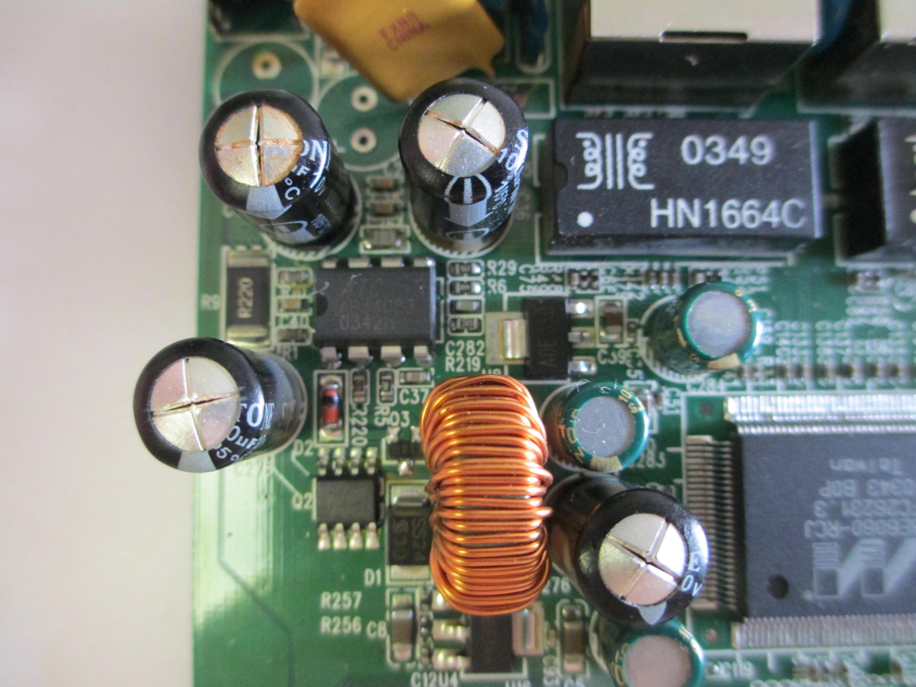

    The JTA0302B power supply on my old router stopped working. Thankfully someone here had fixed one of these before so tried replacing the teapo SEK 47uf 25v start cap with a used capxom KM I had laying around and it fired up and put out stable voltage.
    While it was down I opened the router and found 4 blown stone 1000uf 10v caps. I found some bigger KMQ 1000uf 16v caps in a old sharp tv I had laying around and wondered if they would work better than the stones that are in it now until I order replacements?
    What would be a good cap to replace these with? The stones have no other details than 105c.

    not good,
    only low esr
    types are sufficient,
    as for the defective
    wall power adapter
    that boiled
    these stone caps,
    replace it too,
    if you want
    long turn
    solution

      Chemi-Con KY/nichicon PW would be good. I'd replace the CapXon KM too. Replace ALL the Stone caps (if there are more than those 4), they are not reliable at all!

        I had planned on replacing the power supply since I went mongo on it to get it apart. Are the CUI brand that digi key sells any good? This should work. http://www.digikey.com/product-detai...5RP-ND/2792482
        I've been trying to find info on the stones and looks like I have narrowed it down to either GR(HR) ,HR or XR series due to size (8x14 and being 105c. On yellow stones site it looks like the XR have gold writing so doubt that is it. The other 2 just call it a general purpose and don't mention low esr.
        The other caps are sanyo and look to be in good shape.
