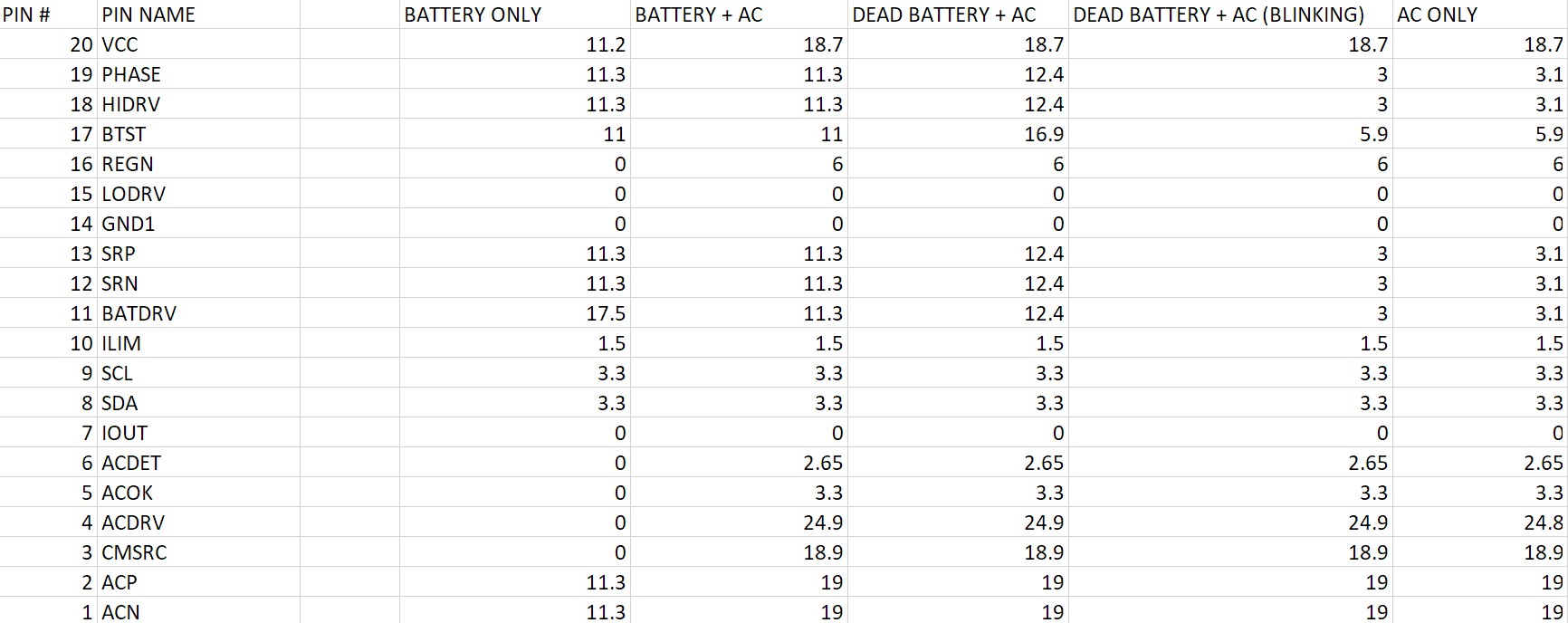

    I have a Toshiba Satellite C70-B (Motherboard AR10SU-6050A2631701-MB-A01) with, I presume, issues with its charging circuit. I had a dead battery for a long while and had to keep the AC connected to be able to use it. I decided to finally replace the battery, but the replacements are not working. The amber power LED blinks repeatedly and the laptop refuses to start. I tried multiple replacement batteries, they all show the same behaviour.
    Here is what I know so far:
    AC only - OK. Power LED burns white and laptop boots.
    AC + dead battery - OK. Power LED burns white and laptop boots. After a while, the LED starts blinking amber, but I can keep using it. If I turn off the laptop while LED blinking, laptop won't start until AC disconnected and reconnected.
    New battery - Power LED blinking amber. Doesn't start
    AC + New battery - Power LED blinking amber. Doesn't start
    When I boot with AC only and then connect the new battery, power LED turns from white to amber (blinking), OS shows 60% charge but 0 charging current. If I then unplug the AC, laptop shuts down.
    As I tried multiple replacement batteries, and they all behave the same, I opened up the laptop and took some measurements of the charging IC BQ24735 (see attachments). Nothing really jumped out at me, other than BTST not being Vbat+6V when new battery + AC connected, but I have no idea why this is the case. I also found it odd that on the new battery, BATDRV is high and I see VCC on the SYSTEM output, meaning the laptop should be working but doesn't?
    Any ideas on how to proceed? Is the charging IC faulty, a short somewhere around it or an issue with current sensing resistors? Also, I was unable to find a board view or schematic for this board, so if anyone could share, that would also be very helpful.
    Thanks in advance!

    Re: Toshiba C70-B charging troubles
    1) Power down, remove the battery.
    2) Meter in resistance mode (200 ohms). Check the resistance for each and every mosfet linked to this charger IC for possible shorts.
    Resistance between SOURCE & DRAIN ?
    Resistance between SOURCE & GATE ?
    Resistance between GATE & DRAIN ?
    Repeat this for all 4 mosfets linked to this IC.
    As a comparison to a similar charger IC device, review the posted chart by @DanielDacko here:
    https://www.badcaps.net/forum/showthread.php?t=98587
      I measured all 5 mosfets going to the IC at 200ohms mode. ACFET, RBFET, BATFET, LODRV and HIDRV all show open line between S&D, S&G and G&D, so no shorts there.
      I also checked the diodes, capacitors and resistors around the area, no shorts to ground. Resistor values seem good, except the 2 R020 resistors showing 0.3Ohm instead of 20mOhm, but I don't really have precision equipment to measure those. Diode between REGN and PHASE also okay.
