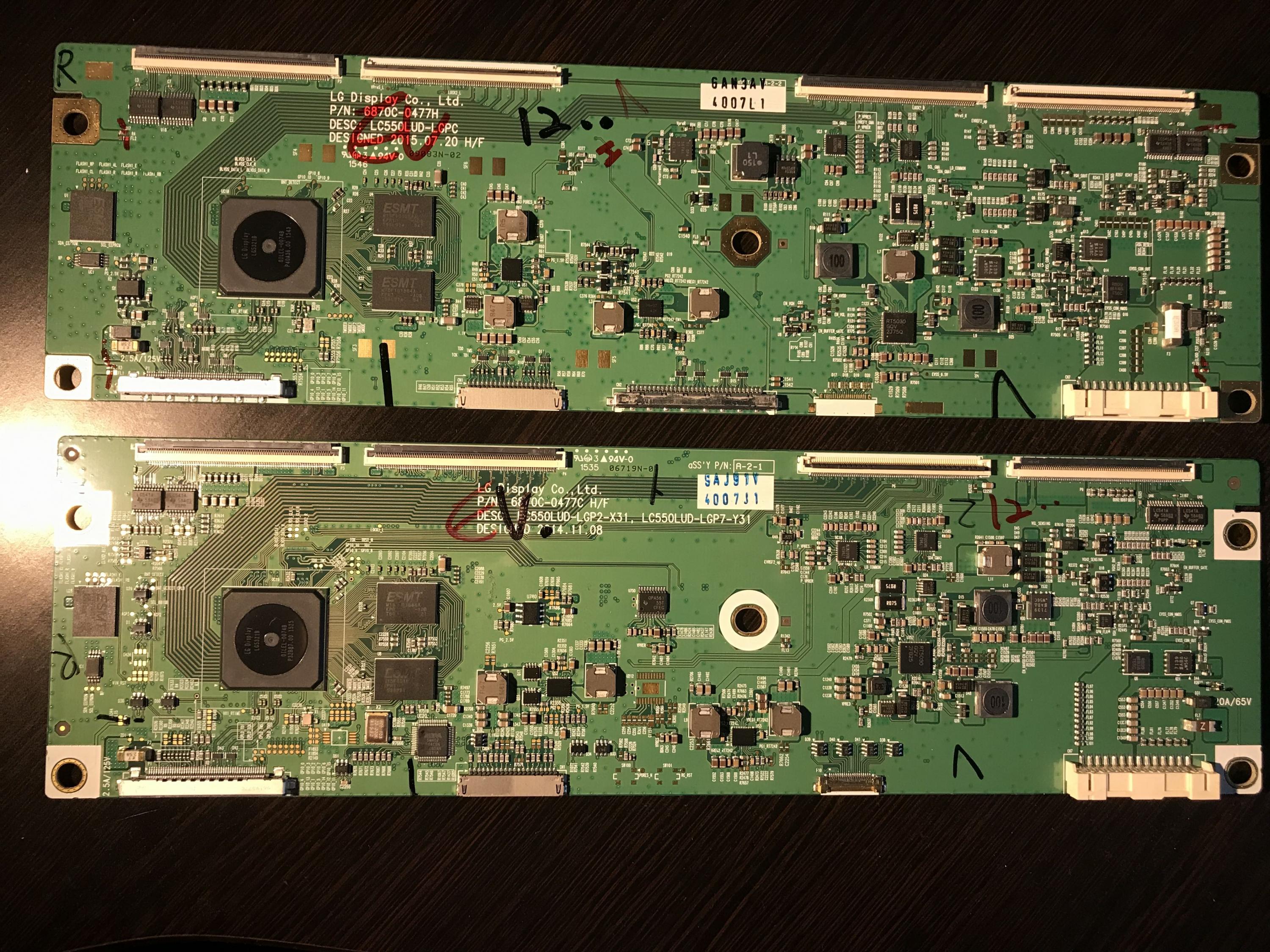

    So I've been having trouble with this TV for years. The symptom was every now and again the image would just freeze and sound would keep playing, a quick power down and power up would fix this until the next freeze. The problem went like this until it started displaying green lines and artifacts as well, also it would not even turn on until it was warmed up. I originally thought it was the main board so after ordering a new replacement it did not fix the issue. Next on the list was a TCON board, I could not find a new one at all, so I bought one that was compatible with my TV used, not exactly the same but description said it worked with my 55EG9100. When I installed it the TV would turn on again. But there were burned in images of a fox news channel and cloudy dark spots, colors way off. I thought I got a defective TCON so I ordered again another one this time matching the exact model my TV came with. Same results, though this time it had a different channel logo lol , the original still works and no burned images but it takes a bunch of tries and i have to warm up the TV for it to get an image.
    I've done a lot of reading and it does look like somehow my original TCON board has some settings that need to be transferred to the replacement, it looks like an expensive solution for that Jig interface. My question is if the settings are stored in an EEPROM chip I can desolder from one board and put it on the one I bought on Ebay? I am handy with electronics and can deal with most surface mounted components except re-balling a video chip lol
    I have some tools if someone can guide me in the right direction, basic multimeter, hot air station & soldering iron, Digital Oscilloscope. I am including a picture of the 2 TCON boards I bought top one is not exact match but compatible, bottom one is exactly like the original both work but give different screen artifacts. There is an 8-leg EEPROM chip on the left side corner if its as simple as swapping it from the original or is it more complicated than this? If there are any schematics for this TCON board out there that would be extremely useful

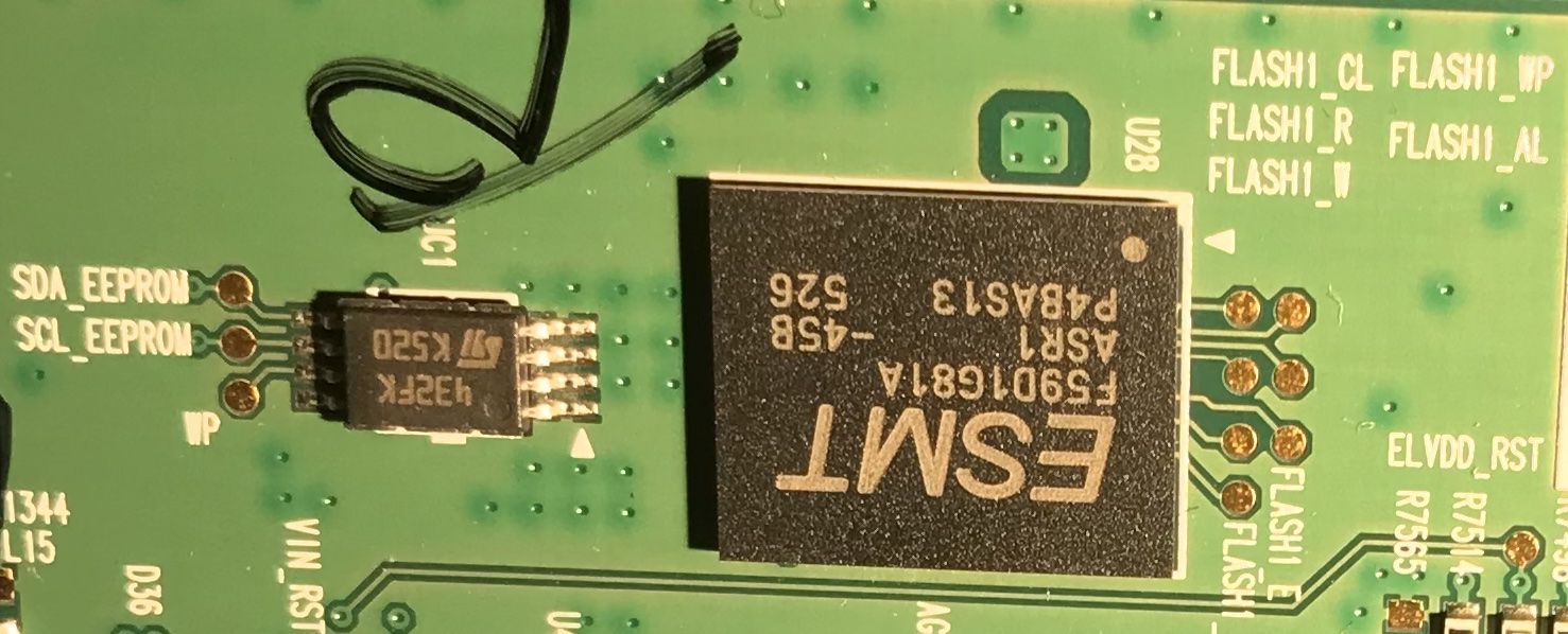

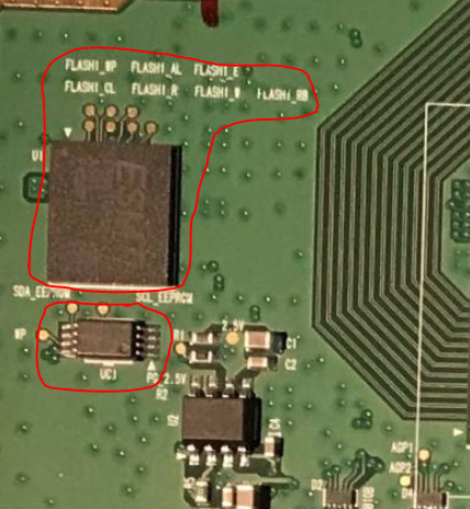

          Thanks for the input so far guys, To answer Davi, Original Board was working for 2 years with no issues other than an occasional freeze up a couple times a week. When board is completely cold it acts like a dead TCON, power supply clicks red light on bottom but completely black screen. Powering on and off for several minutes will eventually bring the screen though now random green lines and pixels will show up. The replacement boards work right off the bat, but a lot of MURA issues. I am thinking of biting the bullet and re-ball the flash chip. Its a BGA 63 chip so I am looking for a stencil with an 0.8mm pitch, I have a cheap BGA station I can use but will have to practice on lifting ram chips from old video cards to get comfortable with it haha. I do remember the voltage of Q21 was 3.5V when it was working and dropped to zero when it wasn't working but this was me fiddling with the meter at components near the power supply connector.
          A closer look reveal pads next to both EEPROM and flash chip, pads labeled for reading, writing, write protect ect. So if there is such a thing as a simple Arduino EEPROM programmer that can be attached to these pads though not sure about the flash chip lol.

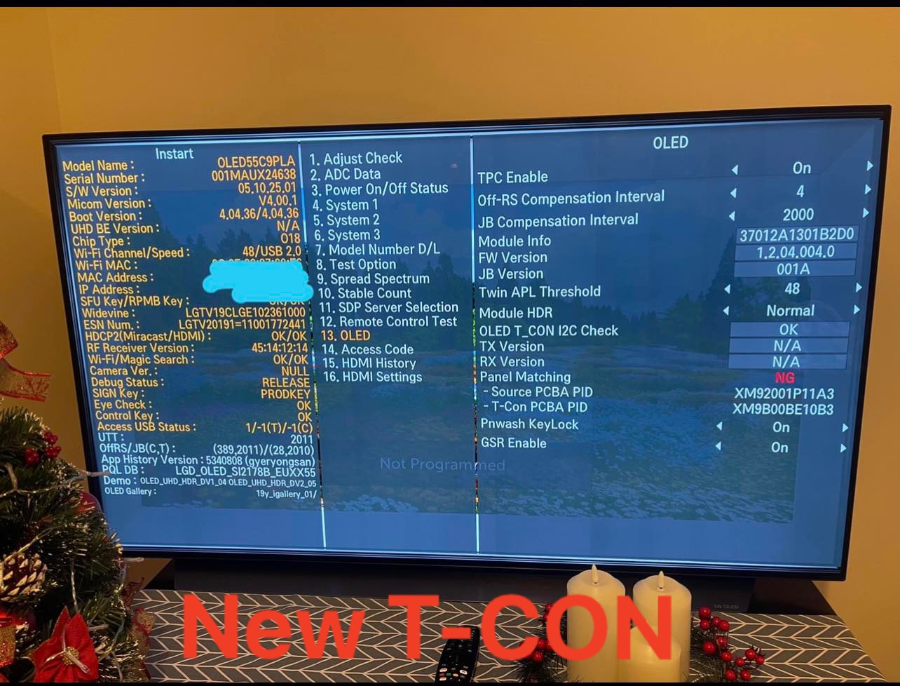

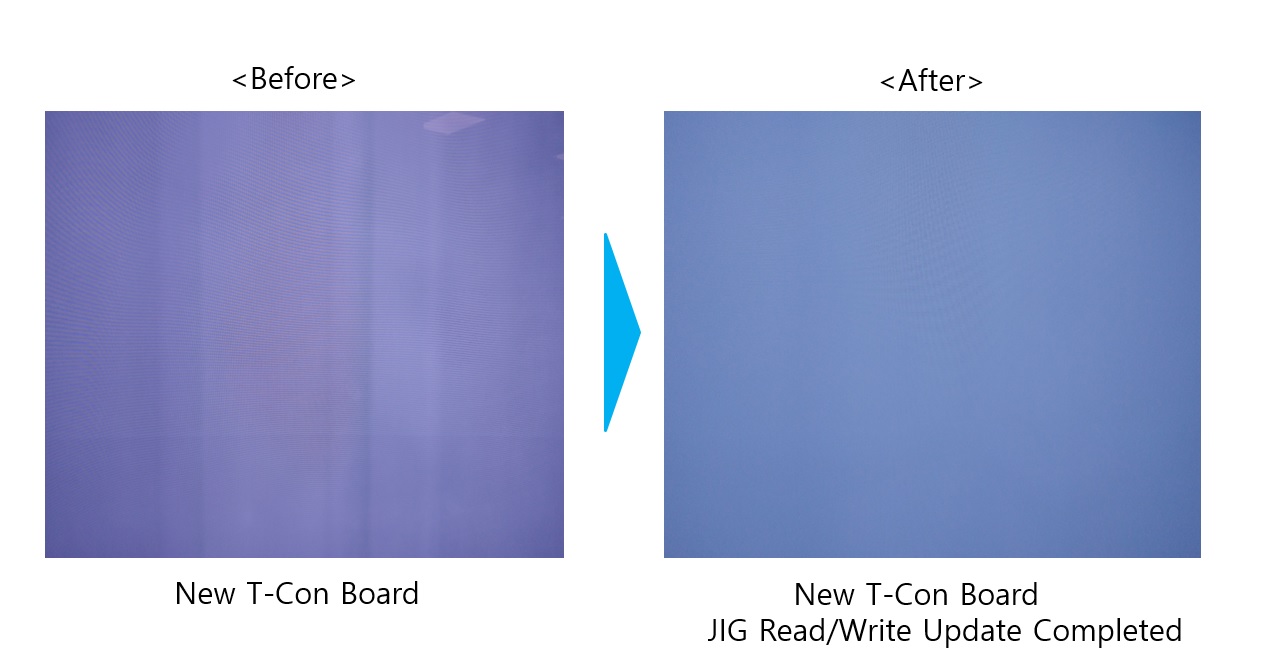

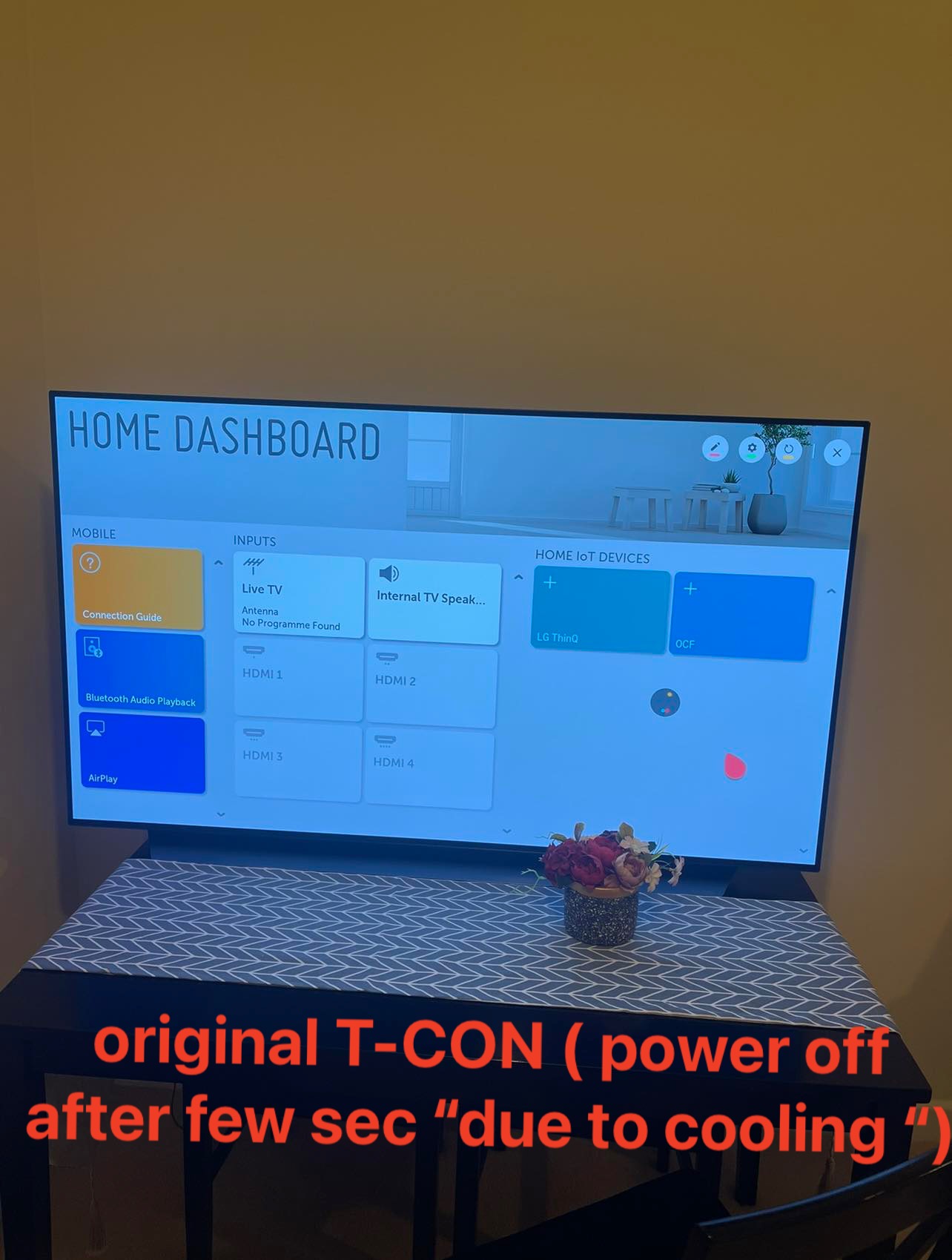

              Hi
              Do you have Idea how can I doo that to write to the new T-CON ( OLED55 C9 )

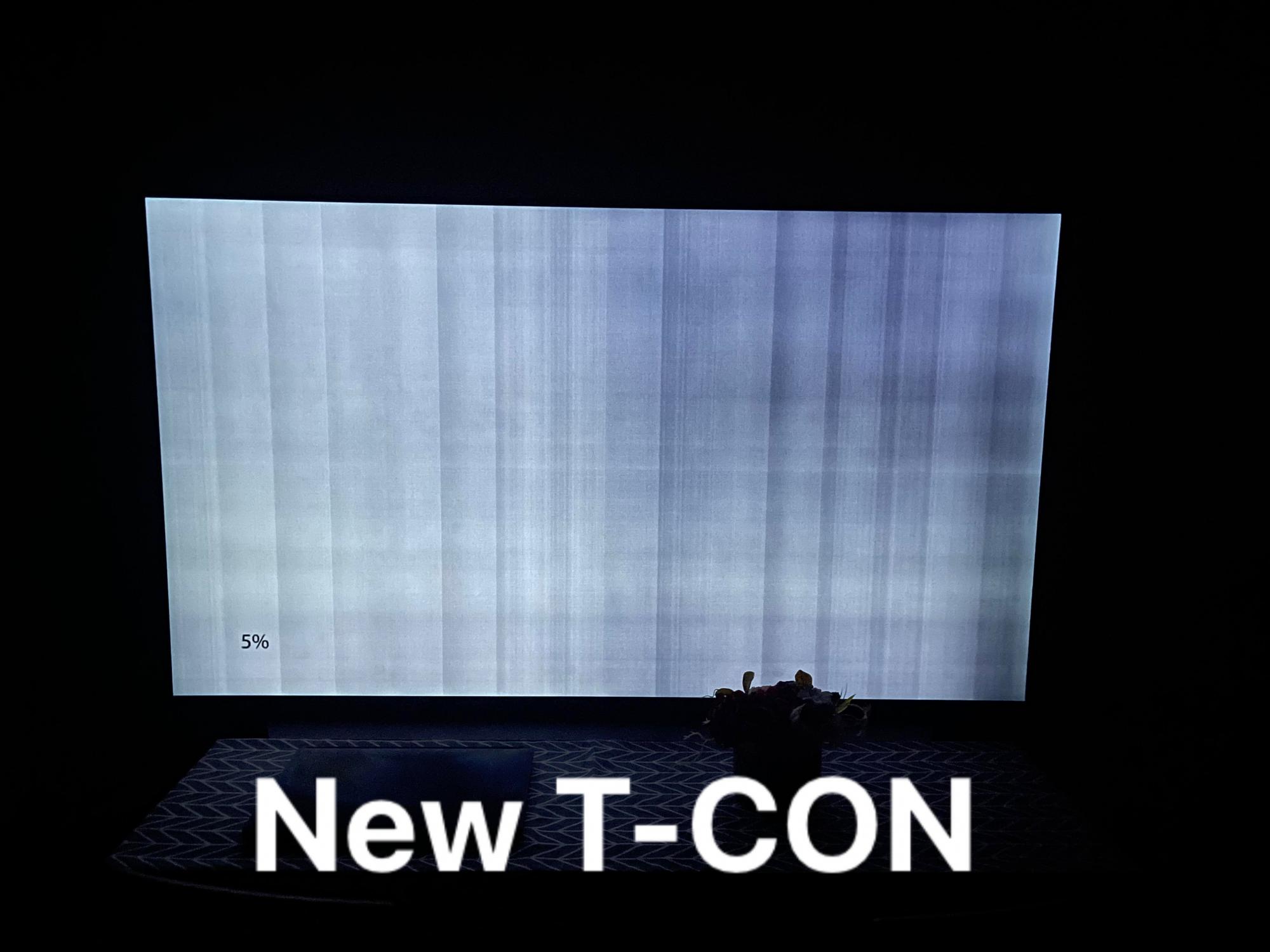

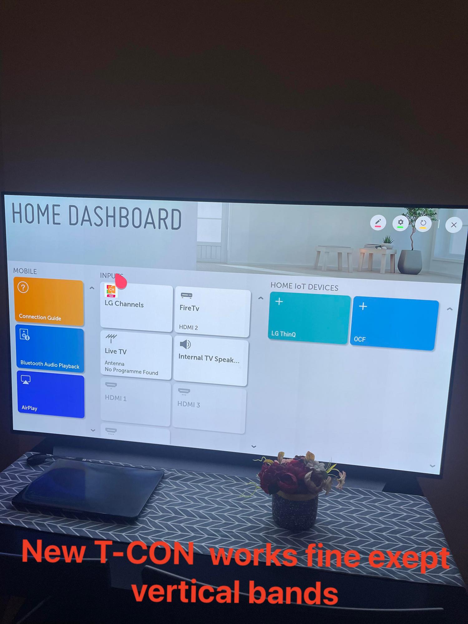

              The original T-CON it's definitely foult ( turn on TV all good but acter 30 sec power off )
              New T-con all works good exept with vertical bands which you can notice when gry pic ( like in your pic )
              Thank you

                The original T-CON it's definitely faulty ( turn on TV all good but after 30 sec power off )
                Thank you

                        Hi
                        Thank you for your suggestions, I will try find how to downgrade the firmware maybe a last solution, in this stage I have done IN-STOP few times and the WebOS apparently looks like factory reset , but still I got the vertical bands slightly vizibile
                        One question, it's the T-CON has eeprom chip? I Was thinking if I read/save the data from the old T-con and the writing to the new one .

                                432FK = 24C32 (TSSOP8) - 1.7 V to 5.5 V EEPROM
                                F59D1G81A - 1 Gbit (128M x 8/ 64M x 16) 1.8V NAND Flash Memory

                                    I think you got right about the version on the IN-START , I maybe mistake but I can see two versions at the OLED info different number between panel and new t-con I will update tomorrow the version of dose two , I will try to find how to post some pictures here ( I m new on the account) you guys to see about the vertical bands and some info from IN-START

                                      Re: LG OLED 55EG9100 TCON troubles
                                      Some pic attached
                                        Some pic attached
                                        can you show us here same page IN_START of the original T-CON in place ?
                                        did you sent IN_STOP before while original T-CON in place ?
