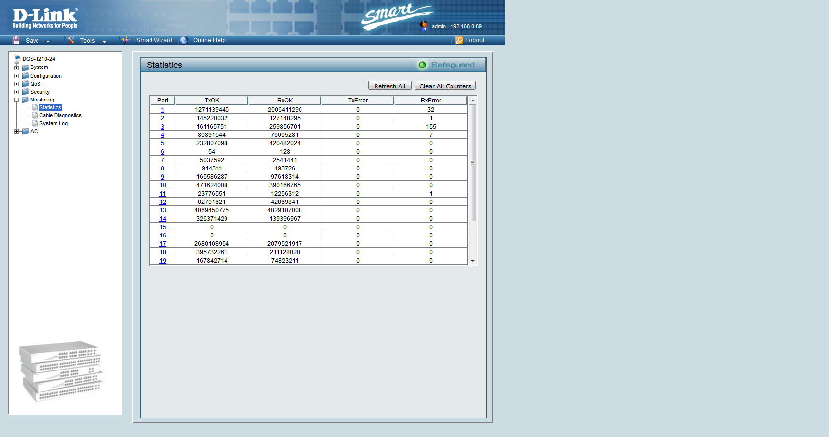

    I have the DGS-1210-24, I use it for vlans and gigabit mostly. I can do a good 100-120MB/s transfers on this switch.
    As you can see I have some rx and tx issues, most of the time, it's just the equipment or it's connection on the other end.
    I had my switch for about 2 years now, it's a solid switch, I've hardly had to do anything with it. Paid $222 New, newegg wanted $430 and D-Link $500, found it at some website called http://www.costcentral.com/

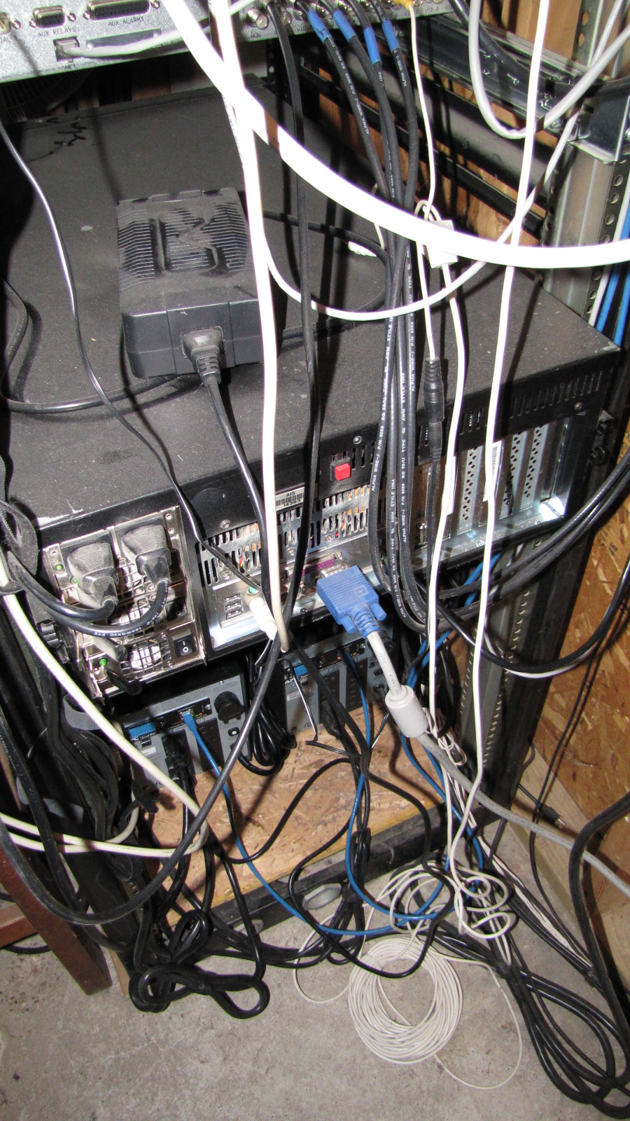

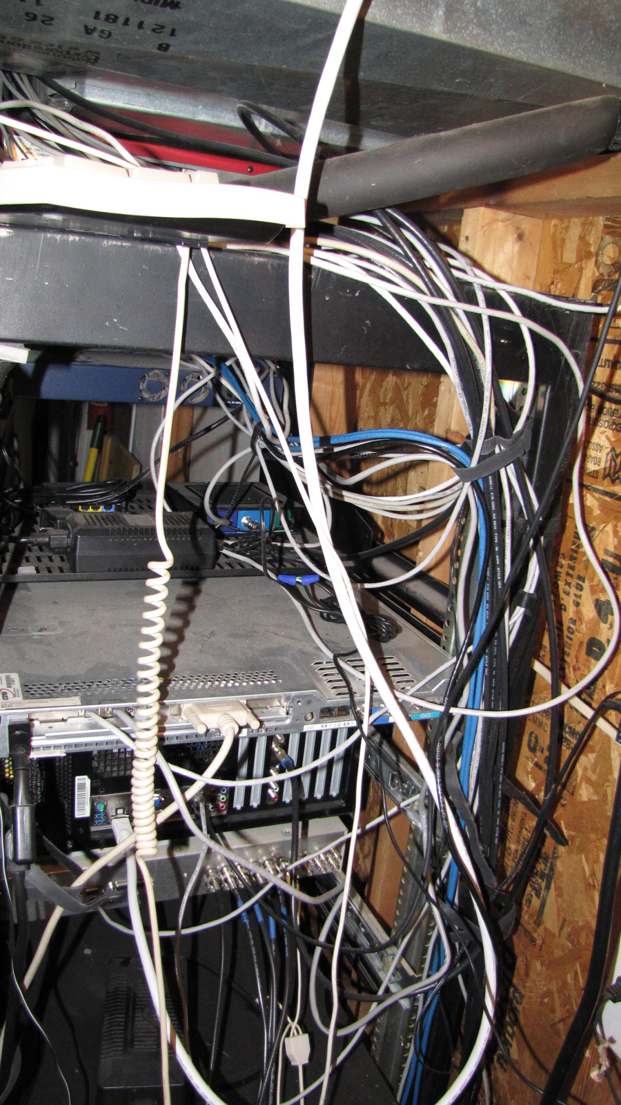

                  Just an update, I picked up a brand new Procurve 1810-24G v.2 for $189 shipped. Here's hoping it works out for what I need.
                  Also got a bunch of CAT-6 patch cables of various colors and lengths to connect everything in the rack. Up until now, I've been using homemade CAT-5e cables that are all solid wire and the same color.
                  This is the first time I've used a managed switch, so I've got some reading to do before it arrives.
                  Also need to get some cable organizers and clean up this horrendous mess! (these are pictures from before the upgrade)

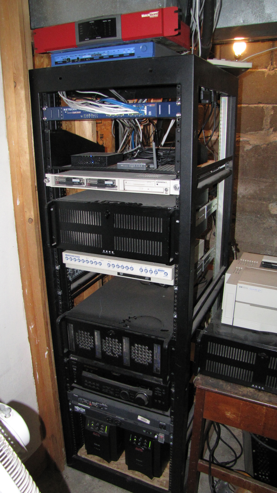

                      • Maxxarcade
                        • Jul 2006
                        • 973
                        Re: Need advice on a new LAN switch
                        Originally posted by Uranium-235
                        yeah not bad, what are they used for? I see some cat 5 cables and a capture card, is that a HT server? Probably so, the amp looks like a dead giveaway. The bottom one dosen't look like it even has a cat5 plugged in
                        From top to bottom: (ignore the junk on too of the rack, just storage)
                        Switch
                        Cable modem and wireless AP
                        Proliant DL360 (router, running ClearOS)
                        HTPC
                        Security DVR
                        File server, running NASLite-2
                        HT receiver
                        Projector RGB interface
                        Surge Protector
                        2x Smart-UPS 1500 w/ LAN management cards
