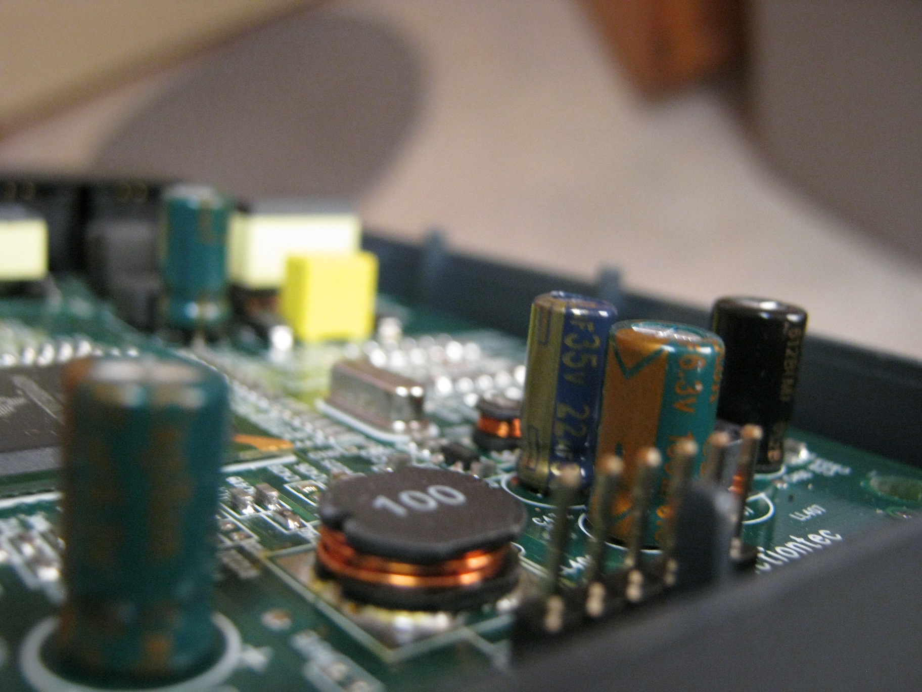

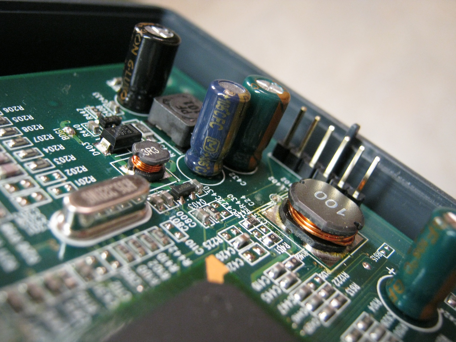

    This modem died a couple days ago. It lost the DSL signal, and it wouldn't start up after being powered off for a couple minutes. Inside, there are two bad CapXon caps.
    Here are the caps in this modem:
    C453: CapXon GF 1000uF 16V (bulging/leaking)
    C406: CapXon KM 470uF 35V
    C446: G-Luxon LZ 470uF 6.3V
    C427: CapXon GF 330uF 6.3V (bulging, bung blown out)
    C424: CapXon GF 22uF 6.3V
    C425: CapXon GF 100uF 6.3V
    C400: G-Luxon LU 47uF 35V
    C432: Panasonic FC 22uF 35V

    We have a similar version (actiontec, same style of case design), and it had suffered from exploded capXons also. It still has a few capXon in there, but they are only the tiny ones - <10uF.
    There were a bunch of 330uF 6.3v and 220uF 10v CapXon GF that had bulged, and pushed the case off the bung - leaning even more than the tower of piza!
    Could we get some pics? Include a pic of the PSU too, some PSUs had bad caps also (like ours).

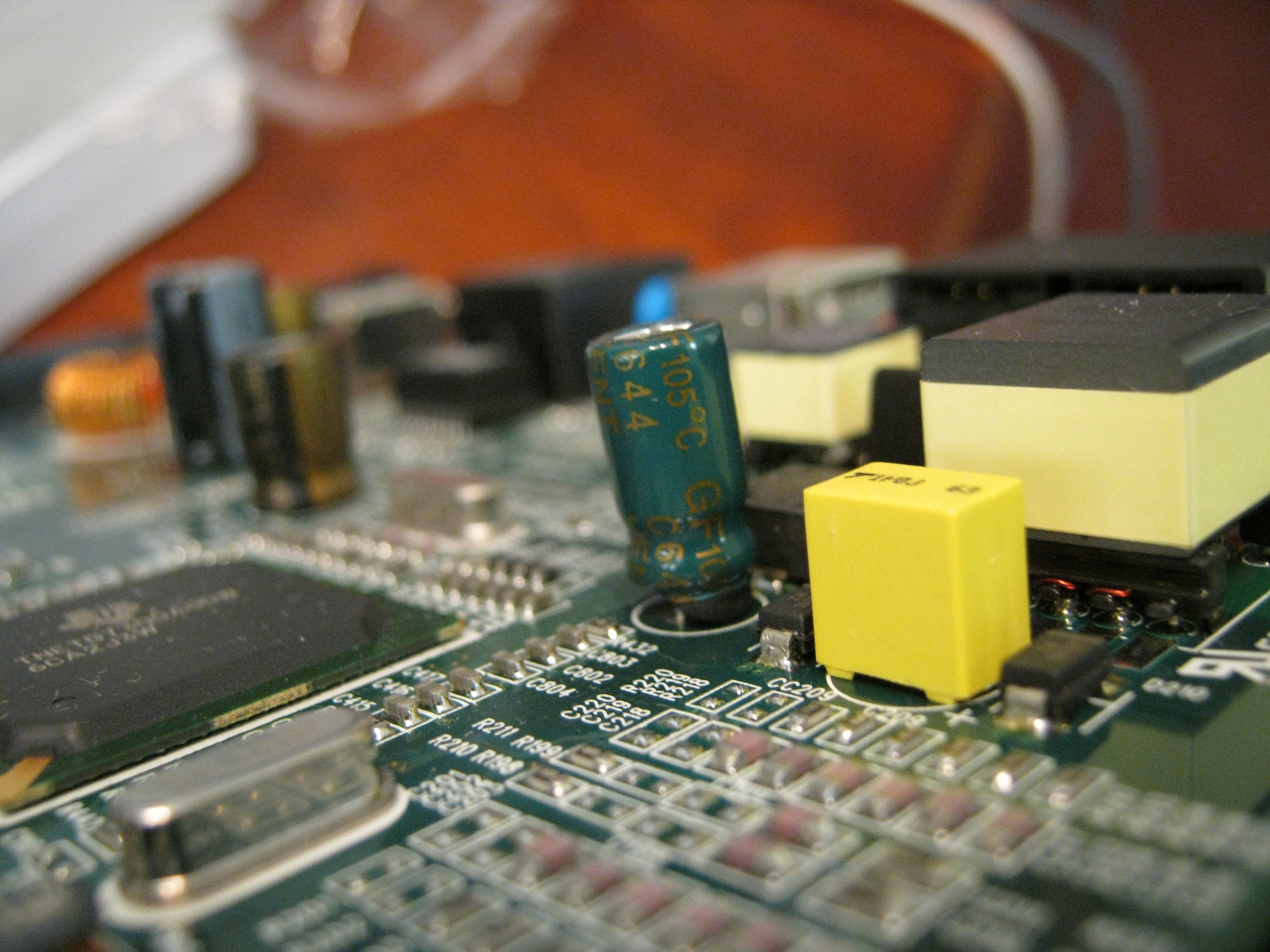

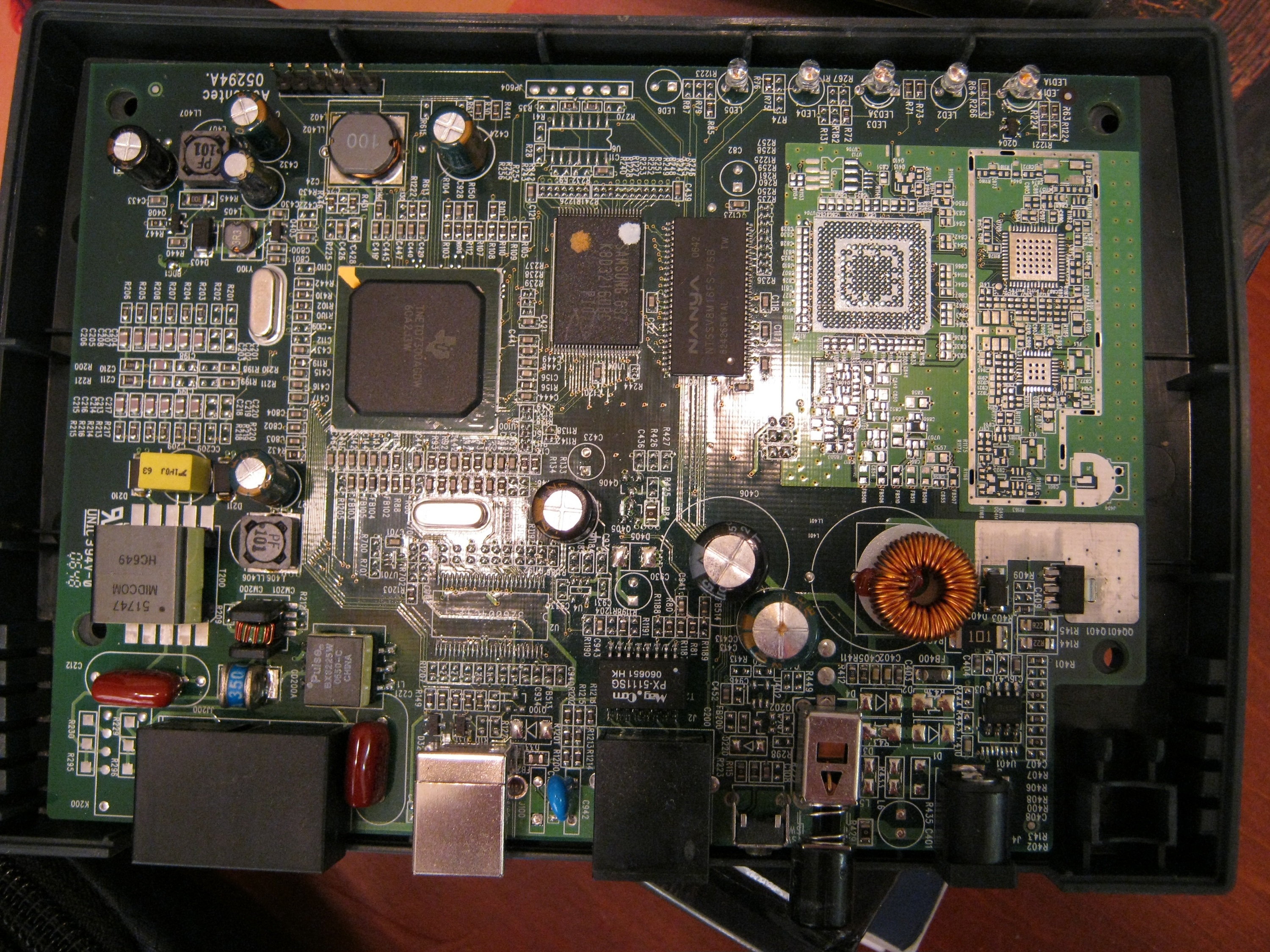

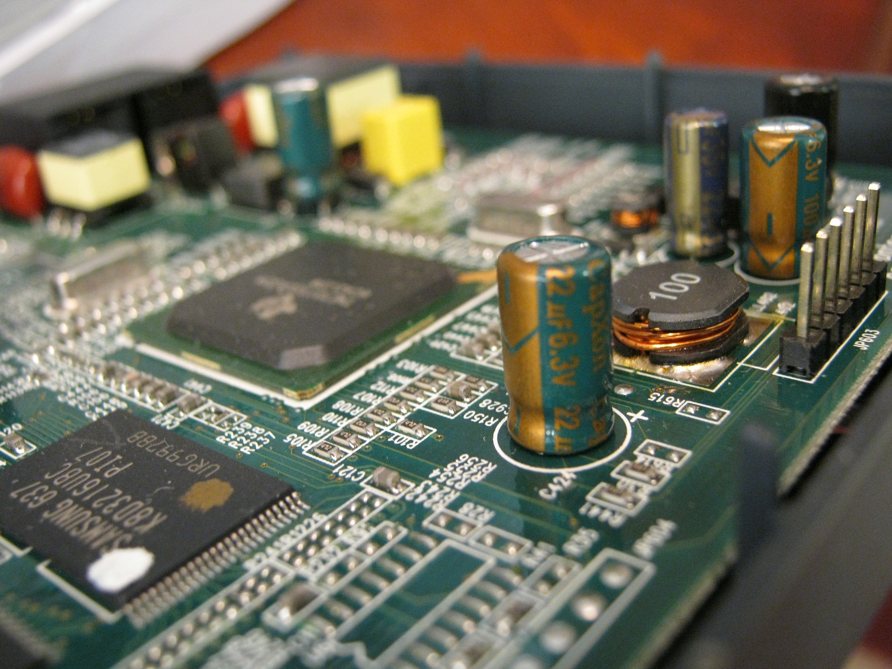

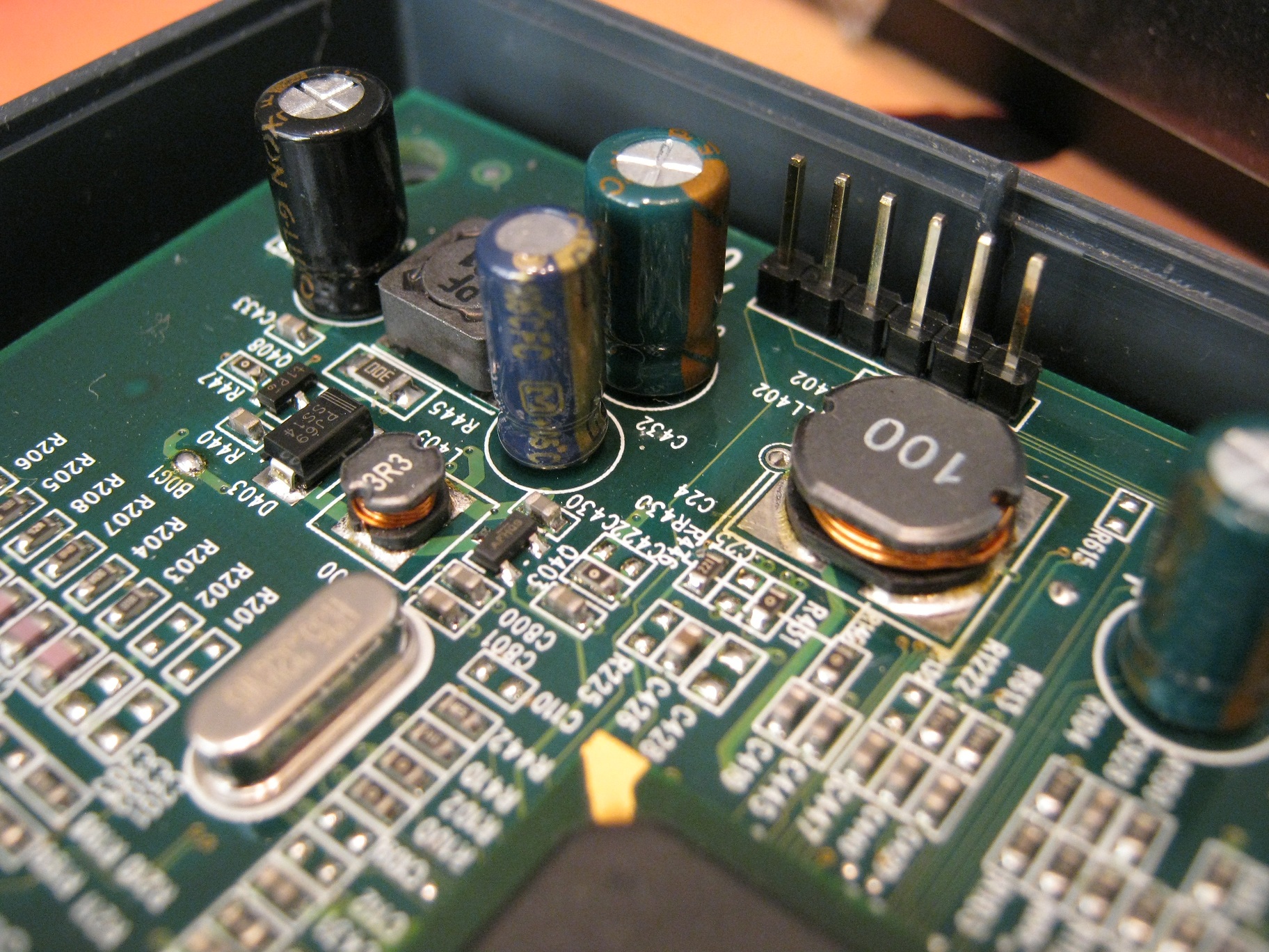

      Here are the pictures. It appears that the 1000uF cap is actually C413. I think C453 is an empty location for a surface mounted cap.
      There are some odd cap sizes. The 330uF cap is the only one that appears in the CapXon GF datasheet. The datasheet shows that 22uF caps start at 50V, and the size of the cap in this modem matches the size listed for a 63V cap. However, the voltage rating on this cap is clearly 6.3V. The 1000uF cap in this modem is only 12.5mm tall, and the 100uF 6.3V cap is 6.3mm in diameter.
      The power supply is a linear 12V 600mA wall wart. I don't want to open it to check the caps. Its case appears to be ultrasonic welded together.

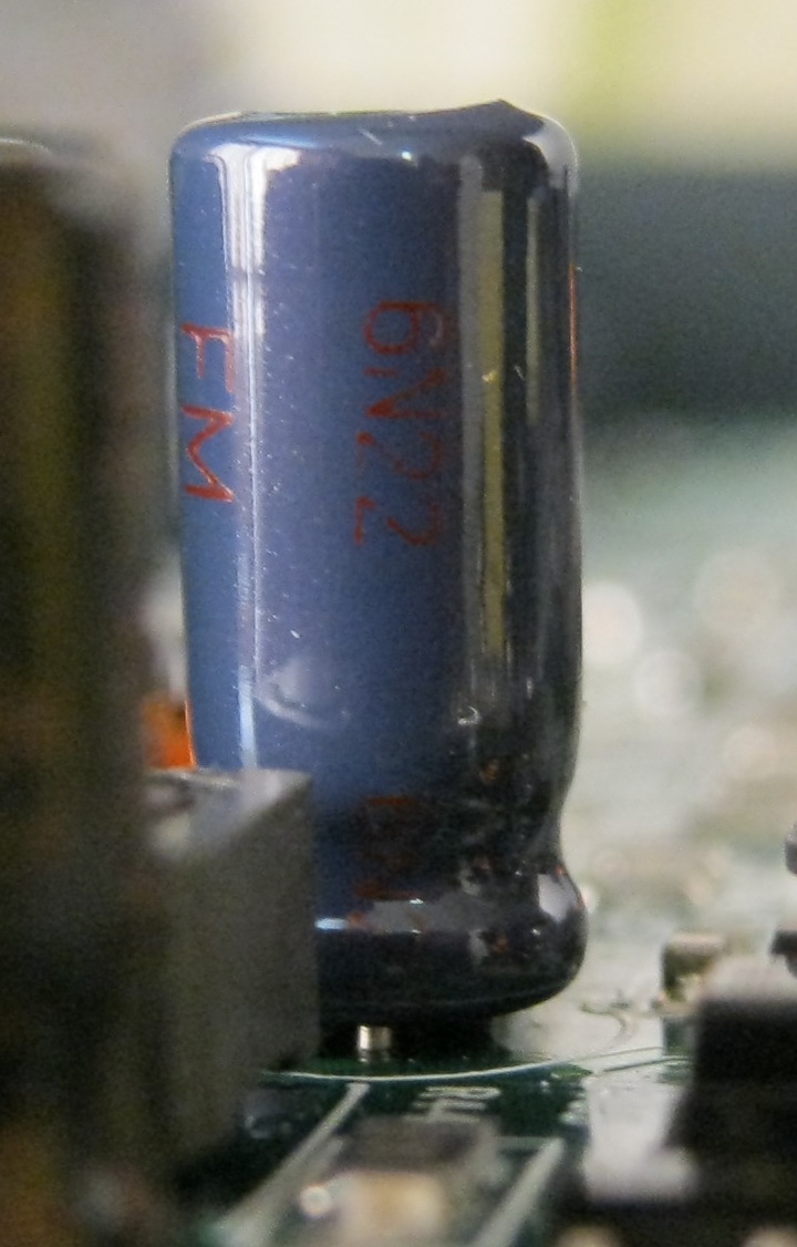

          Is it just me or does the printing on that FC cap look a little cartoony and thus possibly fake?

            It does look strange. I might be able to get a better picture, but my camera sucks. It always focuses on the last object I would ever want to take a picture of.

              Here is the Panasonic FC.
              In case you can't tell, this is what is printed in red:
              6N22
              FM

                Hi all, this is an old thread but I had this device stop working due to bad caps. Recently had a bad lightning storm in the area and the power went out for a few hours. When the power returned, the DSL modem showed the power LED as red so I though the phone lines where out. Long story short, called the DSL provider a couple days later to see if everything on their side was OK, it was, and did a few checks on the modem. They said it needed to be replaced. Figured I'd crack it open and take a quick look and see if anything looked out of the ordinary.
                After opening, noticed two of the caps where bulged, one with some crust. The bad caps where:
                CrapXon 1000uF@16V at position C413 replaced with a Suncon 1000uF@25V
                CrapXon 330uF@6.3V at position C427 replaced with a Matsushita 330uF@6.3V
                Replaced the bad caps with some that I had salvaged from old electronics and the modem is working again. Petty sure that the caps when bad a while ago but did not notice because the power to this device is rarely turned off.
                Just wanted to leave this info here in case someone else runs into this problem.
