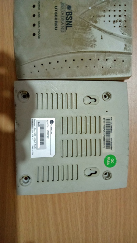

        hi
        please send clear picture of board-label and....

          Re: broadband ut300r2u modem,link light stays on forever
          oh thank you sir, i will send all the pics now

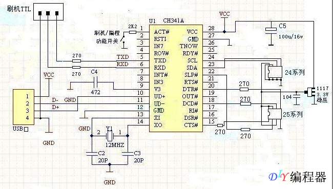

                      can anyone tell me how to use ch431a usb programmer in ttl mode serial , with this modem, i read that this supports ttl mode too.

                                • 31259
                                ch341
                                i have a schem and a chinese picture to help you work it out
                                on one side you have pins 1,2,3 & TXD,RXD,GND,5v
                                TXD,RXD & GND are your connections,
                                to use the board as a programmer you put the jumper between pins 1 & 2
                                to use the board as a serial interface you put the jumper between pins 2 & 3
