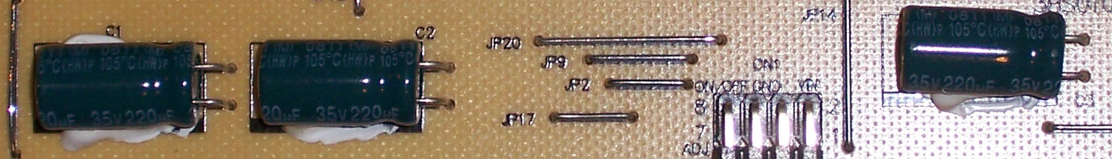

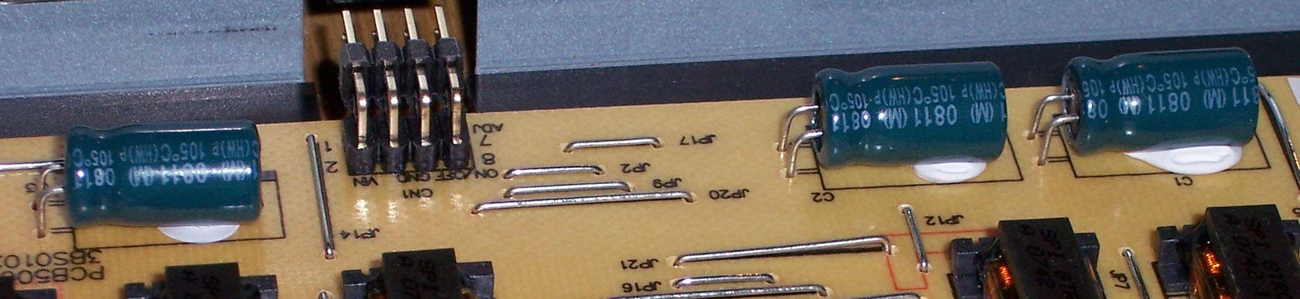

      Originally posted by Magnets
      Please, you can look or photograph capasitors С1, С2, С3 (220uF*35V) that it was visible the vendor and a series?
      Sorry for my English.
      WBR Nikolay.
      • Magnets
        • Jul 2010
        • 11
        Re: Viewsonic VP2030b Flickering
        WBR Nikolay.
        Here's the photos I have of that part.
