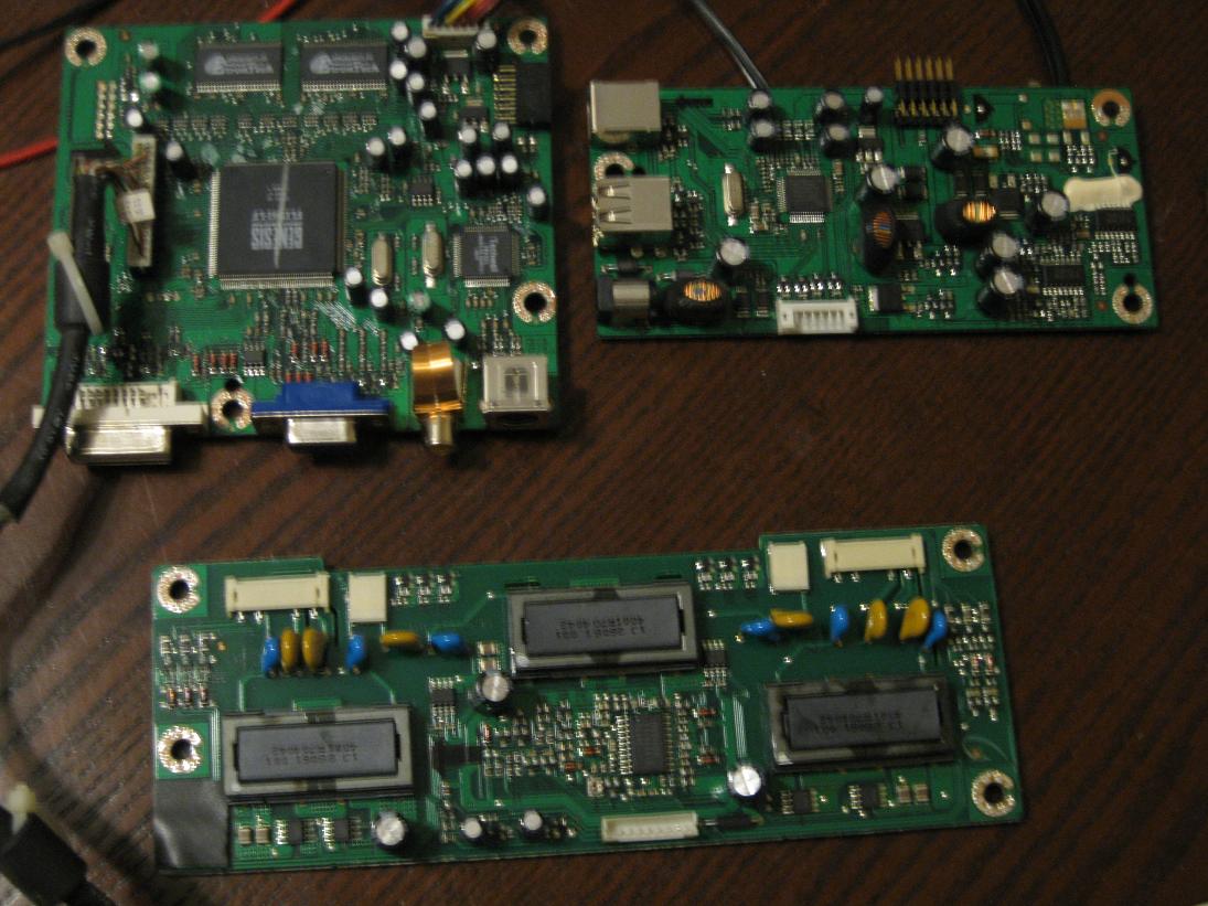

    How are the fuses? How are the caps? Posting some pictures of the boards in question would be a good start.
    • el3ctroded
      • Nov 2008
      • 198
      Re: Dell 2007fpb no power
      Pictures of top and bottom of all PCBs please.

        Some power supplies only output a single voltage and each board uses 78xx compatible linear regulators to produce whatever they need. Pictures of the boards would help us decide how many voltage outputs there should be.

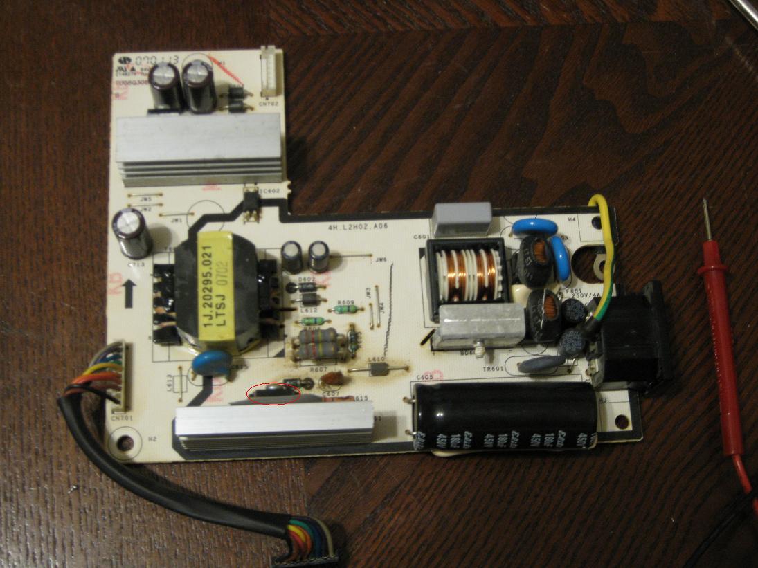

          So while trying to do further testing I accidentally shorted out the board and blew the fuse, after replacing the fuse resistor 613 smoked on me. Of course I did not take pictures before doing all this so I have no idea the correct rating resistor 613 is supposed to be.

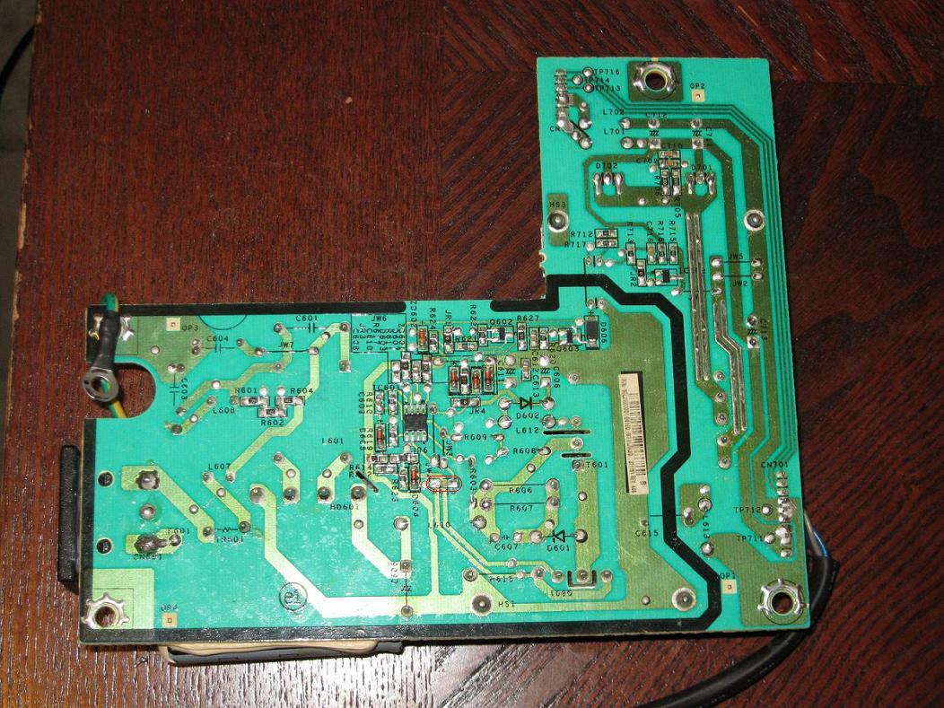

            It seems the PSU board has one voltage rail only as severach suggested, so the fact that you got a single voltage reading means it was working prior to the short.
            Any chance you can get higher resolution pictures of the power supply board? I'm having a hard time locating R613. Might be able to tell what it should be with better pictures.
            Also, how did you short the board (and more precisely, which one)?

                This just makes me mad, Ive discovered that the short also blew out the large mosfet which is what caused the resistor to smoke, I had circled the resistor in red in the bottom image.
                While I was figuring out why on earth the resistor smoked the bridge rectifier also went bad on me. lol I am about ready to toss this whole monitor.
                So in other words my screwing around caused the good powersupply to go kaput and the problem was likely elesewhere.

                  Looks like R613 might have something to do with the voltage supply on the 8-pin IC. Any chance you can read the numbers on that small 8-pin IC?
                  You'll also need to replace the bridge rectifier. Just looks up the number that is written on it, then google it. Should be something rated for close to 2-4A, 600v. Do the same with the mosfet. If you're having trouble finding replacements for these, post their numbers here.
                  Start checking the rest of the components on the primary side. All resistors should read close to or lower than their stated value. If a resistors reads much higher than what it's rated for, it's probably bad. Also check TR601, D602, and R615(?) as those are important.

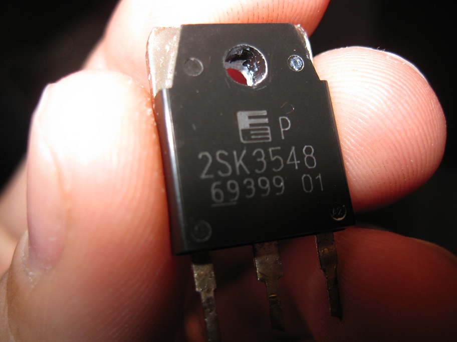

                          Yes the number is correct, the closest thing to the number I can find is 2sk3547 which is some n channel smd, I need a through hole.
                          I'll admit I know next to nothing about mosfets, it is the fellow circled red in the attached image, I'll try to get an image showing all the text on the chip.

                            Here is the mosfet I need a replacement of. Can someone help me?

                              I've tried looking on Google, but so far all websites I visited seem to only re-direct to PDFs for 2sk3547 and similar. Hopefully someone with more experience will see this thread and help you choose a replacement FET. I think the specs that el3ctroded mentioned above sound reasonable.
                              As far as the bridge rectifier - I looked at the GBU and GBJ series on Digikey, and most come with 5.3mm spacing only. Those that come with 7.7mm have the (+) leg with ~10mm spacing. Bending the leads should be okay though. If the heatsink becomes a problem because of this, just remove it as it's not really needed. A 4 Amp bridge rectifier is more than adequate for this monitor and won't produce much heat.

                                The picture help a lot, The manufacturer logo is Fuji Electric Here is a link to there MOSFET they have in production. But I can't find anything on the 2SK3548. Maybe give them a call.

                                      Just received the data sheet on the chip I need, discontinued of course. Got it straight from Fuji Electronics, any help finding a replacement?

                                        Well, I'm no expert at all when it comes to transistor replacement, but maybe these will work? The specs sure look very close.
                                        2SK2968
                                        STW11NK90Z
                                        STW12NK90Z
                                        You can find them on Digikey, but they are all $4-5.
