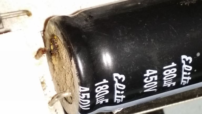

                              Anyway, I have a Dell 2007FPb with no power. Examination of the power board quickly showed that C605, the big 180 uF 450 V electrolytic is dead. The + lead was corroded clean through. Also, the main 4A fuse, F601 is open. Naturally I did not have either of these parts in stock. So while I'm waiting for them to arrive, any suggestions on what's possibly going on here? Is it likely that the cap just failed and then took out the fuse, or did something else downstream kill the cap? Thanks!
                              (The other electrolytics on the board looked good and tested OK on the ESR meter. There are no obvious burn marks anywhere on the board, front or back.)

                                  While we're at it, here's what that fried capacitor looked like. The positive lead is eaten clear through. That's one Bad Capacitor.

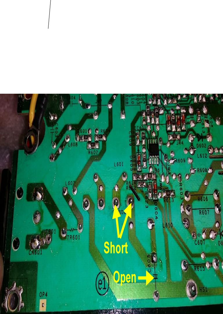

                                    Well I kinda feel like I'm talking to myself here, but here goes anyway. I checked the bridge rectifier on the power supply board but didn't find any shorts there. However, I noticed a third heatsinked part, a three terminal jobber called BD601. The right hand terminal is connected directly to the burned capacitor. And it is a dead short from that terminal to the center terminal of BD601. That doesn't seem right. I'm going to take a wild guess that I need a new one. And of course, Mystery Part BD601 has no visible markings on it.
                                    So can anyone tell me what a BD601 is? Pretty please?

                                      OK, I am a little confused, the pictures show the 4-pin device which is the Bridge rectifier BD601, but you said you did not find any shorts ('I checked the bridge rectifier on the power supply board but didn't find any shorts there')
                                      The two inner pin are for incoming AC, the two outer are the + and - output, the left pin in your picture is the negative leg which goes to the negative leg of the main filter cap, the one on the right is the positive which is connected to the positive leg of the main filter cap.
                                      Right now you reading shows that you have shorted Bridge rectifier, you need to remove it off the board. There is P/N printed on that bridge.
                                      Did you also check the power MOSFET?
                                      Also the AC inlet CN601 Neutral pad looks like jumper is removed? I see empty hole on the pad.

                                        Oh duh! No, you're not confused, I'm confused. I checked a square four-pin SMD called IC602 near the top of the board. I thought that was the bridge rectifier. Then I noticed BD601 but thought it only had three pins - it was hard to see the fourth pin hiding down the end of that thing. You are quite correct - BD601 is clearly the bridge rectifier and it's shorted out. Unfortunately, whatever markings it had were vaporized and it's just blank now. It's really hard doing all this without a schematic.
                                        The hole at CN601 is where I pulled the blown 4A ceramic fuse - good eyes. I'm still waiting for my new fuse and cap. I guess now I need a rectifier too. At least the problem is looking more clear now. The rectifrier went south and applied AC to the electrolytic. That did its best to protect the fuse but it was all in vain and they both finally gave up the ghost.

                                          I pulled the bridge rectifier. The writing was on the back side. For future reference, it is a Vishay Seminconductors GSIB4A60, a 4 A 600 V rectifrier. This part is apparently obsolete and superceded by a GBU406. Widely available and cheap. I'm somewhat surprised they used such a high-rated part, and heat-sinked at that.
