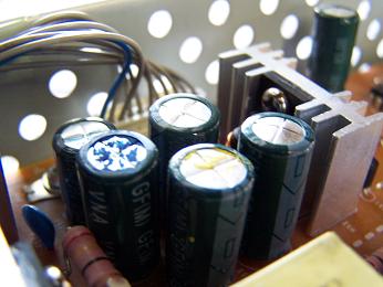

    New here, I found a post on the same issue i have. I got a LG Flatron L1933TR for free and would like to fix it. It's not getting any power at all. I assume it is the cap issue that others have. I saw the list of caps in the other thread, but where do i go about ordering them? I tried to look them up on the digikey site, but in not really sure what to get as I am new to this.
    Values are as follows:
    C202: 25V 1000uF
    C203: 25V 680uF
    C204: 16V 1000uF
    C205: 16V 1000uF
    C206: 25V 1000uF
    C207: 25V 470uF
    C103 is also a GF, 50V 33uF.
    Any help on where and how to order these would be appreciated.
    Thanks,
    Greg

    Two ways to do this. In either case, start by measuring the diameter of all caps that are in 'close quarters'. Also, measure and determine the highest capacitor that will fit.
    You can follow this procedure to select appropriate caps. I suggest you post your selections so someone can review your choices. Speaking from experience, it is embarrassing if the repaired monitor works, but you can't get the back on because a cap was too high.
    Alternatively, once you have appended the dimension information someone will look up the appropriate caps.

      Before you order the caps, did you look to see if any were bloated or leaking?
      I had one monitor that had no power and all the caps looked good. So I looked at the backside and noticed poor solder joints on the main AC input connector. I resoldered and it fixed the issue.
      I left the old caps in.

          Have you checked that the board receives power? I mean, AC is getting to the Big cap? besides caps, you may have a blown fuse or a shorted Bridge rectifier (that in turn would blow up the input fuse ...)

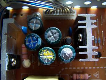

            Neighbor tossed a flatron 19 inch monitor. My wife picked it up. I came here and got info on bad capasitors and now i have a working lcd monitor!
            I kept putting off buying a new monitor because my 1996 17 inch crt is still kicking, but for $11.98 i have a nice lcd now.
            Thanks to all who helped!!

                      Thank you for posting that information. One of the caps on the main board does seem to be buldging at the top. In the included pictures it's the cap on the lower right, closest to the heatsink (it's a Samxon 1000uF 16v cap). Could that cap be causing the problem?

                        Yes, it's probably the cause. It sitting so close to the heatsink didn't help any. While your at it, you should go ahead and replace them all. Use Panasonic FM series from digikey.com and select USPS First Class postage for the best rate.

                          That could be it. The recommended procedure is to replace ALL the caps. The one you indicated is in a bad location (next to a heat sink), however there is no reason to believe the others are in perfect shape.
                          As an example from nearly two years ago, I had received a 17" Gateway monitor with the classic 'won't start' problem. Opening it up, I found most of the capacitors were bulging, so I replaced them. After spending $15 for caps and shipping, the monitor still wouldn't work. After tearing my hair out, searching the internet, etc, I found a reference on this site that indicated the problem was the 22uF, 100 volt cap that 'never fails' - one of the three caps I hadn't replaced. It didn't take long to figure out I never wanted to repeat this experience.
                          'Not turning on' can be caused by several bad caps such as the one you identified. Or they can be caused by a single $.25 cap.

                                        I just finished fixing an L1933TR I picked up at a recycle shop for $10. Nice monitor, well worth the effort.
                                        I replaced three of the power supply caps; a 1000uf/16V (used 25V), a 680uf/25V (used 1000uf/25V) and a 470uf/25V. When I put the monitor back together, the backlight came on but the video (graphics) did not.
                                        I pulled the small green computer board (next to the power supply board) from its mounting and reheated all of the connections on the white dual-row video connector (underside of the PCB) near the center of the board. I also reseated the flat connector that slides into the socket on the lower edge of the large LCD panel.
                                        This time, when I applied power, the monitor worked perfectly; I'm using it now.
                                        I suspect we will see more of this reheat-to-fix in the future, as the RoHS solder joints begin to deteriorate. Just one more thing to check when we fix up these orphans...
