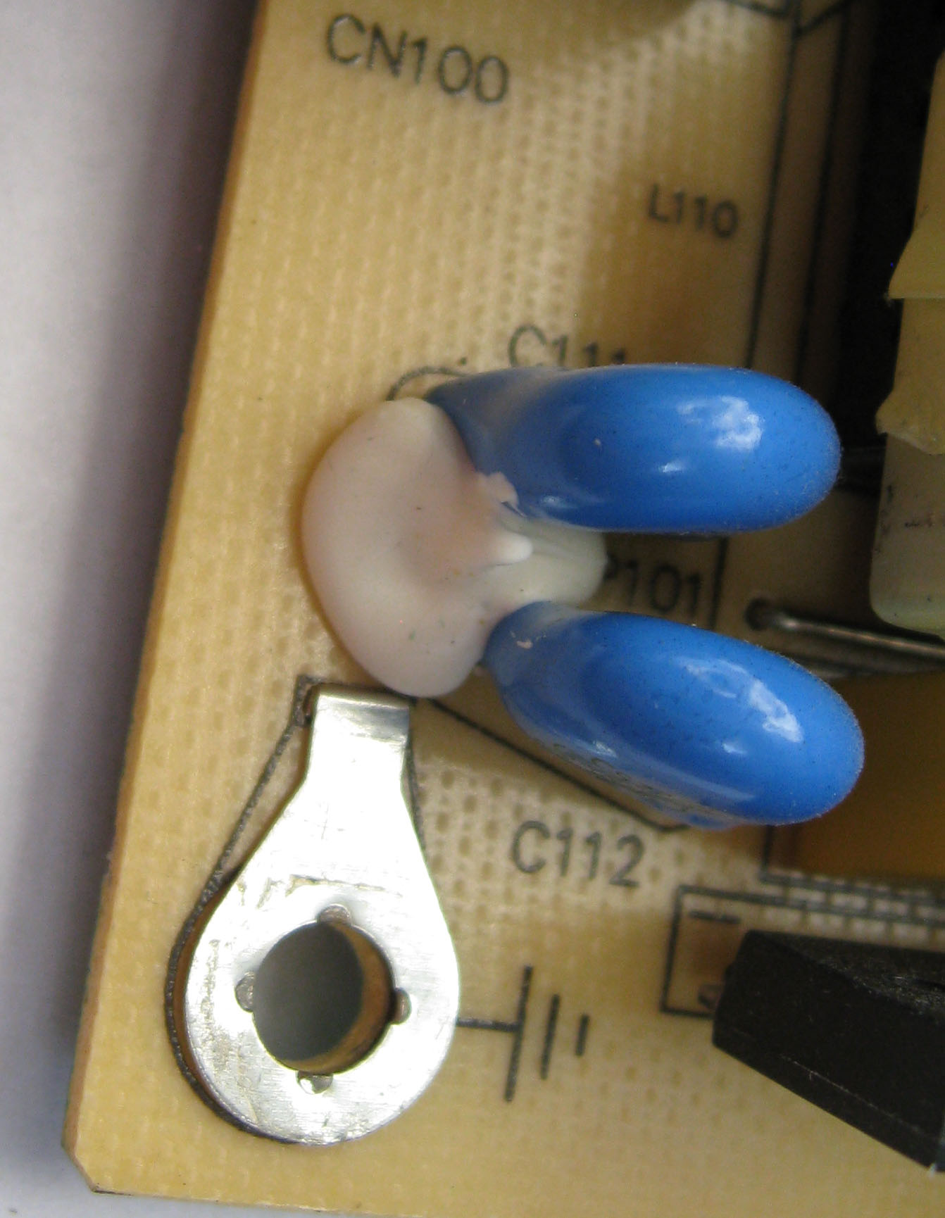

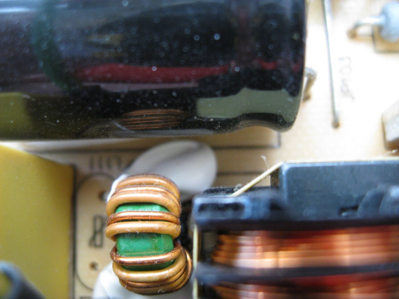

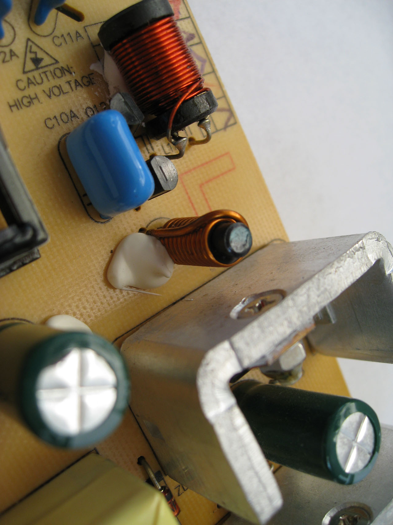

                                    Hello everyone. Thanks for all the friendly expert help and guidance you guys give.
                                    I too have the Sceptre X22WG-Gamer with the FSP050-2L02 power board bad capacitor problems. I'm not an electronics expert but am handy enough with a soldering iron that I think I can get this done.
                                    Before I order my capacitors, my question is, should I go ahead and order replacements for the blue ceramic dipped C111 and C112 capacitors with the white gunk oozing around them (and the others like the coiled ones I've shown in the attached photos) or should I just replace the C551 and other bulging radial electrolytic capacitors (like the ones included in the eBay kit)?
                                    I don't know enough about this to know if that ooze is normal or what.
                                    Thanks!

                                      The white gunk is glue, not electrolyte. Nothing to show that those components have failed.
                                      Do you actually have any bulging capacitors?

                                        Thanks Sean. Yes. The CapXon 470uF 25v C551 and C552 are definitely bulging. C554 and C664 don't show anything obvious.
                                        Neither of the Taicon 16v 1000uF 637(M) capacitors show any bulging on the tops, nor does the little CapXon 33uF 35v.
                                        • seanc
                                          • Nov 2008
                                          • 1319
                                          #80
                                          Re: Sceptre x22wg-Gamer 22" LCD
                                          You're best to replace them all, including the small one, following the recommendations in this thread.
                                          If the large capacitor isn't bulged, you can leave it alone.
