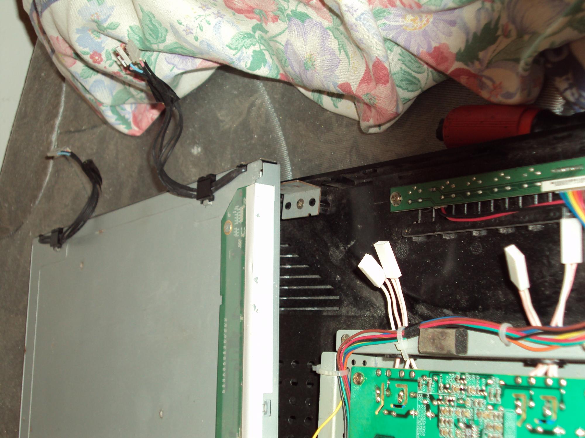

    Hello Everyone!
    Noobie here. I just Googled and came across your site which is very informative. I am trying to understand some things and know a little about others. I have just replaced my 2 bad caps "after over a year after taking it apart". I am attaching pics to figure out the dark spots on the back of the PSU, and I need to know exactly how the 4 (Pink and white)cords attach to the monitor into the other 4 cords wrapped in black tape.

      Dark spots: This is the AC input to the bridge rectifier. The only idea I have is that poor solder joints were overheating. I'd remove the old solder and resolder.
      Four cords: They go back togetherlike they were originally. You didn't label them?
      OK!! OK!!! When the power supply is sitting on the back of the panel, the pair from the top of the monitor go to the pair from the top of the power supply. It doesn't matter which way the two pairs go together.

        Thanks a lot. Works like a charm.

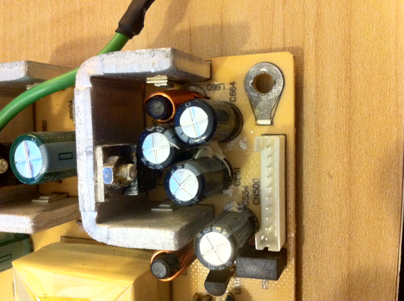

          Hi, my monitor would not power up at all, no indicator lights at all. Just prior to that, the led indicator would blink really slow interval, no display.
          I seem to have the bulging C551 and C552. Start by replacing these?
          Also, before I was just using the VGA as the DVI had a red tint to it. By the time I called support, I was out of warranty. Any ideas on that, now that I have it open?
          Many thanks in advance!

            The recommendation is to replace all the electrolytic caps with the possible exception of the large (100uF, 450 volt) one. Use low ESR name brand caps, not junk from Radio Shack.
            A red tint is often the result of failing CCFLs, but since it only appears on the DVI input, that is probably not the issue in your case. Have you tried adjusting the tint using the menu?

              Hi PlainBill, thanks for your response. I am planing on P12389-ND from Digikey. Is it just those 4? C551, C552, C554, and C664?
              I could not correct the red tint with adjustments. It was almost as if you had 2 of the 3 cables plugged in on a component video connection, like that. VGA worked fine though.

                There are three more that you are ignoring. The small one next to the SMPs transformer is very important. If it fails, the power supply won't start. And in that location it gets plenty of heat. There are two for the inverter that should also be replaced.

                      No. Here is my philosophy.
                      Let's take an extremely simple case. Take a monitor off the shelf, do a quick test, it doesn't work. Open it up, notice one cap is bulging. Replace the cap, test the monitor, it works, put the monitor together again. Elapsed time - 1 hour and $1.00 of parts.
                      Now most of the caps came from the same company, or at least are of the same quality, and have been exposed to the same temperatures and similar stress. Replacing all of the caps would have taken an additional half hour, and an additional $5 in parts.
                      Some of the monitors I repair are given to family members, but most are sold. Let's take the best case - I give one to my 12 year old Granddaughter. Now she's a bright young lady, she knows Grandpa makes mistakes. If the monitor dies in the next year or two she would politely ask me to fix it when I got a chance. Which means I would make it a priority job. And I would be looking at another hour long job to replace the next cap that died.
                      A much worse case is if I had sold the monitor. Even with an ESR meter, I can't tell how long a cap is going to last. In particular, the small 22 - 68uF startup cap will fail without warning or visible signs. Now if a monitor I sold in the past month dies, I have a very unhappy customer who at best will insist I repair it FAST, and will probably badmouth me at every opportunity.
                      In either case, it's worth half an hour of extra work and $5 in parts to make sure it's fixed the first time.
                      Note the critical parameters - capacity, voltage, diameter, and height and I'll recommend suitable replacements.

                          1 million thanks! I am back up and running after replacing the 7 capacitors, under $5 total.
                          The 7 items from Digikey were:
                          1 - 493-1575-ND
                          2 - P12366-ND
                          4 - P12389-ND

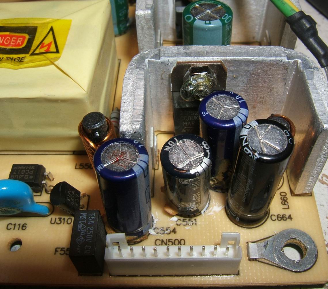

                            Connector CN501
                            1,2,3 5v
                            4,5,6 Ground
                            7 CCFL control
                            8 CCFL control
                            9,10 12v
                            U1: Beyond Innovation BI3101A Technology dual PWM CCFL Controller
                            U220: System General SG6841SZ PWM C114:160v/320v -> Q100 -> T100 -> D660:12v, D550:5v
                            Q100: Fuji 2SK3502 N-MOSFET
                            C114: Taicon AQ 100uf 400v WV=160v/320v 13x31
                            C210: CapXon GL 33uf 35v 5x10
                            U300: Sharp PC817 Optoisolator
                            U310: KIA431A Shunt Regulator
                            C1, C661: Taicon HF 1000uf 16v 10x20
                            F550: Fuse 5A 250v
                            D660: ST STPS20H100CT dual diode 100V power Schottky rectifier
                            D550: ST STPS2045CT dual diode 45V power Schottky rectifier
                            ZD661: 1N4??? Zener Diode
                            D114: ?N539? Diode
                            D220: Taiwan Semiconductor FR1? Diode
                            Q12A, Q11A, Q12B, Q11B: Hi-Sincerity HSD965 Transistor
                            T1A, T1B: SPI 8TC00291 CCFL Transformer
                            L1A, L1B: 8LR7020 Inductor
                            D1A, D1B: SS24 SMD Diode
                            I fixed this and it failed within 3 months after service #1 when a Nichicon PM at C551 reached 49 ohms ESR. On service #2 I had hoped to increase reliability by using some higher endurance caps. I left a cheapo in.
                            C664: Rubycon ZL 680uf 16v 8x20
                            C552: LTec LZP 470uf 10v 8x12
                            C551: Panasonic HFA 680uf 10v 8x15
                            C554: UCC LXY 680uf 10v 8x18
                            D550:5v -> C552,C551 -> L550 -> C554 -> F550
                            D660:12v -> C661 -> L1 -> C1
                            D660:12v -> C661 -> L560 -> C664
                            Here comes service #3. It's my monitor so the many service attempts is educational and not a problem. This time I was using it when I heard the cap pop. The monitor continued to work. I quickly open it up to see that the Ltec C552 has blown. Better caps are in parallel which allowed the monitor to continue working. Heat sink HS550 and all the caps inside it were very hot which is why this monitor eats weak caps faster than your average electronic oven. Only very high endurance caps should be used. Up to 20mm caps will fit. Taller caps usually are higher endurance so the taller the better. Here are some high endurance caps.
                            3000 hours 8mm Rubycon ZL
                            4000 hours 8mm Rubycon YXG
                            5000 hours 8mm UCC LXY
                            6000 hours 8mm 6.3v UCC KY
                            2000 hours 8mm Panasonic FC
                            2-3000 hours Panasonic FJ (based on height)
                            3000 hours 8mm Panasonic FK
                            3000 hours 8x15 Panasonic FM
                            4000 hours 8x20 Panasonic FM
                            6000 hours 8x11.5 Panasonic FR
                            8000 hours 8x15 Panasonic FR
                            9000 hours 8x20 Panasonic FR
                            No more Mr Nice Guy. The other caps are fine. For the blown cheapo in goes the toughest thing I have. Maybe it will last this time.
                            C552: UCC LXY 680uf 10v

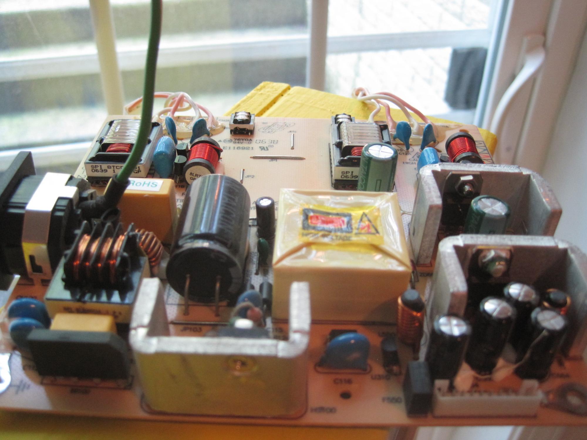

                                        My caps are poped up also. Can I use a 470uF cap thats is 35v to replace C551 and C552?

                                          Did some reading and found that 35v was fine. Monitor works like a camp now. Thanks for all your posts and help.
