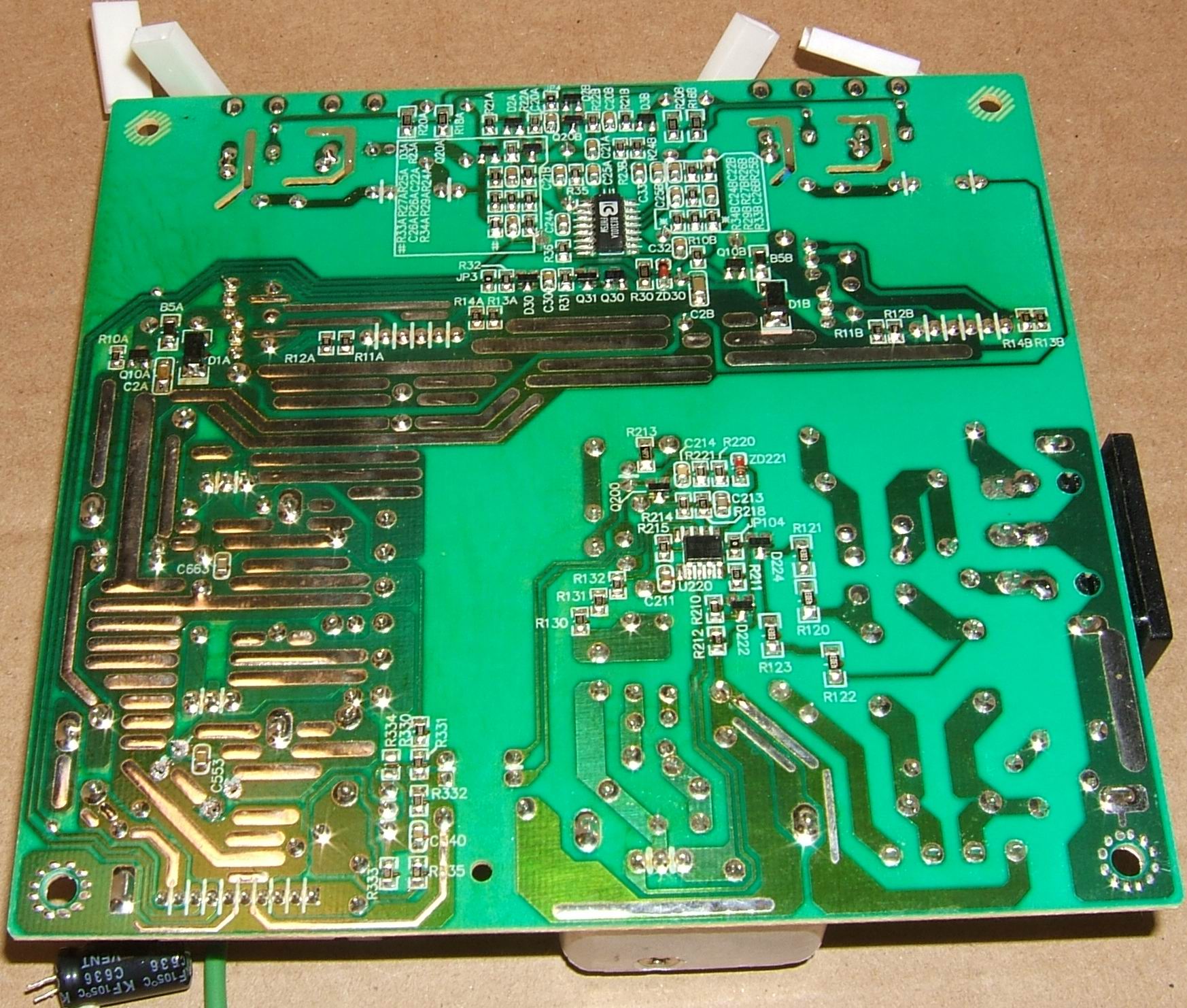

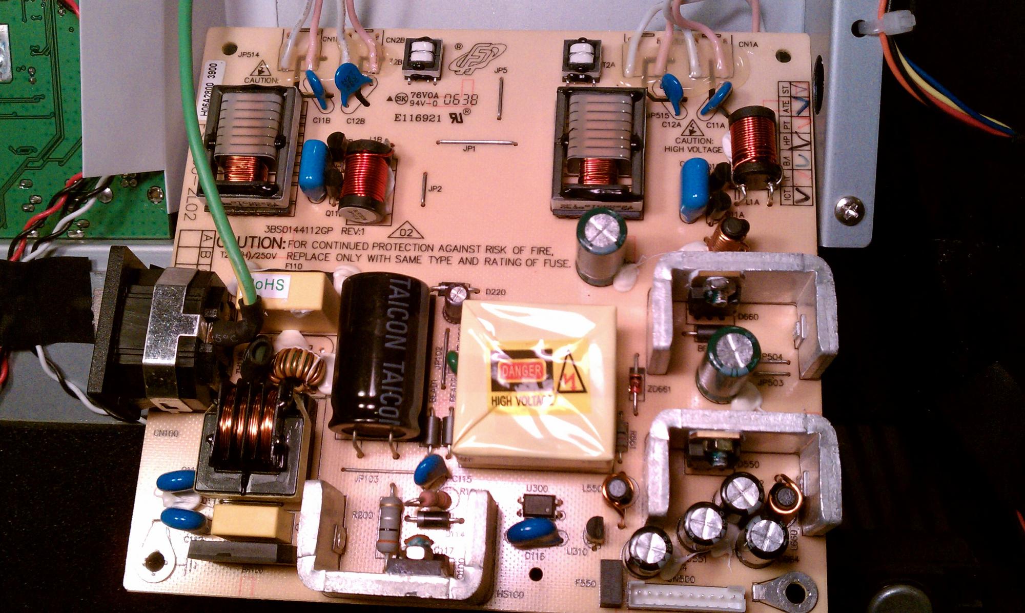

    Power Supply: FSP050-2L02 3BS0144112GP REV:1 E116921 K3502 2SK3502 SG6841SZ BI3101A
    Video Board: AL012 REV.1 MTK810NGD MST9251DA-LF-165
    Inverter Transformer: SPI 8TC00291
    Another revision of the FSP050-2L02 uses a set of 4 transformers similar to the SPI 8TT00006.

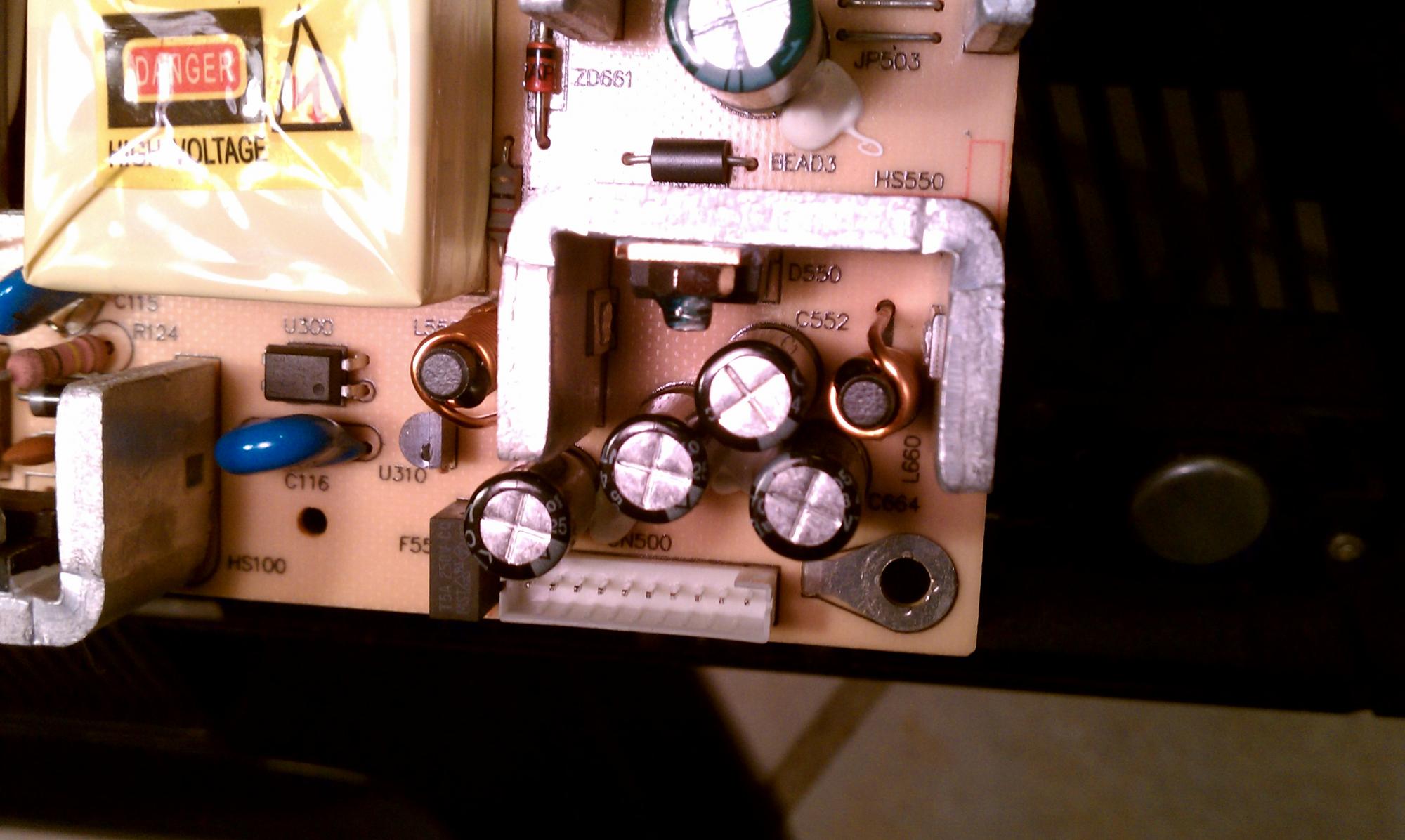

    Bulged caps on power supply:
    C551, C552: CapXon 470uf 25v (runs at 5v, good ESR=0.05, bad esr>=1.1)
    Other caps that did not fail yet:
    C664: CapXon 470uf 25v (runs at 12v)
    C554: CapXon 470uf 25v (runs at 5v)
    C1, C661: Taicon 1000uf 16v (runs at 12v)
    C210: CapXon 33uf 35v (runs at 12v)
    The video board has a dark spot near C37. C37 tests good.
    C37: Jackcon 47uf 25v, esr=0.06 in circuit, esr=1.1 out of circuit

      Do you have the same symptoms as picture 5?
      If so, now's the time to learn how to repair it!

          Yes, please take clear photos of your power board.
          If you look at picture 5 in the original set of pictures, you can see that 2 of the capacitors (tall cans with X on the top) have bulging tops.
          These items can be replaced and will usually result in a working monitor.

            As far as the caps go, they ALL look fine, and I can't see any bad spots on the back of the P.S. Mobo... Not sure what else it could be, you see anything???

              There seems to be a hole in the top of U310, which may suggest that it's dead.
