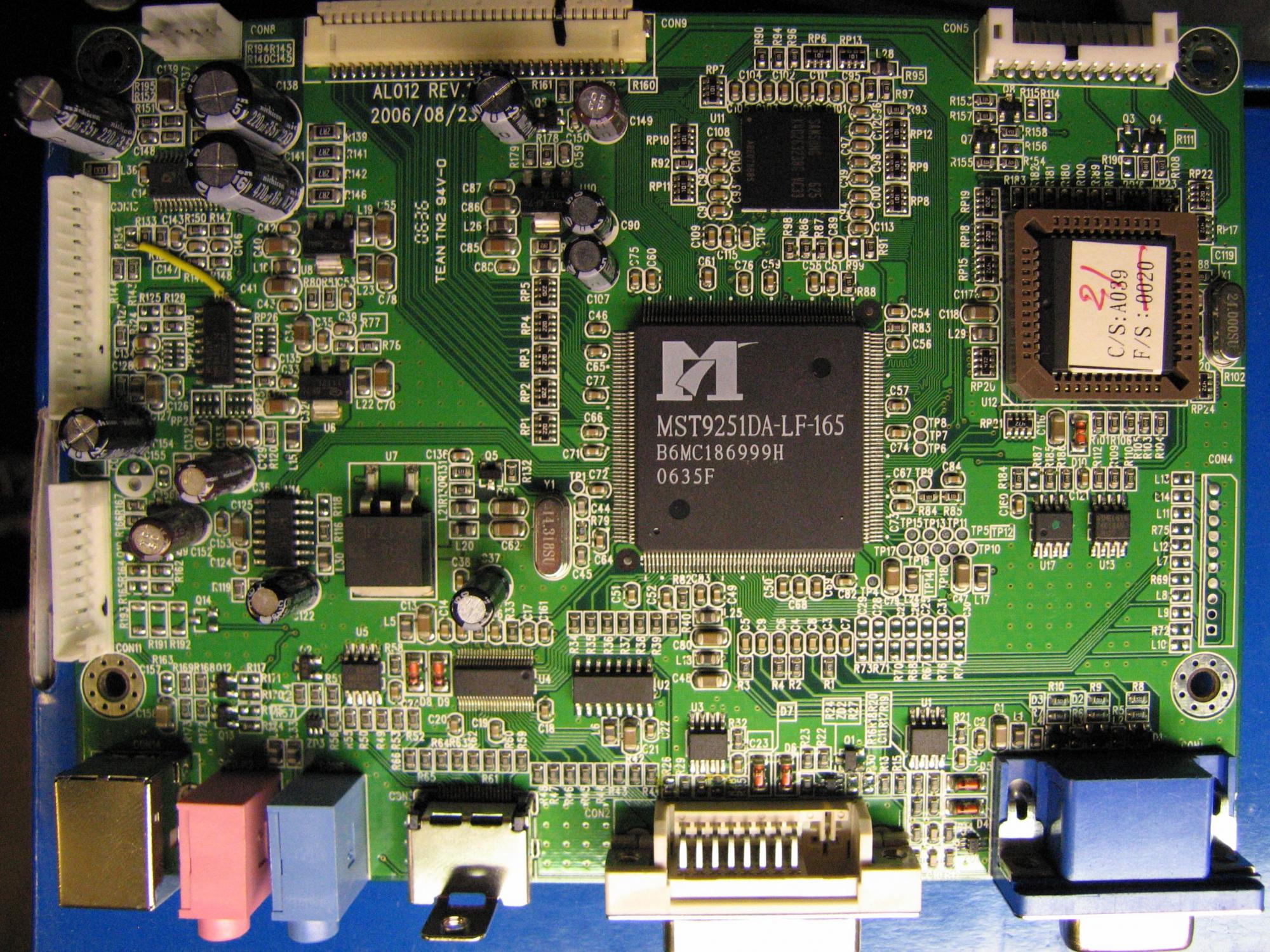

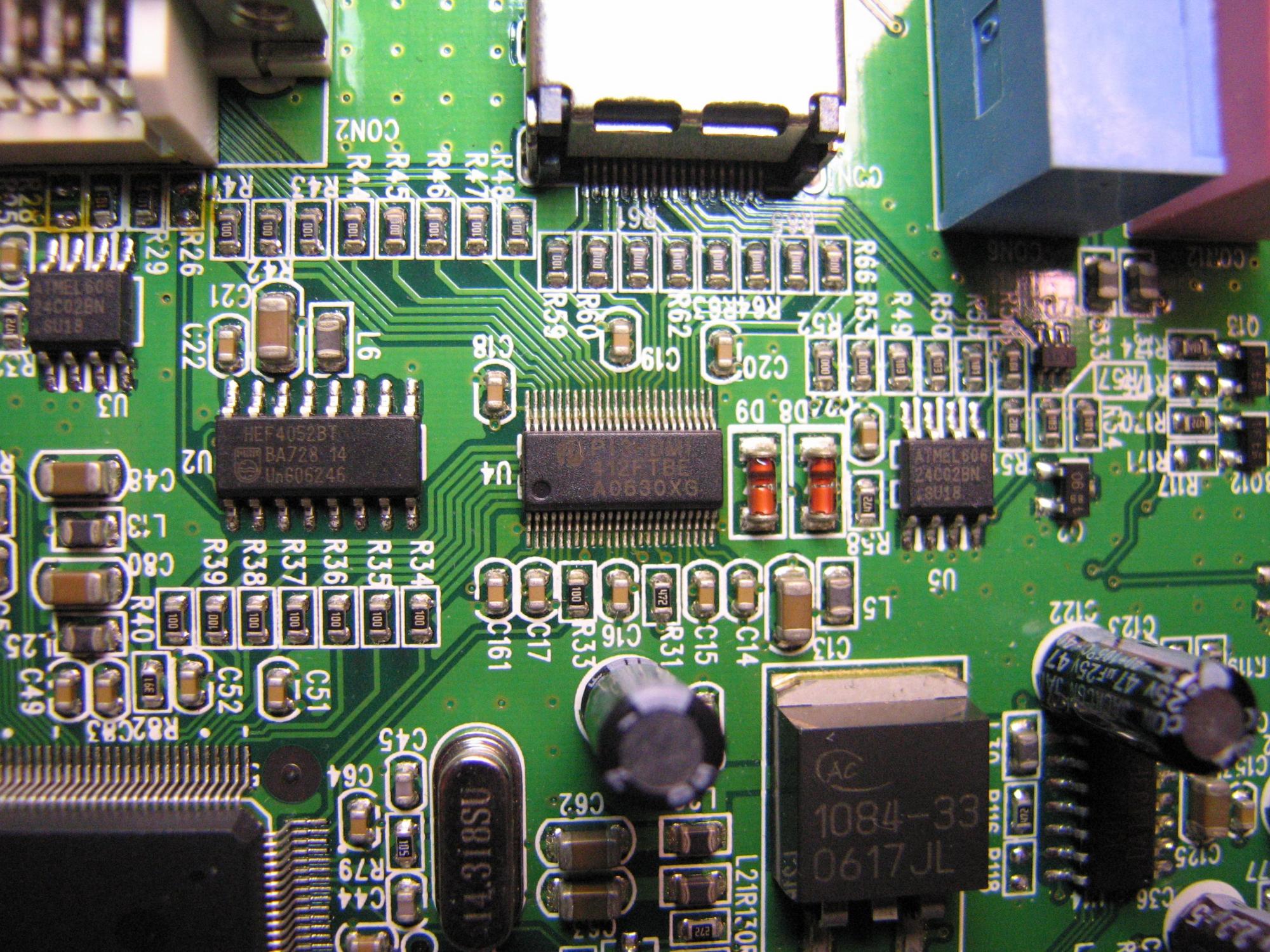

                Re: Sceptre x22wg-Gamer 22" LCD
                Ok so here's the logic board and a closeup of the chips.
                The IC behind the HDMI port reads PI3HDMI 412FTBE.
                Datasheet
                The IC behind the DVI reads HEF4052BT BA728 14
                Judging by the logo, it is a Phillips part.
                This is a bit encouraging. Since both the DVI and the HDMI went, it seems to me the ICs are probably ok, and something minor that is driving them has failed.
                Bill, I'm not sure where to probe with my multimeter, can you give me some helpful hints?

                          This is almost too easy. Excuse me while I slip into lecture mode.
                          The two ICs serve similar functions. Both are multiplexers - they select from one of two different sets on inputs and feed them to the outputs. The HEF4052 is old technology - 1970's CMOS, and is the equivalent of the Chrysler Airflow. PI3HDMI412FTBE is specifically designed for HDMI. It would be the equivalent of the Bugatti Veyron - if the Veyron could hit 5 Gbps.
                          The relevant information - HDMI is an upgrade of the DVI standard. It drops the analog capability of DVI and adds digital audio signal lines.
                          Check the power supply voltage(s) for the PI3HDMI412FTBE on pins 1 and 48. (There are many more pins, but those are easily probed - it's a 48 pin IC). The dimple is pin 1.
                          One other point - an earlier post mentioned 'fixing the x22wg from the menu'. Make sure the DVI and HDMI inputs are allowed - it seems strange that they wouldn't be, but....
                              So 1 probe on pin 1 and one on ground?
                              I checked the debug menu and I didn't see anything in relation to this.
                                    Black probe to ground, check voltages at pin 1 and also pin 48 when monitor is plugged in.
                                        PlainBill
                                        When the monitor is on and the CFLs are lit:
                                        Pin 1: 0.03
                                        Pin 48: 4.92~4.93
                                        When the CFLs turn off and the screen goes into standby:
                                        Pin 1: 0.01~0.02
                                        Pin 48: 4.94
                                        I have everything plugged in besides the data cable to the LCD panel inverter to take the measurements. Is this sufficient or should I instead plug that in, and attempt to draw a voltage off the CFL connectors while it is running and then test pins 1 and 48? And if so, what's your preferred method of drawing power from CFL connectors witout actual bulbs?
