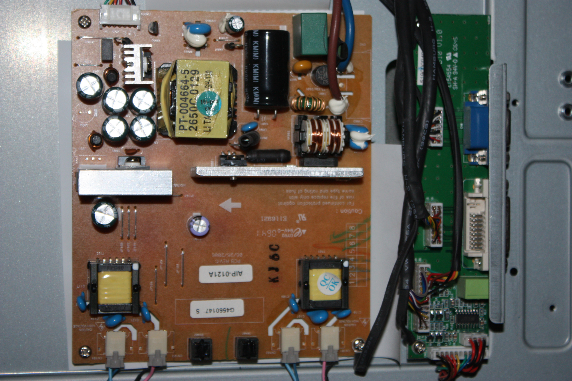

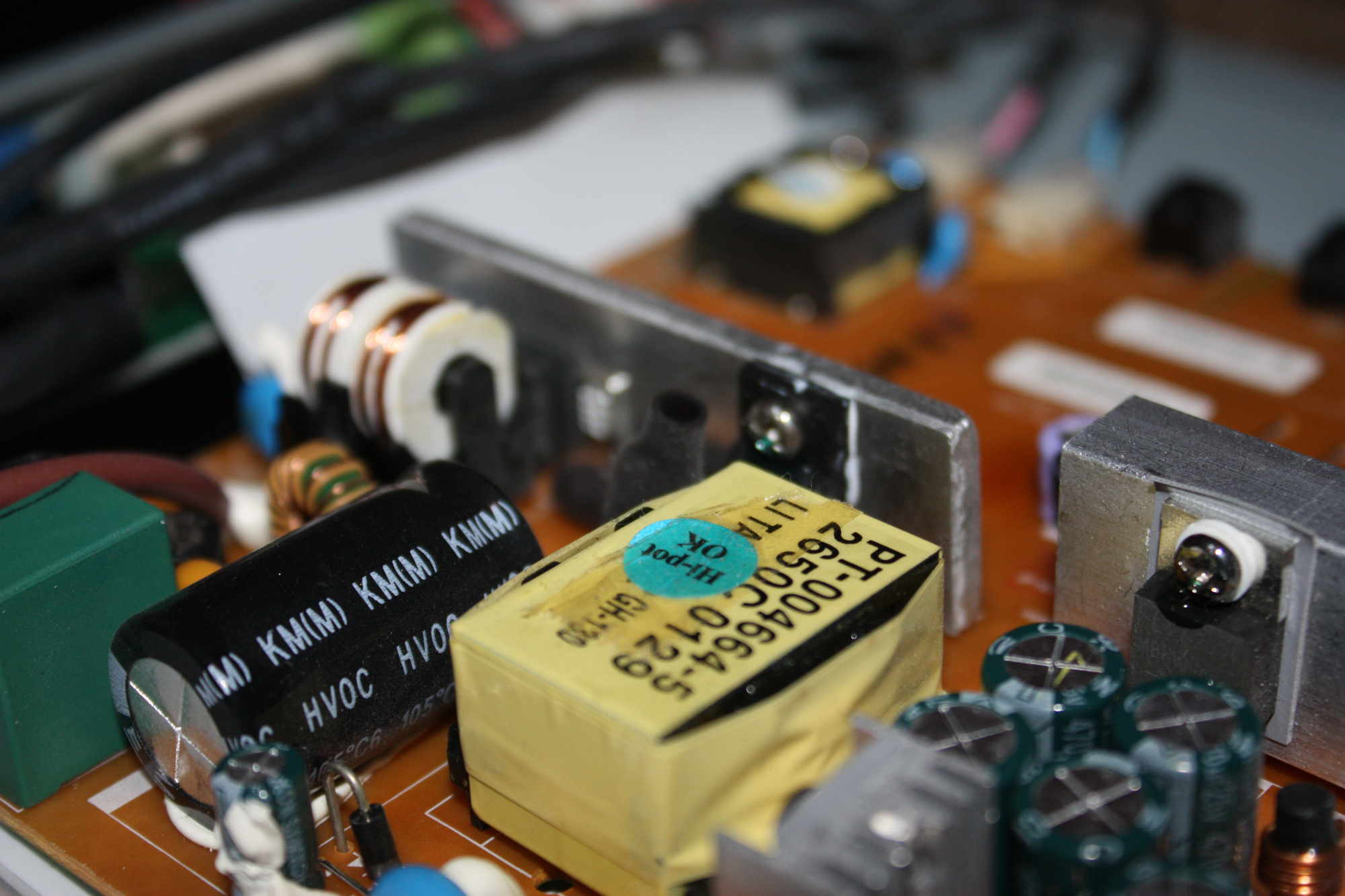

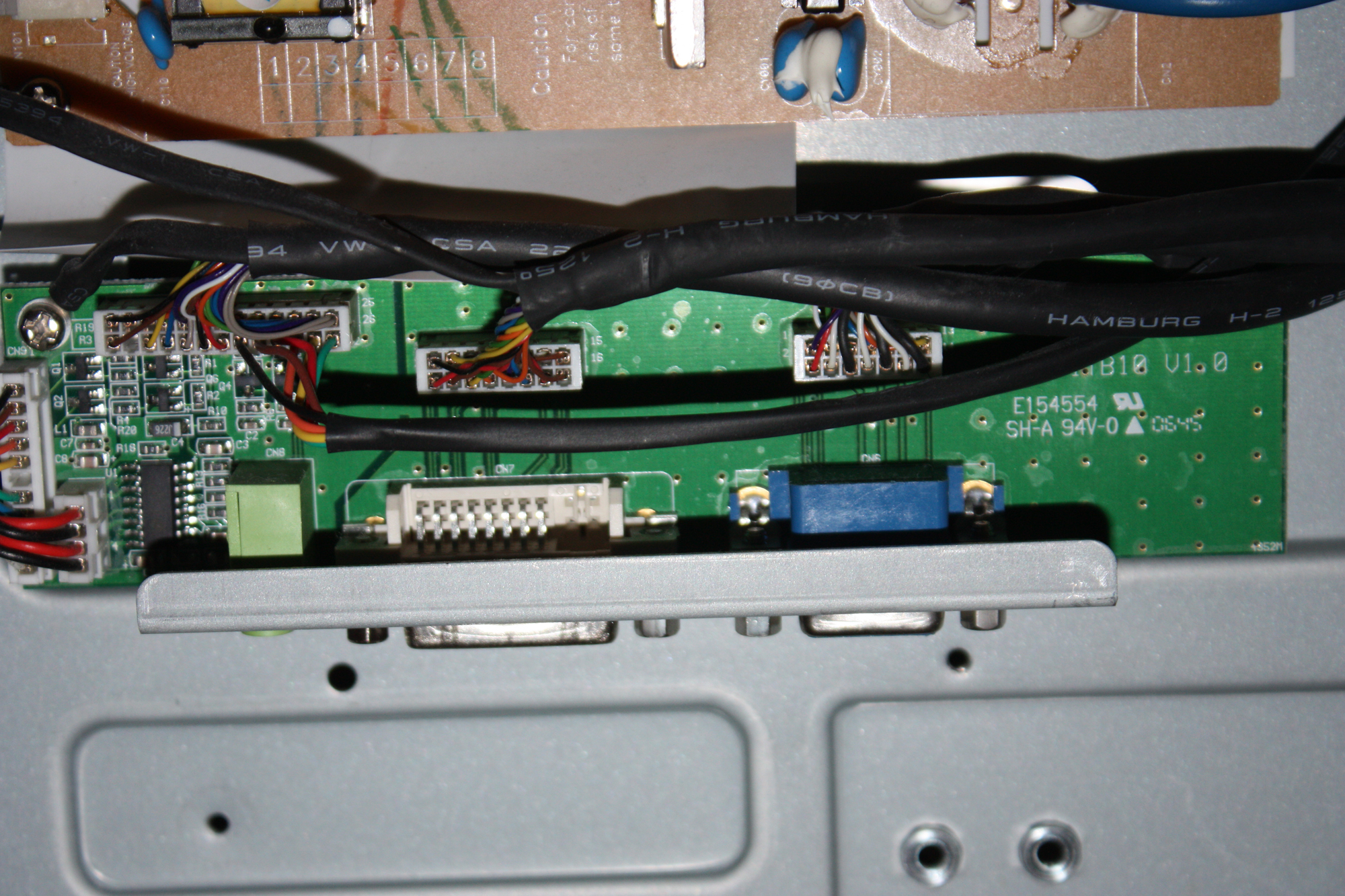

              • FreshPancakes
                • May 2011
                • 2
                Re: Sceptre X20WG-Naga inverter problems
                Thank you for responding so quickly. I've uploaded pictures from my monitors motherboard. Nothing looks fried or altered. I'm puzzled.
                • PlainBill
                  • Feb 2009
                  • 7034
                  Multiple problems, any of which make me want to scream in frustration.
                  1. I see a power supply / inverter. There is a connector at the upper left corner that MAY have a legend identifying the pins. That legend is unreadable.
                  2. I see a board on the right that appears to be an input board, with cables running everywhere. I don't see where those cables go.
                  3. The is no sign of a signal processor board.
                  Identify the pins on the connector in the upper left. With the power cord plugged in, measure the voltage from ground (the mounting screw near that connector) to each pin on the connector.
                  Provide a clear picture of the signal processor card.
                  PlainBill

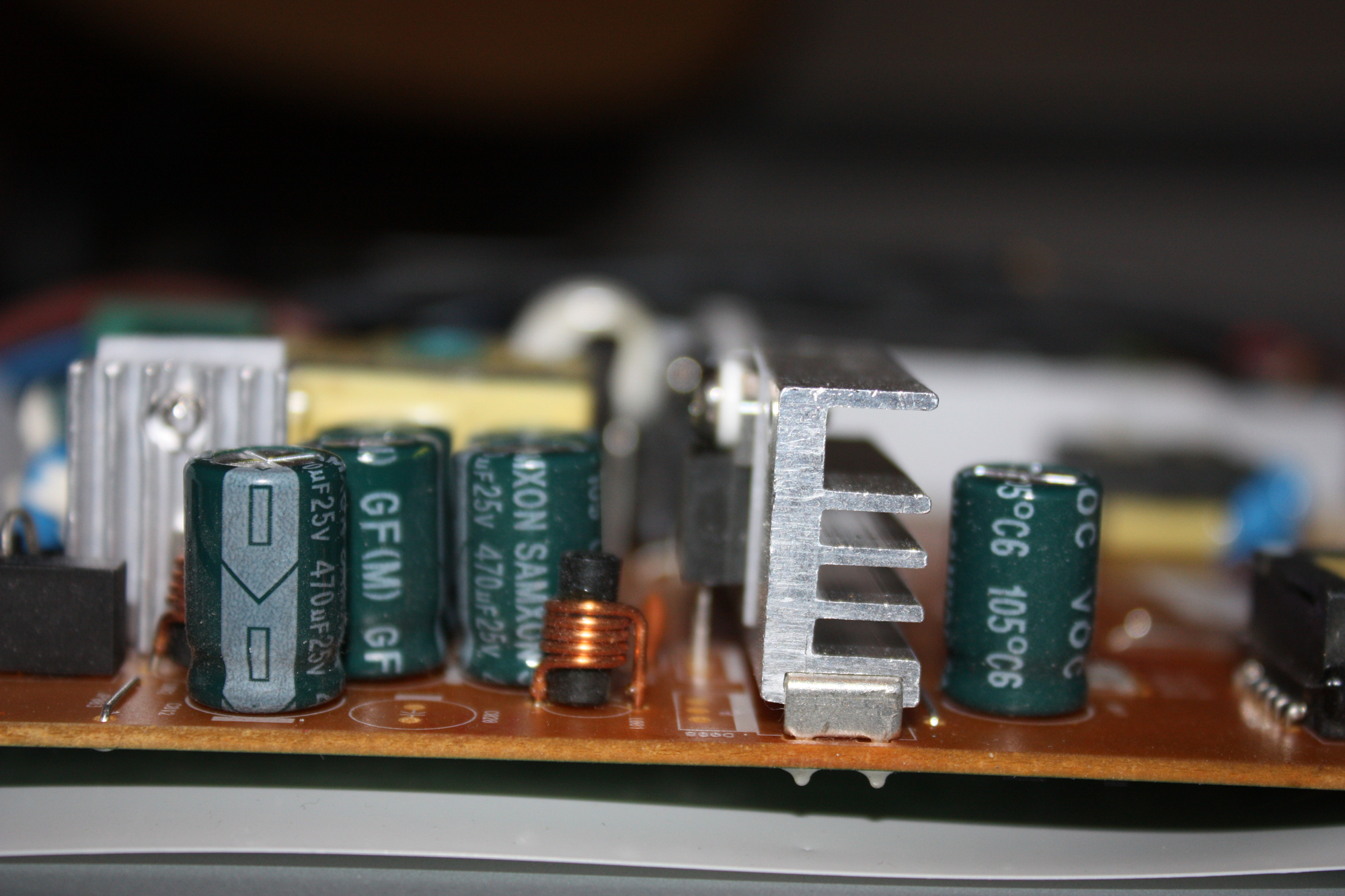

                    I'm not saying this will solve your problem, especially without seeing the voltage measurements as suggested by PlainBill above, but the Samxon GF caps are a problematic series.
                    Samxon makes good caps, but the GF series fail often without signs of bloating.
                    So do the voltage measurements first. If they look okay and we have exhausted all other alternatives (checking the voltage regulators, etc), then I would suggest replacing all the Samxon GF caps.
