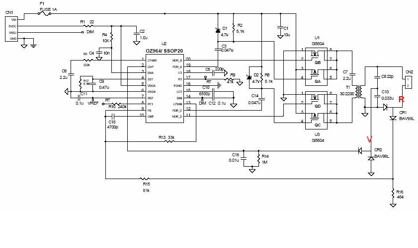

    First, what you describe happens rarely. Most inverters monitor the voltage across and the current through each CCFL. The inverter will shut down if either goes out of limits. A more common cause of shorted transistors seems to be bad solder joints. Of course, a design that does not measure current could also be responsible.
    As for building a tester, it already exists on many inverters. Take a look at the attached schematic. This is from the application note for an OZ964 inverter controller. The same or similar design can be found on most inverters. And there is the dilemma. Often the controller shuts the inverter down before measurements can be made. What's more, there is no standard parts arrangement, and certainly no standard test technician to make the measurements.
    While it is possible to force the inverter controller to ignore the fault condition, I'm reluctant to do that publicly for several reasons. The most important is that the technique is already known for some inverter controllers, and it is considered a fix for the problem, not a troubleshooting aid. I would rather not be blamed for a monitor flame-out.
    I have been hoping to come across someone with the problem who has a monitor whose schematic is available. At least then I could create a sample procedure for troubleshooting the problem. Peering at fuzzy pictures trying to follow traces as they go under components is not fun.
