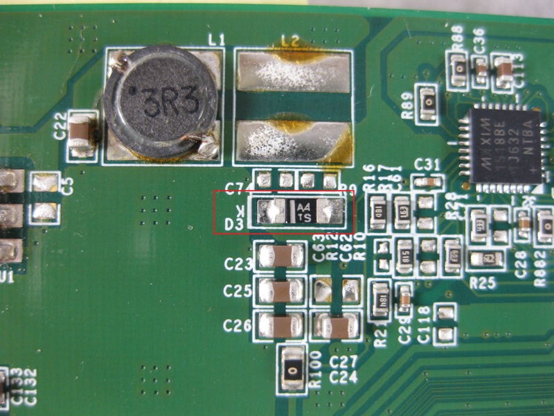

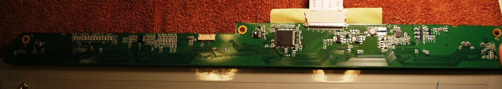

    I think I have identified this diode as shorted.
    I need help in identifying it...
    Anybody know what type it is?
    It is in the PCB attached to a Viewsonic VX2235WM-3 LCD screen
    Where I can find one?
    Thanks in advance.
    Scott

    Given it's proximity to the inductor, it's probably the rectifier for a bucking regulator. That top line looks as much like a logo as a package ID.
    1. Measure the dimensions of the package.
    2. Determine the package designation. The SMD Codebook could help.
    3. Use a parts look-up like Digikey or Mouser has to find a high speed diode in that package. I'm guessing that it is a schottky diode rated at 50 volts and 2 amps.
    An additional clue could be obtained from the Maxim IC which appears to be part of the circuit. The application note for it might show the voltage and current rating for the diode.

          • FIXITNOW
            • Jun 2008
            • 128
            Re: Trying to identify a diode...
            from cook book
            A4t = BAV70 Philips B SOT23 dual diode
            A4t = BAV70 Philips B SOT363 dual diode
              MAXIM MAX1518B datasheet shows a Schottky, 3A @ 30v coming from LX connection, with a 3.0 µH coil on the anode side. Similar to that configuration here, with a 3.3µH coil.
              Have you removed the diode and tested it? Schottky's don't test out the same way as "regular" silicon junction diodes do. In circuit, you're likely across another component.

              • Toasty
                • Jul 2007
                • 4171
                @ Fixitnow = there's a question from a previous post on what that marking is.
                AA tilted?
                44 tilted?
                A4 or 4A ?
                Plus, it's only a 2 connection device, not 3 as the A4T cross indicates.
                Oddly looks like the Motorola symbol...?

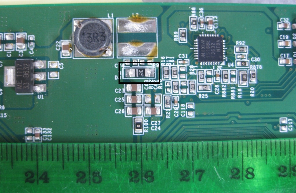

                    Using 'diode + 3A + 30V + Schottky + surface mount + in stock' on Digikey comes up with 41 hits, most of which represent different packaging methods. Knowing the dimensions of the package, it should be easy to find one which will work.

                      PlainBill felt this was a DIODE SCHOTTKY 3A 30V SMB. I'm not good at figuring out the size of the component so I can order it. I've included another picture of it along with a mm scale.
                      Can anybody help regarding what size this thing is so I can order it. I can figure out measuring it, I just don't understand the naming conventions regarding size.

                        It would have helped if you place the scale closer to the diode. I acturally had to mark a piece of paper and slide it down the screen to line up with the scale!! Oh, the inhumanity!!!
                        That looks to be 4mm long and about 2mm wide. The picture doesn't give me a clue as to thickness. This might be a Rohm PMDT package or the equivalent from another manufacturer. Likely part numbers are RB050LA-30CT-ND (RB050LA-30TR) and RSX301LA-30CT-ND (RSX301LA-30TR). The first numbers are the Digikey stock numbers; the numbers in parentheses are the manufacturer's part numbers.
                          Thanks much PlainBill...........I'll order them today and see what happens...
