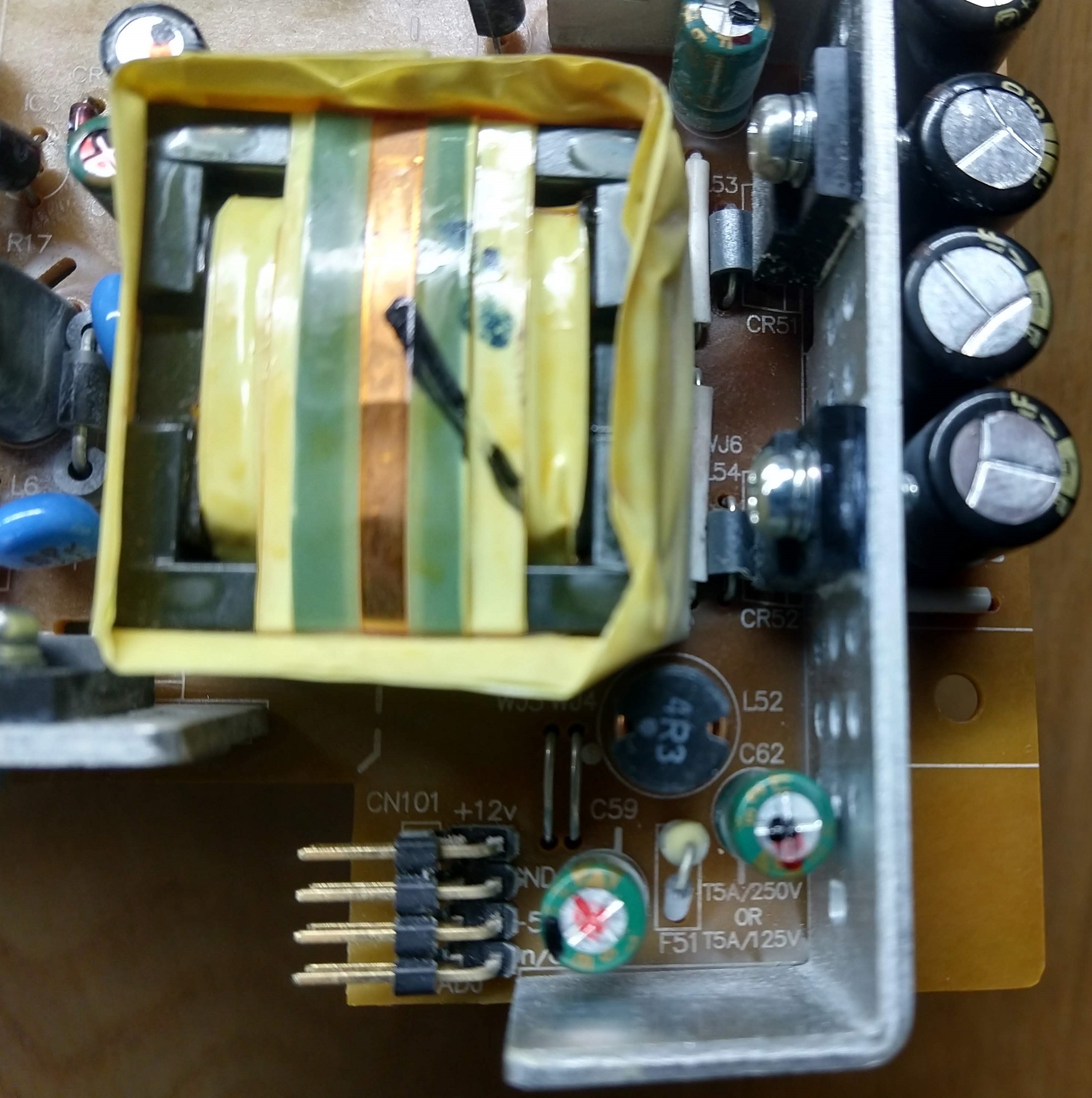

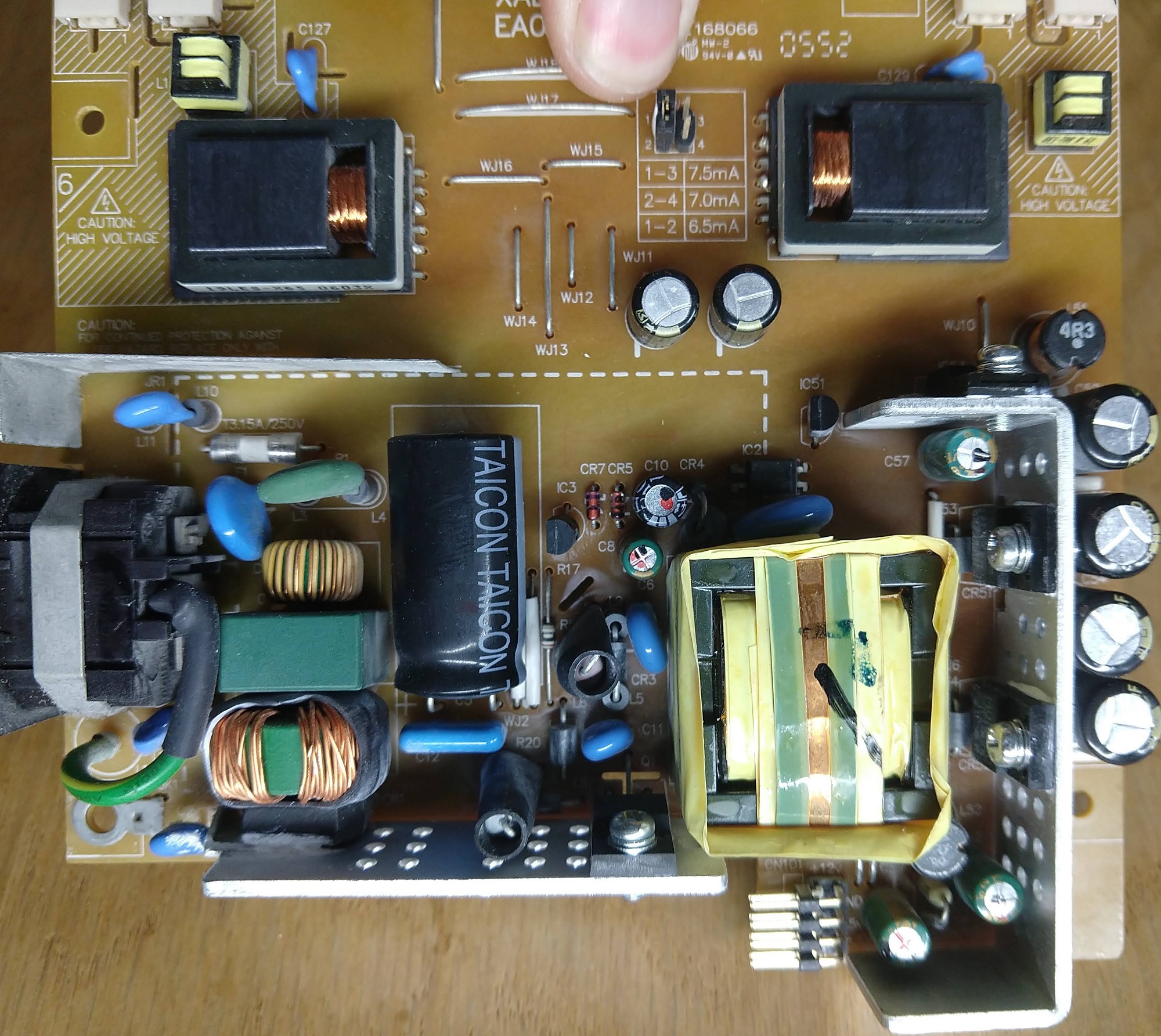

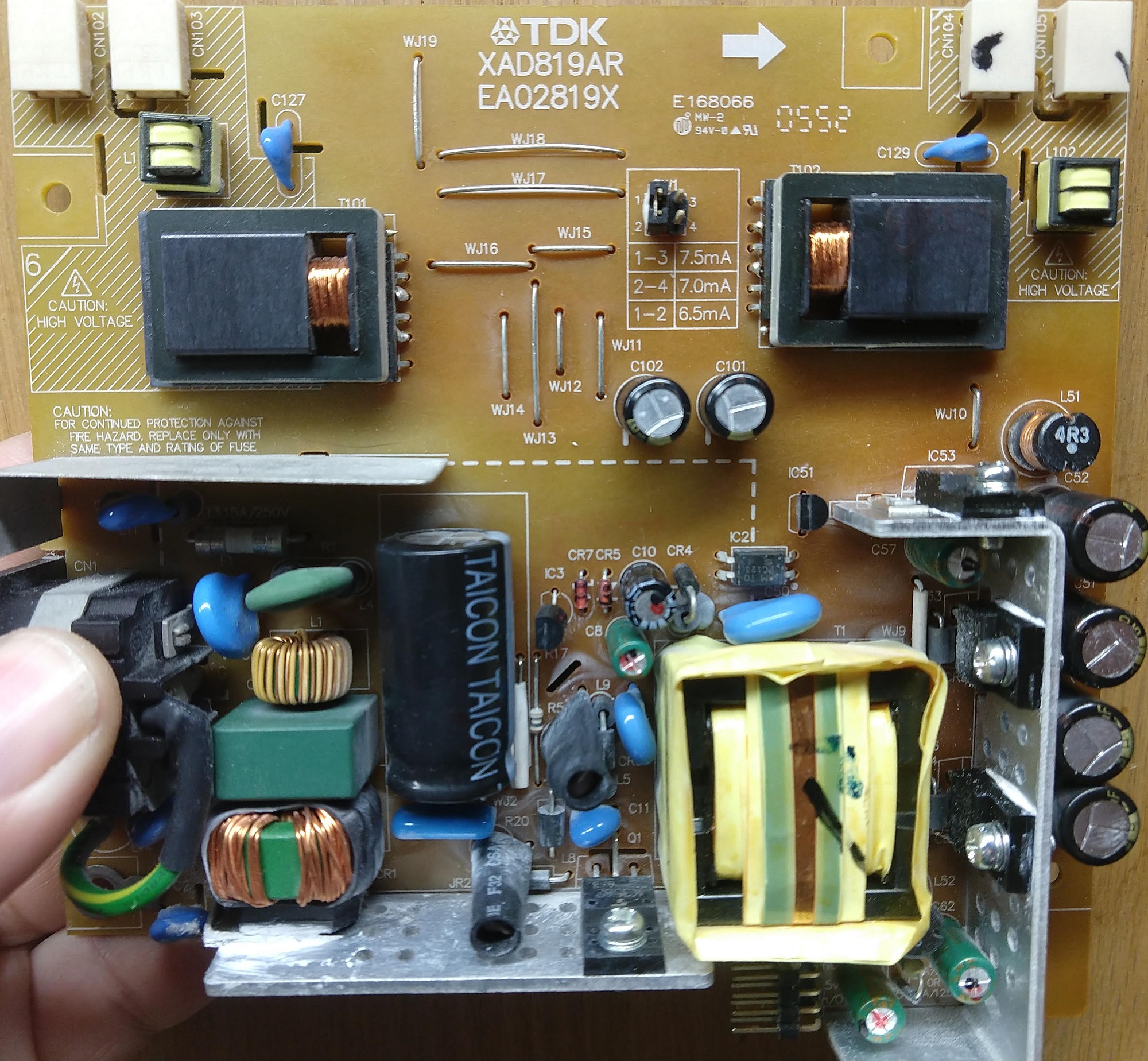

    Please be patient with me this is my first post.
    A little Background on this. I had been having issues with this monitor waking up from sleep mode. I have two of these side by side. One was HDMI and the other DVI connected. Recently this HDMI one would wake and it would keep trying various resolutions blinking on and off before finally coming back on. I discovered if I shut it off and back on it would usually lock in and work fine right away. This was for several weeks. I came home to have it not come on but I could hear a ticking sound from inside and it wouldn't come wake up.
    I pulled it apart to discover that I had partly recapped it at some point years ago. I have no idea why I only did 6 of them and not the other other 6. I don't see any obvious bad caps but obviously I don't trust the other 5 and the big 100uf 400v one either. With PS board unplugged from everything I powered it up and I could hear the ticking sound coming from the transformer about once a sec. I checked the outputs and was getting 4.98v on the +5 volt but only about 6.3v on the +12 and that was bouncing around.
    The caps c101 and 102 as well as those down the right side of the pics are Panasonic FMs I put in some time ago. Image 8 shows the legs on the large cap and I had some kind of baked on dust on the left one that almost made me think it could have been leaking. It was likely just normal dust but some of it in there seemed to be almost granular. could be nothing but it just seemed weird to me so I thought I would mention it.
    At a minimum I plan to try and replace the caps I missed before but I am wondering if there is a better way to proceed. I do not know theory so consider me an idiot who can barely solder. Having said that if anyone can help guide me I would appreciate it. I am sorry the pictures are so poor, I miss real cameras instead of cell phones.
    I hope you can help
    -Adrian

    Normally this would be the small startup cap on the primary side that is dead (C8 or C10).
    However I can visually see that the small green caps inside the heatsink (C62 for example) are bulging.
    So just replace all caps you did not replace the last time.

      Thanks for replying. I think it may be a result of my terrible pictures but I will go after them first and see where I stand. They didn't seem to be bulging to me, or at least not near as bad as the ones I have seen in the past. I will let you know after I get them replaced. I was afraid it was something more like bad transformer or a diodes and was figuring I could get all of the parts in one order. Would you recommend that I replace the big 100uf 400v one as well since I have it apart?

              OK, try this: disconnect PSU board from the logic/video board, then plug in the PSU board into the wall and check those output voltages again. Are the 12V and 5V rails stable and close to their nominal values?
              - If not, desolder one side of jumpers WJ11, WJ12, WJ13, & WJ14 and try the above procedure again. These jumpers should disable power going into the inverter MOSFETs. If you only get 12V rail to be stable after this, there may be an issue with the CCFL inverter circuit.

                      In post #6 you say you replaced 6 capacitors, Which ones? the board has location numbers. I suspect you did not replace the two startup ones.

                        RJ, Thanks for replying. I replaced C5, C8, C10, C57, C59, C62. [At some point a while back (years) I had replaced C51, C52, C54, C56, C101, C102.] So at this point there are no original electrolytic caps on the board. I was still getting the ~6.43v on the 12v side at the CN101 connector. It currently has jumpers WJ11,12,13,14 disconnected to remove the Inverter section as suggested by Momaka in post #7 but it had no effect. That's why I am stuck. So I open to any suggestions.

                              What is the number on IC53? I believe this is a scr that is there for protection, it should have a couple resistors connected to it's gate and then two zener diodes, one connected to the +5v and one to the +12v.

                                RJ, IC53 is a KIA7812A which seems to be a 3 terminal voltage regulator.
