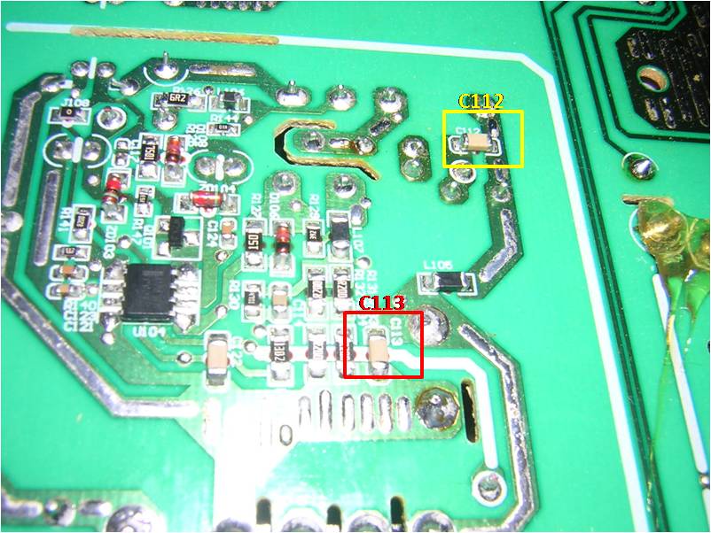

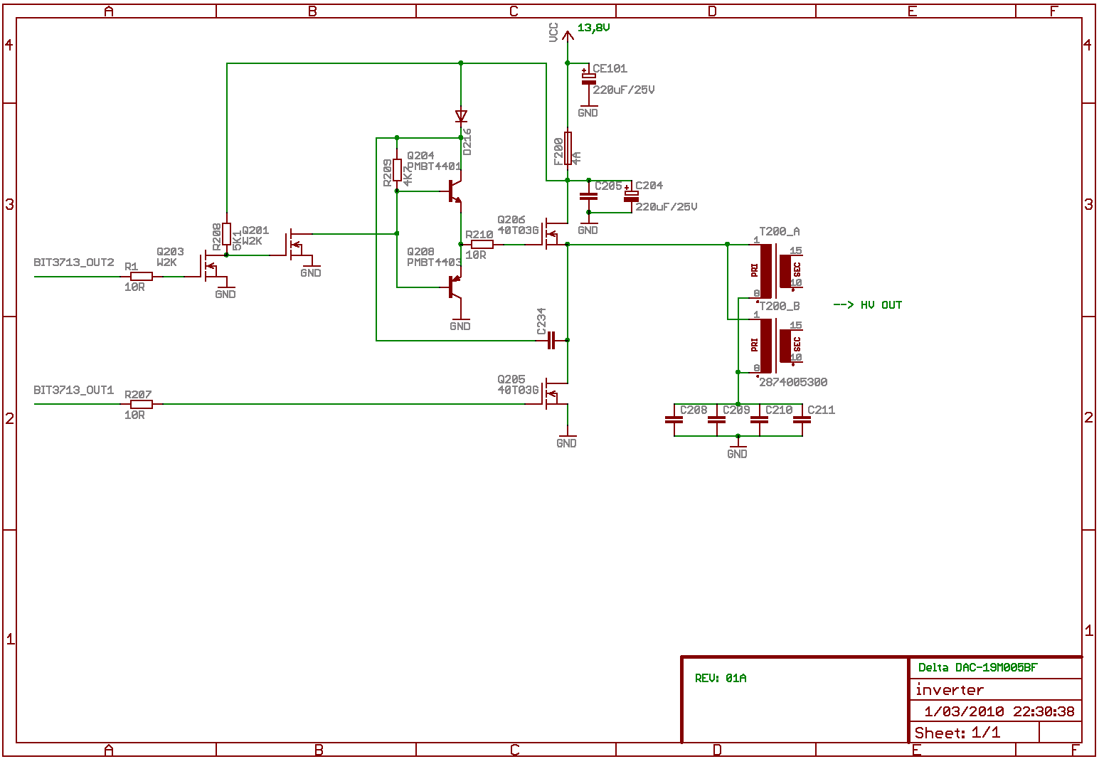

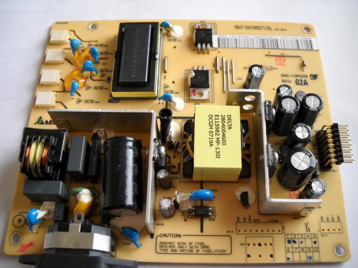

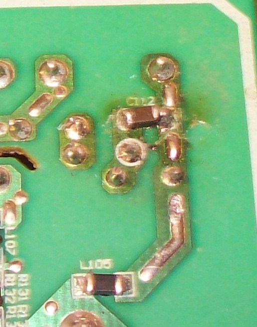

    I have been fighting my dac-m005 for along time.here is a pitcure of mine that got hot,any body know the value?
    Whatever I do, I consider it a success, if in the end I am breathing, seeing, feeling and hearing!
    • Welchs101
      • Sep 2008
      • 979
      #42
      Re: ACER AL2017.....not working...Led comes on....with-flashlight can see image
      I dont know the cap value. I would de-solder this cap and measure for it you but i am not good at removing and then putting back such small caps. However, the C112 cap appears to be the same as the C113. So if C113 is ok on your board remove it and measure cap.
      I would get a 2nd opinion from some others on this forum but this is what i would do.
      • alexanna
        • Mar 2010
        • 1346
        #43
        Thanks it is c112 it is open I think it is on the primary side, so if any one would know the voltage it would be helpfull.Where would you look to try to find wiring diagram?

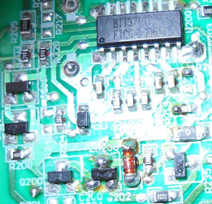

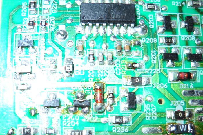

          Your transistor marked (140, I thunk is a P14 and a P14 or DTA114GUA is a transistor with only one resistor. My board is using a P13 for transistor Q202 and it is a DDTA114EE with two resistors. as for Q204, my board is using a W2Xwhich is a DigiKey 568-1743-1-ND.I will post some pictures as soon as I figure out how to insert them. I ordered Q200, Q202 and F200. I ordered 10 of each just in case. I an going to get U200 running before I worry about any of the drive transistors ( Q201, Q203, Q204 and Q208). I have a scope so I can look to see if U22 is running.

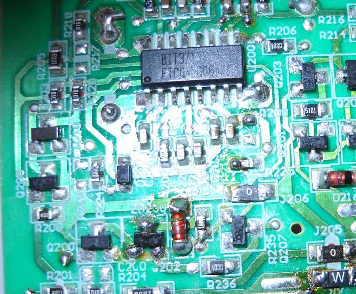

            Here are pictures of my board, I can take better ones if you want.

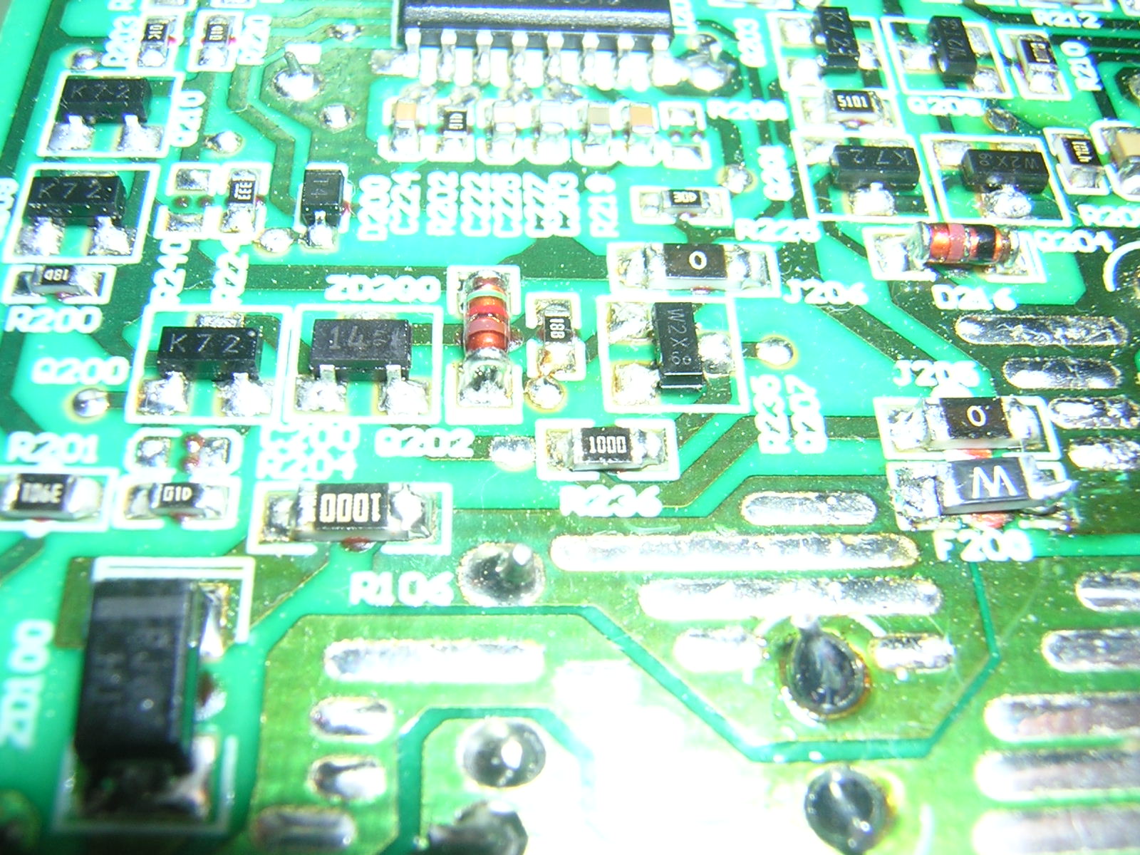

              frankNstein,
              Thanks for the pics. Did your parts come in yet? I hope you get your monitor working.
              I did have a few questions for you if thats ok.

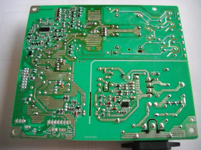

              You said your device was labeled P13.........can you take a pic of the back of your board but magnified to the top left.......i think this is where my "problem" is as well and i just want to see what your board looks like. I also want to double check to make sure we are talking about the same part.
              You said your part was P13.....mine is labeled "14"....there is no "P" on my device. Also, when i measure between the base and emitter i measure about 21Kohms.........but the part number you suggested with a single resistor the resistor value is only 10kohms.........so this is why i was thinking i had the "two" resistor setup. You sound like you know what your talking about so i just wanted to double check my reasoning with you.......if i measure ~20kohms between base and emitter for part "14" you still think that this is a single transistor setup.
                I got my parts and replaced Q202 and fuse F200. The fuse didn't open when I turned the unit on and I was able to look at the output of the inverter IC with the scope, it didn't look good and then the fuse opened again. I think that the IC is turning on Q205 and Q206 at the same time causing the fuse to open. I ordered four of the IC yesterday and will let you know what happens when I get them. I measured my Q202 and get about the same reading as you. I will send the picture later tonight because I will have to do that from the Windows computer. I will also send you a drawing of part of the board. It might take some time but we will get this figured out.
                    Glad to help. I figured your transistor Q202 was a P14 because mine was a P13 and I couldn't find the marking code 14 but found P14. Also, they are both digital transistors, transistors with internal resistors. I can tell you how to check Q200, Q202 and Q207 with a simple voltage check if you have a new fuse for F22. Also, you should measure the resistance from both sides of F22 to ground to see if you have an actual short on the fifteen volt line. Here are the pictures, hope they help and let me know if I can do anything else to help you.

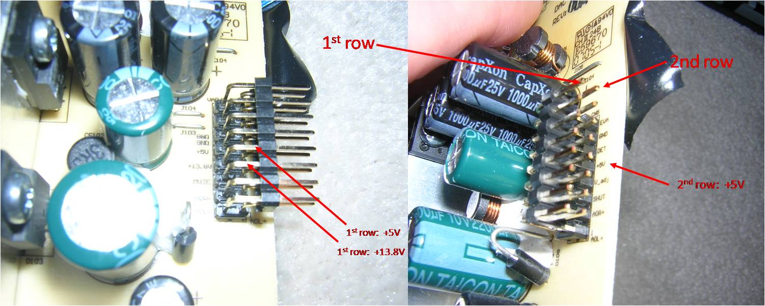

                            #53
                            ok.

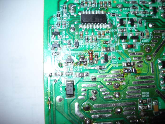

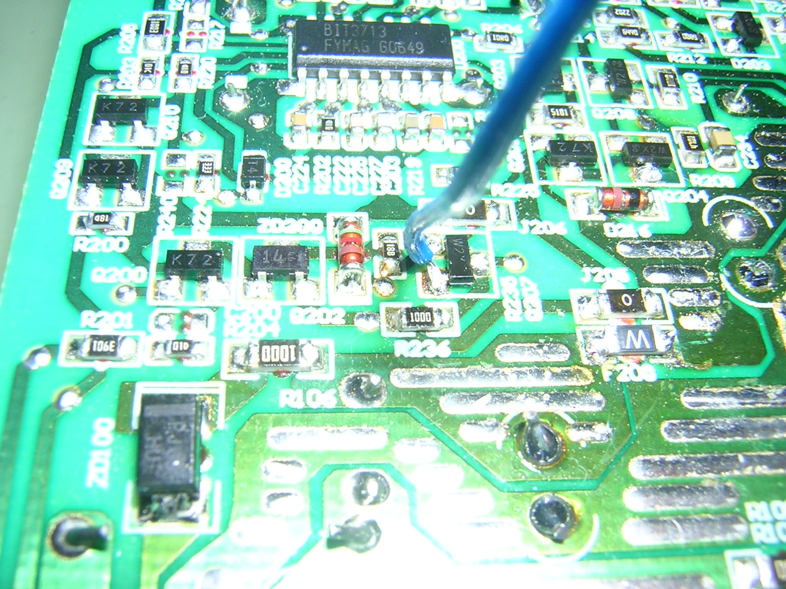

                            Here is what i have done:
                            1) I measured the resistance to ground on both sides of the fuse. Both resistance measurements were large....essentially opens.
                            2) I removed Q205 and Q206.
                            3) I then soldered in a new fuse and checked it to make sure it was indeed a short.
                            4) I then soldered a small wire to the "emitter" of Q207 (see enclosed pic).
                            5) Put power supply board and logic board back in place. Connected Lamps as well.
                            6) Plugged in power cord to outlet.
                            7) Measured the +5V and +13.8V values...........
                            Meausred values:
                            a) 5.05V b) 1.5V........not 13.8V........
                            8) I also measured the voltage on the wire i soldered to the emitter. I measured 4.96V on the emitter of Q207. When i first turned it on it went to 4.96V then to 0V .....then to 4.96V and then back to 0V......and then stayed at 0V.
                            Questions:
                            1) What is Q22?

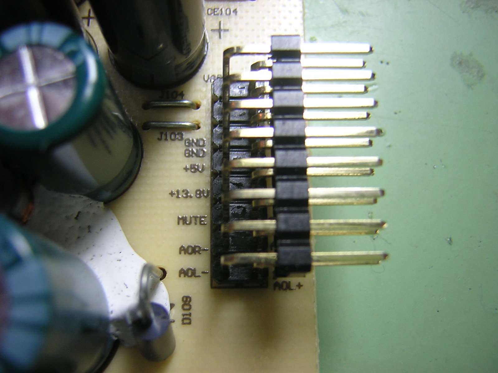

                            2) CN5: There are "two" rows of pins. The top side rows has a +5 and +13.8V. The bottom row has only a +5V. I assume i should measure the +5 and +13.8V on the top row.......is this right?
                            • frankNstein
                              • 35
                              #54
                              Yes there are two rows of pins on the connector CN5. I didn't understand, do you have the 5 volts at that connector? The reason the voltage is changing on the emitter of Q207 is because the power supply is pulsing. Try to measure that voltage as quickly as you can, before the power supply starts to pulse. Also check the fuse to see if it is open again. I was out of town for a few days and didn't get to do anything on my board but I am going to try to get something done with it this afternoon. Did you order some more fuses? I will let you know how it goes.
                              • Welchs101
                                • Sep 2008
                                • 979
                                #55
                                I have not ordered fuses just yet. I will do so today or tomorrow.
                                I have another fuse........
                                From the pic i had in previous post..........i showed the +5V and +13.8V. I measured the +5V and it was "about right" but the 13.8V was only about 1.5V....so the 13.8V pin is really low compared to what it should be.
                                The fuse "did NOT" open during this test. It is still a good fuse......shorted.
                                • Welchs101
                                  • Sep 2008
                                  • 979
                                  #56
                                  I am attaching a pic of the 1st / 2nd row ......explain what i ment.
                                  My measurements for the +5V and +13.8V were from the 1st row only.
                                  Again, i just want to re-state that i measured:
                                  1st-row+5V: I measured 5.05V
                                  1st-row+13.8V: I measured 1.5V
                                  From the emitter of Q207 i measured 4.96V. This is what i measured when i first turned it on. It did not go above this value.......it just went to zero then returned to 4.96V and then back to zero.
                                  • 12ax7a
                                    • Oct 2009
                                    • 21
                                    #57
                                    did you check Q204?
                                    it looks like it has a burn hole in it..
                                    • Welchs101
                                      • Sep 2008
                                      • 979
                                      #58
                                      Q204?
                                      I have not checked Q204...........why do you think it has a burned hole in it?
                                      • 12ax7a
                                        • Oct 2009
                                        • 21
                                        #59
                                        'coz i think i'm looking at a hole in the top side of it where the magic smoke escaped... (-:
                                        or at least that's what it looks like.. pictures play games so hard to tell but ...

                                          I think i see what your talking about in the photo. Let me double check the actual device and get back to you on that.
