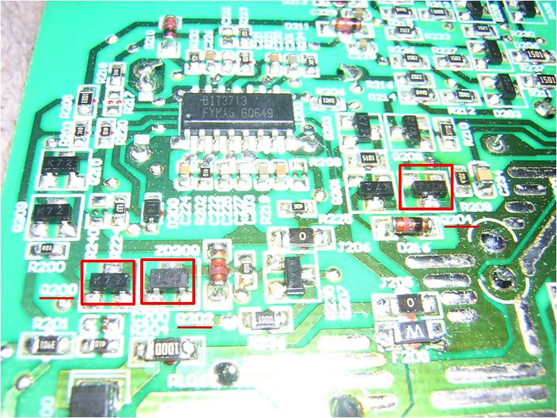

ACER AL2017.....not working...Led comes on....with-flashlight can see image

    This should be a PNP Pre-Biased transistor. Terminal one should be the base, terminal two should be collector and terminal three should be the emitter. There should be two 10K internal resistors used to bias the transistor and it probably will be open.

      Re: ACER AL2017.....not working...Led comes on....with-flashlight can see image
      Label the leads - lower left '1', top center '2', lower right '3' (see enclosed pic for how i labeled leads).
      Measure resistance(Red lead/Blacklead)
      Red-Black: Black-Red:
      1-2: open 3Megohm
      1-3: 21.9Kohm 21.9kohm
      2-3 : 3Megohm 30Megohm
      Diode-test: Black lead goes to the first terminal, red lead to the second.
      1 2:2.1V (no beep)
      1 3:2.1V (no beep)
      2 3:infinite (no beep)
      2 1:infinite (no beep)
      3 1:2.4V (no beep)
      3 2:1.1V (no beep)
      Also, frankNstein could you post a link to a data sheet? Or list a part number so that i could look up a data sheet.
      Thanks.
        I think you have an older board than I do but it looks like yours is using a DTA114GUA transistor. Also check diode ZD200 for shorts. This board is using Q200,Q202 and Q207 to supply power to pin 10 1nd 6 of U200. I haven't ordered parts for my board yet but I think that replacing Q200 will get things running unless U200 is bad. Good luck and let me know how things are going.
          what is the revision number of your board? Just curious.
          Also, what measurments do you have for your Q200? How do you know its bad?
                No problem.
                ZD200: Ok, diode voltage is ~ 0.7V
                Below are measurements for Q200:
                Measure resistance:
                1-2: 0.4Megohm 0.4Megohm
                1-3: 150Kohm 150kohm
                2-3 : 174kohm 290kohm
                1 2: infinite (no beep)
                1 3: infinite (no beep)
                2 3: 0.57V (beep yes)
                2 1: infinite (no beep)
                3 1: infinite (no beep)
                3 2: infinite (no beep)
                  Below are measurements for Q207:
                  Measure resistance:
                  ------------Red-Black: -------------Black-Red:
                  1-2: --------3Megohm---------------26Megohm
                  1-3: -------5.8Megohm ------------6.1Megohm
                  2-3 : ------5.9Megohm -----------(-2.4Megohm)
                  1 2: 2.3797V(no beep)
                  2 3: infinite (no beep)
                  2 1: 0.61V (yes beep)
                  3 1: 0.63V (yes beep)
                  3 2: 2.2V (no beep)
                  • Welchs101

                    #29
                    Do any of those i measured look bad?
                    I think Q200 and Q202 looked bad.......is this right? Do you think they are bad enough to cause the fuse to keep blowing?
                    What about Q207.........is this one ok?
                    • frankNstein
                      • 35
                      #30
                      Q200 is a fet and is probably good. Q202 is probably bad. If Q207 shorted the backlight would run all the time. Q207 is a NPN transistor #MMBT4401LT1.Hope this helps. If I can do anything to help you let me know.

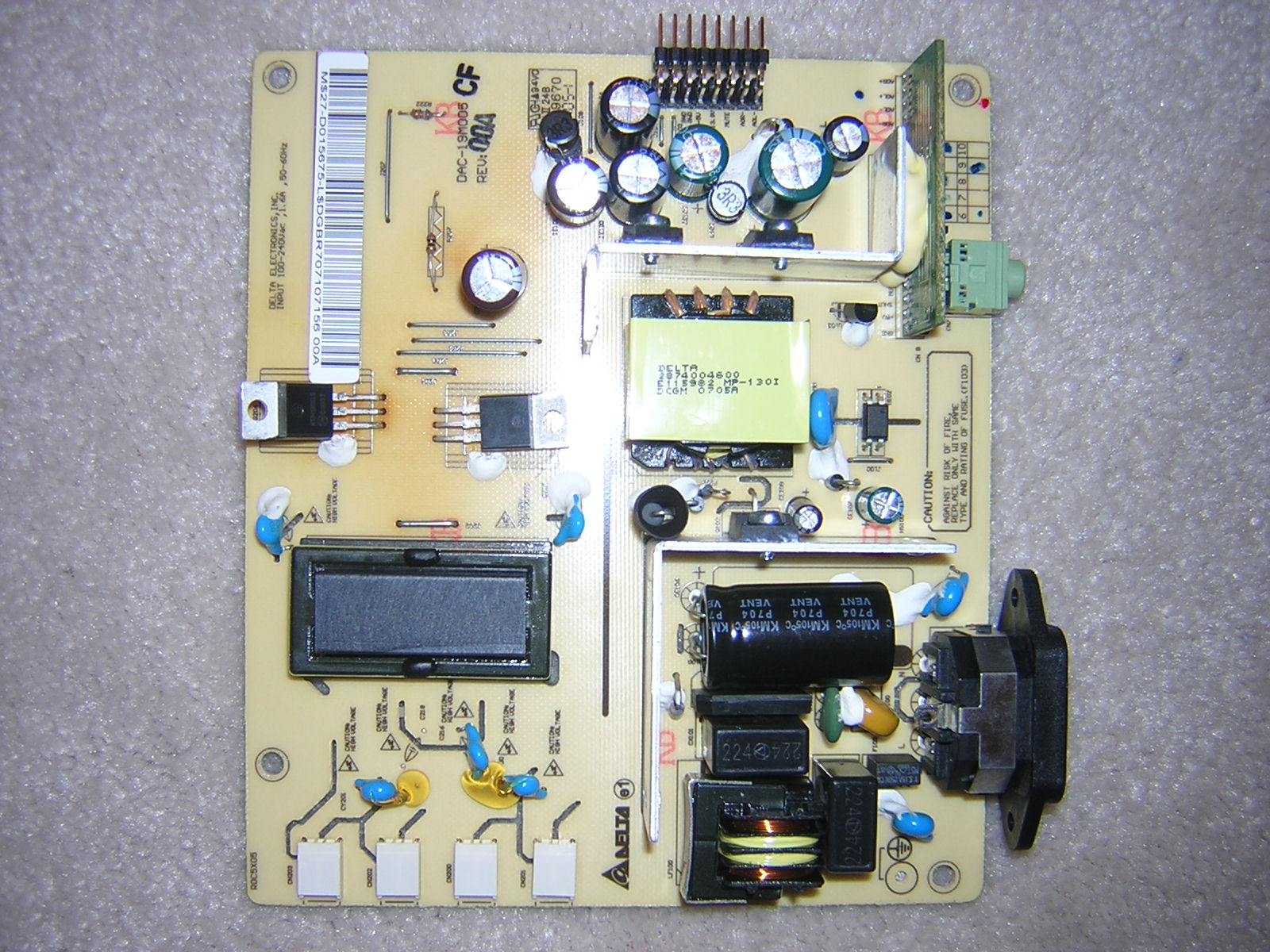

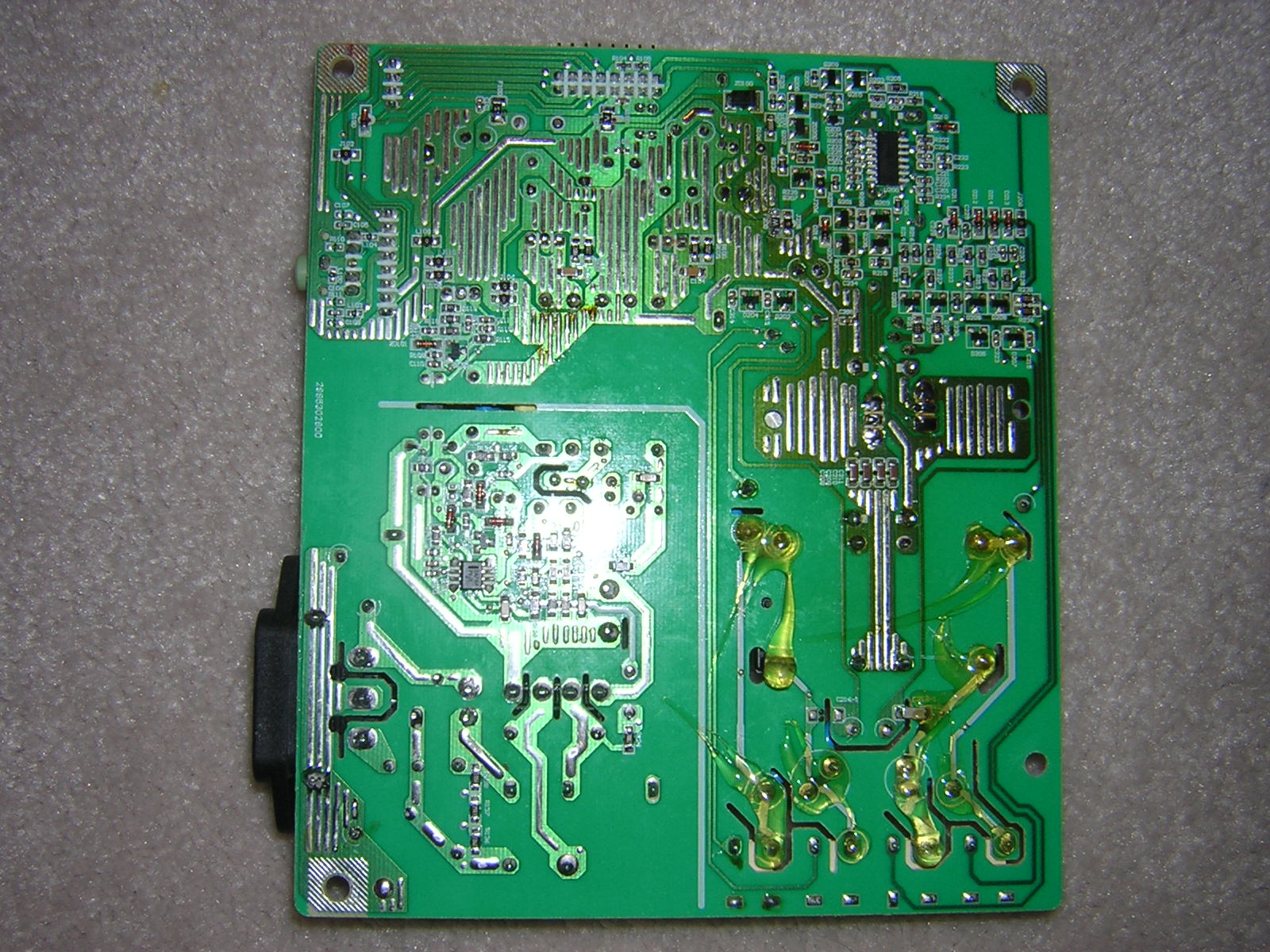

                                          The board revision for this ACER AL2017 is
                                          DAC-19M005 CF
                                          REV: 00A
                                          I have also enclosed a pic of the top and bottom.
                                          Can you also submit a pic of your board for comparison.
                                          Sorry the K72 part was not applicable.
                                          Also, why do you think my Q202 has only the single resistor? The reason i ask is that if you look at the resistance measurements i measured ~ 21Kohm between what i was calling pin1 and pin3. Because i measured ~20Kohm i was thinking i had the "two" resistors not just the one.
                                          Also, the Q202 marking is "14".....its hard to see from the pic but if you want i can take a better one if it would help.
                                          I wanted to ask your opinion on another device...... labeled Q204.......do you know what this device is?
                                          Thanks again.
