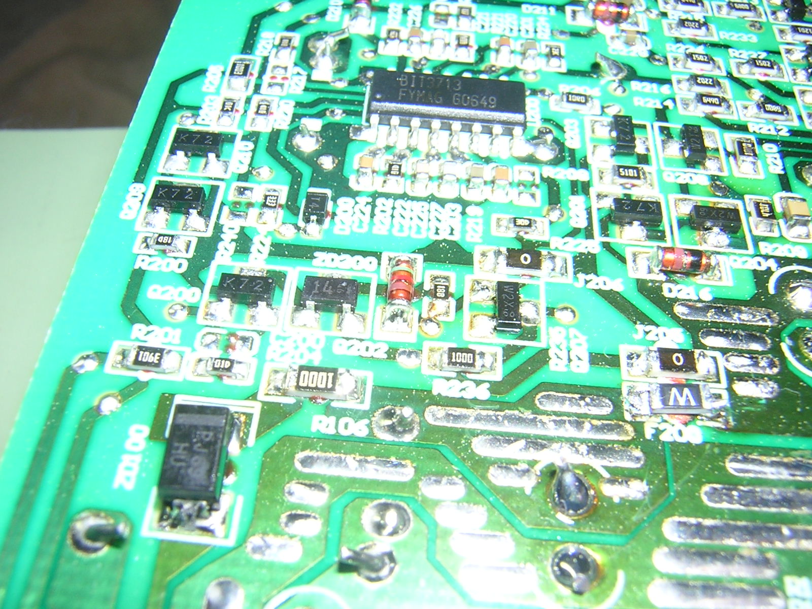

    I have an ACER AL2017 a friend brought over for me to look at. I am hoping to fix this monitor so that i can fix another monitor that i have been working on for a long time. This monitor has a power supply board very similar to the westinghouse power supply board shown in this thread
    https://www.badcaps.net/forum/showth...3&page=1&pp=20
    In this thread above caps, power-fets and fuse were replaced. I did the same.
    When i power on the monitor the lamps DO NOT COME ON.
    The green LED light does come on.
    Also, using a flashlight directed towards the screen, i can see the image.
    Its just that the lamps wont turn on.
    Note: I have checked the LAMPS using another monitor and they work fine.
    Sounds like an inverter problem but i am not sure how to isolat the problem.
    Any ideas on what to measure to figure this one out?

    If memory serves, this board is notorious for shorted inverter transistors and a blown fuse. The fuse is a smt style on the back of the board - look for the M in the inverter area. Also, replace all electrolytic caps with the usual exception.

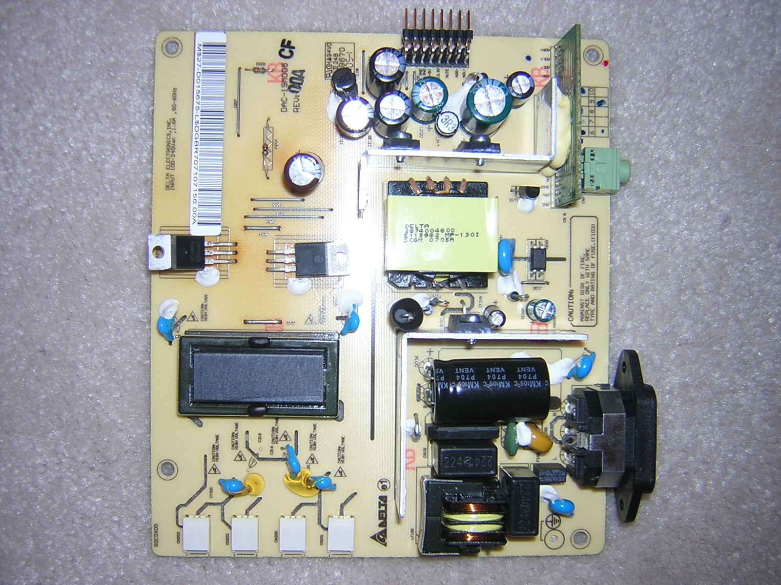

                This looks like a DAC-19M005 board if it is check F200 and see if it is open again.

                    The fuse is probably open again. I have one of these boards with the same problem.

                      Things to check:
                      1. The fuse. If it is open, don't replace it yet. Instead use a #1157 bulb (automotive tail light).
                      2. The state of the BL_ON line. It should be close to 0 volts.
                      3. Is power getting to the inverter controller?
                      PlainBill
                      • Welchs101
                        • Sep 2008
                        • 979
                        Re: ACER AL2017.....not working...Led comes on....with-flashlight can see image
                        I checked the fuse........IT IS OPEN!
                        I bought a bulb but i dont know if it has the same voltage and current rating. The one i have is a Sylvania #921 (12.8V, 17.9W). Would this work? If not i will buy the one you mentioned in your thread.
                        You said the state of the BL_one line should be 0V......where do i measure this?
                        Is power getting to inverter controller...........Is the inverter controller the BIT3713 device?

                          That bulb will work, perhaps better than the one I suggested. Now the idea is to use that to replace the fuse (temporarily) while you figure out what is causing the fuse to blow.

                              I'd do the 'touch tests' first - CAREFULLY!!!

                                Check Q202 and see if it is open.

                                      I checked Q202........but to be honest i am not sure what this device is and what it should measure. I am enclosing a pic of this device (Q202) ........it has markings on it of "14".

                                        Use the standard tests for a transistor. Label the leads - lower left '1', top center '2', lower right '3'. Measure resistance 1-2, 1-3, 2-3; all should read > 100 ohms.
                                        Switch to the diode test range and do these tests. Black lead goes to the first terminal, red lead to the second. You should get a reading of about .5 volts on only two of the six tests. The others should read open.
                                        1 2
                                        1 3
                                        2 3
                                        2 1
                                        3 1
                                        3 2
