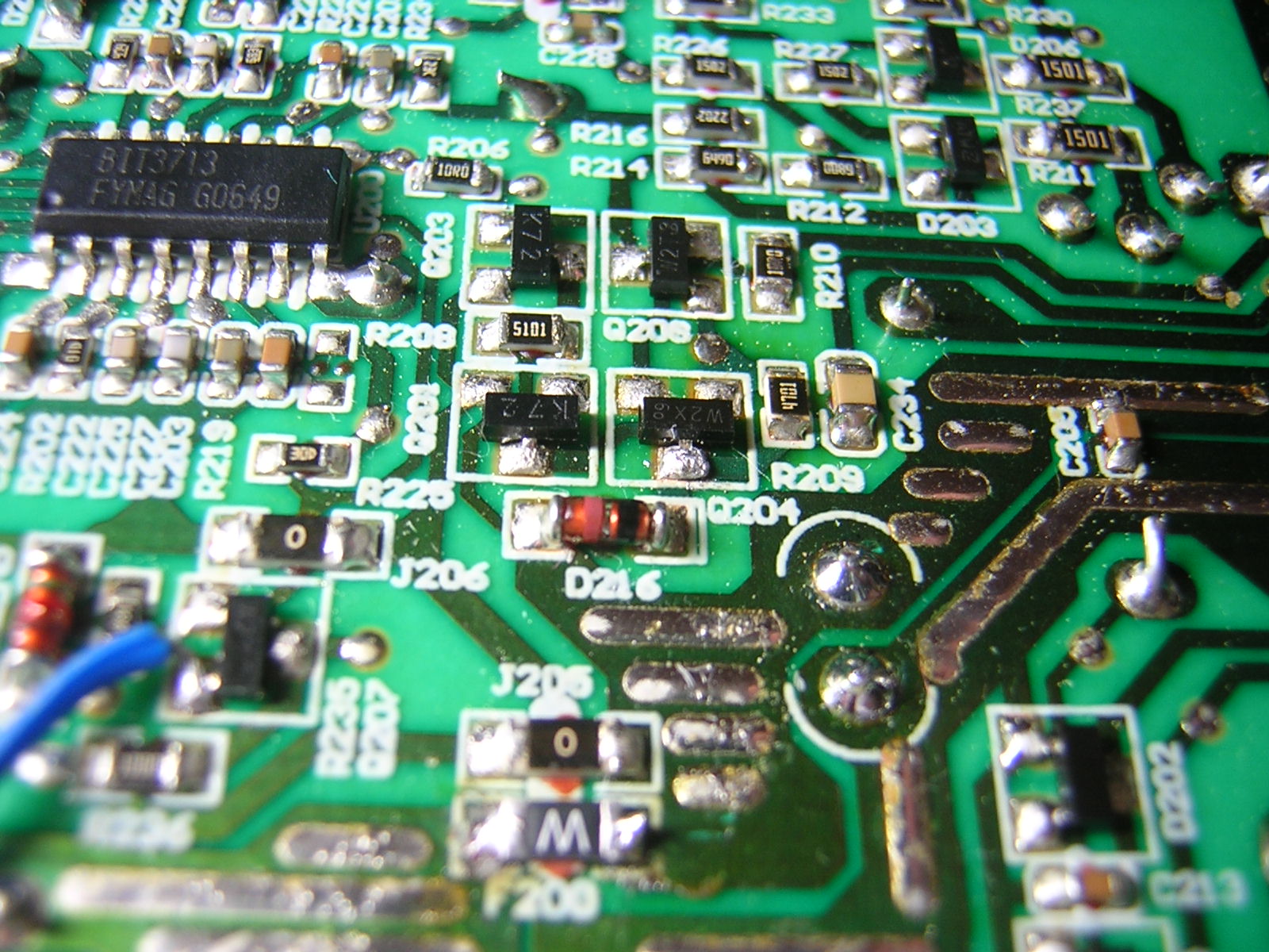

        Re: ACER AL2017.....not working...Led comes on....with-flashlight can see image
        frankNstein,
        I looked at my Q201 and compared it to yours. I believe yours has the markings of "W2K" and mine has the markings of "K72". So they are different at least in the markings (see my enclosed pic of K72).
        I will keep looking to see if i can find more information on the W2k and K72 devices. If i cant find them i may start a thread here on bad-caps to ask if anyone else knows what they are........i have had sucess with other people finding parts that i could not.
        also, you mentioned you replaced your U200 device. Where did you buy it from? Was your U200 device defective?
              I had a little time this morning and found a replacement and the data sheet for the K72. I think it is about the same as the W2K but with a diode. I will try to do some more troubleshooting this weekend and probably order the replacement for my board. Here is the data sheet, hope this helps.

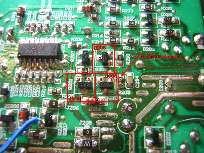

                      #70
                      Measure with multimeter devices Q201, Q204, and Q208.
                      Note: I have enclosed a picture to show where Q201, Q204 and Q208 are located on the board. I have also labeled each of the pads: 1,2 or 3
                      I have also included the datasheets for these devices.....at least what i know at the present time to be the data sheet for these devices.
                      Q201:
                      Resistances:Black, Red
                      1 to 2: Open
                      1 to 3: Starts at 7.6Kohm and then begins to increase
                      2 to 3: 1.37MegOhm
                      Resistances:Red,Black
                      1 to 2: 1.6Megohm
                      1 to 3: Starts at 5Kohm and then begins to increase
                      2 to 3: Open
                      Diode-checks: Black, Red
                      1 to 2: No beep no reading
                      1 to 3: 0.58V beep
                      2 to 3: 0.223V Beep
                      Diode-checks: Red, Black
                      1 to 2: Starts at 1.7V and increases No beep
                      1 to 3: Starts at 2.18V and goes to about 2.25V no beep
                      2 to 3: No beep no reading
                      Q204:
                      1 to 2: 4.72kohm
                      1 to 3: 0.884Kohm
                      2 to 3: 5.6Kohm
                      1 to 2: 4.72kohm
                      1 to 3: 0.883Kohm
                      2 to 3: 5.6Kohm
                      1 to 2: 1.6V No beep
                      1 to 3: 0.539V beep
                      2 to 3: 0.868V No Beep
                      1 to 2: 0.591 Beep
                      1 to 3: 1.7V No Beep
                      2 to 3: 1.73V no beep
                      Q208:
                      1 to 2: 1.63Meg ohm
                      1 to 3: 0.881Kohm
                      2 to 3: Open
                      1 to 2: open
                      1 to 3: 0.880Kohm
                      2 to 3: 1.63Meg ohm
                      1 to 2: 0.577V beep
                      1 to 3: 0.538V beep
                      2 to 3: No Beep, No reading
                      1 to 2: No Beep, No reading
                      1 to 3: 0.540 Beep........surprising that got beep both ways see above
                      2 to 3: 0.88V No Beep
                      • frankNstein
                        • 35
                        #71
                        Thanks for your help. I will do some more checking today.
                        • frankNstein
                          • 35
                          #72
                          Could you please check the resistance of Q204 again. Just from (1) to (3), R/B and B/R. I found that that transistor on my board has a resistance of about 450 in both directions, in circuit and out. I have ordered Q201, Q204 and Q208 for my board. I am quite sure that Q204 is the problem but I thought I would just order them all because of shipping cost. Some are on back order so I am not sure when I will receive them.

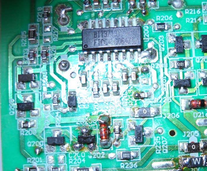

                            OKey, Im also busy for a long time with this power supply and also no luck for me. My Part No is 19M005 rev 00A. Does some of you have scematic diagram of it??? My FETswere broken, also Q201 and Q204 (and of course the caps) Replaced it, fuse gone and Q 201 and 4 also gone again.
                            • blackrider1
                              • May 2011
                              • 28
                              #74
                              Here you have a DAC-19M005 datasheet, I posted on the Fixing a DAC-19M005 Power Supply thread:
                              https://www.badcaps.net/forum/showth...217#post165217
                              http://www.megaupload.com/?d=ZZHAGME6
                              Although 6 months later, FrakNstein and Welchs101, Did you fixed your boards finally?

                                #75
                                Well, finally I got it working. According to the DAC-19M005 datasheet, I decided to follow the line from 16,5 V to the backlights transformer (from F200 ahead), and replaced Q204 (it was burnt, as you can see in the first picture),Q201,Q203 and Q208 ( Q203 and Q208 were okay but I replaced them too).
                                And Q200,Q202 ,ZD200 (weird meassures when testing),Q207 and D216 (They were okay too).
                                And finally, not necccesary but I did it, Q209 and Q210.
                                And now, it´s working.
                                PS: I replaced for the first time all caps (2 bulged and others),Q205 and Q206and ,although they were okay, F200,R210 and R206, but didn´t still had backlights. I didn´t got any blown fuse, so my problem was different than yours, but finally I fixed it. You can see the pictures here:
                                https://www.badcaps.net/forum/showth...143#post167143
                                post #94
