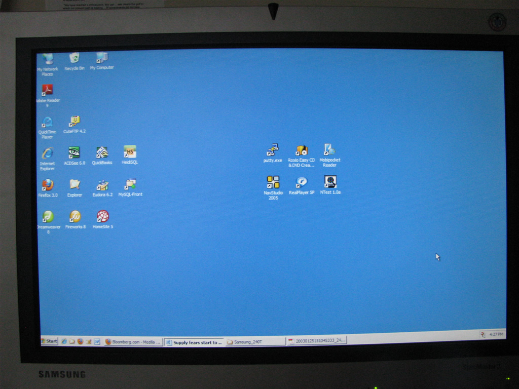

    Samsung 240T just arrived. Works fine except that the screen image shows the following:
    Bands of 45 degree cross-hatching, maybe 1.5" - 2" tall, slowly make their way from the bottom of the screen to the top. There are two bands maybe 3" - 4" apart visible at all times. An image is attached, one band can be seen immediately below the NavStudio, RealPlayer, NTest icons.
    Al Moodie.

    60 (or 120) Hz hum bars?

      Try moving the monitor elsewhere to see if it's RFI/hash from switching power supplies or the newer electronic "ballasts" of overhead fluorescents.

        Re: Samsung 240T on screen ripple effect
        The SMPS caps and bad cap on the regulator on the mainboard. Sometimes a regulator oscillate because of insufficient filtering.
          I agree.
          I've come across this several times on some acer monitors. Each time it was fixed by recapping the power supply.
            Thanks Wizard and aliasdck, I intend to recap everything, parts arrived today.

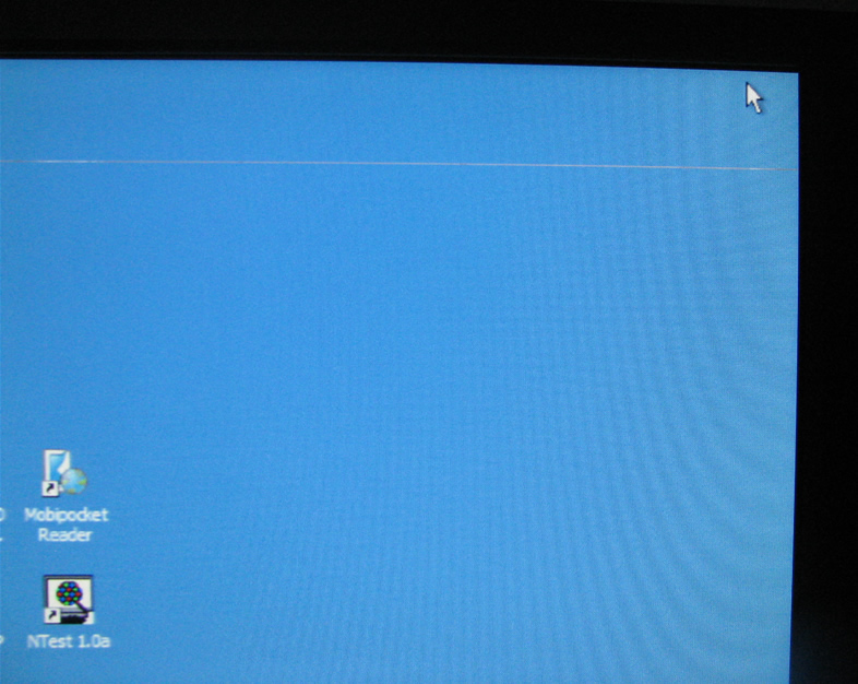

            Monitor has developed another problem, a thin horizontal runs across the screen about 1" from top, image attached. Sometimes it's there sometimes it's not. Can this be fixed.
            Al Moodie.
