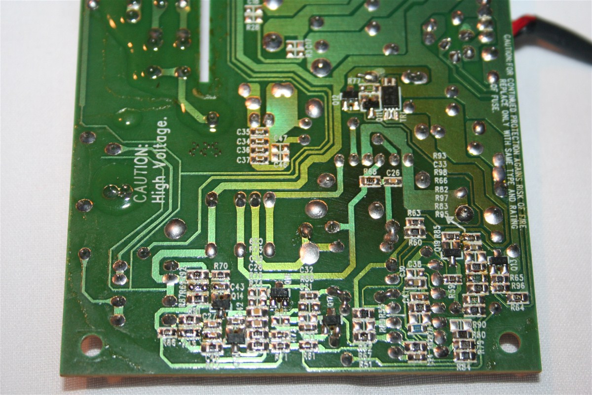

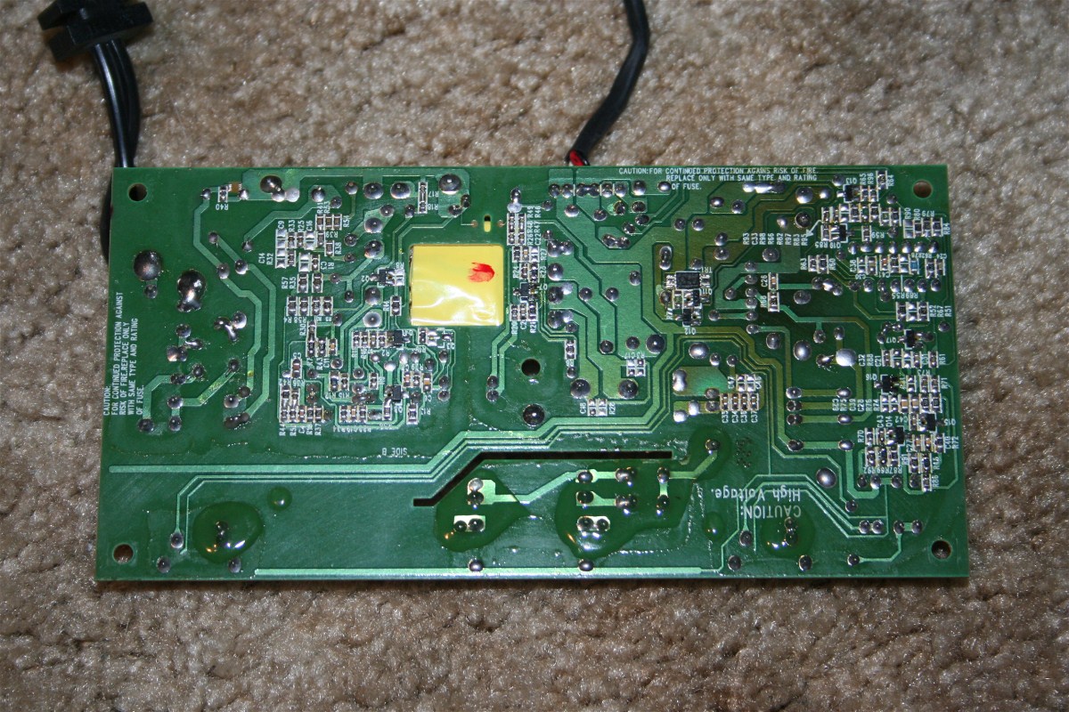

I'm not sure why, but the back board pic isn't working
--- begin sig file ---
1) DMM in diode test: Test diodes D15, D16, D12, D8, D14 both directions and post results
2) better pic of bottom. Take clear closeup of the entire right half of the board (side with discoloration). And I'd prefer they not be posted inline, just attached with the thumbnail...
I believe the picture limit size is 2000x2000. You can crop out your carpet in the pictures to lower the size.
In addition, the owner of this forum has been making changes in the last 3 or 4 days, but has not posted a notice that I'm aware of, and the site has been up/down lately.
I did crop the pics down to a 1200x800. I thought the board would automatically resize them to a small size and make them clickable to a larger size.

I don't have any knowledge of how to test things or what readings go with what. I don't have anything to test with either. I mainly was asking what the two 1Uf caps mcfischer was referring to when I first posted in this thread.
The 1uf caps in the first post are at location C106 and the one just left of it (just above ZD101).

Look at the picture in the very first post. It near the very top in the middle right by the Delta.
That is why PlainBill wanted pictures of your board. It looks like the picture in the first post and your board are NOTHING alike.
It is not uncommon for different board revisions to exist in the "same" monitor.

I can't find anything that resembles the 2 you mentioned. I must be blind
That explains alot... I have a completely different board in mine. In fact, the power wire and video cable are soldered right to the boards. No connectors
1) glass fuses and picofuse to see if they are open
2) test transformer using ohms
3) check for cracked or poor solder joints
for starters.
