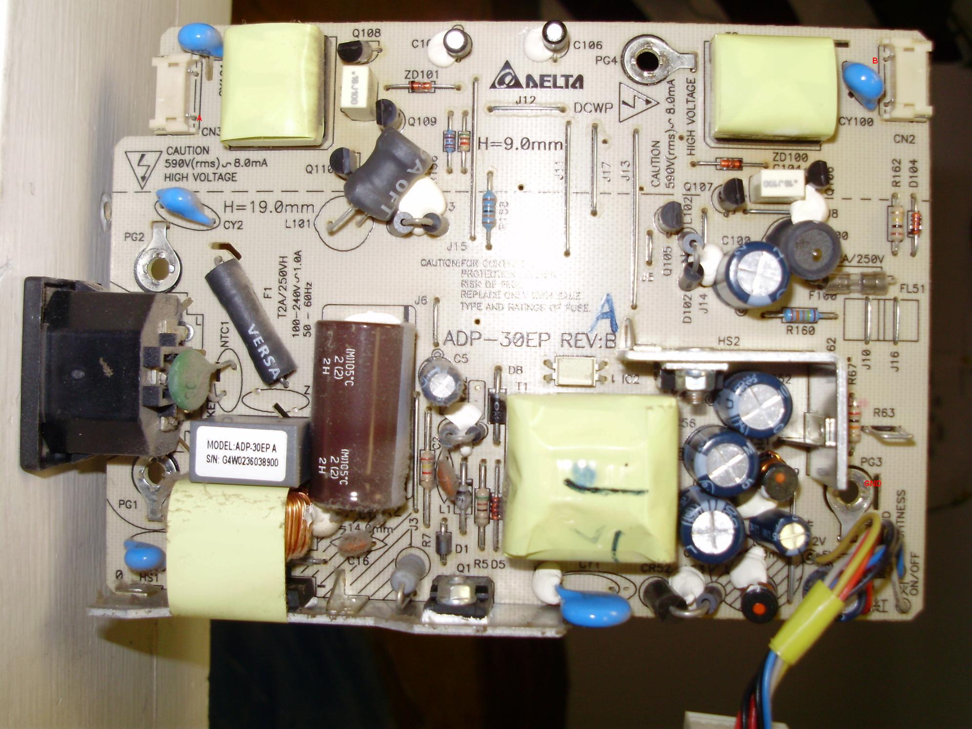

    I have a Gateway FPD1530 Flat Panel LCD Monitor. When turned on it lights up and you can see the picture perfectly for about 1 second then the screen go's dark. Flashlight test reveals the picture is still there, its just dark. Power light stays solid green. Pictures of the Logic Board are attached. I cant see any bad caps or dry solder joints. Any ideas will be greatly appreciated.

      Re: Gateway FPD1530 works for a second then dark
      This is a classic description of the 'two seconds to black' symptom. I've marked up the top picture. Try measuring the AC voltage from point A to Gnd and from point B to Gnd while the backlights are on. Also check the inverter transformers for bad solder joints.
      By the way, this is a picture of the inverter / power supply, not the Logic Board. (Pictures of the right board, you just gave it the wrong name.)

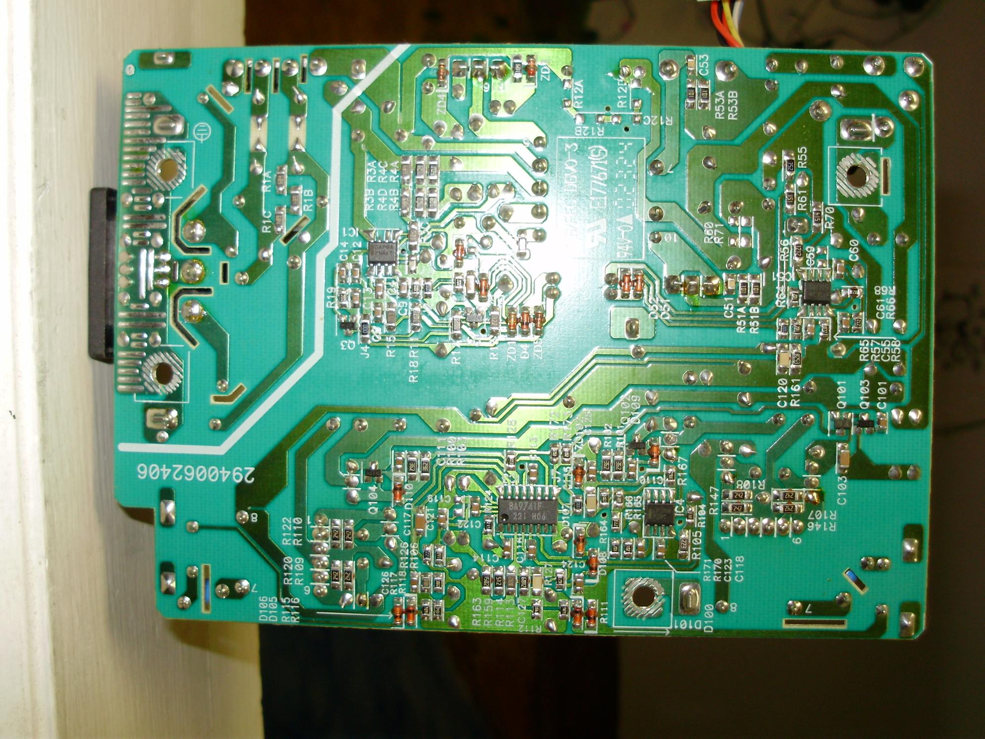

            No, it's unlikely bad caps would cause this. You are measuring the voltage on the return line, which is proportional to the current. If you tried several times to read the voltage and got consistent results, the only conclusion I can come to is one CCFL is carrying more current than the other.
            NOW, we have to figure out why. If you look at the top of the board near each of the connectors for the CCFLs you will see the transformers. If you look at the underside you will see the transformer pins are numbered 1-6 (primary side) and 7 & 8 on the secondary side. With power off, measure the resistance of each secondary.

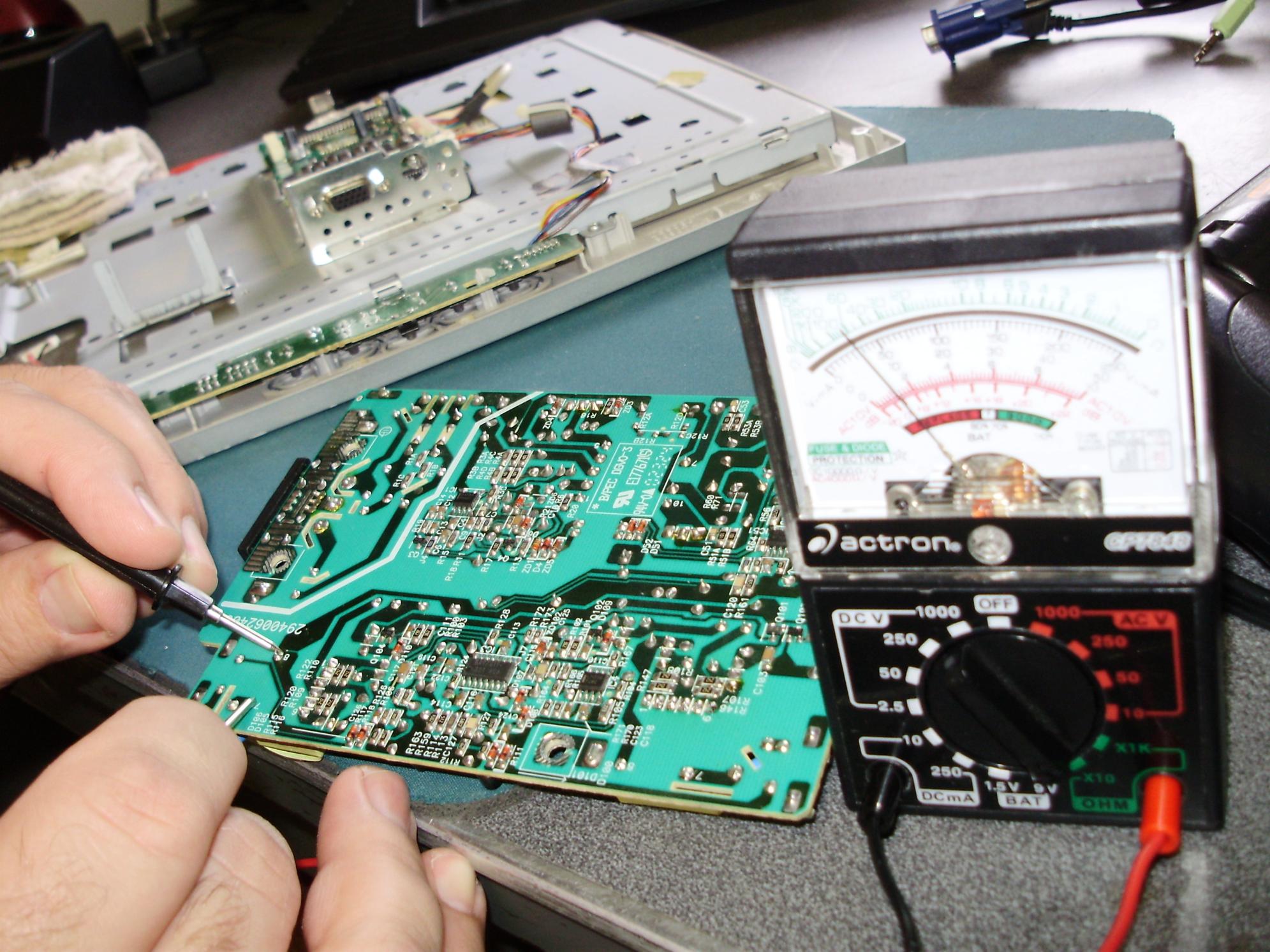

              How do I measure resistance? (I know, Im a doofus) I have a multimeter.
              • PlainBill
                • Feb 2009
                • 7034
                (Well, as long as you know.) Disconnect the power supply / inverter board from the rest of the monitor turn it face down in the same position as the picture. Set the DMM to the 2K ohms range. In the lower left corner of the board you will see two points labeled 7 and 8, with the 8 above the 7. Put one probe on the pin labeled 7 and the other on the pin labeled 8. Write down the reading. Now look at the lower right corner of the board. You will see two more pins, but this time the 8 is to the left of the 7. Measure the resistance between the two points.

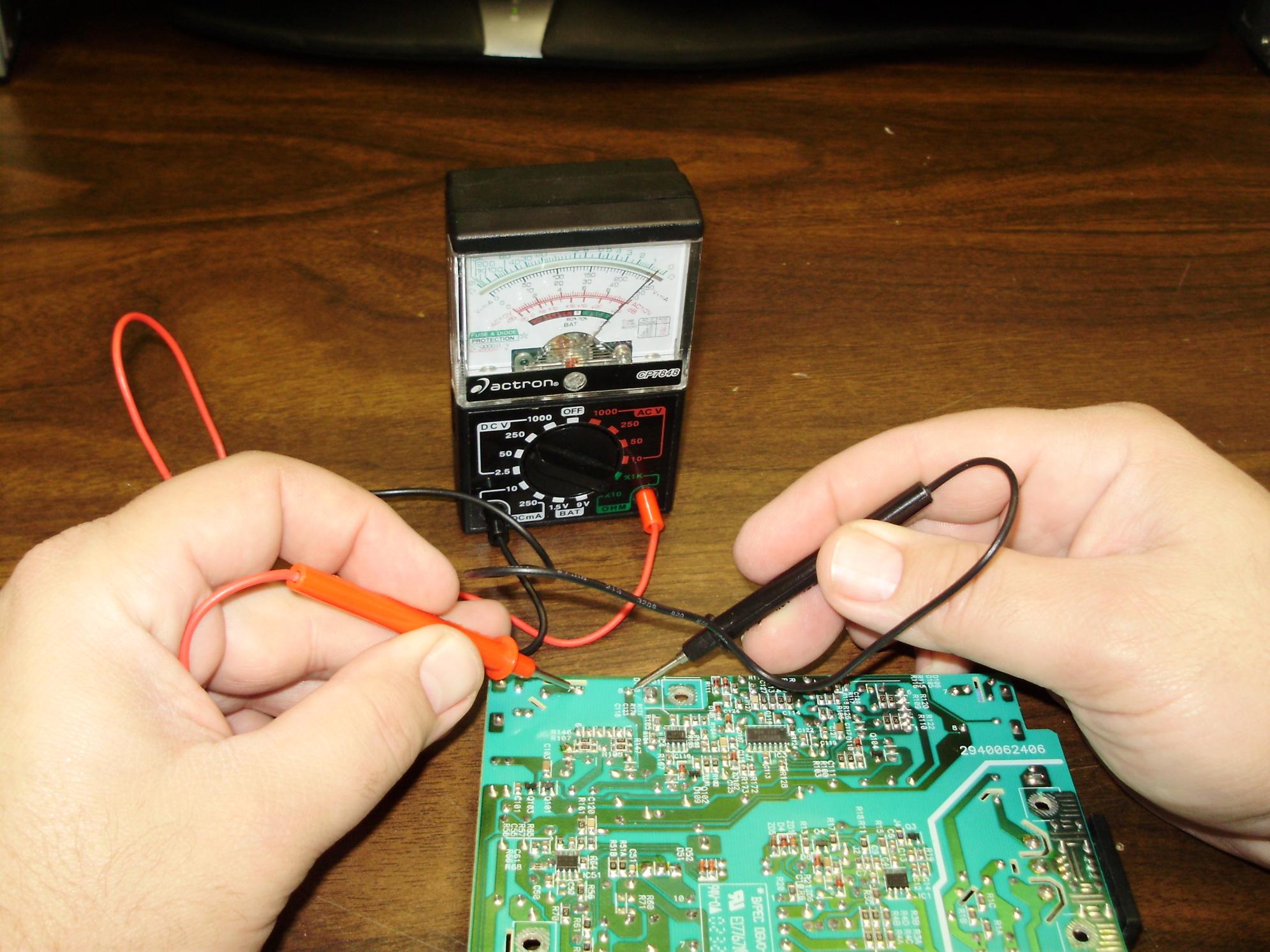

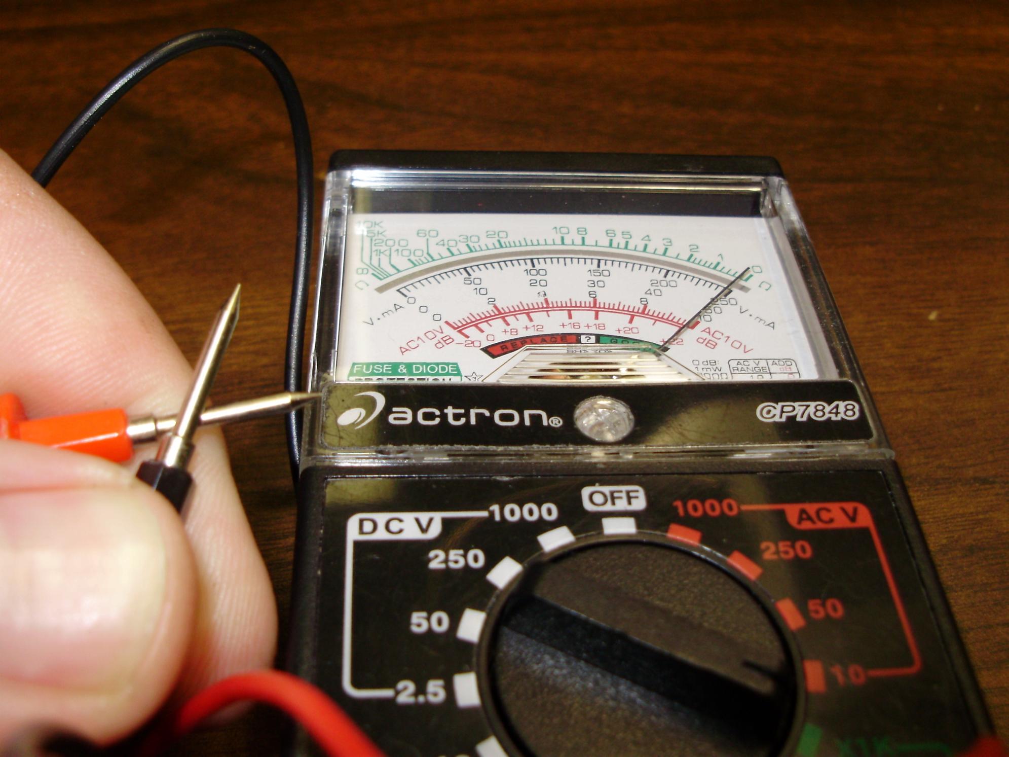

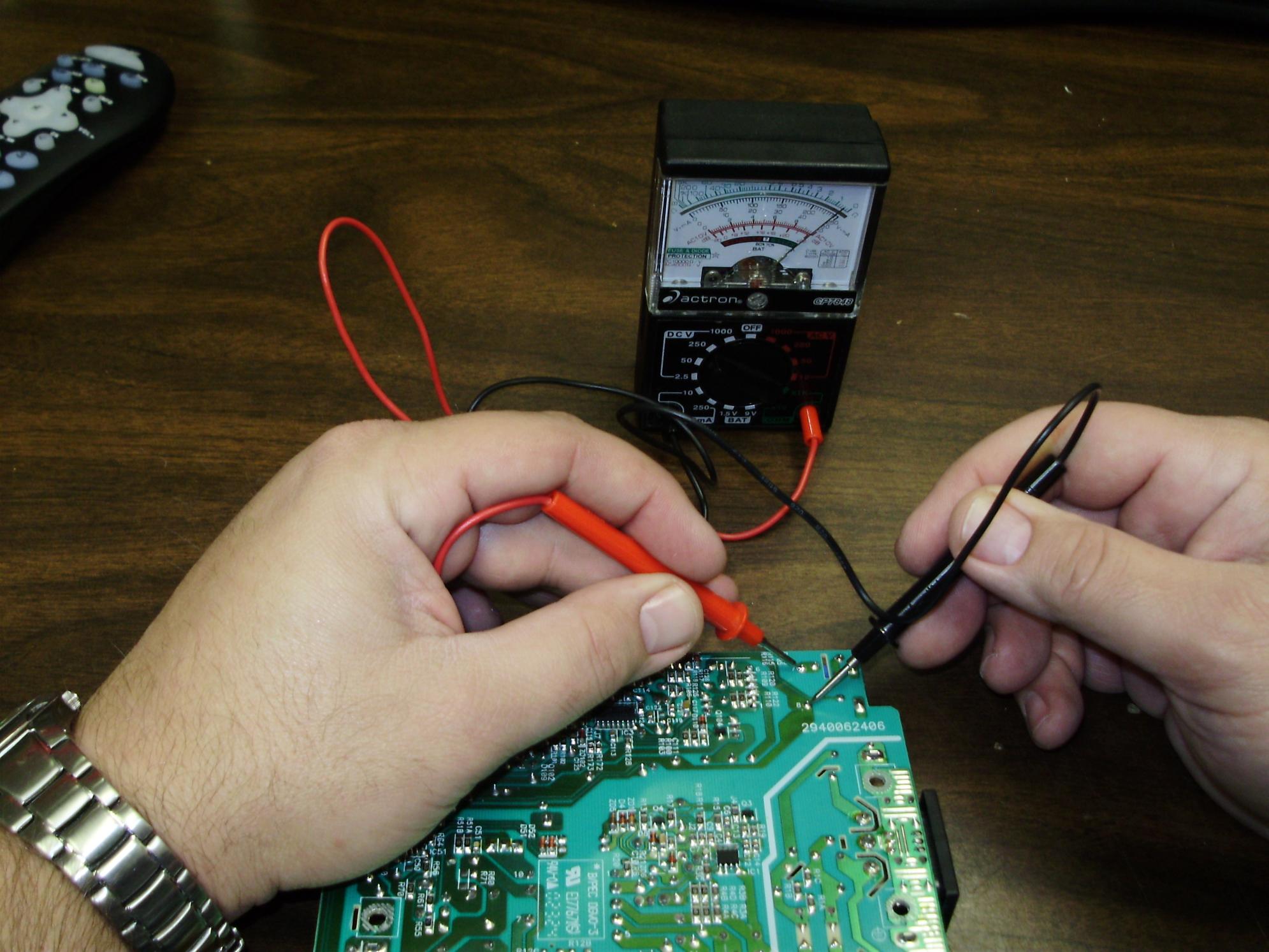

                  lol, my wife is usually first to admit Im a doofus and I runa close second.
                  ok, my MM only has 1K Ohm and 10 Ohm Setting so I used !k Ohm Setting.
                  I will post 4 pictures.
                  The 1st one shows my MM at rest.
                  The 2nd one show my MM with leads touching so you can see what it reads.
                  The 3rd shows the secondaries reading closest to the power plug.
                  The 4th shows the secondaries reading farthest away from the power plug.
                  I await your directions and Im sorry to be such a pain.

                    Try it again on the X10ohm scale. That should give you a reading closer to mid scale. We are looking at what might be very small differences in resistance.

                      ok on the 10 Ohm scale I get a consistent reading on both secondaries of 60 ohms resistance. See attached Pic of reading
