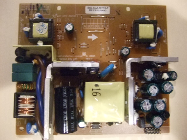

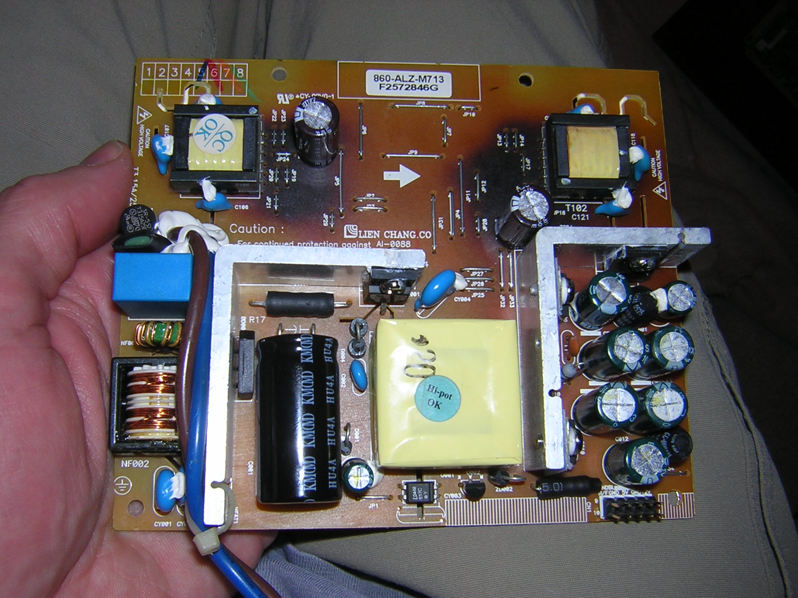

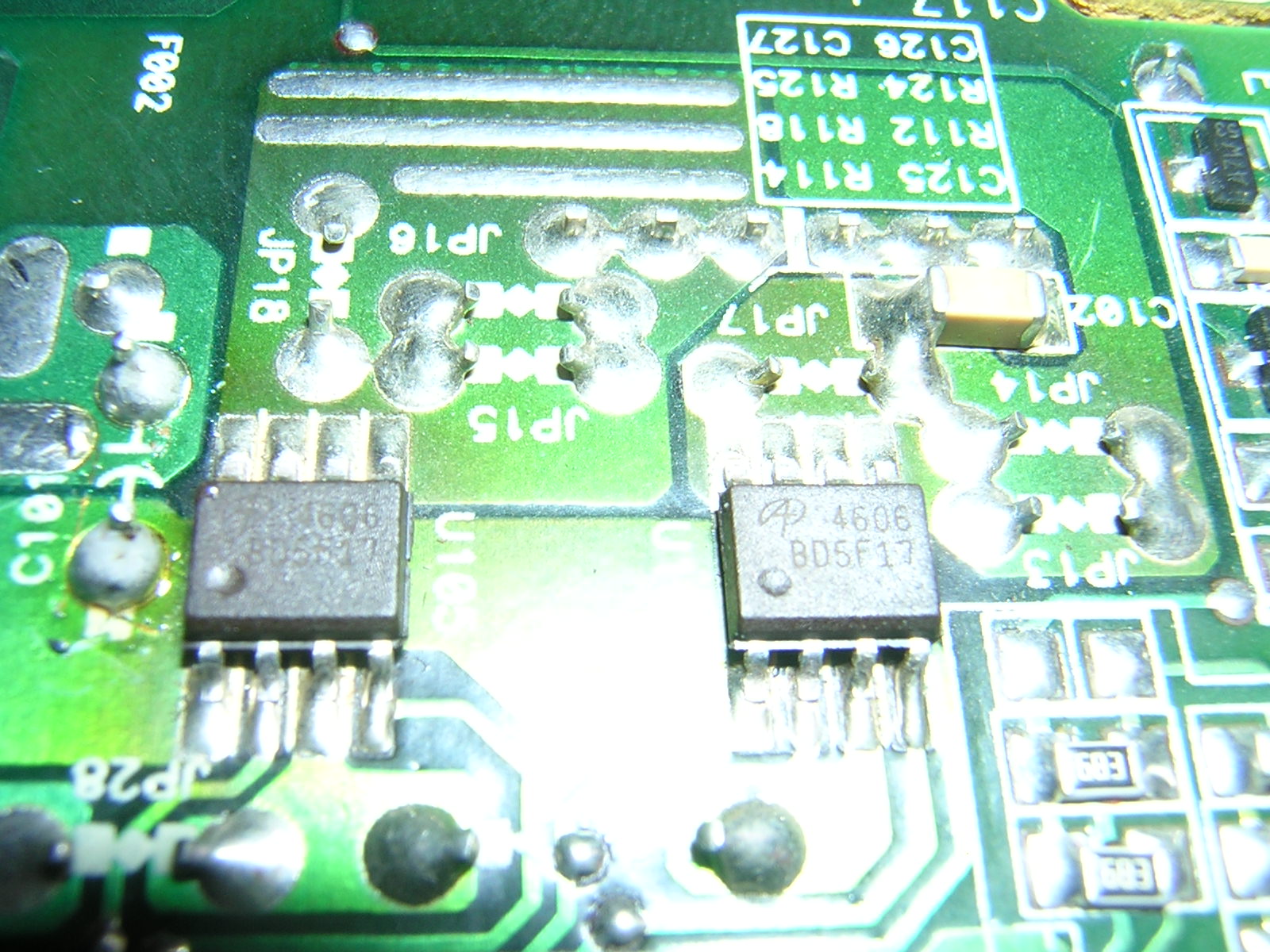

    I have a KDS 700P monitor which does not work. I opened it up and found two burned areas on the power supply board (see enclosed pic).
    In the areas that are burned i see this chip. But i cant seem to find a datasheet for this chip. I have included a pic of the chip.
    any help you can provide would be appreciated.

    That's an easy one ! AO4606
    https://cdn.badcaps-static.com/pdfs/...c6e472ae00.pdf
    The AO4620 is the replacement for AO4606. You can still buy the AO4606 from from Ebay but not from Digikey.

      thanks!!!!!! How did you know the part number is AO4606? I was stumped....could not figure it out. I thought the 2nd number was the part number.

        Can you tell from the data sheet if D2 and D1 are shorted? When i take a meter and measure the resistance from D1 to D2 i get a short.......but i am not sure if this is how it is supposed to be or not?

          Well search using wildcard *4606 and that other website
          http://www.alldatasheet.com/
          Have a better search engine then
          http://www.datasheetcatalog.com/
          Either way you should be able to get some anwser
          Originally posted by Welchs101
          Another quick question.........
          internally no that are not connected. on the board yes that OK.
          Measure from the gate to drain, and source to drain to see if shorted

            Measuring the primary side of the transformer. There appear to be 6 pins on what i would call the primary side. ALL 6 pins are shorted..........is this NORMAL?
            • sofTest
              • Aug 2008
              • 361
              Re: Need help identifying IC (BD5F17) from KDS 700P monitor.
              SO this leads me to ask the question........what could have caused the "burnt" spots on the pcb board.
              Bad solder joints on the transformer legs? Try re-flowing them.

                        Start by checking the power supply out voltage.
                        Are you getting a steady +5VDC and +14vdc?
                        About the dark spot on the top side of the board. This is normal heat burn mark from the four AO4606 and not from the transformer.
                        Also check for shorts across the power supply.

                              Well, IT WORKS!
                              Using what you guys said i started probing around. I started with the voltage across the big filter cap......then I discovered that my friend had not replaced ALL the caps that he said he had. I found one cap "near" the big filter cap which was "bad". I replaced this cap. I looked at a few other caps which were not replaced. They were the SAMXON brand which i remember reading on here that these were "bad" so i replaced the other caps as well. Good thing i did since after i removed the caps i measured them using my cap meter on my fluke........they were not 100% bad probably getting close.
                              I replaced all the caps on the board with new ones.........plugged everything back in and the monitor WORKED!!!!!!!!!

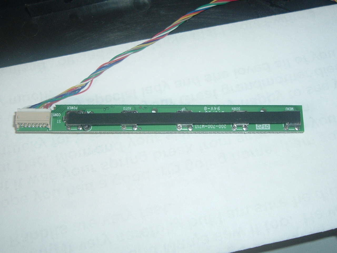

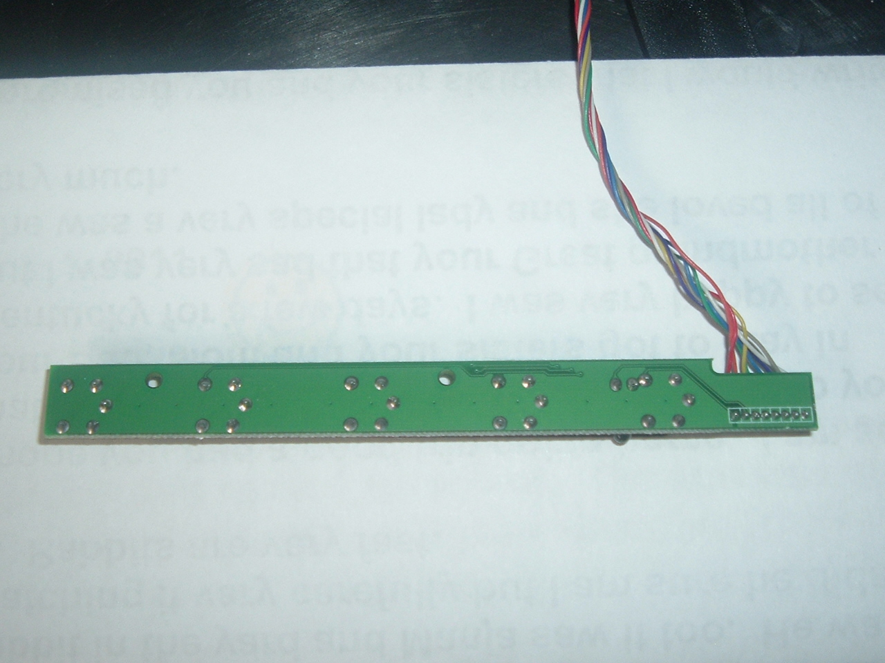

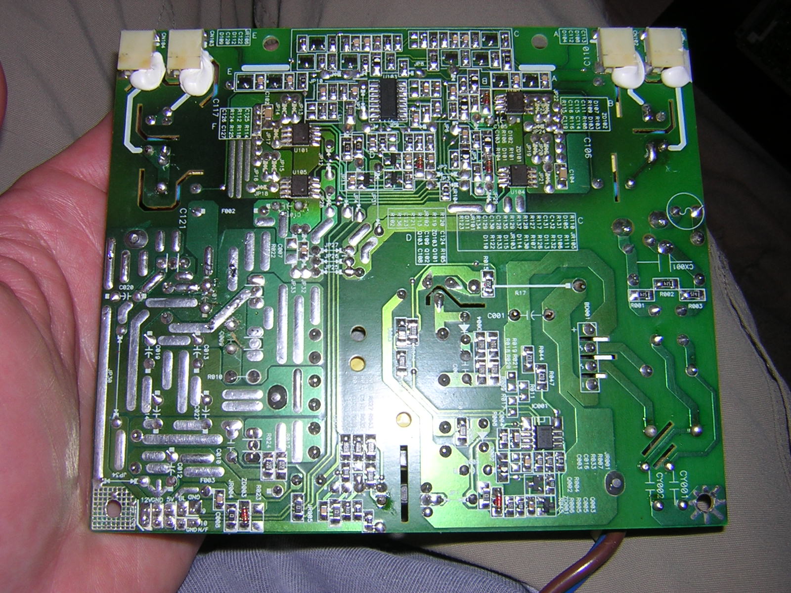

                                    I looked into the fuse and connector advise and could not find any issues. The LED for the power button is green when I test it so I am stumped.
                                    I am not an electronics wiz, for this issue I am more of a one trick poney. I have fixed about a doz monitors now with only the knowledge of replacing the PS caps and have had good luck with this as I have always found the bulged caps every time I opened one up.
                                    Anyway this one has the good brand of Samxon for all but the big guy and that is a KM(M) but they rarly go bad from what I know. I guess I will replace the four 1000uf x 25v, two 470uf x 25v and the one 220uf x 25v and see where that takes me. If that does not work I will ask if anyone wants a monitor for parts or repair as I will be outa my leage.
                                    Thanks for the help, I did add a few pics of the board in case you can see something I do not.

                                      What I am seeing is someone who is not listening. By your description, the problems is NOT the power supply, it is not the signal card, it is the LCD panel card. Post a picture of the back of the LCD panel, or stop wasting my time.

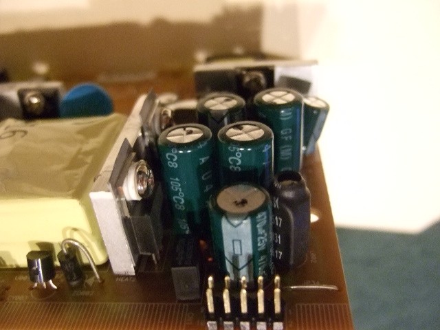

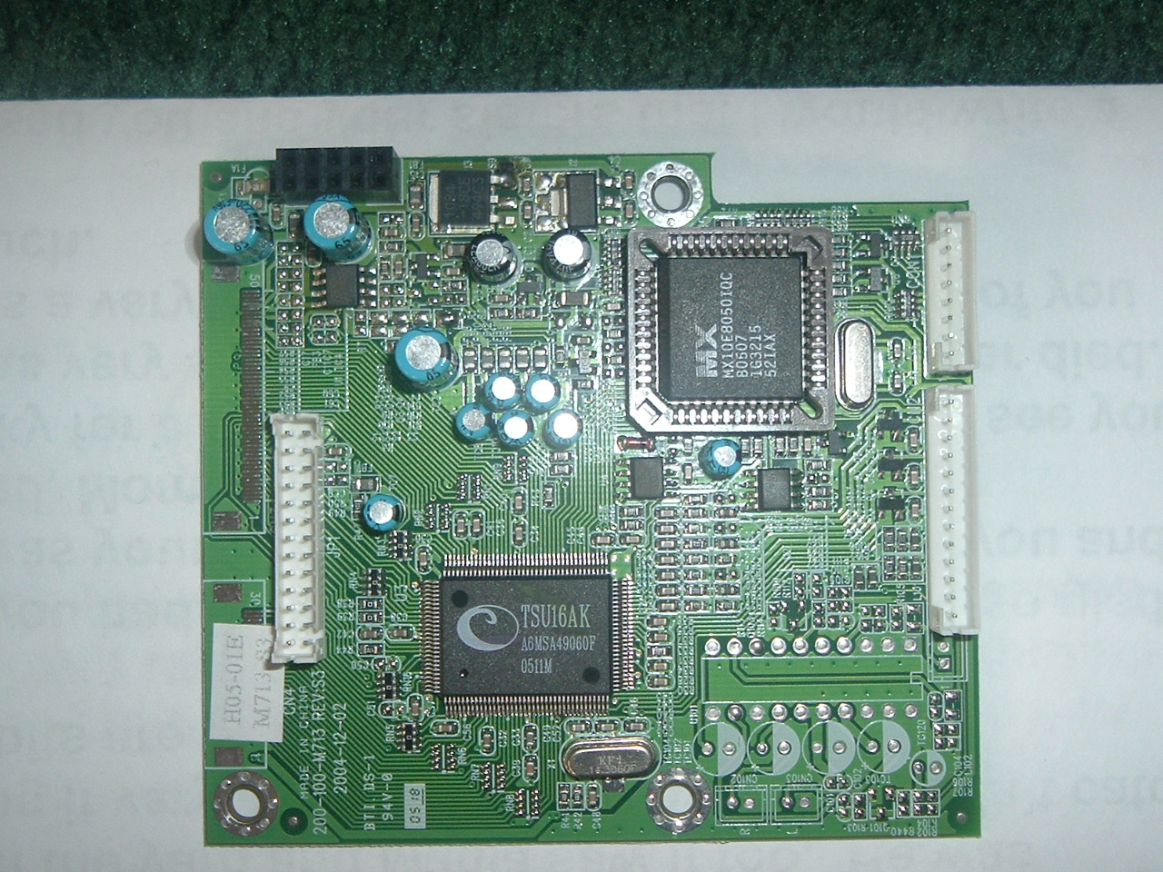

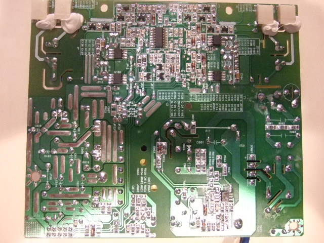

                                        Sorry for the long lead, I am have some time now to get back to this. Also sorry for not mentioning that I did look at the panal when you brought it up, I should have said so but I forgot since I did not see anything about it. All it is is four buttons and an LED. I did attach photos of the front and back of it.
                                        Since I am a one trick pony on these I orderd a set of caps and replaced them hoping for the best. It did not work out, still have the same issue. The monitor is full bright all day long. It will since the presence of a video signal when I switch the note book PC I use for testing from onboard LCD to external and back but that is all it does other than make a nice large square desk light. The only button that works is the power and all the others do not give me any menu nothing.
                                        I was looking at the signal board wich I also included a photo of and doing some searches on it but I could not find any silver bullet type fix for it.
                                        Thanks for the help and sorry for taking so long and the incomplete info.
