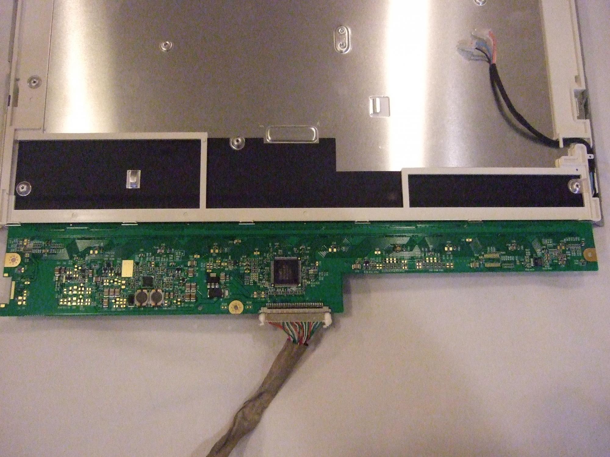

    I think the "panel" that PlainBill is referring to is the LCD panel control board that spans the horizontal width of the LCD panel. It may be hidden by a cover plate or underneath a clear plastic cover. It's connected by ribbon cable to the logic board.

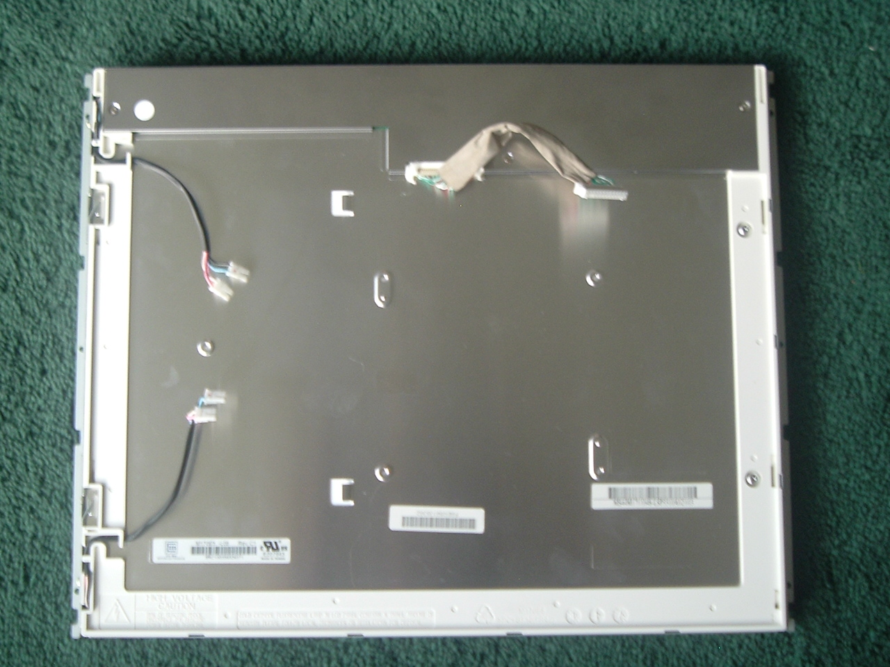

      Re: Need help identifying IC (BD5F17) from KDS 700P monitor.
      This is the photo of the back of the LCD panal, the data cable is glued down to the socket pretty tight and I insure the data cable to the signal card is fully seated when I test it as well.

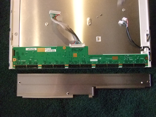

        Where the cable is running underneath the metal plate at the top. I think that if you remove the 3 screws, it should allow you to remove the plate to expose the circuit board underneath.

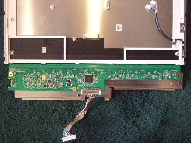

          Looks like I cross posted with Jetadm. I attached a couple of pics of the monitor logic board. I would hate to have to change that board from the way the cables are attached to the monitor. If that is the problem I would consider this thing to far gone to fix for my abilities.
            The resolution of your photos are too low (max on this forum is 2000x2000) for us to make out any PCB designations, but most of these panels have at least one SMD fuse. It will be marked something like F1.
              Unfortunately, you cannot replace this board as it is part of the LCD panel. You will note that this board is connected to the LCD panel through 5 flat ribbon cables. These cables are "welded" to the panel using specialized equiptment at the factory.
                This one is a bit more clear but the lighting is not good and the flash washes it out. I will look for the F1 and see what I can find.
