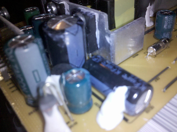

    Another Westinghouse LCM-22w3
    About 4 months ago my monitor starting making a high pitch noise when turning on and off. At first it was no big deal, but soon the monitor would turn on to a white screen and require turning the monitor on and off multiple times in order for the picture to finally show up.
    I checked around and it seems like some others have had similar problems and it was caused by the capacitors being blown. I just opened up the monitor (pain in the ass) and it looks like the tops of the two larger black capacitors have started to push out and have a little bit of brown on top. They still don't look anywhere near as bad as others I've seen in other peoples pictures... so I was wondering if they look like the cause of the problem. I wiped a little of the brown off the top of them, but you can kind of tell how they are different than the others.
    It looks like only the two large black capacitors need to be replaced because all the green tops are still flat. Does anything else besides the two black caps look strange and where should I get the replacements?

    Based on the experience of numerous people, don't screw around just replacing 2 caps. You didn't get bit by a couple of bad caps that slipped through the quality control process. It looks like you have a mix of CapXon's and Elite caps, both of which are known bad manufacturers. Replace only the two that have failed and in a few months you will likely be opening the monitor to replace more that have failed. I've circled all the caps that should be replaced.
    PlainBill
    There are two ways to do this. One way is to follow this process to locate the proper replacements. FWIW, I prefer to use Panasonic FM or FC series caps but other brands are also excellent. I use Digikey because they offer shipping by First Class mail. Mouser is another very good source.
    The other way is to post the manufacturer, series, capacity, voltage, height, and diameter of each cap. Someone will respond with the recommended replacements.

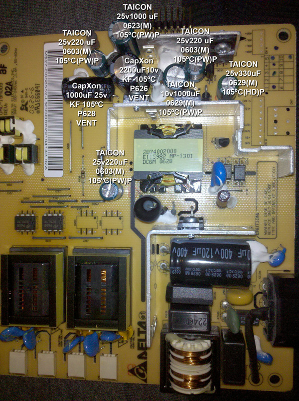

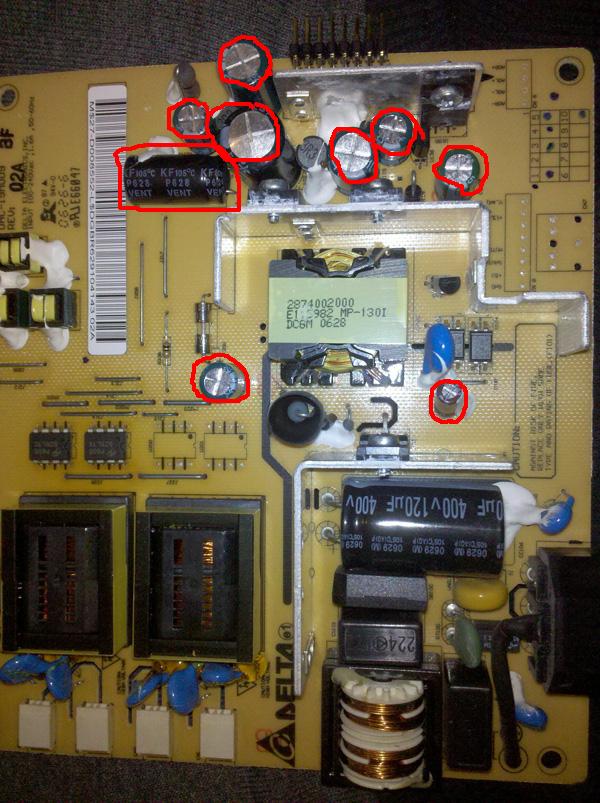

                Ok, I removed all the caps and have labeled the screenshot attached and also listed them below. I'm very new at this and didn't have a proper setup, so I kind of scratched the board a little while removing the solder... Nothing serious, but minor scratches here and there around the areas of solder. Could the board have been ruined?
                Here is a list of the 8 caps I removed to have replaced:

                  Rationalizing the list slightly, I come up with this:
                  3 ea 220uF 25v P12383-ND EEU-FM1E221 @$.32 ea
                  2 ea 1000uF 25v FC Series P10278-ND EEU-FC1E102 or P11223-ND EEU-FC1E102L or P10279-ND EEU-FC1E102S @ $1.00 - $1.20
                  1000uF 10v P12353-ND EEU-FM1A102 or P12354-ND EEU-FM1A102L @$.50
                  330uF 25v FM Series P12386-ND EEU-FM1E331 or P12387-ND EEU-FM1E331L @ $.37
                  2200uF 10v P10230-ND EEUFC1A222 @ $.90
                  All part numbers are Panasonic; all stock numbers are Digikey stock numbers. When ordering from Digikey, specify the First Class Mail delivery option. It is cheaper and faster than Priority Mail for small packages.
                  There are a couple of problems with this list. First, you did not specify the dimensions of the originals. It is now YOUR responsibility to make sure these will fit. I have indicated alternate sizes when available in Panasonic.
                  Second, I take the attitude that when replacing junk with first rate it isn't important to match the specs of the original exactly. Anyone who wants to compare the specs of the originals and propose better matches is welcome to do it.

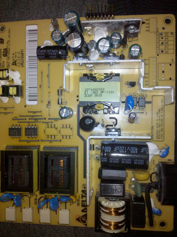

                        Great news! I finished replacing all the caps and the monitor is now back to working like the day I bought it. It turns on and no longer makes noises or switches to a blank white screen.
                        Thanks again guys, especially PlainBill, I really appreciate all the help you gave and finding replacement parts for me, you made this experience very easy and stress free.
