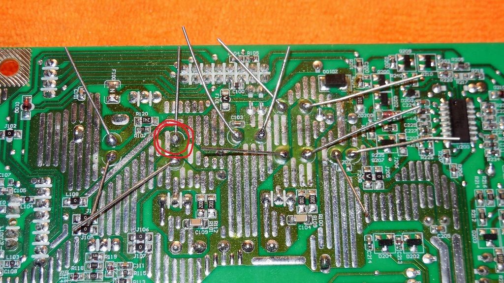

      Re: Another Westinghouse LCM-22w3
      hi everyone. im very new here and cant post a my own thread. i just happen to be replacing caps on this board. ive been electronics tinkering for my whole life. i know a few things. one thing i never questioned and stayed away from till now are the parallel sauter lines on the backs of some boards. they stay within a trace. they seem like maybe a continuity measure. but anyway ive never hit one by accident till now and was wondering if its ok. the cap and the "line" are on the same trace so it seems ok.
      i also dont think i can post pix so ill leave a photobucket link.
      http://i5.photobucket.com/albums/y17...b.jpg~original
      thanks
      Fat
        The solder adds (a little) to the current carrying capacity of the circuit trace like using a thicker copper but cheaper. As long as you didn't short any adjacent traces you'll be fine.
        • FAT
          • May 2017
          • 5
          • usa
          thank you very much
