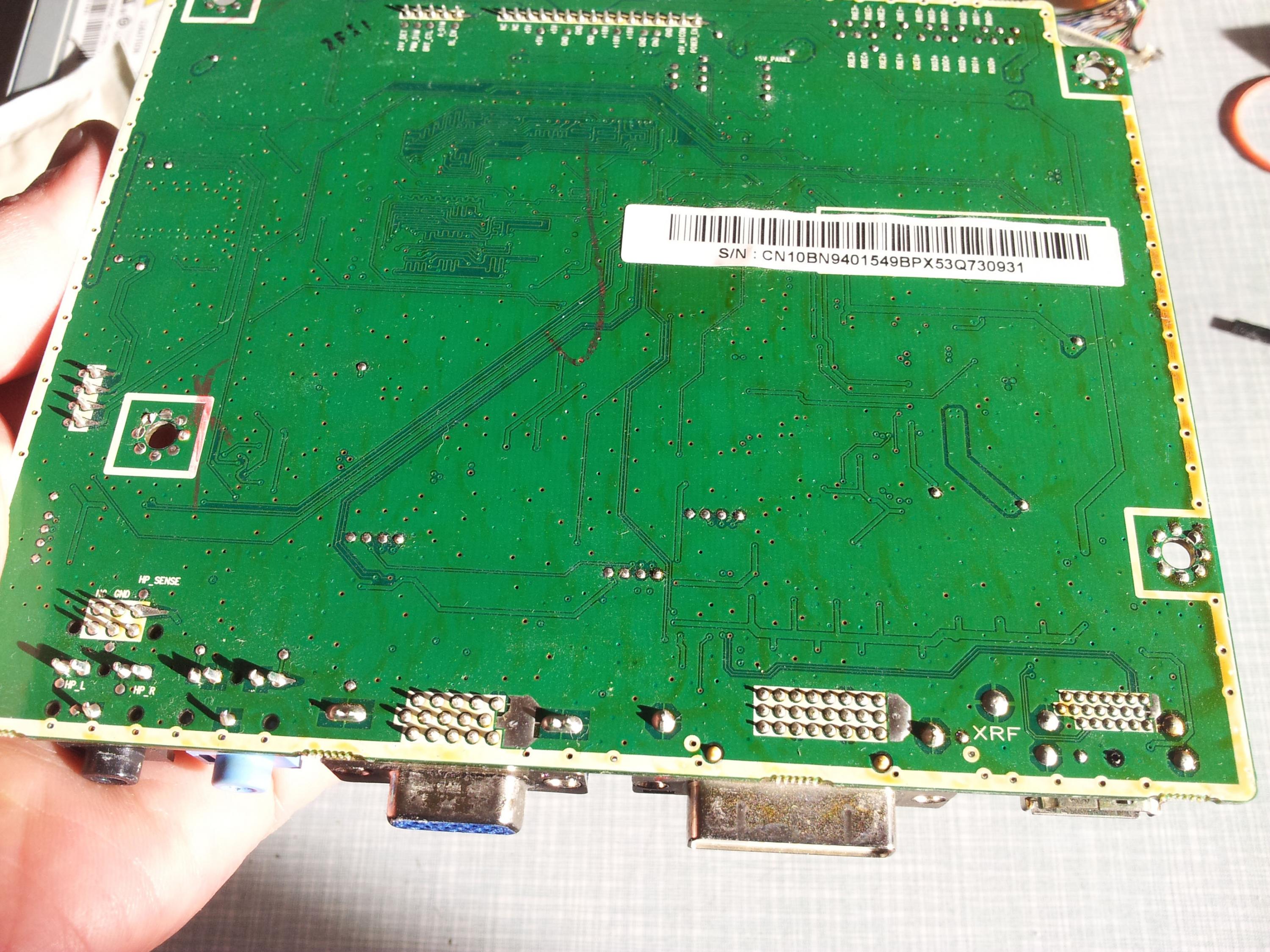

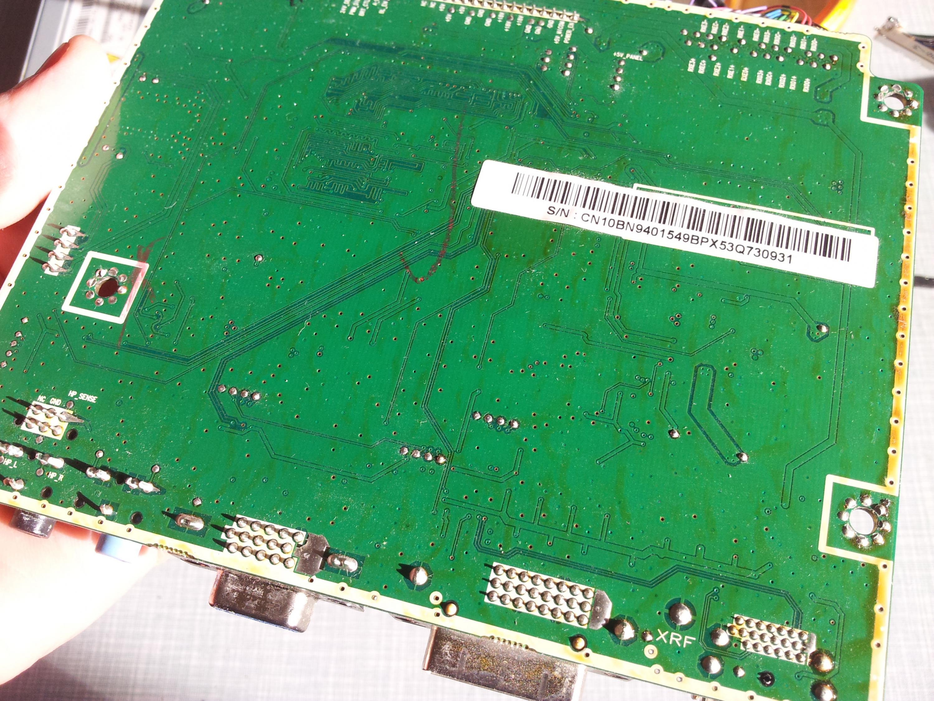

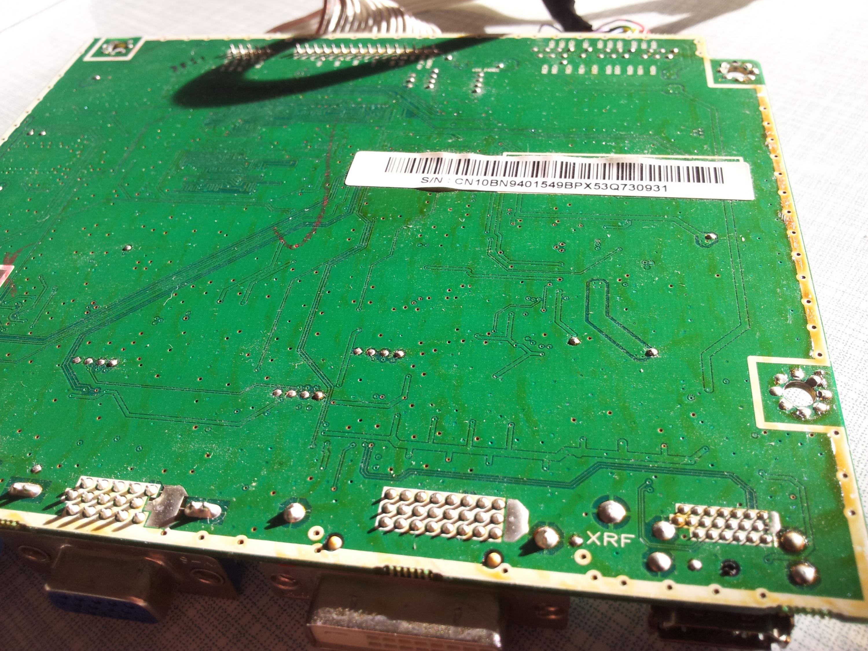

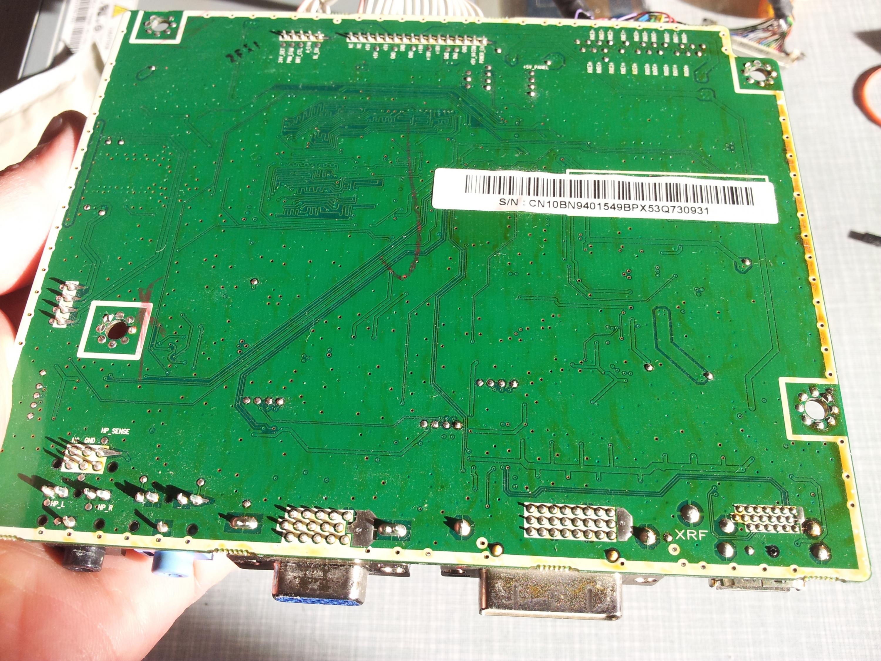

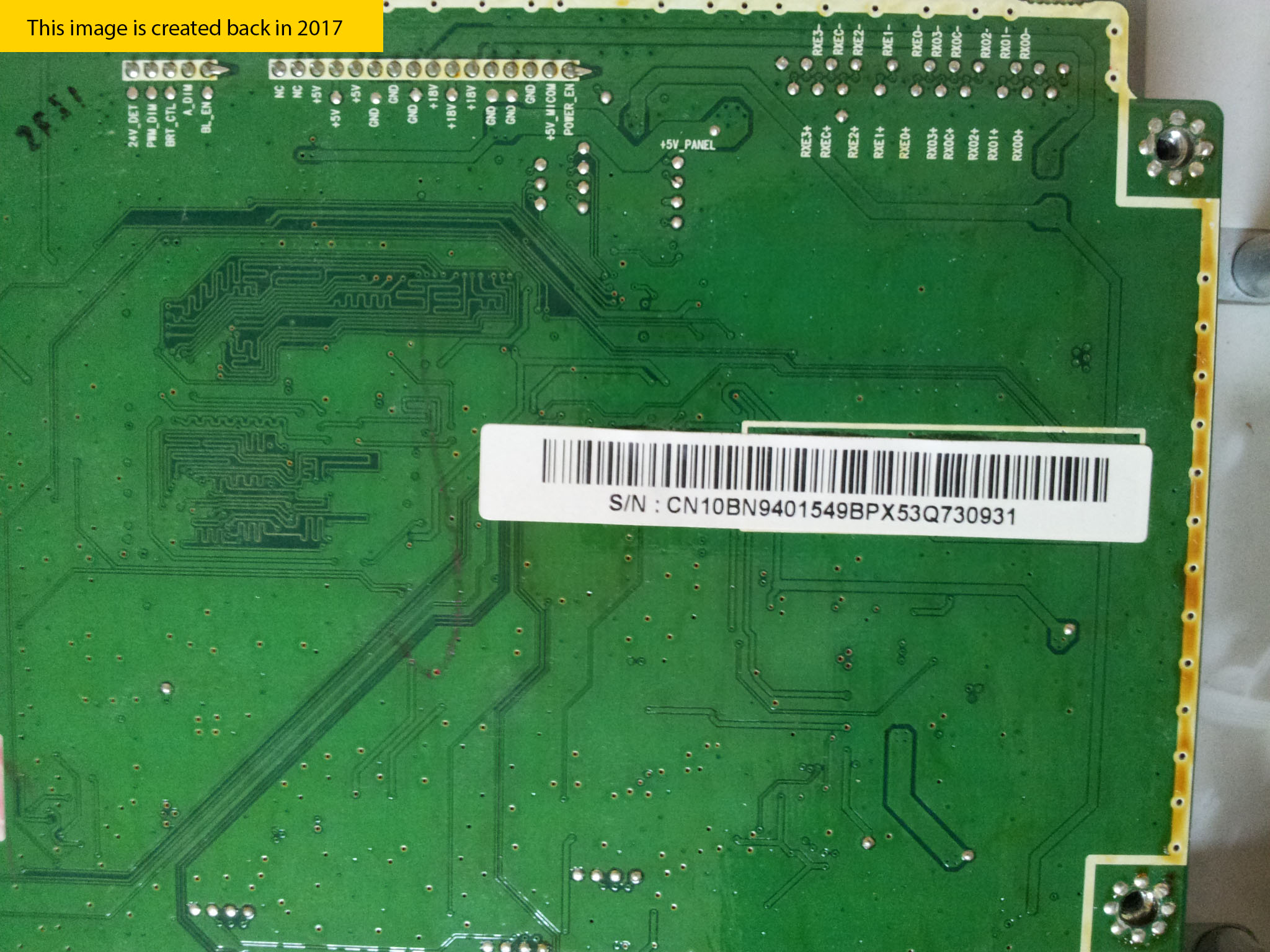

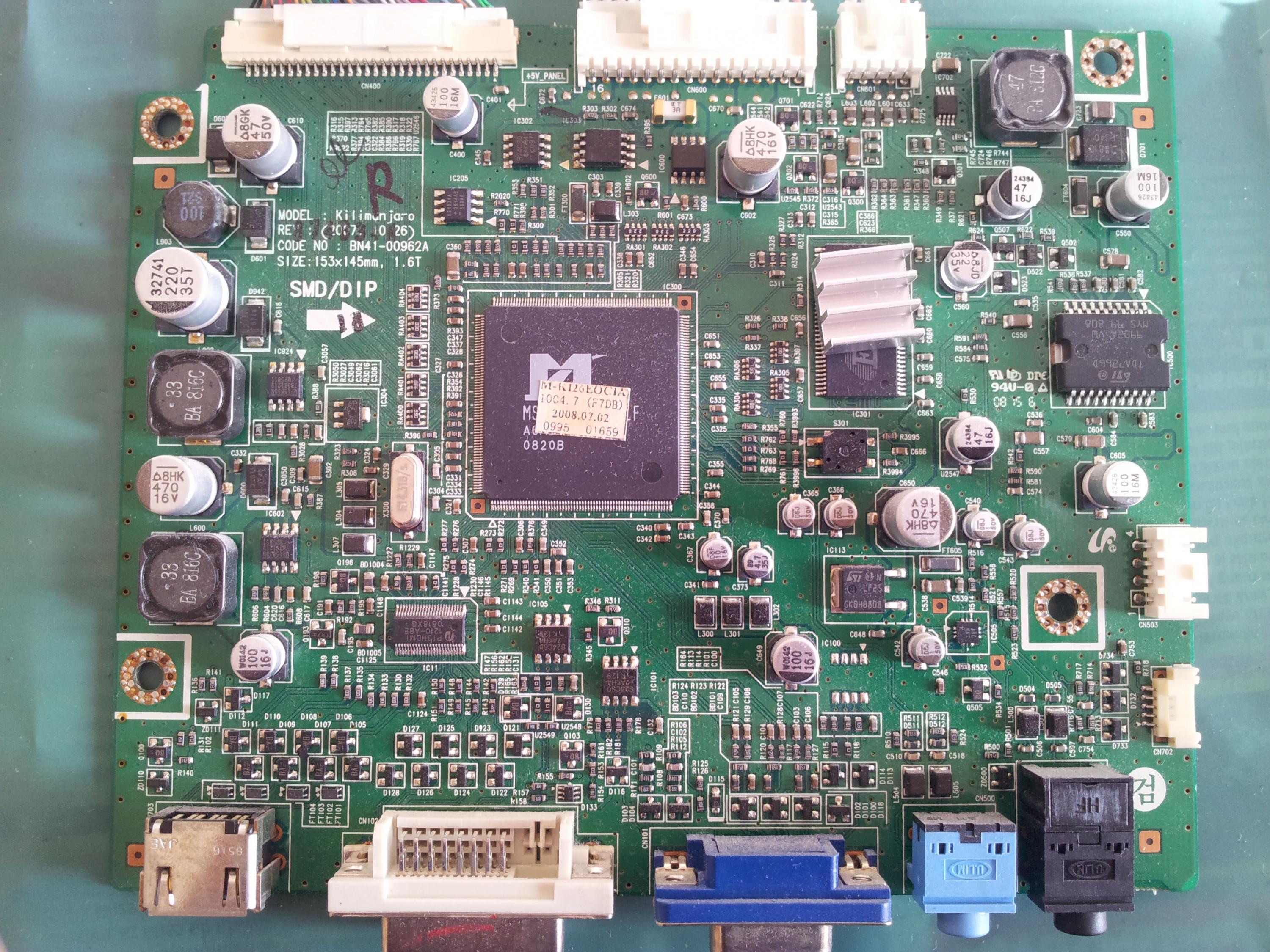

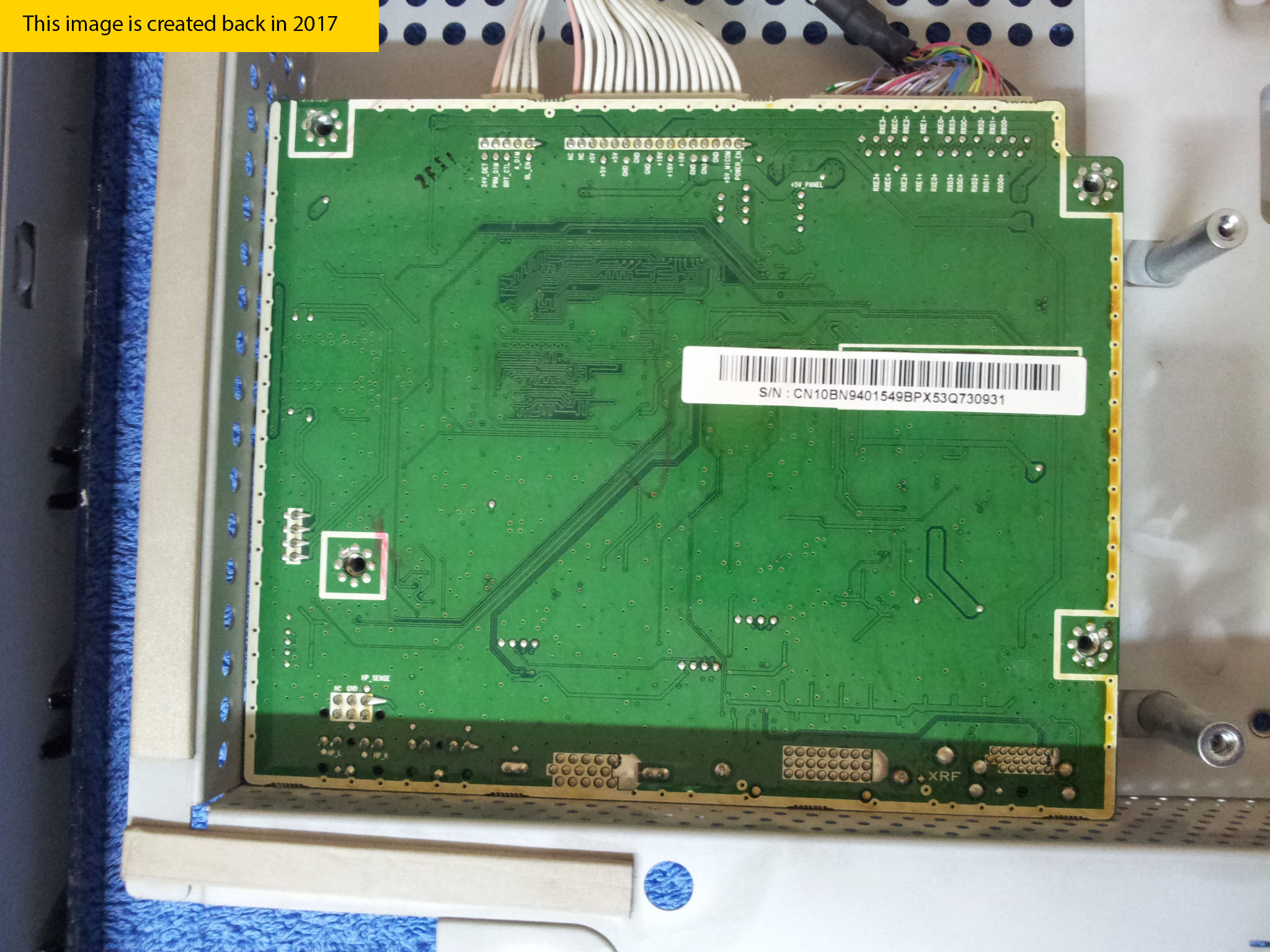

    I made some photos of the main/logic board. Please check the attached photos. First 8 images are 'fresh' and last 2 are from back in 2017 (just so we can compare them).
    What I noticed and what I tried to 'catch' with my phone camera are those....(kinda) like.... 'flame drawings'. You know, like when you try to draw a 'flame'. I thought 'oh, my main board is burned completely. You'll notice also at the right edge that its not a clear 'white' line but 'dirty yellowish' one. I managed to clean that line with 99% Isoprophyl alcohol. There is also some (I think a guy who assembled/checked the monitor in factory marked it with a pen), 'sign' on the board. I managed to almost clean that as well. Also tried to clean those 'flames' markings and I think they can be 'removed too.
    But anyway, I thought board is burned. Then I had an idea to try and check if I have some old photos from back in 2017 of the same board. And...to my surprise board had the same 'flame markings' like it has now. So now I don't know what to think, but you might have an idea what those 'flame markings' mean?
      Thanks!
      Really good quality photos, by the way. That really helps.

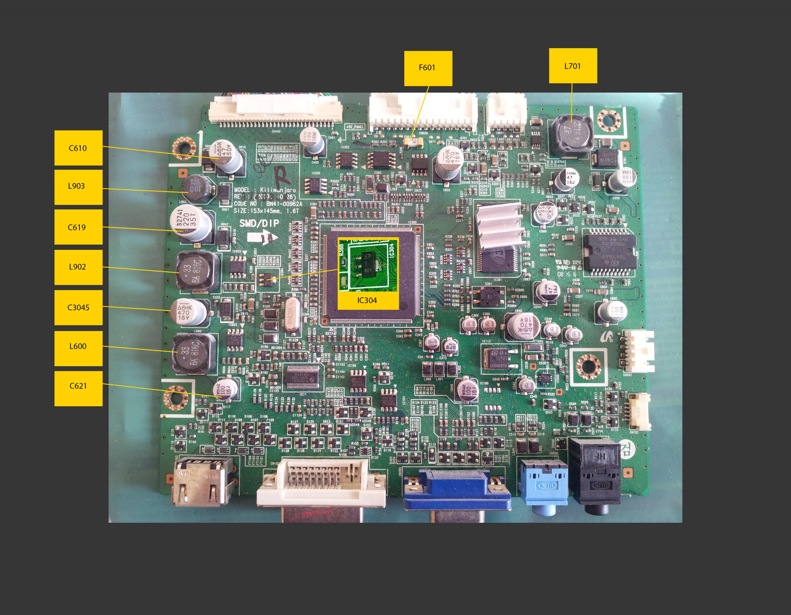

      There is a white 3 Amp fuse at the top, below the middle connector.
      Check the resistance of this fuse and make sure it is not open-circuit.
      Next.... I was wrong about there being only two voltage regulators. This board appears to use several buck regulators instead (as the round SMD inductors on the left side of the board suggest.)
      If the 3 Amp fuse mentioned above is OK (i.e. shows good low resistance), then check the voltages (relative to ground) at the positive (+) terminals on the SMD electrolytic caps on the left side seen in the first image of the logic board. The negative (-) terminal on these SMD electrolytic caps is marked with a black semi-circle on top. So the positive (+) terminal is the one opposite to that. Report what voltages you get, starting from the cap at the top left side (it appears that cap is labeled C610 on the PCB.)

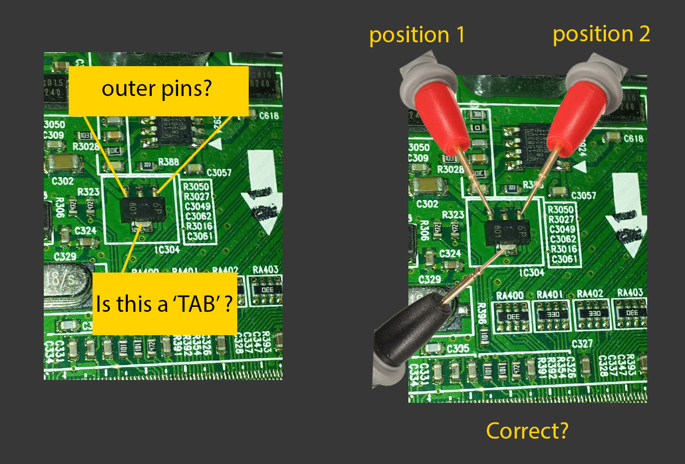

      Also, check the voltages on the tab and two outer (left and right) pins of IC304 (it's located to the left of the big "main" chip in the middle of the board.)

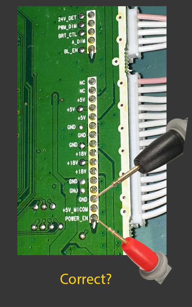

      Lastly, measure the voltage (again, relative to ground) on pin POWER_EN while plugging in the power supply in the wall. (Note: this is the same pin that connectors to PS_ON on the power supply board.) Also, if possible, try to measure the same pin when you press the monitor's power button. Do this test, only if the 3 Amp fuse above tests good, though.
      On a separate note, what happens if you disconnect the LVDS connector (the one with the multi-color wires seen on the top-right of this picture) and plug in the monitor. Does the monitor's power LED indicator light still glow as it would normally when the monitor is in standby mode? What about if you disconnect the small connector on the right (again seen in the same picture above) that's for the inverter control. Does that do anything for the power LED indicator? Basically, I want to check if there is some type of feedback circuit in this monitor that prevents the logic board from showing any activity if it doesn't detect certain voltages.
      That's leftover flux from when the board was manufactured (soldered.)
      It's nothing to worry about and can be left alone.

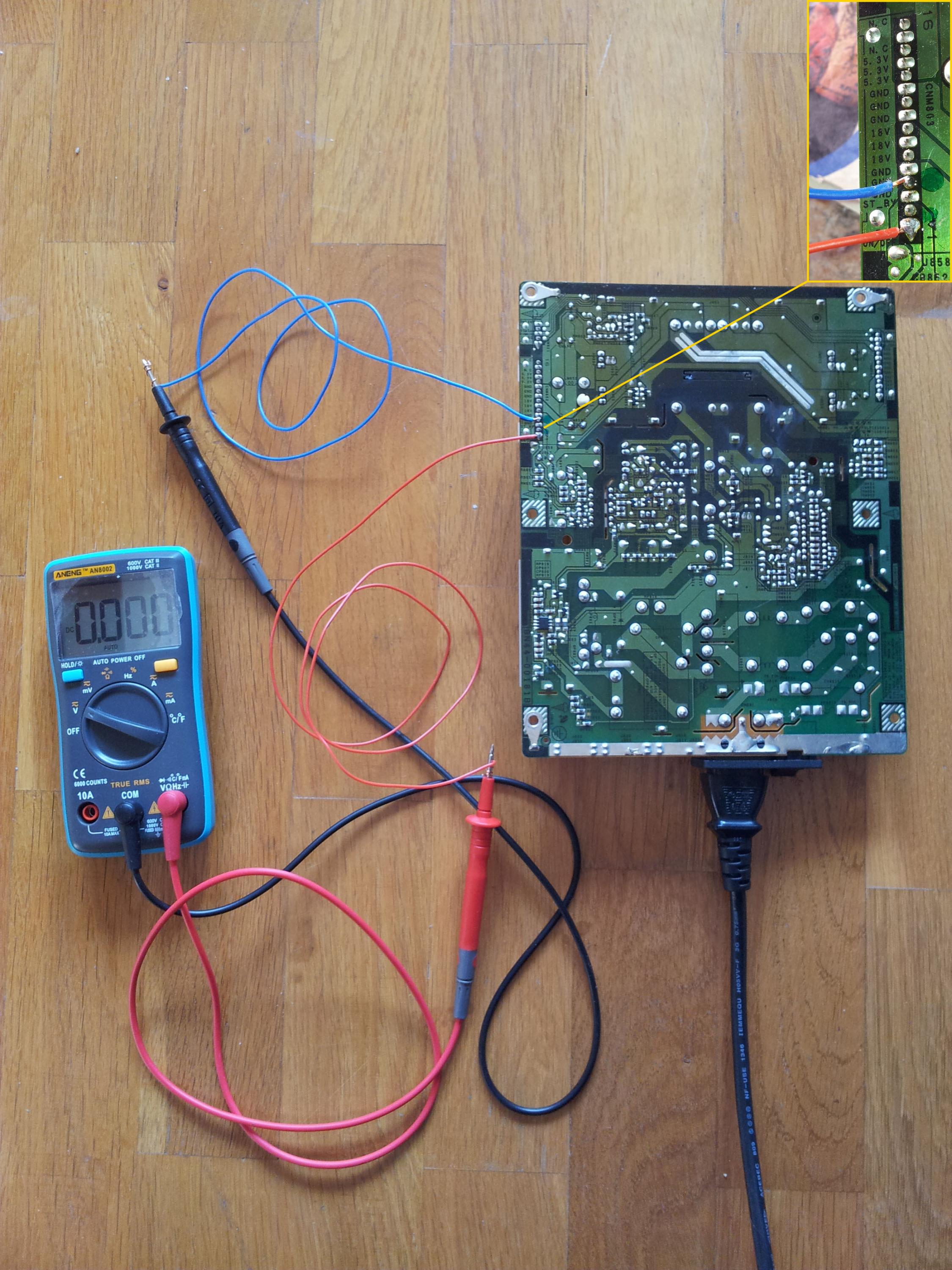

          Hey guys. Thanks for your answers.
          I kept re-reading your posts, and somehow I have a feeling that you have wrong imporession about something. About how I measured that BIG FAT capacitor, (or any other measure).
          So please let me explain it first...
          I pulled out bare power board out of the monitor and put it on the table. On the table there were NO OTHER boards present and NO OTHER boards connected to power board. I only attached power cable to power board, and connected the cable to a wall socket. Thats it! No other boards were connected. This is how I tested some elements before this post.
          Originally posted by R_J
          Have you tried disconnecting the cable between the main board and the power supply to see if you get the other voltages?
          With the cable disconnected, the PSON pin should be close to 4~5 volts
          These power supplies usually have a pullup resistor to turn on the power supply when the main board is disconnected from it.
          Thanks R_J for trying to help me!
          Ok, so yes, as I said I did NOT have any other board connected to my power board while I was checking that BIG FAT cap (and also a standby voltage on a CNM803 connector of my power board).
          BIG FAT cap voltage is checked like this: I put negative probe at capacitor negative leg, and then I touched capacitor's positive leg with postitive probe.
          I hope thats correct, because at one discord electronics channel (which some visitors of this topic are also members of), that I should NOT touch with my negative probe a ground while measuring that big fat cap. So I just touched its legs directly (negative probe to negative leg, positive probe to positive leg, and it showed 307v).
          So R_J, to answer your question: Yes, since I didn't even had main board connected to power board, while I was testing a big fat cap, these are 'the other voltages' that you asking me to check.
          If you want me connect only main board to a power board and put them 'bare' on the table while no other monitor elements are connected (T-CON, inverter, lamps), just these 2 boards (main and power) connected to wall socket, I can do that. But together, I can't do that because its not easy (at least not for me, and aside from that I'm scared if I have to have all things connected while monitor is open and under voltage).
          So, can you tell me what kind of checking I should do, I mean what parts should be connected and what can stay disconnected? (sorry that I'm scared this much, but I'm not rushing things before I'm sure what I'm doing)

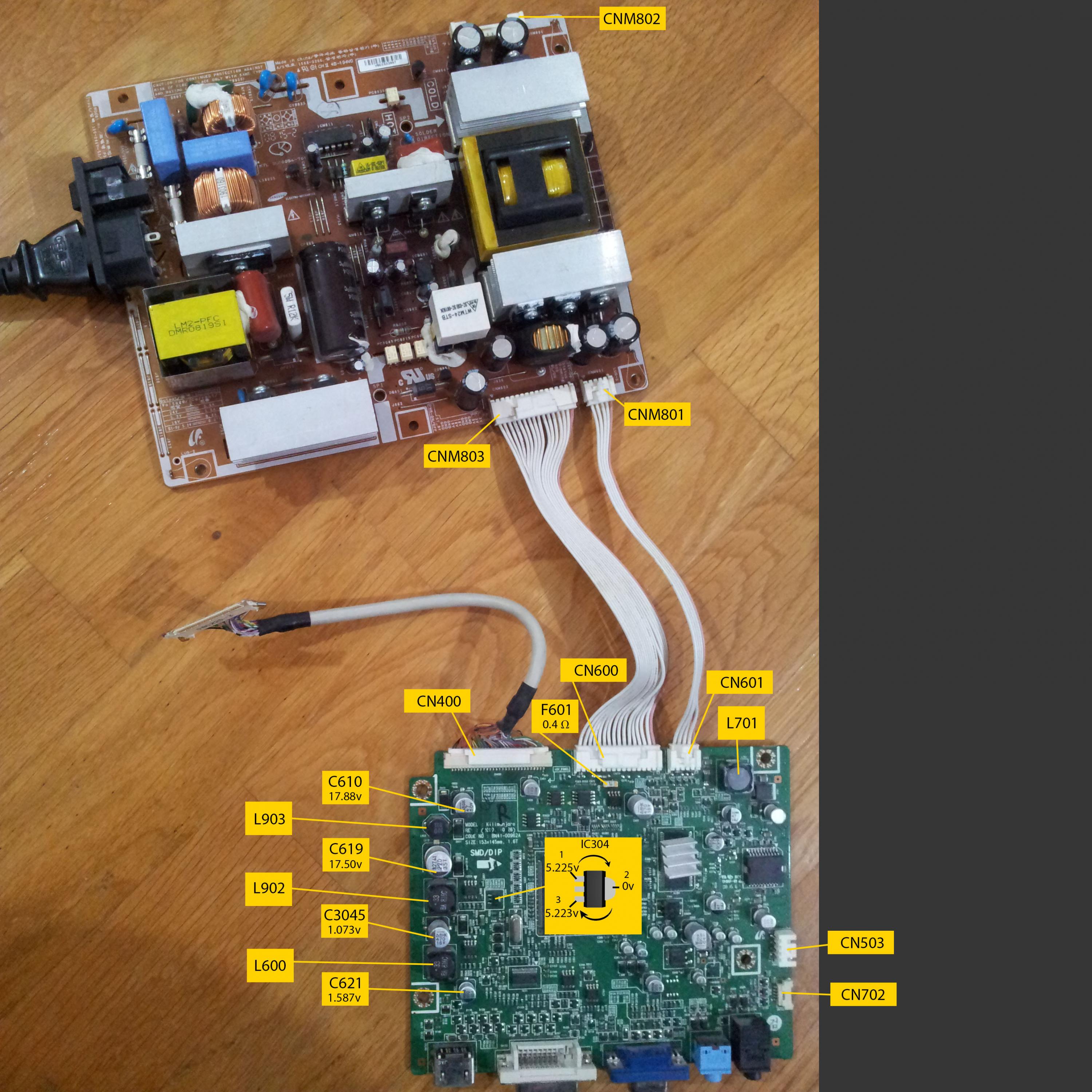

          Ok, this is the only question right now that I can give 100% clear answer.
          Fuse F601 is not open-circuit (it beeps in multimeter continuity mode)
          Fuse F601 resistance is 0.4 Ohm
          Resistance between probes of my multimeter is also 0.4 Ohm

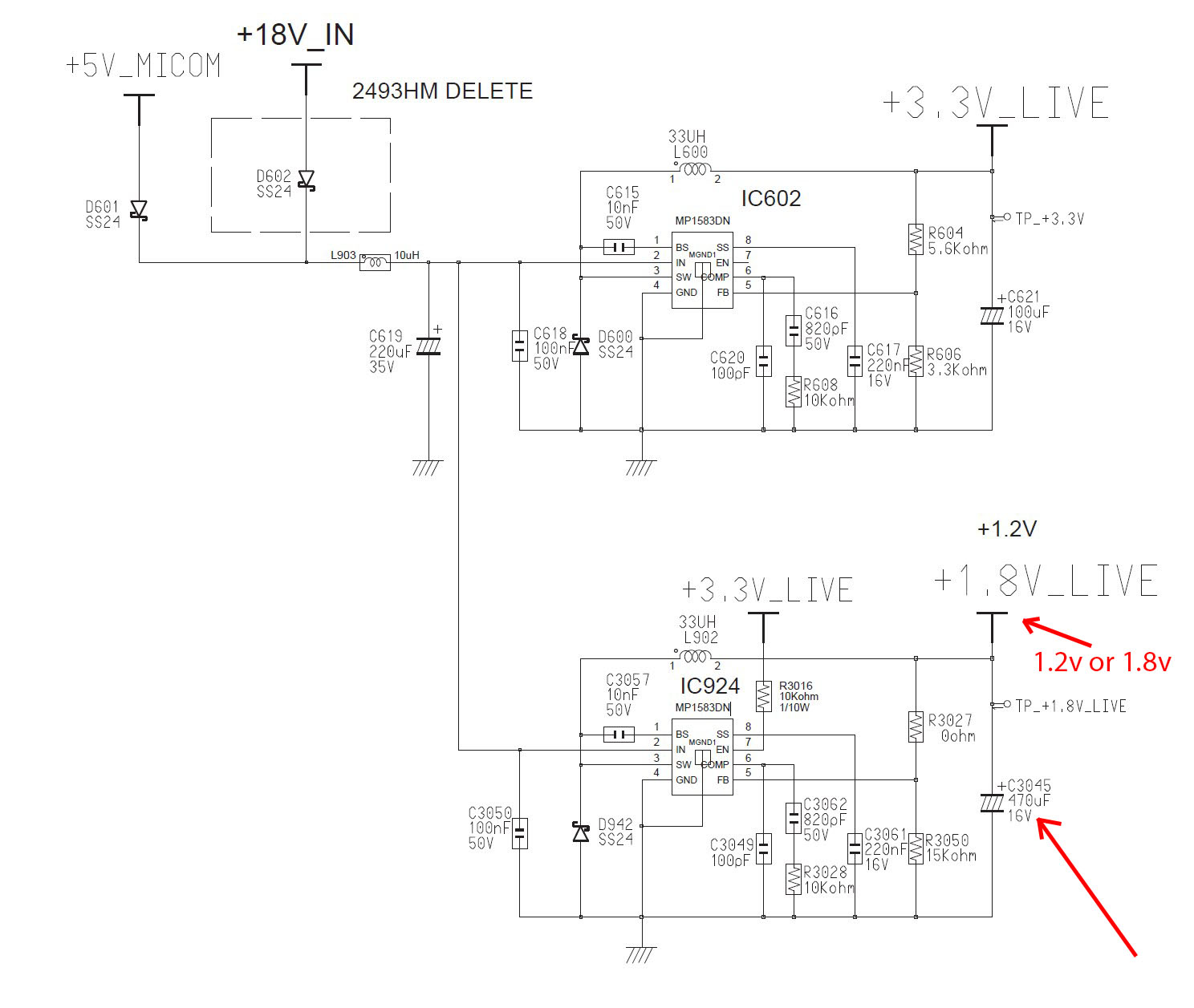

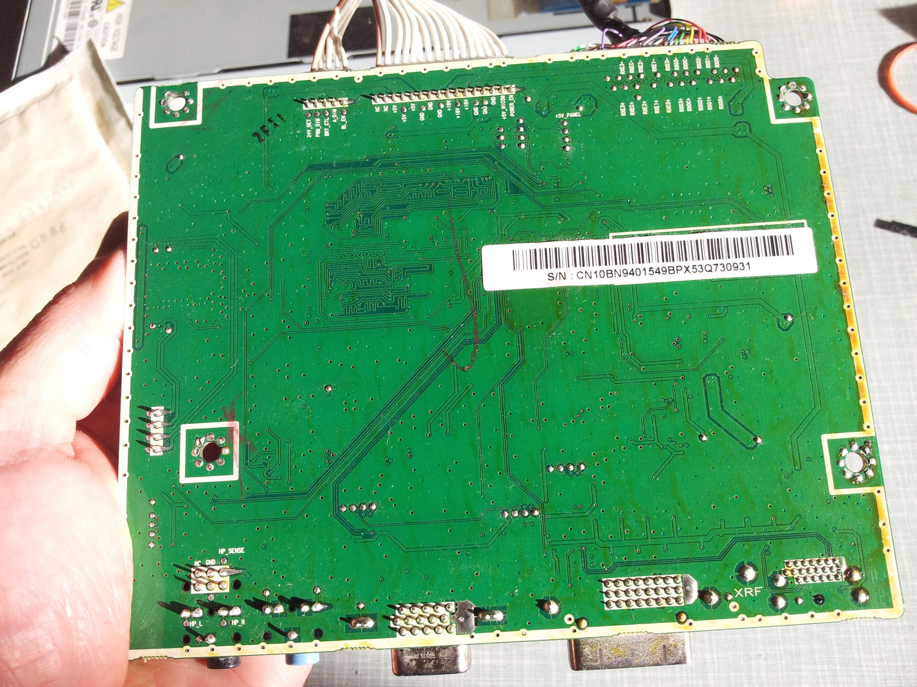

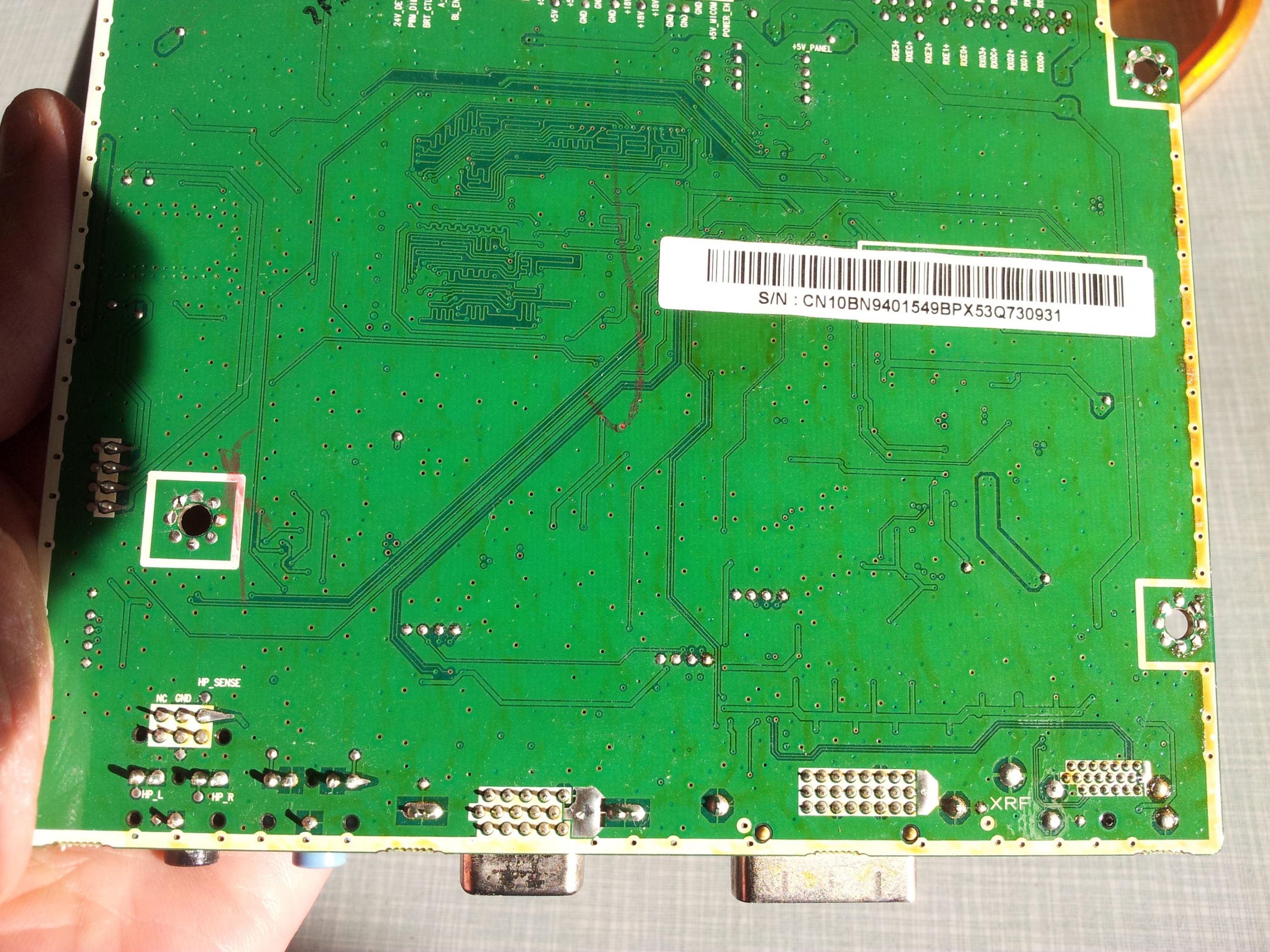

          btw. I uploaded first 2 images, in case you need to know what are the board markings of specific elments. Do note that on the first picture there are power and main board 'connected'. I just connected them like that so you can visually see it, but they were NOT connected at all while I was measuing standby voltage and big fat cap of the main power board. (only power board was connected throgh the cable to a wall power socket)

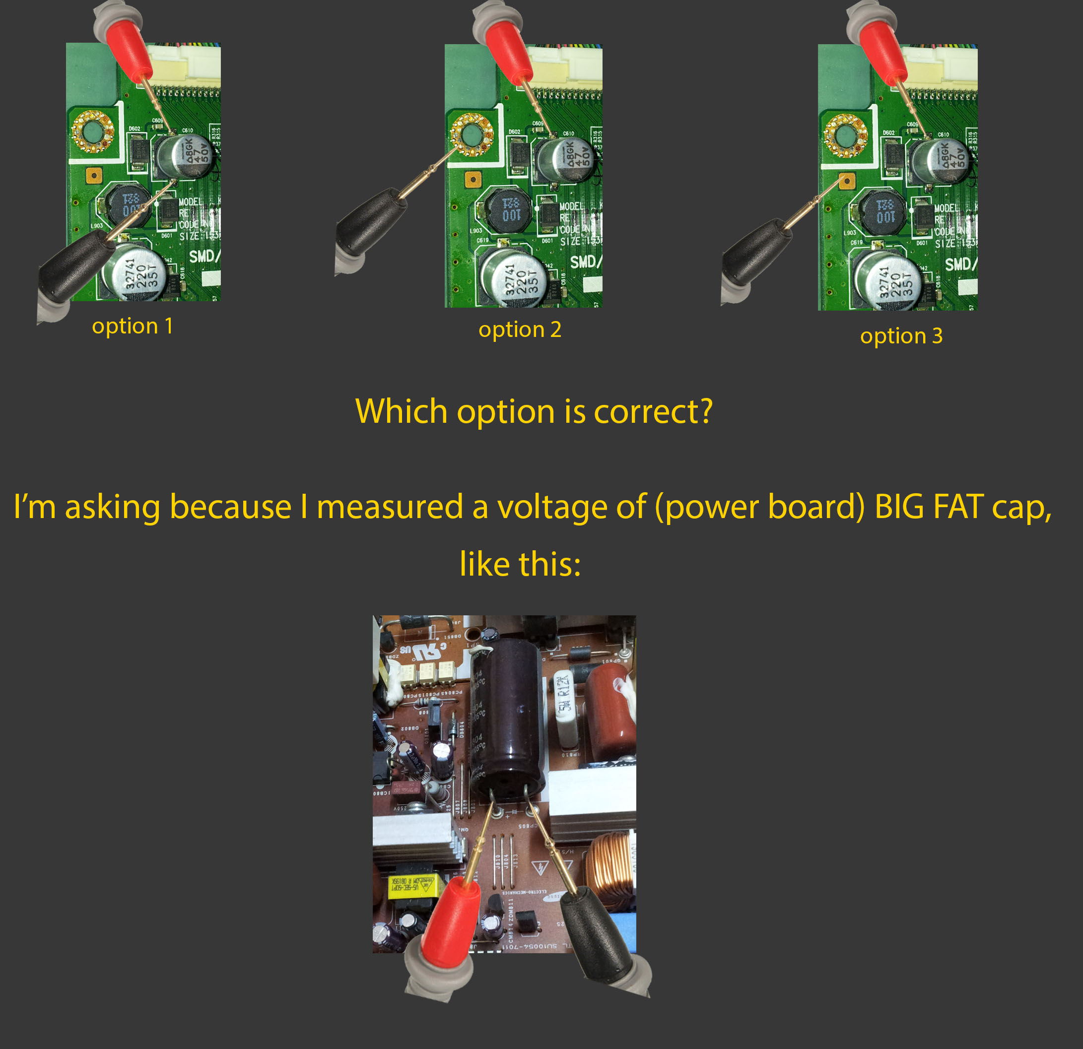

          One of the questions which got me thinking. I know you will laugh or be pizzed, but for sure there will be some reaction to this question. Because of the way I was checking the voltage of the big fat cap, I had to ask specific question. So I uploaded an image. It's a 3rd image.

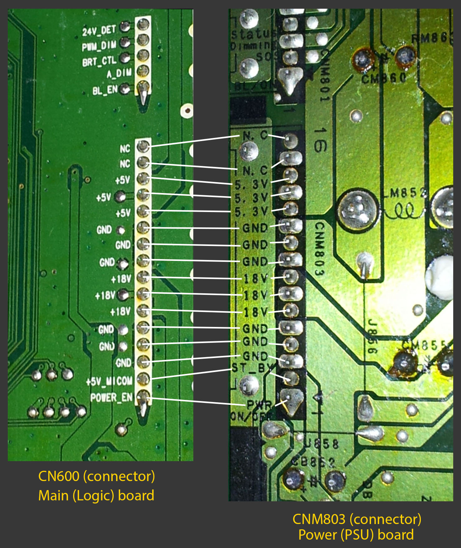

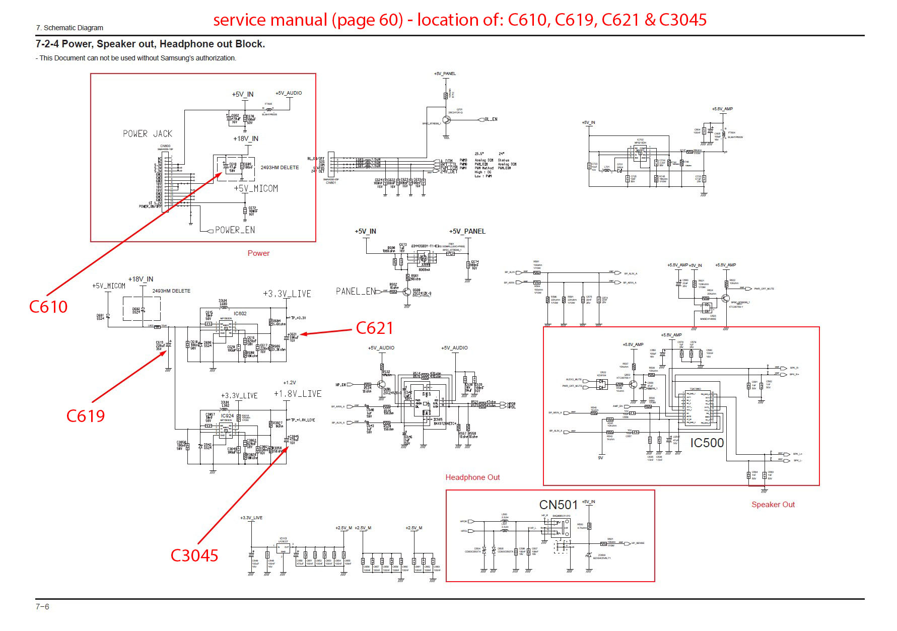

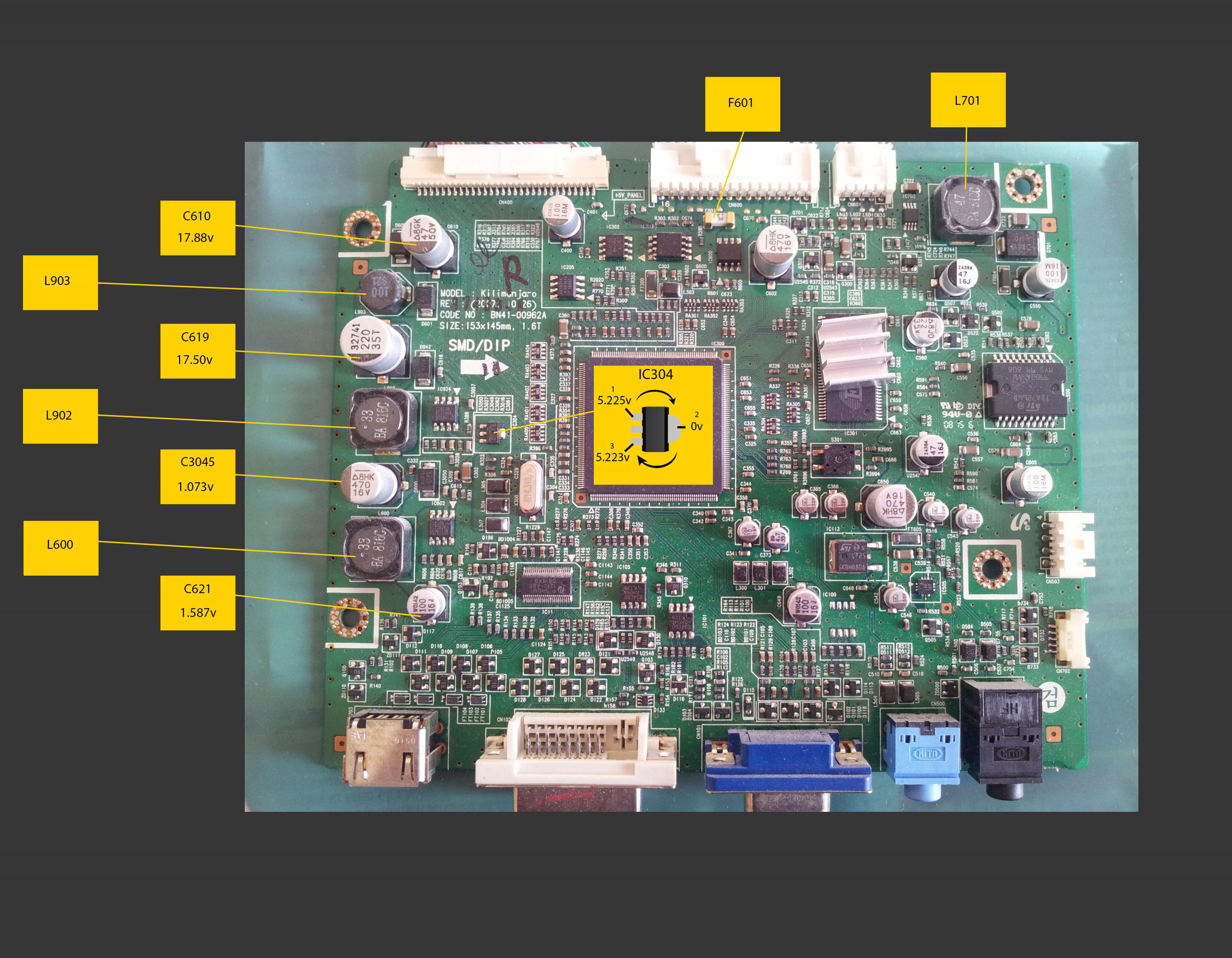

          I'm asking because when you say 'relative to ground' does that mean that negative probe MUST touch the circle where 'screw' goes (or touch negative part of the board where the measuremnat is happening), OR I can touch negative leg of a capacitor directly with black probe? Its because I was told to NOT touch the ground with negative probe while measuring the voltage of that big cap.
          Please check the 3rd image.

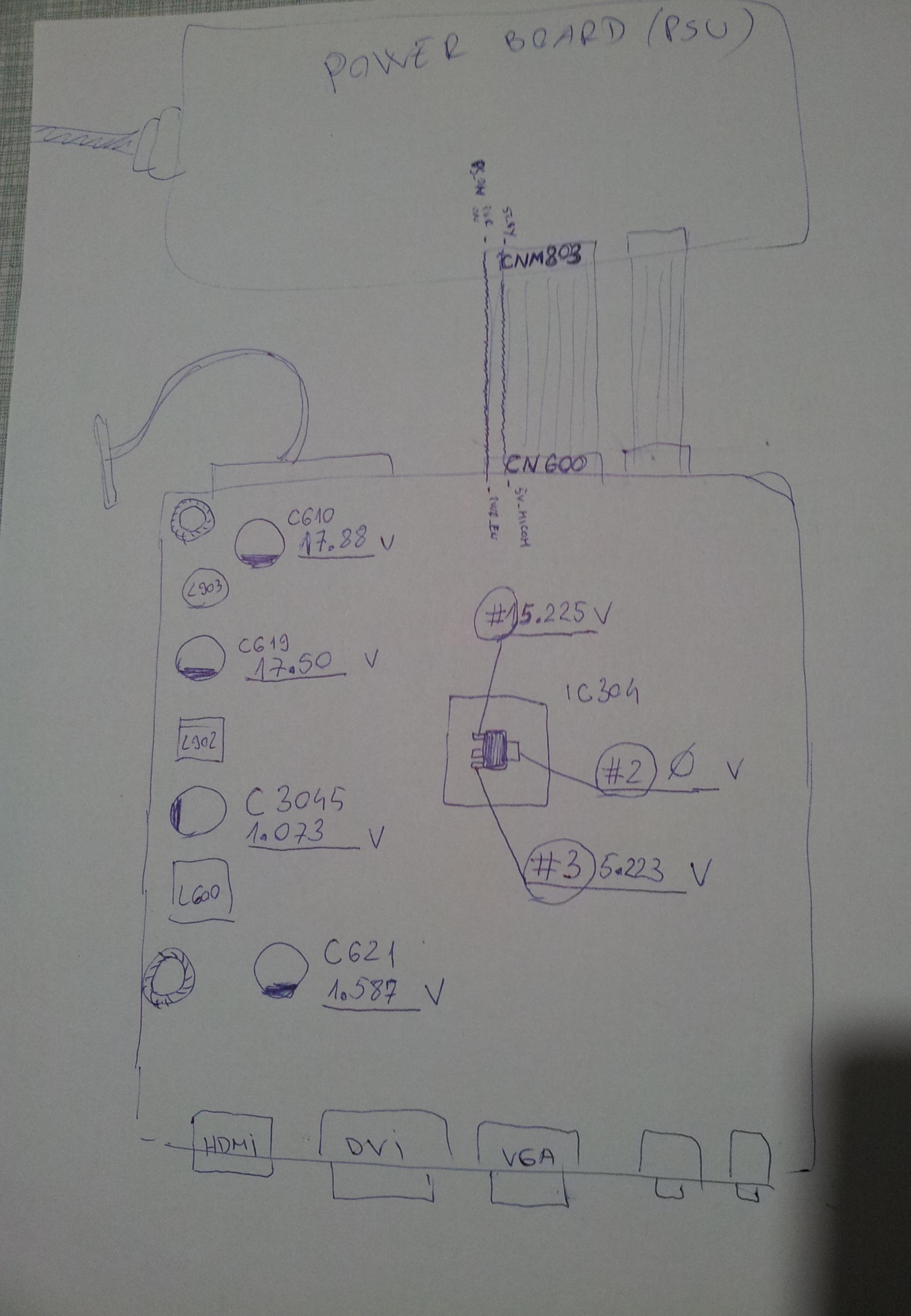

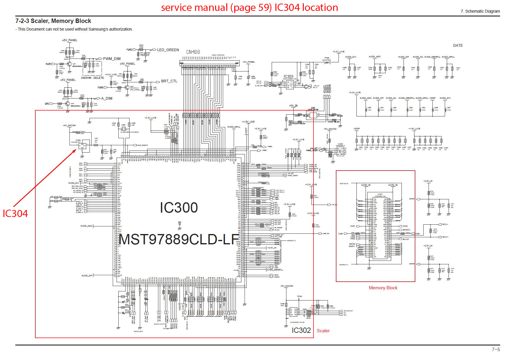

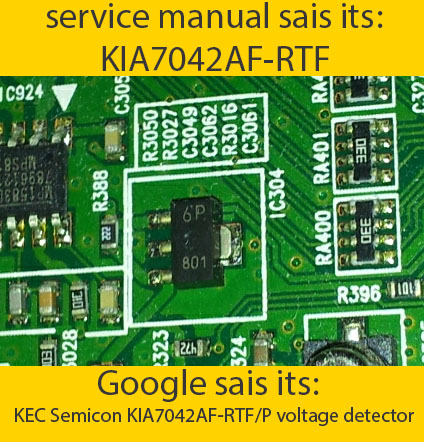

            Ok, this will sound stuped (like the rest of my questions were 'smart'), but when you say 'tab' what do you mean? On one side of that IC304 there are 3 pins. On the other side there is some wider...'pin'. Is that the one that you refer to as a 'tab'? I will attach a picture regarding that IC304, please check it out and let me know if I guessed correctly? Also, if I was right about positions, can you tell me how you measure it?
            If I can guess, while main board receives a power though power board, I should put black probe on a 'tab' and red probe on left pin, and check the voltage? (then keep the negative probe on 'tab' and touch the right pin with red probe). Correct?
            I know question is stuped but I just want to make sure we both observe that IC304 from the same angle (point of view).
            Please check the 1st attached image in this post.

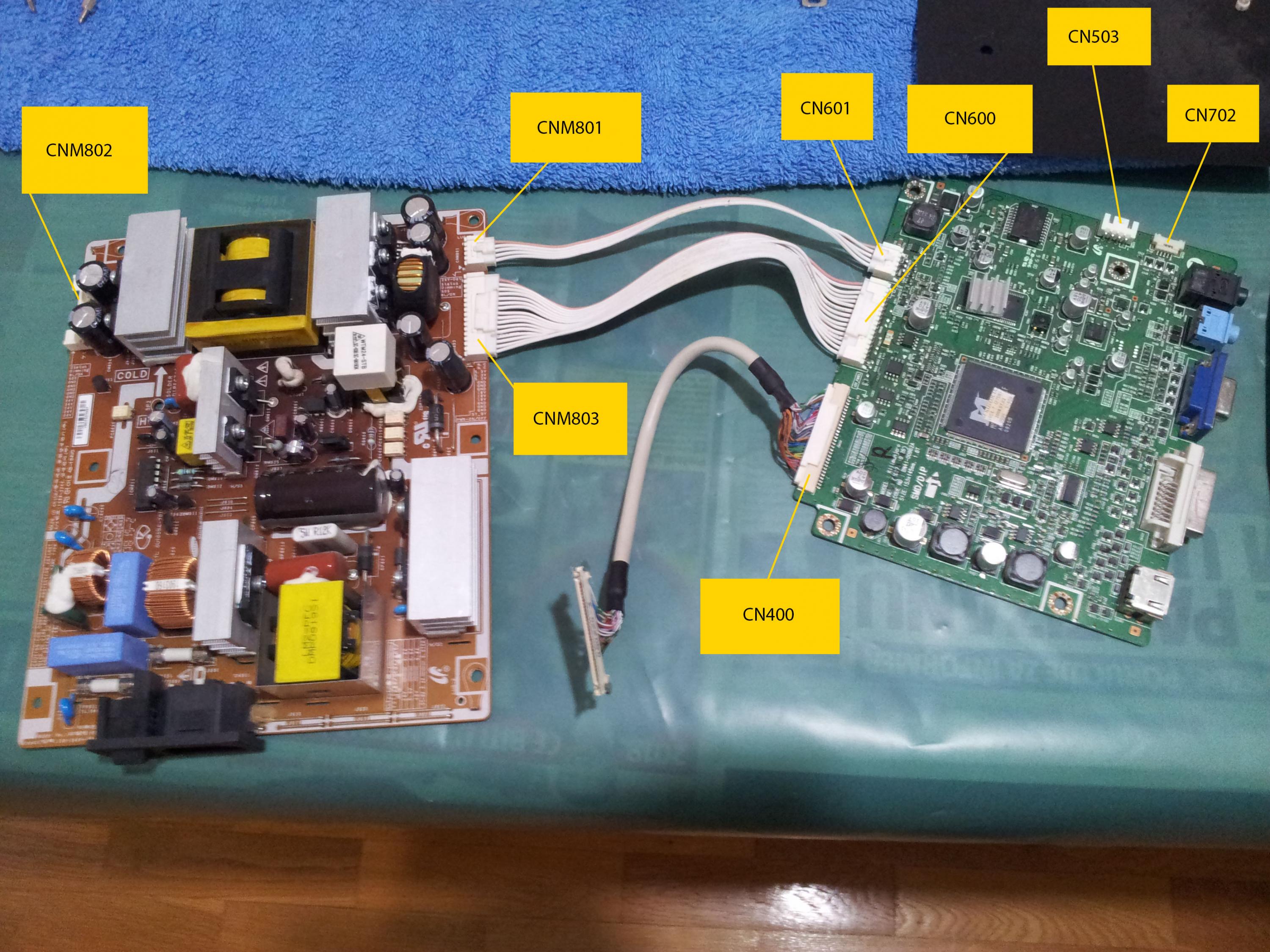

            Hmm, at first I thought I understand what you asked me to do. But the more I think (and I must do that), the more I'm not sure if you assume something that I don't.
            First I would measure it in a way that I would put black probe on a GND pin, and touch the POWER_EN pin with a red probe, correct? And I was just about to do that, but then I thought...
            I was told that standby voltage should be present at powerboard connector pin, and only then, it will be able (once its shorted to the PS_ON) to provide voltages to other boards which are connected to a power board. Now I'm thinking.... my monitor is disassembled. If I don't touch (press) monitor power button, how can then the voltage be sent to other boards of the monitor? I guess when I press power button on a monitor, it short 'standby' pin with PS_ON pin and then voltage is 'sent' to main(logic) board? Did you assumed that all other monitor parts are all connected together so that I can check voltage on POWER_EN pin? They are not connected...
            I know I'm making things complicated and I'm really sorry about that.
            Anyway, I attached the image, and that is how I would test the voltage of the POWER_EN pin. Please let me know (if you still have a strength to write answers on my stupid questions) is that 'ok' way? And let me know about what needs to be done so that pin POWER_EN gets the voltage? (what parts needs to be connected? only main board and power board, or should I 'short' some pins in order to make POWER_EN gets its voltage)
            Please check the 2nd attached image in this post.
            Hmm, you say 'small connector on the RIGHT'. On that picture that you used to point me that 'multi-color wired LDVS connector', there is no 'small connector on the right'.(maybe you were looking at different photo?). I would guess you mean the connector on the top (on far left). Right? On that picture multi-color LVDS connecitor is on far right (while the wide white-wired connector is between small one and LVDS connectors). Do you mean that 'small connector' on far left (on the top of the board)?
            (I attached the image in previous post (its a first attached image) with connector markings, so you can reffer to them if you want)
                Good question.
                The answer is that both option 1 and option 2 are correct.
                In particular, option 1 is very good because then you know exactly what the voltage is across the cap. However, trying to measure across each cap like shown in option 1 can be cumbersome. This is where option 2 is easier.
                As for option 3... I'm not quite sure what that little square connects to on that PCB, but it could be an isolated point not connected to anything. If that's the case, then you won't get any voltages, so I suggest to NOT use option 3.
                And finally, there is a 4th option: if your PSU and/or logic board are installed *and* bolted to the metal chassis of the monitor, then you can use the metal chassis of the monitor as a ground point too (i.e. connect your black multimeter probe there.)
                What I personally like to do is I like to get an alligator clip and connected my multimeter's black (-) probe either to the metal chassis (4th option suggested above) or clip the alligator clip to one of those round screw hole rings. That way, I can measure voltages with just one hand, while I can use the other hand to either press buttons on the monitor or keep that hand on the On/Off button on my surge protector / extension cord, in case I need to turn off power quickly.
                Yes!
                That wider pin would be the "tab".
                Connect black (-) multimeter probe to ground (i.e. chassis or on a ring for a screw hole on the PCB) and then take voltage measurement with red (+) multimeter probe first at position #2, then tab, then position #1. (Note that the tab is also tied to the middle pin on the row of 3 pins, but I prefer and always suggest to use the tab, because it's easier to place the multimeter probe there and you're less likely to slip and short across the IC pins.)
                I used your picture here as a reference to where positions #1 and #2 are:
                https://www.badcaps.net/forum/attach...7&d=1604276645
                  Yes, that way is OK.
                  But again, if you don't want to hold black multimeter probe, you can just clip it to any secondary side ground (i.e. metal ring around a hole on the PCB or metal chassis of the monitor.)

                        I understood the explanations from your first post, so here are some results:
                        (please check any of 3 attached images. 3rd one gives IMO best presentation, since I spent some time making it in photosohp)
                        Voltages on the capacitors on the left side of the main (logic) board:
                        C610 = 17.88v
                        C619 = 17.50v
                        C3045 = 1.073v
                        C621 = 1.587v
                        IC304:
                        pin 1 = 5.225v
                        pin 2 = 0v
                        pin 3 = 5.223v
                        btw. after I pulled the plug that was connected to a power board, I checked the voltage of BIG FAT and it was already around 6v and dropping (I didn't checked instantly, but after a min or two). Then I checked the other caps on main (logic) board and out of 4 mentioned ^ above, only C619 had around 2.1v very slowly dropping. When I checked BIG FAT cap again, it had around 1.11v and dropping. Then I checked again C619 on main (logic) board and it had around 2.19v (and pretty stable, like it is in no rush to discharge). By now (3 hours later) I guess it discharged probably. Power board and main (logic) board were connected all the time, except that I pulled the plug that was attached to power board.
                        Also, I got a s*rvice manual for my monitor that I got from back in 2017 when I had issue with caps. So if you don't have it and want to check it out, let me know. I'll upload it. I wasn't sure if it's allowed to upload it, so I decided not to, for now.

                          Momaka, thank you for a detailed explanation! I think I (finally) understood your instructions and I finished checking voltages at POWER_EN pin (of main/logic board), that you asked me to measure.
                          First, here is how I did it (picture #2 in this post shows visually how I connected everything).
                          - I soldered (red) wire to a POWER_EN pin on the main (logic) board. The other end of that (red) wire was connnected to RED probe of my multimeter.
                          - I soldered (blue) wire to a GND pin on the main (logic) board. The other end of that (blue) wire was connected to a BLACK probe of my multimeter.
                          - I separated a whole monitor frame from a monitor (so the small 'power on/off sensor board was still on the frame). Then I connected that small power on/off sensor baord to a main (logic) board using its small 4 pin cable.
                          - I connected a power board main power cable to an extension cable (extension cable has a ON/OFF switch).
                          When everything was connected, I turned on the multimeter, and then did it in 3 steps:
                          1st step: (extension cable On/Off switch was in OFF positoin). Voltage that was measured at POWER_EN pin was 0v (zero volts).
                          2nd step: (extension cable On/Off switch was in ON position). When I pressed the ON switch on the extension cable, voltage started increasing in in next ~2sec reached 1.217v, and started increasing. After 10 seconds from the moment when I pressed the ON switch on the extension cable, it reached its max of 1.236v. Then started slowly dropping. 18sec after I pressed the ON switch on my extension cable, voltage dropped to 1.213v.
                          3rd step: (extension cable switch turned ON, monitor turn ON touch sensor was 'touched). In this momment (just before I would press touch sensor, voltage was 1.212v. Once I pressed touch sensor.....nothing happen. Voltage kept slowly dropping. I pressed it couple of times, but almost nothing happen. Except that in one point when the voltage was 1.195v, it jumped to 1.220v and again started dropping. I don't think these small voltage range differences are important, but I still described how everything went. I even recorded a 'small' clip with my phone, but its still too big to upload (> 40MB).
                          After this I pressed the On/OFf switch on extension cable to turn off the power board.
                          Then again, I was like 'lets check again' and I repeated the whole process again. Not much difference, but here it is:
                          1st step: zero voltage on POWER_EN (ofc, On/OFF swtich on extension cable was in OFF position).
                          2nd step: (extension cable On/Off switch in ON position). in next 7 sec, voltage reached its max of 1.202v and started dropping again.
                          3nd step: (extension cable On/Off switch in ON position, monitor turn ON touch sensor was 'touched). Sensor touched 17sec after I pressed exntion cable on/off switch in ON position). At the time voltage was 1.193. Then I touched the sensor, and...again nothing happen, except that voltage kept dropping slowly. At 34th second (from the moment when the extension cable on/off switch was turned ON), voltage dropped to 1.180v.
                          And, since everything was already connected, I took the time to measure a voltage on a BIG FAT cap (while main/logic board was still connected to a pwer board). Voltage on a BIG FAT cap was 384.5v
                          So, to sum things up:
                          POWER_EN voltage (NOT connected to main wall socket): 0v
                          POWER_EN voltage (connected to main wall socket): 1.234v (and slowly dropping)
                          POWER_EN voltage (connected to main wall socket, and monitor turn ON touch sensor button touched): 1.212v (and still slowly dropping)
                          BIG FAT power board filter capacitor (while power board and main board were connected): 384.5v
                          I hope with this 2nd post, I provided the rest of the checkings you asked me to do. If there are more checks that needs to be done, please let me know (with ofcorse some instructions how to do it).

                                Re: Samsung 2693HM - Doesn't turn on (no standby)
                                C610 = 17.88v
                                C619 = 17.50v
                                C3045 = 1.073v
                                C621 = 1.587v
                                IC304:
                                pin 1 = 5.225v
                                pin 2 = 0v
                                pin 3 = 5.223v
                                C3045.... that voltage looks weird. I haven't seen any ICs in a monitor application that need 1V (since 1.073V is pretty much close to either 1.0V or 1.1V... neither of which are standard.) Generally, standard voltages for most ICs and MCUs are 3.3V, 2.8V, 2.6V, 2.5V, 1.8V, 1.6V, 1.5V, 1.3V, 1.25V, and 1.2V. From these, 3.3V, 2.6/2.5, 1.8, and 1.3V are the most commonly seen ones. The voltage on C621 looks close enough to 1.6V (or 1.5V if meter is reading a bit high for whatever reason), so that one is probably OK.
                                Does the main IC or any IC on the logic/main board get really hot (as in, you can't hold your finger on it) after the monitor has been plugged in for a minute or so. You can touch the ICs on the main/logic board with your bare hand/finger to check temperatures, there aren't any dangerous voltage there. Just make sure your hand isn't wet or has metal filings, as you might short something out otherwise. (I know this is getting in "uncomfortable territory for you, asking you to touch stuff by bare hand, but it's actually pretty safe. You probably have 1000's of times greater chance of catching Coronavirus and getting complications from it than getting hurt from this, lol. ) Or if you still feel too uncomfortable to do that, then let the monitor sit powered for a minute or two, then disconnect from wall and check temperature on parts right away with your finger. This should tell you if anything had gotten hot.
                                C610 and C619 look like they are part of the same 18V rail, with C610 doing filter duty before L903 and C619 providing filtering after L903. I suppose it might be good to confirm that - just check resistance between the two (+) leads of caps C610 and C619 (with the monitor powered Off and disconnected from the wall, of course.)
                                And then there's IC304: looks like it's doing pass-through duty only, kind of like a MOSFET or BJT... but that doesn't make much sense, since its designator starts with IC and not Q. Can you tell me what part numbers you see written on IC304? I can't read it from any of the pictures (nothing wrong with them, btw, it's just IC304 is a small component.)
                                  Perfect! You did everything 100% correct.
                                  So it looks like POWER_EN / PS_ON is stuck at 1.2V, or thereabouts. I think that means the main PS should be Off... However, the fact that you have 5.3V and 18V on the logic board and that the big cap also has 385V DC on it means the main PS is actually turned On.... which I find odd, as I expect APFC and main PS voltage to be present only when the monitor is turned On. When off, voltage on PS_ON should be different.
                                  Because of this, could you do another measurement on PS_ON signal? This time, however, keep the logic/main board completely disconnected from power supply. Now, while checking voltage on pin PS_ON, plug in PSU to the wall and tell me what voltage you read. (And of course, since you don't have the logic board connected, you won't have the panel On/off touch board connected either, so that should make things simpler to measure.)
                                  Yup, that's normal for when the APFC booster is working.
                                  Without APFC, you're more likely to see 325-340V, depending on line voltage. (And for the voltage measurement at PS_ON with logic board disconnected, you'll likely see big cap voltage only at 325-340V, too.)

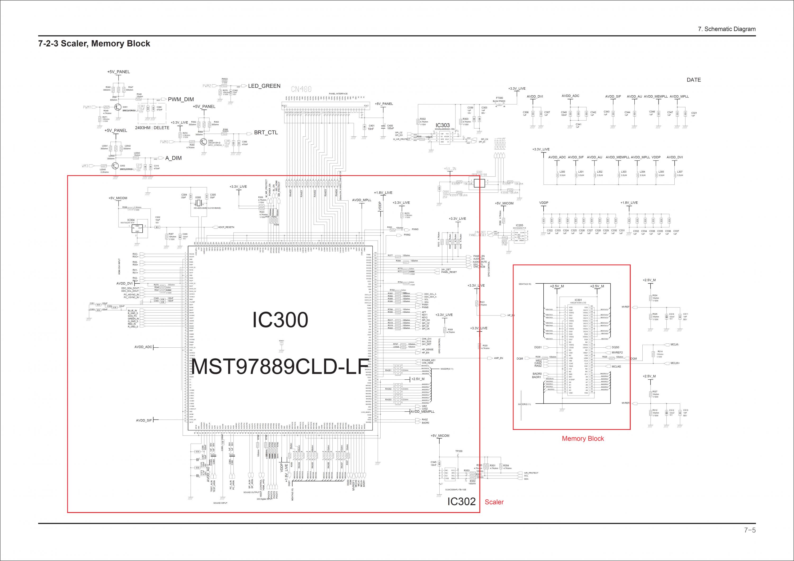

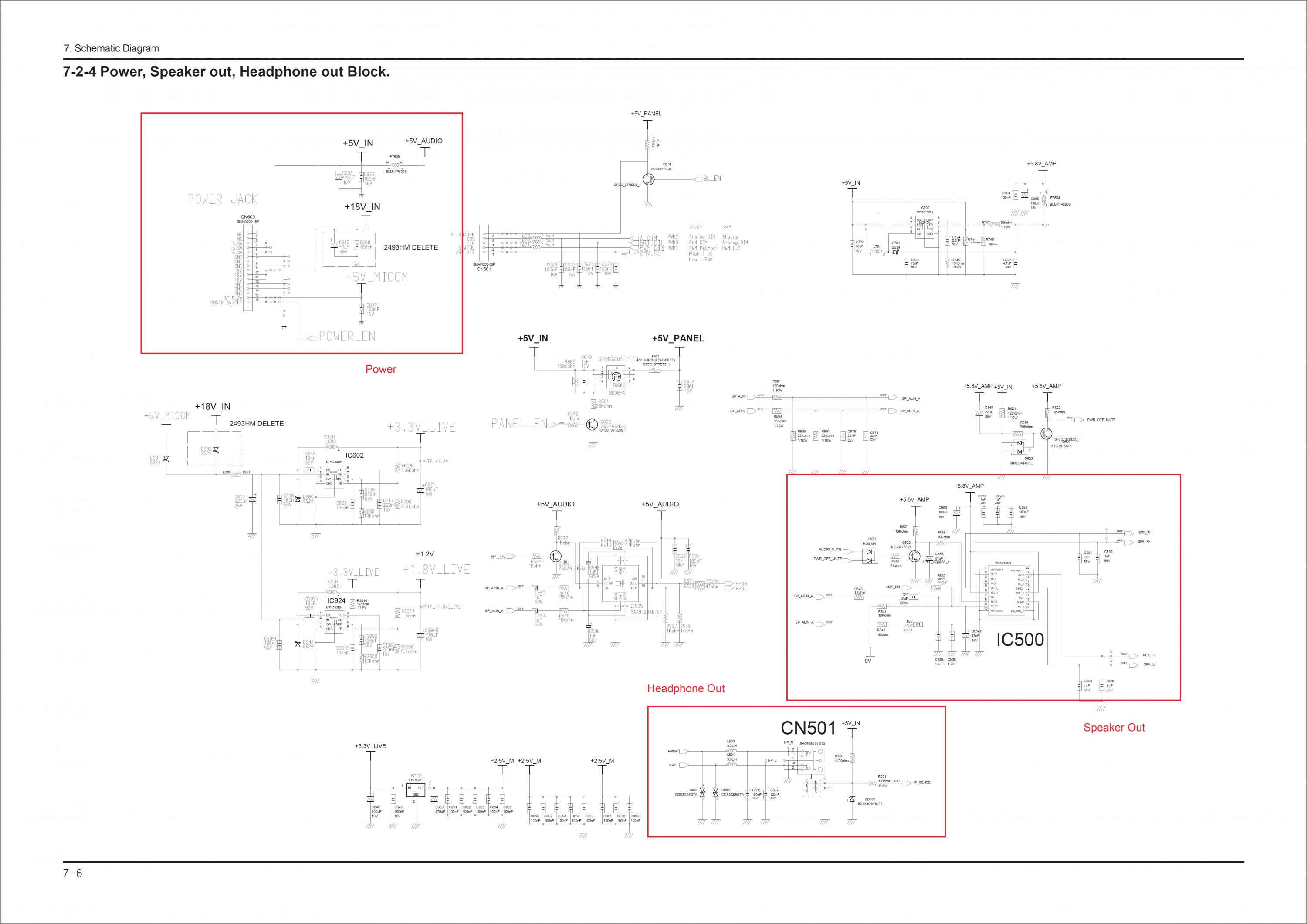

                                    Now, before I start another novel, I want to tell you that I (as you can see) uploaded some files. You'll find:
                                    - Service Manual for Samsung 2693HM (split in 2 rar archives, because of its size)
                                    - 2x 400% zoomed-in (most important) pages from service manual (pages 59 & 60) as jpeg images
                                    - some datasheets of specific main(logic) board elements
                                    - And also some images where I point to certain elements (or their service manual page location, so you don't have to waste time while trying to find them)
                                    So... you can check them out if you want.
                                    I have checked Service Manual for this monitor (page 60), and I've found C3045 capacitor which 'revolves' around IC924. The schematics show that the 'output' voltage on that C3045 capacitor should be 1.8v (or 1.2v). I can't determ which voltage should be present (1.2v or 1.8v). I guess when the monitor is not powered it should have 1.2v, but when the monitor is powered it will go 'live' and have '+1.8v_LIVE' voltage? Correct?
                                    Anyway, please check the service manual (page 60), or one of the images that I made by making a screenshot of that page from the manual. (I'll attach the image)
                                    Also on the schematics, you can read near IC924 a marking 'MP1583DN'. I googled it, and it sais its: 'Monolithic Power Systems (MPS) MP1583DN-LF (3A, 23V, 385KHz) Step-Down Converter (regulator)'. I'll attach the datasheet for this one.
                                    ^ one extra question about this Step-Down converter (regulator): Since its datasheet sais it accept intput voltages from 4.75-23v, and oputputs 1.22v-21v, and since capacitor C3045 in Service Manual schematics show that it should have 1.8v (or 1.2v), that means, that the IC924 wont be hot. Because its input voltage is ~5v (which comes from 5V_MICOM connector pin), and his work wont be 'stressfull' to adjust voltage from 5v to 1.8v (or 1.2v), compared if it had to adjust input voltage of 23v to 1.8v (1.2v). Correct?

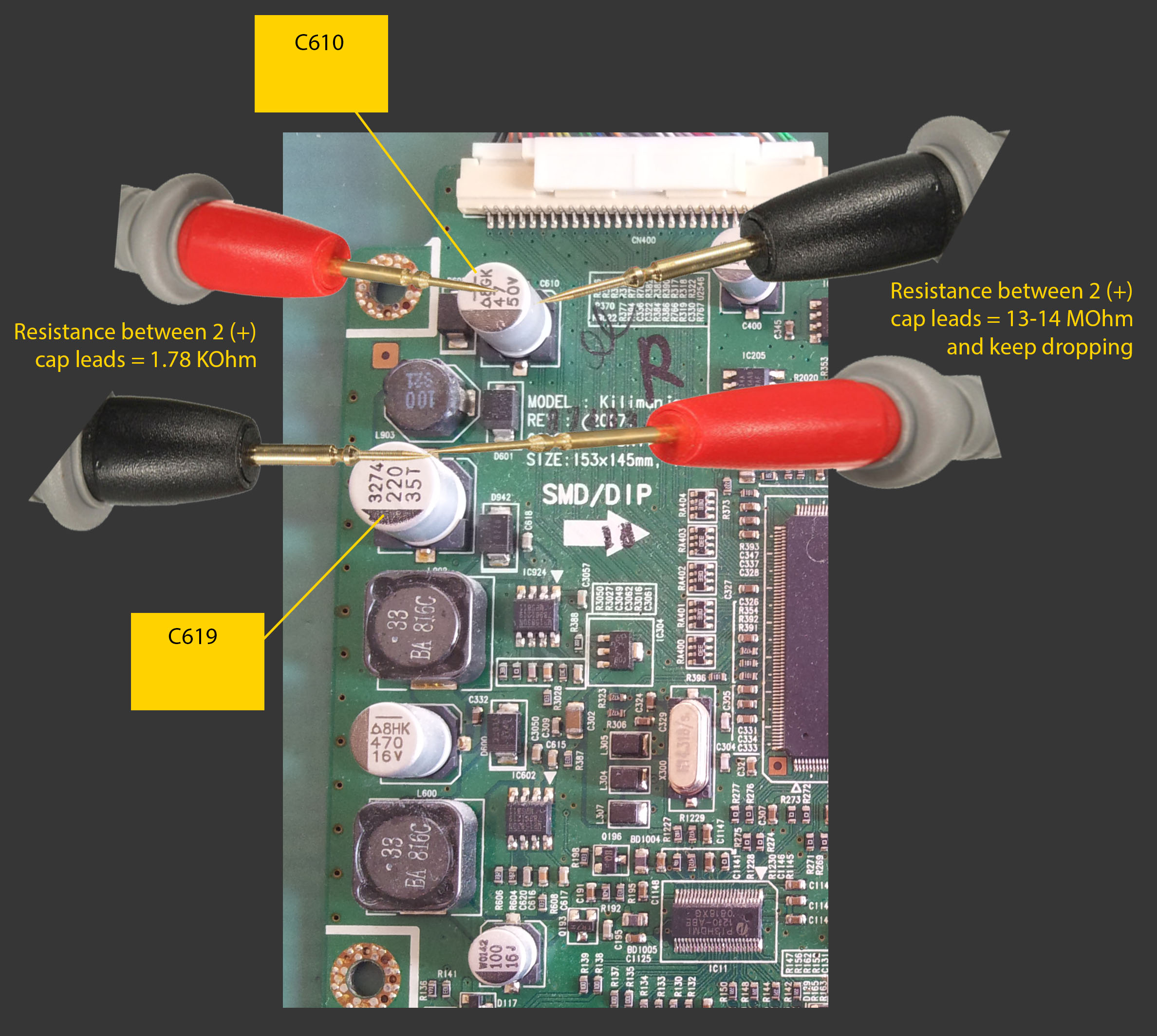

                                    I've attached the picture of the service manual caps location.
                                    I mesured the resistance between 2 (+) leads (legs) of C610 and C619 caps, and...here is the strange thing:
                                    When I put red probe to positive leg of C610 and black probe to positive leg of C619, resistance is 1.78 KOhm. BUT... when switch probes, so that black probe goes to positive leg of C610 and red probe to positive leg of C619 resistance is around 13-14MOhms, and dropping....dropping....dropping to 3MOhms (and keep dropping). I checked multiple times, just to be sure. (I attached the image as illustration)
                                    • twist3r
                                      As for IC304 I made a small picture of the markings few posts back (you probabbly missed it). Its in post #25, (1st attached image). It sais: 6P 801
                                      Here: https://www.badcaps.net/forum/attach...7&d=1604276645
                                      Inside Service Manual of this monitor (page 59), you can see a schematics wtih IC304 included and there is a mark 'KIA7042AF-RTF' near it. I googled it and it is probably:
                                      KEC Semicon KIA7042AF-RTF/P voltage detector (SOT-89 (SOT-89-3)).
                                      From what I see on the schemantic it receive 5v voltage from +5V_MICOM pin of the main power board. So I would (as a newbie) conclude these voltages on IC304 are 'ok' since I measured 5.225v on pin 1 and 5.223v on pin 3 of the IC304. The only 'strange' thing which I don't understand is that inside PDF file for that IC304 KEC Semicon voltage detector, for 'my' KIA7042AF-RTF model, it sais that 'Detecting Voltage (Vs)' goes from 4.05-4.35 (but typical 4.2v). Maybe that means...'once' there are (at least) voltage of 4.05-4.35 on its pin 1, it'll do its 'thing' or... send the voltage to pin 3. Right? I'm a bit confused because voltages that I measued on both pin 1 and pin 2 are above 5v. Anyway, I will include PDF of that 'KEC Semicon KIA7042AF-RTF/P voltage detector' with this post.

                                      Another question is: so, no mattter what type of monitor with CCFL laps I try to power on, as soon as I pull the plug from the socket wall, there is no voltage charge left in CCFLs and I can touch them or their connectors, correct? I mean, they are not like capacitors that can hold charges after the device is turned off and cable pulled from the socket wall, right?
                                      OK, so I checked the voltage on PWR_ON/OF (PS_ON) pin on the power board.
                                      Here is what I did:
                                      I soldered a blue wire to GND pin of CNM803 connector (on power board). The other end of that blue wire I connected to black probe of my multimeter.
                                      I soldered a red wire to PWR_ON/OFF (PS_ON) pin of CNM803 connector (on power board). The other end of that red wire I connected to red probe of my multimeter.
                                      Then I connected power board with its power cable to an extension cable (with a ON/OFF switch on it). Then that extension cable attached to a wall socket.
                                      In that moment multimeter was showing 0v (ofc, since exnesion cable ON/OFF switch was in 'off' position).
                                      Then I pressed the extension cable switch to ON position and....nothing happen. 0v (zero volts). As it should be, right?
                                      Since I could, I took time to measure a stendby voltage on that CNM803 connector. It was 5.24v. Again, good, I think.
                                      So to sum things up:
                                      PWR_ON/OFF voltage on power board CNM803 connector: 0v (zero volts)
                                      ST_BY (standby) voltage on power board CNM803 connector: 5.24v
                                      Ok, I guess thats all for now. I only didn't answer your question about how much (IF any of) ICs getting hot. Will try to answer that question after (IF) you decide to answer on this new chain of posts I just made. Sorry about that.
                                      I'm doing it this (long) way so maybe one day, if I decide to check something I can re-read what was done, and/or if one day some poor soul with the same issue and the same monitor decide to visit this topic so he can read and maybe get the answers that bothers him, like they bother me right now.

                                        Hmm. It took me some time to make those JPG images of pages 59 and 60 of the service manual with 400% zoomed-in clarity in photoshop. But now when I uploaded them, I see that they are not as clear as they were on my hard drive. I guess there was some 'compression thing' going on while the vBulletin forum software attached them. So I'll upload these 2 Hi-Res pages in a rar archive, so you can use them (if you don't like reading PDF service manual).
                                        Reason for making these 2 pages (59 & 60) in Hi-Res is: You can't search for some elements on the schematics inside service manual. For instance I coudn't use a seach option to find C610 or C619 (or C3045) capacitors. It only finds some of them in the list section. So since the search function in Acrobat Reader is useless for this Service manual (even if the schematic is 'vectored' and pages are not made out of bare scanned photos), I was thinking maybe you would like more to watch at the Hi-Res image instead of page in service manual.
                                          Well, good thing you provided the SM (service manual) and IC924 datasheet.
                                          From the MPS MP1583DN (IC924) datasheet, the reference/feedback voltage V_FB of the IC is typically 1.222V (see page 3, parameter "V_FB"). Resistors R1 and R2 in the app note in the datasheet set the output voltage. In the SM of the monitor, we can see these resistors correspond to R3027 and R3050. From the picture of the mainboard you provided, we can see that R3027 has a big zero (0) written on it, so it's a zero Ohm resistor (i.e. a jumper)... which means the output of IC924 should equal to the reference voltage, V_FB... so that means 1.2V is the correct voltage output and 1.8V is not. I think also any bold text in the SM is basically to indicate a correction or later revision. (And for example, you can see that for the 2493HM model of the monitor, there are certain parts that say "DELETE", which probably means those parts of the circuit are not installed. So in other words, the bold text supersedes anything else written on the schematic.)
                                          With that said, that 1.2V rail is still a bit too low. According to MP1583DN datasheet, V_FB can be as low as 1.194V and as high as 1.25V... so even if your multimeter is slightly off, it should still measure close to those values if IC924 is working correctly. And on that note, I think IC924 IS working fine. However, the monitor SM says that IC924 gets its enable signal from the output of 3.3V_LIVE (i.e. the voltage generated by IC602.)
                                          Now, in my last post, I mistakenly assumed that since the voltage on C621 is close to 1.6V, then that must be what the IC is supposed to output. However, that is INCORRECT. The fact that you are getting only about 1.6V on the output of the 3.3V rail when both 5V_MICOM / ST_5.2V and +18V_IN are more or less normal, then that means there is something wrong with the 3.3V rail and this is where we should start digging deeper.
                                          With the power turned OFF and logic/mainboard (sorry if I keep alternating between calling it logic board or mainboard... it's the same thing here) disconnected from PSU board and all other boards, measure the RESISTANCE between a ground (screw hole metal ring or C621 negative '-' terminal, whichever you prefer) and positive (+) terminal of C621. Keep the multimeter connected for 2-4 seconds and tell me what you see. Stable resistance? Or resistance climbing? (And approximate #'s, if value is climbing - this doesn't need to be exact.) Post back what results you get here.
                                          On that note, you said your monitor died when cable co. came in and installed new tuner box and had said box connected to monitor. If that really was the case and not a coincidence (after all, it could be, despite the guy saying this happens all the time - we still don't know the problem, so we have to keep open mind about any possible scenario), then I suspect there may also be shorted protection diode(s) on the HDMI or DVI-I (or whichever input you used) that's pulling the 3.3V rail down. In particular, I was looking at the monitor SM and on page 79, look at the schematic of the HDMI and DVI_I inputs. For the HDMI connector, diodes D105 through D112 provide anti-static / surge protection on the signal lines by clamping high voltages to the 3.3V rail and negative voltages to ground. Likewise, diodes D129 and D130 provide clamping to 5V_DDC and 5V_DDCH rails. On the DVI_I connector, it's the same scheme with the surge protection - you have diodes D121 through D128 for clamping signal lines to 3.3V or ground and diode D133 providing protection on SCL and SDA lines.
                                          Thus, since the 3.3V line is low, it is possible that one of these diodes (in particular diodes D105-D112 and D121-D128) to be shorted. Again, with the power OFF and mainboard disconnected from all other boards, you can check these diodes either on RESISTANCE setting or in DIODE MODE. Just for consistency, let's use RESISTANCE mode. These are the tests to carry out:
                                          1) Place red MM probe on pin #1 of diode (see page 79 of SM - it shows pin numbers for these diodes and how they are wired) and black MM probe on pin #3. You may or may not see a reading on your multimeter, but if you do, it should NOT be lower than probably 200-400 Ohms (if it is, report what you measured.) Now reverse the positions of the red and black MM probes on pins #1 and 3. Your MM should show very high resistance or OL. If not, report what you get.
                                          2) Place red MM probe on pin #3 of diode and black MM probe on pin #2. You may or may not see a reading on your multimeter, but if you do, it should NOT be lower than probably 200-400 Ohms (if it is, report what you measured.) Now reverse the positions of the red and black MM probes on pins #3 and 2. Your MM should show very high resistance or OL. If not, report what you get.
                                          Repeat the above tests for all protection diodes (D105-D112 and D121-D128).
                                          You don't need to report all resistances back here. But if you do, perhaps do it in this format so it's easier to read.

                                          To answer on this question (and to check what you asked me about) you have to be more clear. My monitor is disassembled. So...when you say 'doe the..... after the MONITOR has been plugged for a minute or so' what do you mean by that?
                                          Do I have to assemble the monitor again?
                                          Oh, sorry about that.
                                          By MONITOR, I meant just PSU board, logic board, and ON/OFF button board... as that's all we really need at this point in troubleshooting. T-con and inverter board are not needed.
                                          So NO, you do NOT need to assemble the monitor.
                                          (It would be terrible if you had to. I remember servicing PS3 consoles back in the day - those you had to assemble at least partially to test, unlike the Xbox 360's. As such, I really hated servicing the PS3's.)
                                          So, do I have to connect again (only) power (PSU) board with main (logic) board, and with a monitor frame (which holds that touch sensor), and touch the sensor again, like I did when I was measuring POWER_EN pin voltage in my previous posts?
                                          Yup, that's it.
                                          OK, no worries about that one then.
                                          From the monitor SM on page 81, we can see that C610 is connected to the "raw" 18V input from connector CN600, whereas C619 is connected after it through Schottky diode D602 and inductor L903. This explains why the voltage you measured on C610 was slightly higher than at C619 (i.e. the slight voltage drop from D602.) In the absence of the 18V rail (i.e. when the monitor is in standby or soft off mode), the ST_5V / +5V_MICOM rail will be feeding into C619 through Schottky diode D601, so then C619 will only have ~5V.
                                          So yeah... we're good with that step here and nothing further to check on it.
