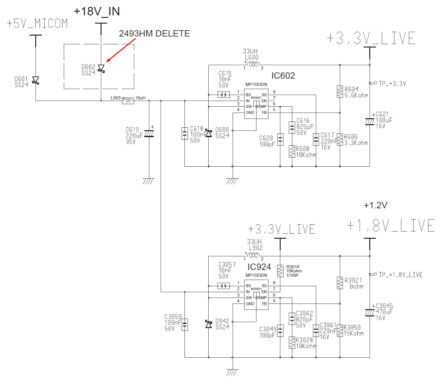

    If you connect a 1.5V battery across a capacitor and then disconnect the battery, the capacitor will have.... guess what? 1.5V across it. If you do the same with a 9V battery, then the capacitor will have 9V across it.
    Now imagine you put a resistor between the battery and the capacitor. If you "very quickly" connect and disconnect your capacitor to the battery with the resistor between them, the capacitor will not be at the same voltage as the battery - it will be lower, because the resistor limits the rate of current going into the capacitor, and thus allows it to charge up slower. However, if you leave the capacitor connected to the battery (again with the resistor in between them) "long enough", eventually the capacitor will reach the same voltage as the battery.
    In the case of the circuits around IC602 and IC924, think of the SW pin as the battery and capacitors C621/C3045 as the capacitors in the above experiment. The main difference here is that instead of using a resistor like in the above experiment, the circuits use an inductor (L600/L902.) Why an inductor and not a resistor? Because with a resistor, there will be a lot of losses as current passes through it and generates heat. But with an inductor, the losses will be much smaller, because it can "store" some of the current that passes through it (at the peaks of the square wave pulses), and then give it back to the circuit (to capacitors C621/C3045) when there is nothing output between the peaks of the square waves.

    The Schottky diodes D600 and D942 play a very important role when there is a current passing through inductors L600 and L902 but when the voltage on the SW pin is 0V between the peaks of the square wave pulses: it provides a return path for the current "stored" in inductors L600/L902 to continue to flow out of them and into capacitors C621/C3045. Without these Schottky diodes, inductors L600/902 will try to do "anything" to keep that current going through them, because... remember, inductors don't like instant changes in current. And that "anything" could mean the inductor could generate 1000's of Volts just so that current can jump through and continue to flow. If you're wondering what the heck I mean, think about a time when you have disconnected an inductive high-current device when it was turned On and drawing current - for example, an electric radiator/heater. If you have, notice sometimes you see blue sparks/lights at the plug when you did that? - That's the inductance of the heating element generating high voltage and jumping the air gap between the disconnected plug prongs and wall outlet to try to maintain the current going through it. Another example would be the sparks you see at the brushes on a motor (e.g. a drill.) The sparks are created from the inductive property of the coils in the rotor of the motor.
    So basically, this phenomenon is called inductive kickback.
    Diodes D600 and D942 simply provide a return path so that the inductive kickback from L600 and L902 doesn't generate extremely high voltages that can damage IC602 and IC924. Moreover, these diodes allow the inductive kickback from L600 and L902 to supply current into C621 and C3045 between the voltage pulses from the SW pins. So L600/L902 and C621/C3045 are used in tandem as energy storage devices to transform the square wave pulses into a smooth DC voltage and provide power to the rest of the components on the logic board.
    Again, look up how a buck regulator circuit works, and it may get more clear.

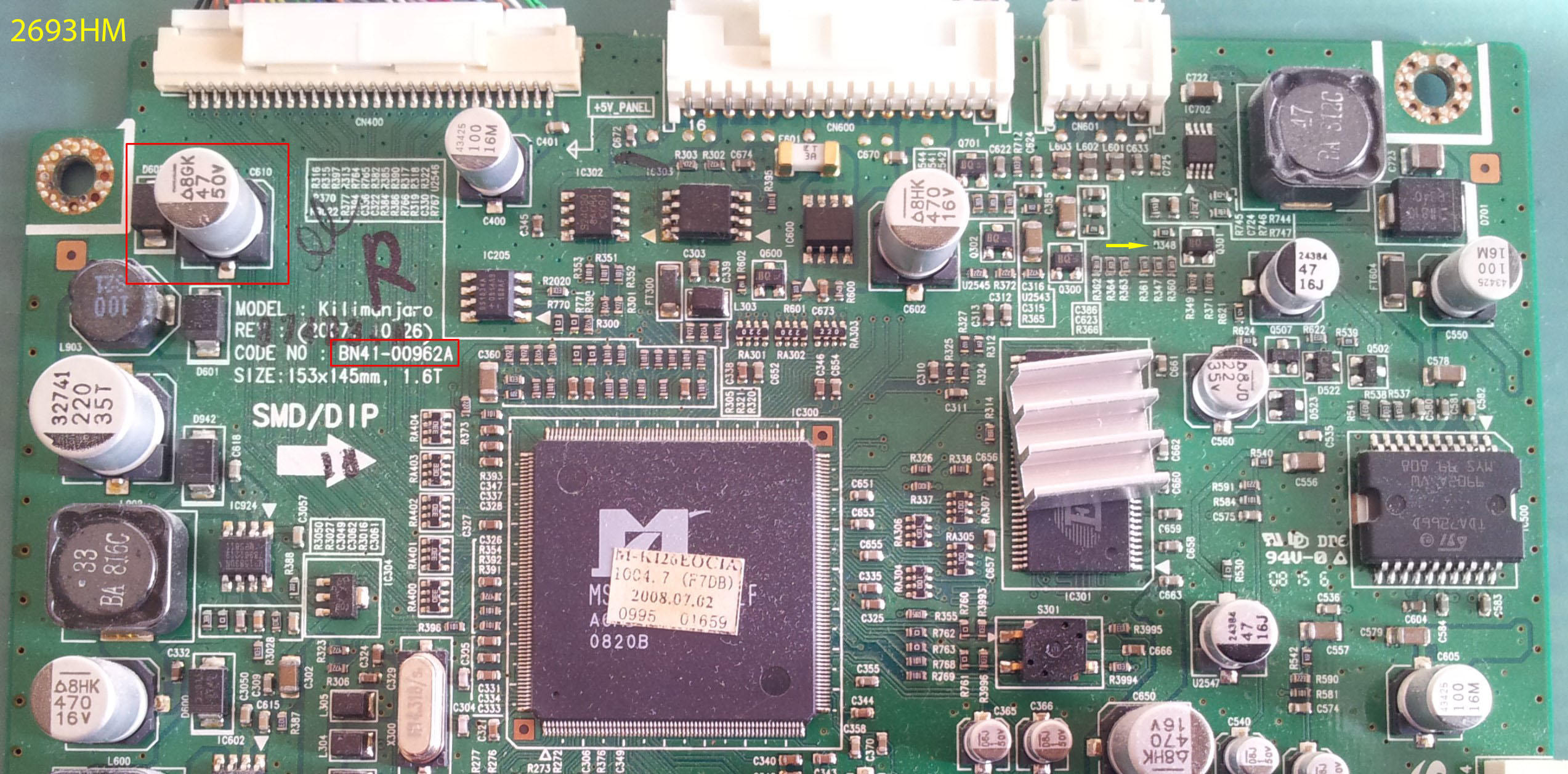

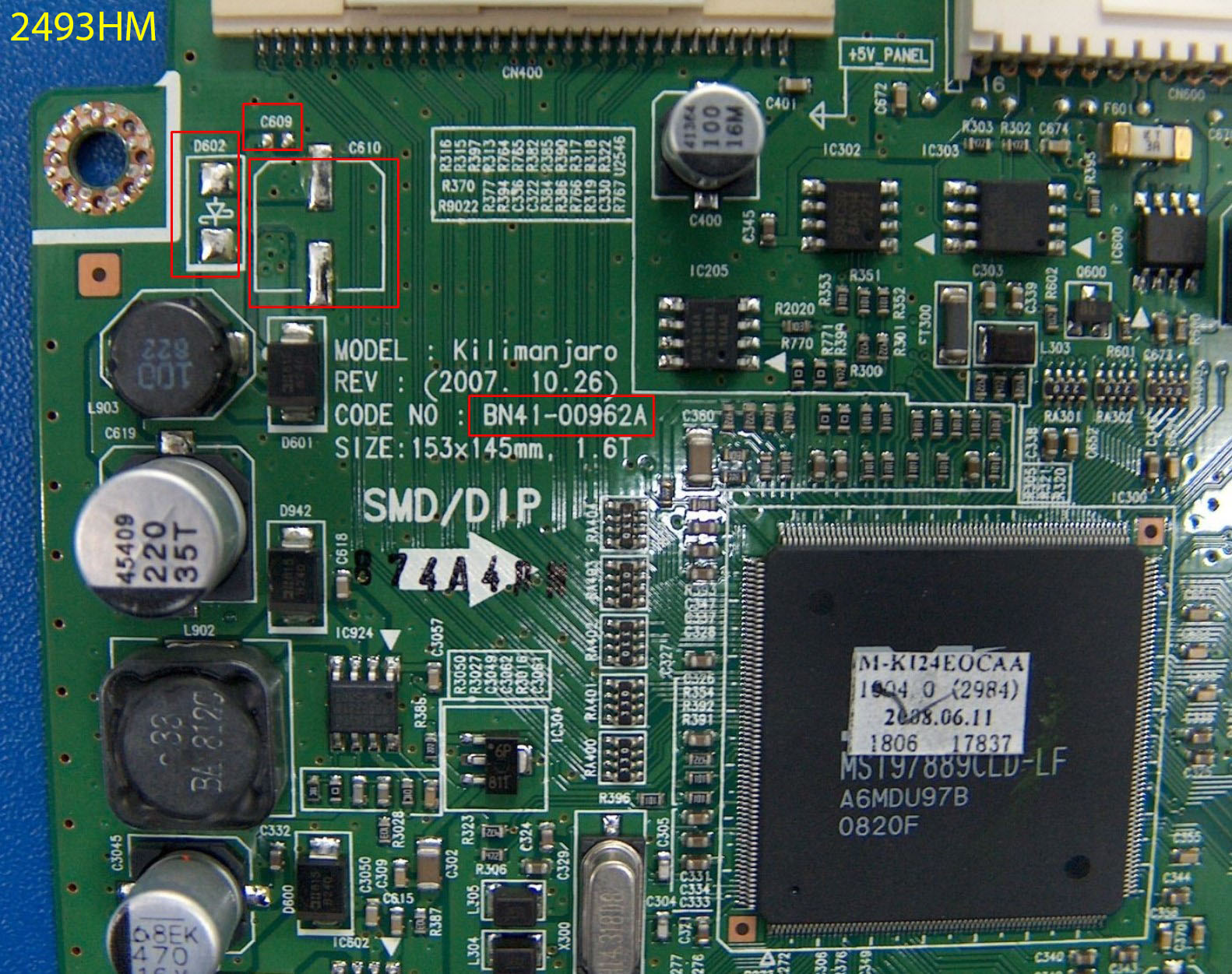

        Well, few days ago I was obsereving a main/logic board from a 2493HM monitor, since the model is the same as for my (2693HM) monitor.
        Model of the main/logic board is: BN41-00962A
        At first I thought that the guy (the seller) was selling some faulty board, because I noticed that some elements are missing. But then, I remember that in the service manual for my monitor (which is the same for 2493HM monitor as well), had some parts where it sais "2493HM DELETE".
        So I was like: Ahaaa, ok!

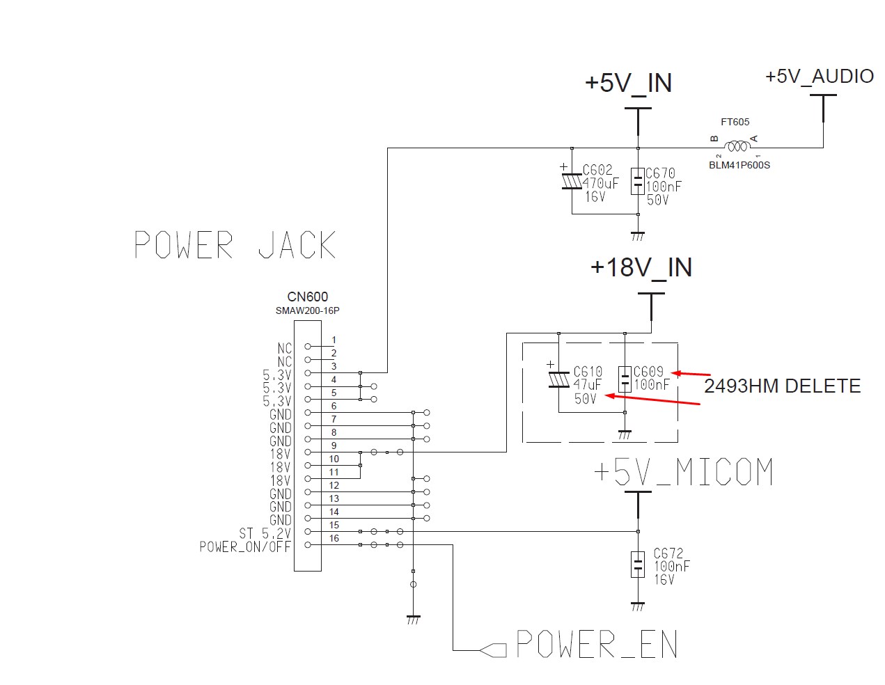

        There are 3 'areas' in the service manual with '2493HM DELETE' note.
        Two of them are on page 60. The note sais that 2493 model doesn't have a D602 shottky diode.
        Also on the same page there is a note for 2 capacitors:
        C609 (ceramic cap) &
        C610 (electrolytic cap)
        They are also missing on 2493HM main/logic board (and also in the manual).
        One thing that I don't understand is why 2493HM mainboard doesn't have D602 diode? That diode is first on '+18V_IN' line. I mean, if there is not a diode there, the line is broken and the line can't provide 18v. How is that possible?

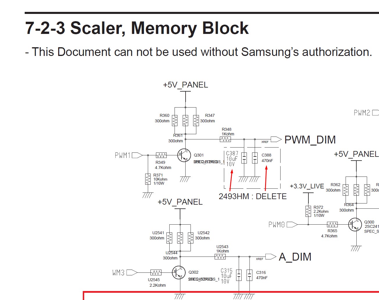

        And... the 3rd note on the service manual is on page 59, and it shows that there should not be present two ceramic capacitors. Ok, but I tried to find them on my board. These caps are:
        C387 &
        C388
        These 2 caps are the last 2 elements on the way to 'PWM_DIM' connection.
        Main idea was (if it comes to that) to buy a 2493HM main/logic board and 'transfer' missing elements from my main board to a main/logic board of 2493HM monitor (since the model of the board is the same, BN41-00962A). But thing is that even after almost one hour of looking through a magnifying glass, I coudn't find them on my main board. They are just not there, like they don't exist. They should be located somewhere in top, top-right area of the board. But they are not there. In the service manula, prior these 2 caps there is a R348 resistor, which I found (and marked it with yellow arrrow on the main board image I'm gonna attach). So now I think that using a main board from 2493HM monitor for my 2693HM monitor wont work, since I can't find and transfer these 2 ceramic caps from 2693HM to 2493HM main board.
        What do you think?
            It means the +3.3V_LIVE and +1.2V_LIVE on the 2493HM are only generated from the 5V_MICOM line.
            One possibility is that the 2493HM board uses less power and doesn't need the +18V_IN when the monitor is turned On.
            But you can always solder D602 and the corresponding capacitors back on the 2493HM board from your 2693HM board... and that should make IC602 & IC924 just work with the 18V line, like it did on your 2693HM board.
            In any case, I wouldn't worry too much about this discrepancy.
            C387 &
            C388
            Yeah, I don't see them at all on your main board nor any spots for them either. It looks like the trace from resistor R348 goes directly to L601 and then out to CN601. So maybe they did a revision on the PCB but not to the SM... which doesn't really surprise me too much. So probably don't worry about this either.
            I don't think those two caps are a deal breaker. There's a good chance they might be missing from the 2493HM board too. And those are just for backlight / dimming control. So worst case, if you connect the 2493HM board to your monitor, the backlights might not work properly or dim properly... but we can probably get them to work again. Most likely, it would require that the PWM_DIM, A_DIM, BRT_CTL, and LED_GREEN circuits on the 2493HM board are matche to the ones on your 2693HM board... and *maybe* swap the firmware chips, if needed (though you actually might not need to.)
            With that said, if you can find a 2493HM board that is relatively inexpensive to you, then you can give it a try. But if it isn't cheap and/or you don't feel it's worth the gamble, then keep your 2693HM monitor for parts, in case you do run into a spare board some day. Alternatively, you can also look for a replacement of IC300... though that will require hot rework and may not be too easy if you've never soldered chips of that size before.

              Ok, so I went to check the voltages.
              C3045 = 1.223v
              C619 = 3.294
              And IC300 was barelly warm.
              But then, I was like...'lets check few more things'. And very soon 'few more' became 'everything that I thought is important'. Some things surprised me and made me unable to figureout why I'm getting certain values which I thought are wrong (and maybe they are), so I'll write down what I did (while trying to keep correct order of the measurements that I did).
              Ok, so...
              I checked other 2 electrolytic capacitors:
              C610 = 1.545v
              C619 = 4.880v
              Then I checked shottky diodes:
              Note:
              first value is the voltage on the diode while one probe is touching one side of the diode, and the other probe is touching other side of the diode. Then, next value is th 'voltage to ground' of one side of the diode where black is on the ground point and red touching one side of the diode. And third value, is the same like 2nd value, just red probe touching other side of the diode, while black kept touching 'ground point'.
              D602 = 3.139v / 4.888v / 1.769v
              D601 = 0.326v / 4.887v / 5.214v
              D942 = 1.241v / 1.240v / 0v
              D600 = 3.298v / 3.297v / 0v
              Next thing, I checked voltages on some ICs:
              IC304: tab had 0v, one of the pins 5.213v and the other pin 5.212v (so I guess this one was good)
              IC113: tab had 0v, one pin had 3.290v and the other had 2.486v (which is again what it should be)
              IC602: (below are the pins and their voltages)
              1 = 6.880v (BS)
              2 = 4.880v (IN)
              3 = 3.297v (SW)
              4 = 0v (GND)
              5 = 1.218v (FB)
              6 = 1.097v (COMP)
              7 = 4.047v (EN)
              8 = 1.411v (SS)
              IC924: (below are the pins and their voltages)
              1 = 5.324v (BS)
              2 = 4.880v (IN)
              3 = 1.240v (SW)
              4 = 0v (GND)
              5 = 1.223v (FB)
              6 = 1.041v (COMP)
              7 = 3.300v (EN)
              8 = 1.382v (SS)
              ^ here everything looks ok. Only for IC602 pin 1 (BS) I guess that higher voltage is created because of the capacitor between BS and SW (C615). Datasheet for that IC (MP1583DN), for BS pin sais:
              High-Side Gate Drive Bootstrap Input. BS supplies the drive for the high-side N-Channel MOSFET
              switch. Connect a 4.7nF or greater capacitor from SW to BS to power the high-side switch
              So I guess all 4 checked ICs are ok.
              Then I went back to (again) measure voltages across the electrolytic capacitors and I noticed something.
              Now C610 didn't have 1.545v anymore, but 2.653v. Because its connected to a D602 shottky diode, I check that diode again. Here are the values (again, first number is when probes are on both sides of the diode, then 2nd number when black on the ground and red probe touching one side of the diode, and third number is when red touching the other side of diode, while black still on the ground).
              So...
              C610 = 2.653v
              D602 = 1.030v / 4.888v / 1.769v (soon it went to 1.901v)
              ^ thats what I marked on papper and continue measureing other things (will be back again to this subject for the 3rd time, since I'm writing correct order of what I was checking).

                Ok, next thing I (again) went to check voltage on that C610 capacitor and the D602 shottky diode, so here are the results:
                C610 = 3.795v
                D602 = *forgot* / 4.888v / 3.799v (soon it went to 1.901v)
                note: *forgot* means that I forgot to measure voltages on the diode while touching every end of the diode with a probe. But I measured the voltage of left pad to ground and right pad to ground.
                Now, its clear to me that voltage of D602 'right' pad is the same as the voltage on C610 capacitor.
                What I don't understand is why it kept increasing over time? Also, why voltage across the diode dropped initially from 3.139v to 1.030v when I did 2nd measurement?
                D602 is part of 18V_IN rail. There is no (currently, because of faulty main/logic board) 18v rail. So, everything about that D602 diode is confusing me. Can you try to help me understand what you think is happening?

                  First, I was trying to figureout why the main board for 2493HM monitor has some elements (I counted 5) missing compared to the main board of my 2693HM monitor, even though the board model (and revision) is the same: BN41-00962A. Then, I ended up on shopjimmy website where he had 2 boards, but for different monitors (one for 2493HM and one for 2693HM). And finally I noticed the difference. At the back of the main/logic board there is a sticker with some code. Part of the code is what makes the difference (its a part number). Even when I compared Service manuals for both 2493HM and 2693HM it was 'obvious' but... I missed it.
                  Anyway, main/logic board part numbers are:
                  BN41-00962A (PART NO: BN91-01886A) - 2493HM
                  BN41-00962A (PART NO: BN91-01886B) - 2693HM
                  ^ such 'a small' difference

                  OK, soooo.... I found a main/logic board for (what I think cheap price). Its a board pulled out from 2493HM monitor. (price was ~ $8.5).
                  I then desoldered 3 elements which I managed to find on my monitor board (the other 2 remaining ceramic caps I coudn't find)
                  I desoldered:
                  C609 - ceramic capacitor
                  C610 - electrolytic capacitor
                  D602 - shottky diode
                  While desoldering small tiny C609 ceramic capacitor...I lost that dmn thing somewhere. I still don't understand how it just dissapeared. I'm sure it was in the solder 'bubble' but once I dropped the bubble on the table, I couldn't find it. Even if I melted the bubble few more times, and even squeezing the hot solder bubble with my fingers, trying to feel a 'sand' object between the tips of my fingers. But nothing. I then checked service manual to see what was the capacitor capacity. It was 100 nF. Then I desoldered some small caps from some spare boards. Used my ESR meter and check the capacity while it was set to 120 Hz. I found one with 102 nF and use that instead of the one I lost.
                  So I put that ceramic cap on 2493HM board. (I wont mantion that I was so pizzed cause it was so hard to solder it with soldering iron while the dmn capacitor was so small. Didn't helped me momaka's advice to hold it with my fingernails... cause I don't have any (guess I have to grow some).
                  Then I soldered back D602 shottky diode and finally C610 capacitor. I have to say that desoldering surface mount elements is not easy as well, with soldering iron. Simply because their pads are not just 'outside' in the open, but also under them. But ok, I did that. It was much easier than soldering back that small C609 ceramic baztard.
                  Then, I connected power board to main/logic boarrd, and also connected my (shallow) monitor frame (to be able to press 'power on' touch-sense button). I also soldered two wires to Power_EN pin on the power board, as well as another wire to GND pin of power board. And then connected both wires to red and black probes of my multimeter. Finally I connected power board to a wall socket.
                  I checked the multimeter but it was already showing 3.214 volts. For a sec, I thought 'how'? I didn't touched my monitor frame power button. Then I noticed led diode on my monitor frame is already lit. I guess...it was let in that state before ...or I don't know, maybe it reacted while I was attaching monitor frame (tiny) cable to a main/logic board. Anyway, I pressed the monitor power button and blue led turned off, and voltages on POWER_EN pin of power board dropped to zero. Again, I pressed the power on button on monitor's frame and led light show up shinning blue, and voltages are back to 3.214v on power board POWER_EN pin.
                  Ok, then I checked the voltages on power board, on connector pins where it was expected to be 18v and 5v, and there they were. 18.* and 5.* volts. So, I concluded that it seams like it 'works'. The only thing that confused me was that the POWER_EN pin on the power board had 3.214v (which I think is something like 3.3v).

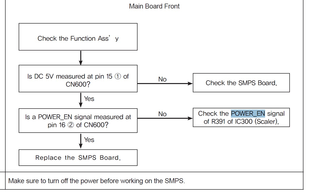

                  Anyway .... ok then, I checked one arhive that I got (I think here, somewhere) for 2493HM monitor, which included schematic for power board as well (since most datasheets only has PDF file for main/logic board). I was thinking ....'2493HM main/logic board,.... lets see if they mantion what voltage is expected on POWER_EN pin (datasheet was for power board BN44-00192B & BN44-00195A) And then...I think I found it:
                  It said (yellow box):
                  PFC Voltage Booster circuits.
                  When QB851 turns on by the PS_ON ( = about +3V) signal form the main board, Transistor in OPTO PC80s is then turn on, which will turn on QB802, which will supply VCC for PFC IC Controller ICP801S, that is when the DC gets boosted up by the MOSFET QP801S, Diode D802, Inductor LP801.

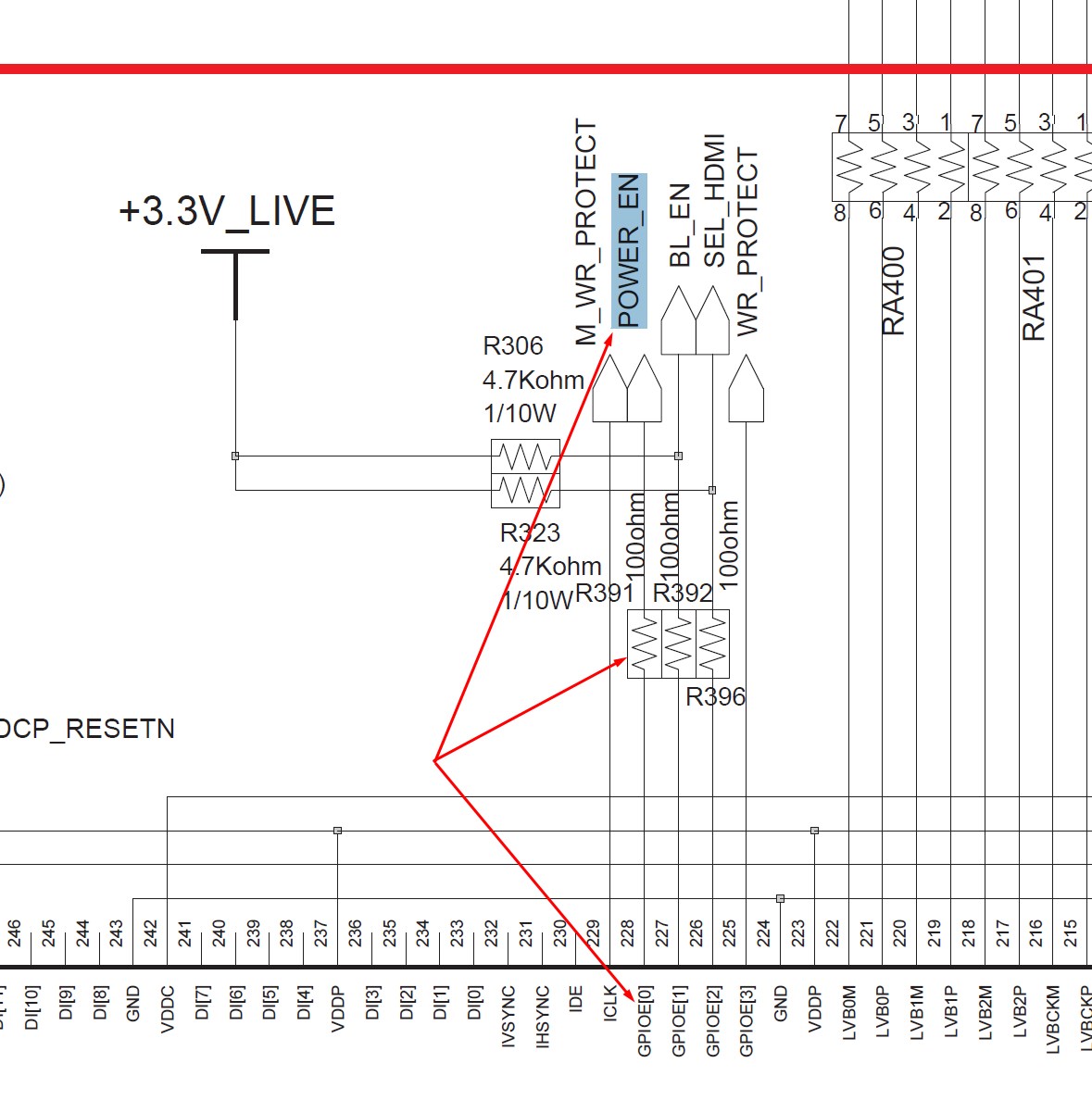

                  So... if my logic doesn't tricks me... I would say that expected voltage for POWER_EN pin is ~3.3v and not 5v as I was expecting. Correct?
                  I was expecting to get 5v there, at least thats how I undertood it. I'm reffering to post #26, here is the quote:
                  I was told that standby voltage should be present at powerboard connector pin, and only then, it will be able (once its shorted to the PS_ON) to provide voltages to other boards which are connected to a power board. Now I'm thinking.... my monitor is disassembled. If I don't touch (press) monitor power button, how can then the voltage be sent to other boards of the monitor? I guess when I press power button on a monitor, it short 'standby' pin with PS_ON pin and then voltage is 'sent' to main(logic) board? Did you assumed that all other monitor parts are all connected together so that I can check voltage on POWER_EN pin? They are not connected...
                  So when you try to measure POWER_EN / PS_ON, you should have, at a minimum, the PSU board connected to the logic board.
                  The way it works is that PSU board generates 5V standby on pin ST_BY (on connector CNM803). This 5V standby voltage powers the logic board in standby / soft-off mode (and on the logic board, ST_BY is connected to 5V_MICOM on connector CN600.) When you press the power button on the monitor, the logic board interprets that and sends a signal on pin POWER_EN of CN600 (which goes to PS_ON pin on the power supply board on connector CNM803.) The power board "reads" the POWER_EN / PS_ON signal and turns On the rest of the voltages - i.e. 18V, 5V, and whatever other voltages there are.
                  Depending on implementation / design, typically POWER_EN / PS_ON either has to be pulled high (to 5V) or low (to 0V or grounded) to make the power supply board turn On. From what I have seen, most monitors use an active high signal to turn On the PSU (meaning you have to feed 5V into PS_ON pin to turn on the monitor.)
                  But in the above case with the voltage measurement at PS_ON / POWER_EN, I'm trying to have you do that so we can determine if the monitor is trying to turn On or not and also to confirm if PS_ON is active high or not... though I would guess that it is.)
                  ^ could you help me understand? Could 3.3v actually be the correct voltage for POWER_EN pin? (since it also managed to 'activate' the power board and make it produce 18v and 5v on its connector pins). Or, I have to get 5v on POWER_EN pin and something is not fully right here?
                  I also checked the service manual for my 2693HM monitor, by searching 'POWER_EN' ...and on page 17 its mantioned to check if there is a signal on R391 (they never mantioned what voltage value should be expected). Then, I saw 2 things. Even though its not connected to, there are resistors there right next to R391 which are connected to 3.3v line. Maybe that sais something but there is no connection there to R391. Then I checked to which pin that R391 is connected to a big IC300 chip. It connects to GPIOE[O] (pin 228). But there is no mantion what voltage comes out of that pin. Then I tried to google and try if I can find datasheet for that big IC300 chip: MST97889CLD-LF. But ofc, there is no datasheet available for download anywhere. Would be great if someone has such datasheet, but I doubt that.

                    Anyway, I'm trying to allow myself to think that the new main/logic board should work 'ok'. But I got some questions before I proceed:
                    1. The fact that I used spare 102nF instead of 100nF capacitor (which I lost) is no big deal, correct?
                    2. I want to dissolder firmware chip from my 2693HM main board and solder it to 2493 main board. Two questions here:
                    a) whats the easiest way to desolder it (and not damage all 8 legs) with an soldering iron? (I got no hot-air). I was desoldering these ICs before but I didn't cared much since I just played 'desoldering' game. But now I must not brake things so that puts preasure on me.
                    b) I thought that there is a one firmware chip but now I'm confused because there are 2 and I don't know which chip is the one that I should desolder.
                    IC303 - MX25L4005 (this is the one I thought to desolder, and service manual list it as: IC-FLASH MEMORY; MX25L4005, 4Mbit, 512Kx8Bi - SM list it as IC115)
                    OR
                    IC302 - S-24CS08AFJ-TB-1GE (this one got me thinking because service manual list is as: IC-EEPROM; S-24CS08AFJ-TB-1GE, 8Kbit, 1Kx8 - SM list is as IC112)
                    ... OR.... I should desolder and switch BOTH chips?
                    My guess was MX25L4005 (even my MiniPro programmer found it in its base) but then this IC302 (in service manual is close to a 'scaler' written in red) maybe that is for making a monitor 'stretch the picture' of whatever its function is (I guess I'm making no sense). Btw. where EDID information is written?
                    What do you think? I'm not russhing things (if you didn't noticed that by now ), so I'll not proceed until someone more experienced and smarter than me answer.

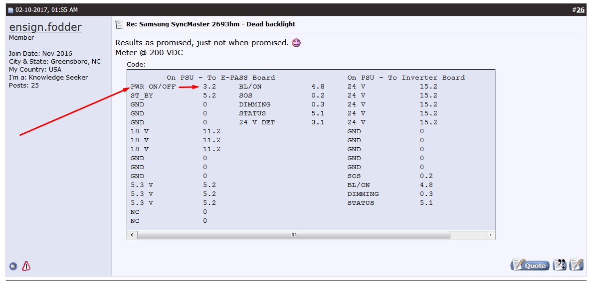

                      One extra information that I've found in another topic (post #26):
                      Samsung SyncMaster 2693hm - Dead backlight
                      While ensign.fodder's monitor had different issue, he measured some voltages there and, as it can be seen, he also found that the POWER_EN (or PSUs Power ON/OFF) pin has 3.2v, which is exactly what I got (3.214v).
                      So that might also confirm that ~3.2v (~3.3v) is expected voltage on POWER_EN (Power ON/OFF) pin. What do you think?
                          Again, this is made possible by the small reverse leakage current of D602. Every diode has a small reverse leakage current. Check datasheet. Because this current is so tiny, it doesn't take much for the voltage to change. If you had a bit more sweat on your fingers and happened to touch across C610, that alone could decrease the voltage easily by a few Volts.
                          In fact, if you try putting a very tiny load (like 10-100 KOhm resistor) across C610, that alone would probably keep the voltage down to 0.xV most of the time.
                          Then again, the higher voltage could be due to a malfunction of IC300, triggering the PSU to pulse on very shortly every once in a while.
                          When you have a malfunctioning IC that is responsible for turning on and off the PSU, you also have to factor in that this could be what is upsetting some voltages.
                            Well, it's the same board, technically, +/- a few components. So kind of makes sense why it has the same part number... except one being type "A" board and the other being type "B".
                            Not bad at all!
                            Normal operation there.
                            POWER_EN = high ---> monitor is OFF/standby
                            POWER_EN = low ---> monitor is ON
                            The precise voltage of POWER_EN is not that important.
                            Generally, for HIGH/LOW signal lines like that, there is a threshold that determines if a signal is considered "LOW" or "HIGH". And there is also a "deadzone" / undetermined /transition area that is ignored.
                            So for example of a 3.3V signal line (like your POWER_EN signal seems to be), probably something like 0 to 0.8V is considered low, and 2.7 to 3.3V is considered high. The "deadzone" area between 0.8V and 2.7V may be ignored and the monitor may not change states until it goes either below the maximum LOW voltage threshold or above the minimum HIGH voltage threshold. That said, I'm using the values of 0.8V and 2.7V just as an example here. They may be something different. It should be stated in the datasheet of the supervisor IC used on the PSU board.
                            But again, it looks like your monitor's PSU is turning On and Off properly, so no need to bother investigating this any further.
                            Yes, correct.
                            I incorrectly assumed POWER_EN is 5V, simply because +5V_MICOM going to the logic board is 5V. It doesn't really matter too much, though. If you "dump" 5V into POWER_EN with a high-resistance resistor from +5V_MICOM, the PSU board will still turn on, because even that will satisfy the HIGH/LOW logic requirements for the signaling.
                            Don't.
                            Not yet, anyways.
                            First try the 2493HM board "as-is" in your monitor.
                            In regards to the components you already moved (C610, D602, and etc.) - that's fine, you can leave those.
                            But since your monitor seems to respond normally to On-Off commands from the 2493HM board, just put that in there, assemble the monitor enough that you can test it, and see what happens.
                            Again, the WORST that could happen is that the backlight controls/brightness *might* be slightly off or not working due to some small differences in the backlight control circuits. But I'm pretty sure Samsung designed this so that nothing would fry or break by using the 2493HM board directly as is on your monitor.
                            So try it and see what happens. If it works, I say DON'T mess with desoldering firmware chips. In fact, the firmware chip from your 2693HM logic board may try to "ask" the 2493HM board to do something that it isn't capable of, and that IMO is more likely to introduce "bugs" and incompatibility than straight-up running the 2493HM board with the 2493HM firmware.
                            In other words, do the firmware swap only if the backlight controls don't appear to work normally (or you notice some other bug.)

                              Can you check the image of the main/logic board that I attached, and view the area in top-left corner of the board. You'll see a pads where C609 ceramic capacitor should be placed (its not my board, its from the shopppjimmy). Can you try to guess whats the package size of that capacitor that I soldered? I just want to know what is my soldering 'achievement'
                              Before soldering that capacitor I desoldered couple other of simmilar size and put it in the small box. I showed the box (with ceramic capacitors in) to my father and told him 'check the size of the capacitor that I finally soldered on the board'. He checked the inside of the box and said something like 'what capacitor, where?'. I was like 'exactly' After that he asked 'this? those are capacitors? They look like dirt or dust'
                              It wasn't easy for me to solder that small capacitor back at all. Was looking for too long through magnifying glass and my eyes started to complain long after I finished it. I guess I would have to try to make a DIY microscope from a webcam or something like that.
                                Not bad at all!
                                Well... I would guess thats a cheap price from your point of view, and even from my own. But checking some sites where sells spare parts (spare PSU or LOGIC boards), like the one I mantinoed few times here (where I got the images of both 2493HM and 2693HM main boards), price range is so high that it kills the whole idea of 'fixing' any monitor. Because... if the used (but working) monitor cost... lets say 50 bucks, whats the point of buying a board that cost $45 to fix a faulty monitor? And sometimes the cost of the board itself is higher than the price of used but working monitor.
                                So yes, I got it for cheap, but I think its only because I was fixing my 26" monitor, which has a higher value compared to 24" (or 22") monitors. But if I was for fixing 22" monitor that price would be on the 'line' where I would have to decide if the price would kill the whole purpose of fixing it because used 22" here can be bought for 25-30 bucks)
                                Also, another reason for me trying to fix my monitor (and it the future other ones) is to learn things while doing it, even if the end price might be against common logic.
                                You can expect at least 5% tolerance on most power components in circuit. For ceramic caps, even 10-20% from original value is not too far off.
                                And that cap really is just for filtering any possible high frequency noise.
                                Board will probably run OK without it in most circumstances. Or if you used up to 1 uF ceramic, that would be OK too. So don't sweat it - the value of these caps is rarely that important.
                                Ok the PSU board will turn on, and...what would happen next? I guess nothing, because.... there want be a picture since the main board (brain IC300 chip) is dead. Correct?

                                  Ok, and finally the interesting part (I know I bored you complitly with my questions ^ above. Again, sorry about that, I really had to ask them)
                                  You guessed most of it (if not even everything) correct.
                                  Ok, I didn't changed the firmware chips (one of the reason being for not being 100% sure which one is the correct one, or should I switch not one but two chips from one board to another.
                                  DVI and HDMI ports work (didn't tested VGA port, but there should be no reason not to work).
                                  BUT...
                                  Once I was in my desktop, brightness apears to 'breath'. Like... I don't know if I'll explain this well...
                                  It was like trying to ...'adjust' itself. Like... switching to brighter, then go darker, then brighter, then more brither, then back to darker, then again brigth, brighter, darker.... etc.
                                  Now I'm not sure.... but after some time that calmed down. Still, because at the time I was aware of what was happening, I took a closer look by observing it and...I kinda (think) to see tiny fluctuation in brightness.
                                  Why I'm not sure? Its because I tried to see WTF is wrong by using OSD menu. And yes, you were right about brightness. It was set to 100%, but changing it all the way to 0% did nothing. It kept being very bright. Thats 'good', BUT...back in 2017 when I switched capacitor on power board, I decided to turn down the brightness (and contrast) to, I think, ~ 35%-40% because that kept my monitor from not being very hot at the back (plastic cover). But now, while I was observing my 26" monitor for probably 30 minutes, back cover of the monitor was pretty hot (somewhere in the area where power board is). And... I could smell...the 'electronic smell'. I don't know how else to express myself about that smell.
                                  Contrast did changed while I was changing it over OSD menu, but...(maybe I'm wrong) I think the change was not as it was in the past (while old main board was still working).
                                  One thing for sure is: changing brightness by using OSD menu, does nothing. And I need to change it (to lower it) so that I can extend the life of my CCFL lamps. It was noticable if you pay closer look at the right vertical edge ofo monitor screen that there is a 'darker' fat (of a thumb size) or better call it 'strip' across that edge. Ofcorse that can be seen only because I know the flaws of my monitor. And I know where to look. If you observe the monitor as a whole, that right edge of the screen is not that noticable.
                                  So...I turned off my monitor and let it wait for some better time until I buy hot air station. Then I could try to switch firmware chips and try to see if brightness could be lowered from the OSD menu. I just have to determ how many (and which) chips are firmware chips.
                                  One extra thing that I notice while being in OSD... I don't remember if I saw that option on my old main board, but...there is a setting for something called 'HDMI dark level' or something like that. That was there, but 'not available' for changing. I don't know what that is for.

                                    Interesting.
                                    Yeah, looks like the firmware on the monitor programs how PWM0, PWM1, and PWM3 signals from IC300 behave.
                                    If you open up the SM and go to page 81 (last page), take a look in the top-left corner at the circuit diagram for CN601.
                                    I think it's written in a very VERY confusing way (or maybe it's just mislabeled?) But if I'm understanding it right, at least from what I'm given...
                                    For 2693HM:
                                    PWM3 (signal from IC300) ---> A_DIM (Analog DIM) ---> pin 4
                                    PWM0 (signal from IC300) ---> BRT_CTL (PWM Method) ---> pin 3 (?)
                                    PWM1 (signal from IC300) ---> PWM_DIM (PWM_DIM) ---> pin 2 (?)
                                    And based on the table to the right of that...
                                    Status on 2493HM is outputting where Analog_DIM is on 2693HM.
                                    Analog_DIM on 2493HM is outputting where PWM_DIM is on 2693HM.
                                    PWM_DIM on 2493HM is outputting where PWM Method is on 2693HM.
                                    So I think that ^ above might be why you can't control the brightness.
                                    Now, *IF* the above information I posted is correct, I *think* it may be possible to just re-wire the inverter control on the 2493HM board, should you'd prefer to do that instead of swapping the firmware (if you think that would be easier / less likely to break something.)
                                    What I am thinking *might* work...
                                    First, take the wire harness that goes between CNM801 and CN601 - that's the wire harness for the inverter board control (i.e. the smaller cable "bunch" shown at the top between the boards in this picture.) On the side where it plugs into CN601, see if you can remove the wires from the plastic part of the connector. Typically, that can be done by pushing on the metal pin bit in the cutout in the plastic. We need to move the wires that go to pins 2, 3, and 4 only, so remove those wires from the plastic connector. (If you can't, post a picture of all sides of the plastic of the connector.)
                                    Next, plug the wires as follows:
                                    Move wire #2 to pin position 3 on the plastic connector.
                                    Move wire #4 to pin position 2 on the plastic connector.
                                    Move wire #3 to pin position 4 on the plastic connector.
                                    This modification should not damage anything on the inverter board or the logic board, because according to the service manual, pins 2, 3, 4, and 5 are all output pins, and they all operate between 0V and 5V. So bad comes to worse, the backlight brightness will either be stuck at max (100%) again or min (0%).
                                    With that said, if the above modification does not work, disconnect wire #3 (which you modified to plug into pin position 4) and see if that helps. If not, you might have to bust out your multimeter again and take some voltage measurements on CN601 with the monitor On and @ 100% backlight brightness in OSD, then @ 0% backlight brightness in OST. (Hint: for this test, it might be helpful to solder long wires to the pins on CN601 so that you can measure them when the monitors is closed up so that you can access the OSD menu.)
                                    Anyways... again, the way the SM is written in regards to the backlight control is absolutely stupid. I wouldn't be surprised if there is a mistake in there. So when I was doing the above suggested modifications, I was referring to the pictures you provided of your old 2693HM board to make sure we don't make a wiring mistake somewhere. On that note, if you could provide a picture of your new 2493HM logic board, that would be great so we can compare.
                                    But all in all, I think the above experiment should be safe to try with the wire swapping @ CN601. At least that might get your monitor working again without having to swap firmwares.
                                    As for your other questions, I'll answer them in another post (or rather more posts) after this one... and may not be able to get to all of them today (it's almost 2 AM here.)
