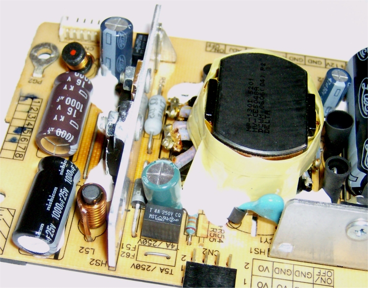

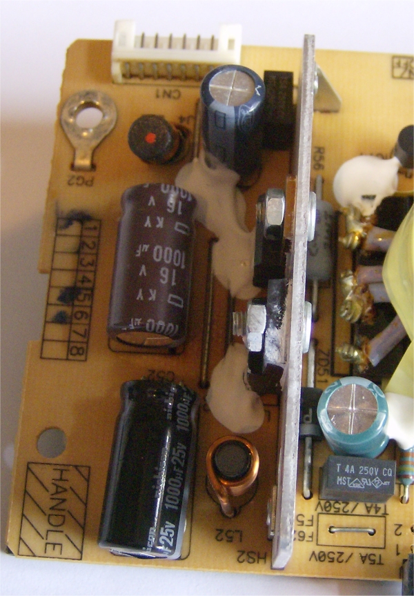

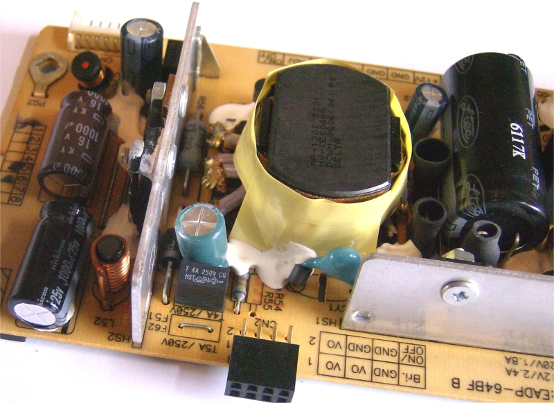

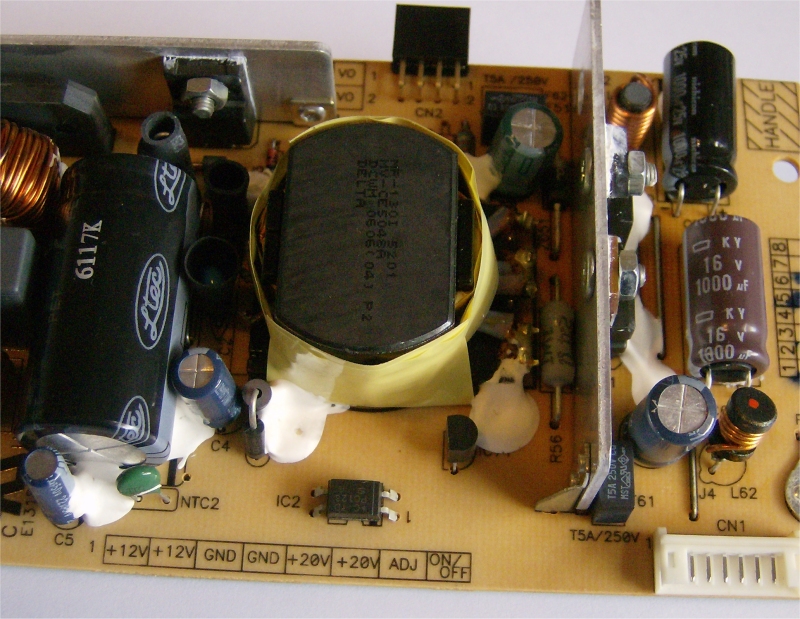

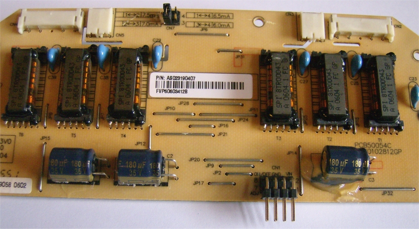

                    Thanks PlainBill. I've attached detailed pics of the inverter board and power board on this post. I can get to the main board later if required.
                    Inverter Board INV20-6009
                    There are only 3 caps on this board - these were CapXon 180uF 35V 105ºC - and when the "on/off" problem first manifested itself I found these were well blown, so I replace them with Panasonic 180uF 35V 105ºC caps part number EEUFC1V181 (pic Invboard_1). However, this did not cure, or change, the problem.
                    Power Board EADP64BF B
                    This board is populated with a total of 7 caps, here are the details.
                    1 x 1000uF 16V Can't make out the name but its the horizontal light brown cap shown in the Pwrboard pics.
                    1 x 1000uF 25V Nichicon Black horizontal next to brown cap
                    1 x 220uF 25V Taicon Upright just behind aluminum heat sink
                    1 x 47uF 50V Ltec Along side the large cap
                    1 x 22uF 50V Ltec At the base of the large cap
                    1 x 150uF 400V Ltec Large horizontal cap - can't actually see the rating for this cap, but pics of replacement boards clearly show it as noted
                    1 x 470uF 16V Ltec Upright cap next to the horizontal caps
                    All of the above are 105ºC rated. I'm not sure about the series of any of these caps. How would this be indicated on the cap?
                    As said in my last post, visually all the caps look good. There is a slight heat discoloration under the heat sink next to the Nichicon and unidentified cap.

                        You are correct, all the caps look physically fine. The light brown cap is made by United Chemicon. The 'crown' logo is distinctive. Rereading the thread, I had a similar experience with an earlier version of your monitor - a VP211B. I 'fixed' that one by swapping the logic card.
                        A couple of suggestions come to mind.
                        1. Try operating the monitor with the back off to see if the improved cooling has an effect.
                        2. Try measuring the output voltages of the power supply while the monitor is working and again when it fails.
                        3. I prefer a single over-all shot taken from directly above rather than a series of more detailed pictures. I'd like on of those of the logic card (video processor, etc).
                        4. The Nichicon and United Chemicon caps are a good brand, the others are suspect. I suggest replacing them all. This is a process for selecting caps.
                        PlainBill
