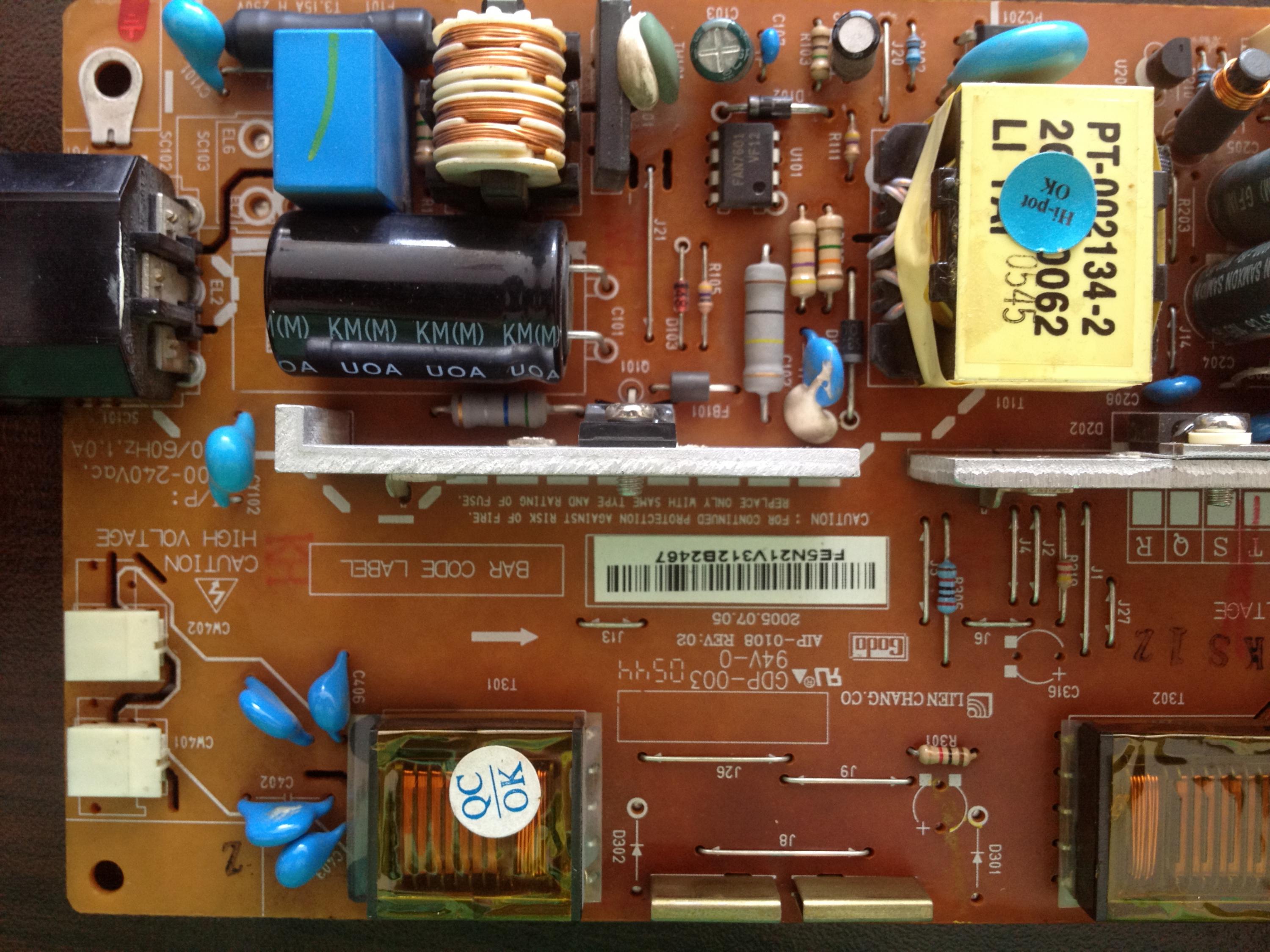

    i crossed the filter @ junction C101 and got 160.8 dcv <bk>
    @ connector CW201 pin6 =5 dcv. and pin7= 5 dcv , pin10=13.78 ,pin 11=13.78. <bk>
    8pin ic @ U101 i jumped pin 1 and 5 and got 115 dcv. <bk>
    thats how i determined the power board was in good shape. <bk>

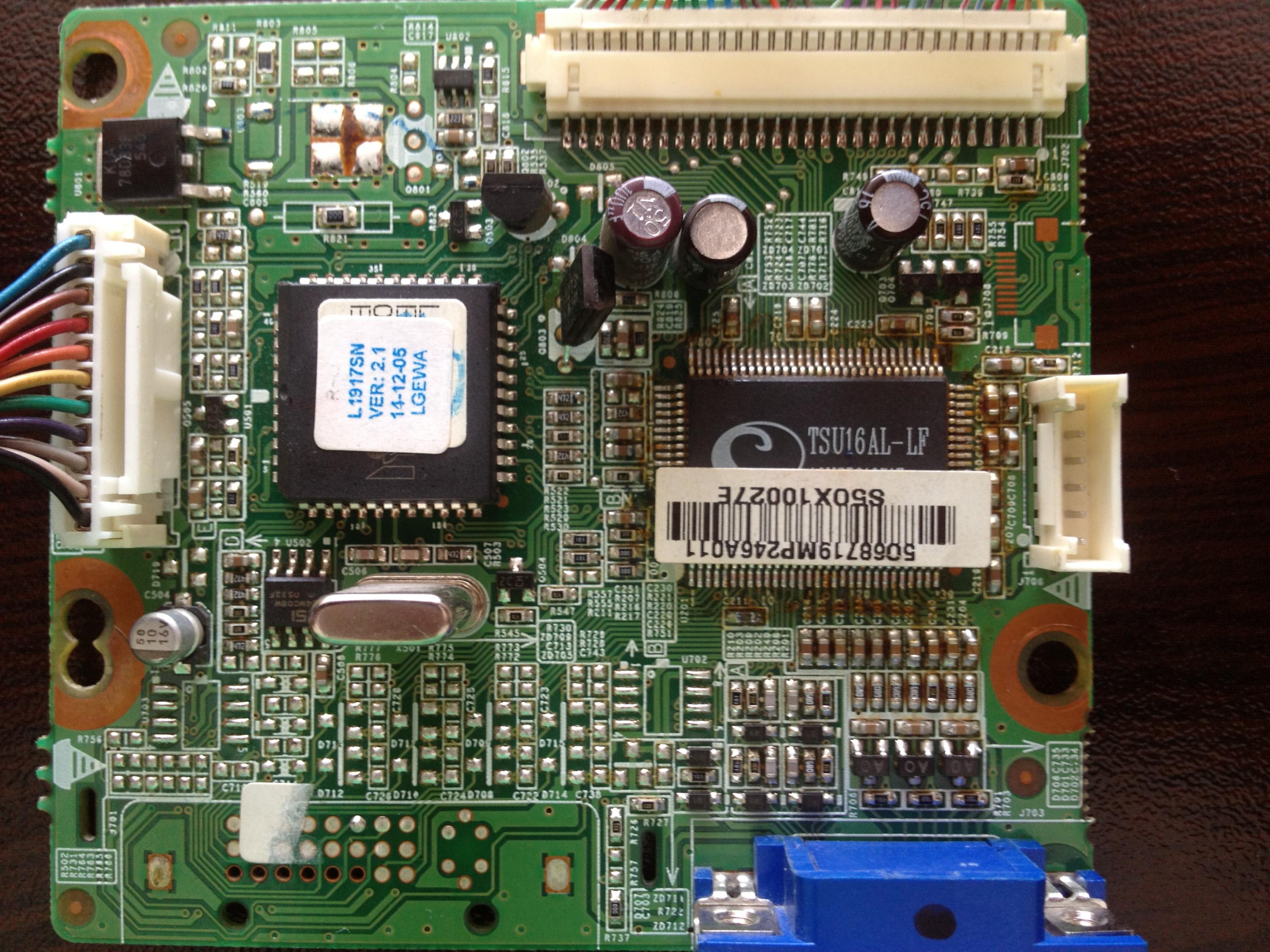

    now for the logic board the parts you circled.<bk>
    U202= 3 TERMINAL LOW DROP OUTPUT VOLTAGE REGULATOR part#kia78D33F
    i had 4.4 dcv going in and 3.0 coming out.<bk>
    U203= PART#LD18 it is a 3 prong surface mount made by STmicro but could not find a data sheet or that part either? but i had 3.0 dcv on pin 3 and 1.5 dcv on the drain. <bk>
    U407= 3 TERMINAL LOW DROP OUTPUT VOLTAGE REGULATOR #Kia78D33F i had 3.4 dcv. in and 2.1 dcv. out.
    datasheet.

        Those voltages look good. 13.78 is a little high, but that would be normal if the backlight was off.
        That output seems a little low, as does the input.
        LD18 rings a bell. I'l do a little checking.
        I may have given you some bad advice. If you would, check the input and output voltages of the three regulators with the black probe on the tab of the regulator. Those input and output voltages are low. I would expect one or more of 3.3V, 2.5V, and 1.25 V out of the regulators.

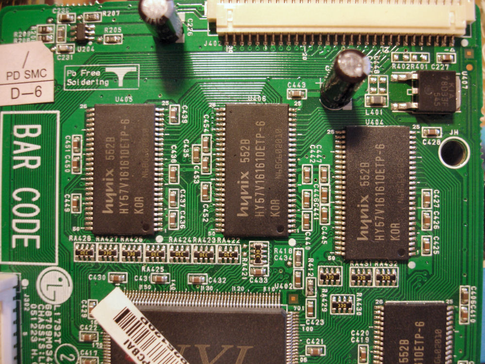

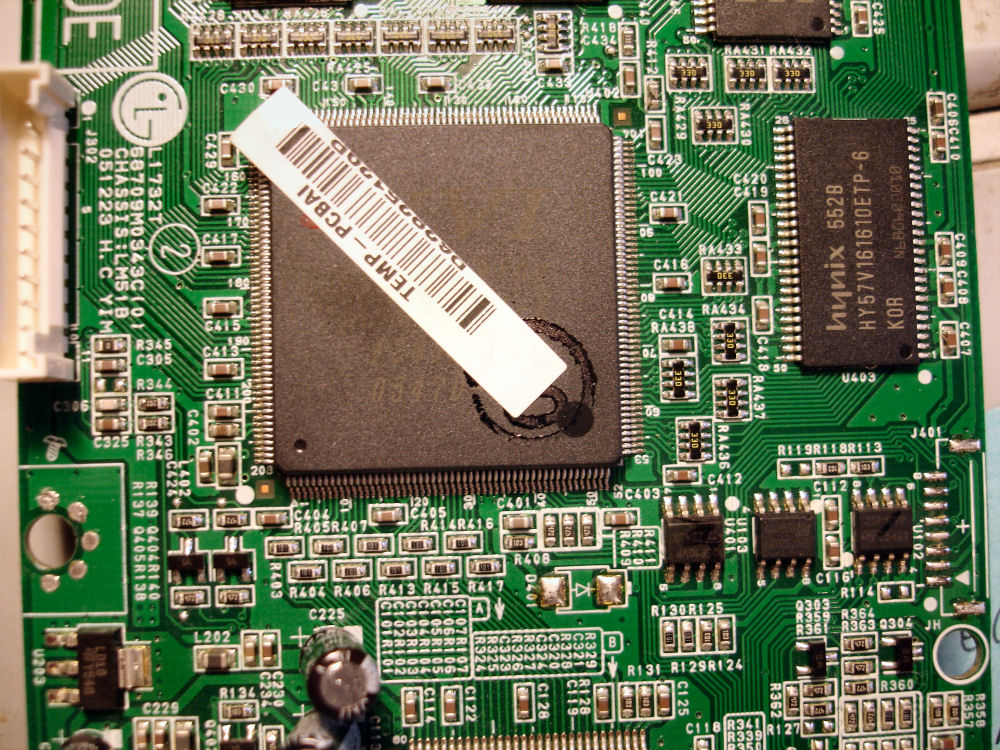

        Also, would you take a bigger picture of the logic board. I'd like to see the complete board, as well as more detail. I want to see where the panel gets power.
        PlainBill

          regulator U202-pin-1 (4.4) pin-3 (3.0)
          regulator U203-pin 1-(1.6) pin 2 -0 pin-3 (1.5)
          regulator U407- pin-1 (3.58) pin-3 (2.1)

              OK, I'm baffled. Those voltage definitely are lower than I would expect.

                        I have an LG Flatron L1952 with the same symptoms. I have an esr meter, and checked all the caps. Like the quote, I only found one bad cap. I wanted to let you know the location, but I forgot to write it down before reassembling. It was 1000/16 and slightly bulging.
                          #52
                          Re: LG Flatron L17NT-A no power
                          i've got a LG L1952HQ here.
                          there are only 2x 16V 1000uF caps in there.
                          all caps are samxon GF though, so only replacing the single bad one isn't gonna last long.

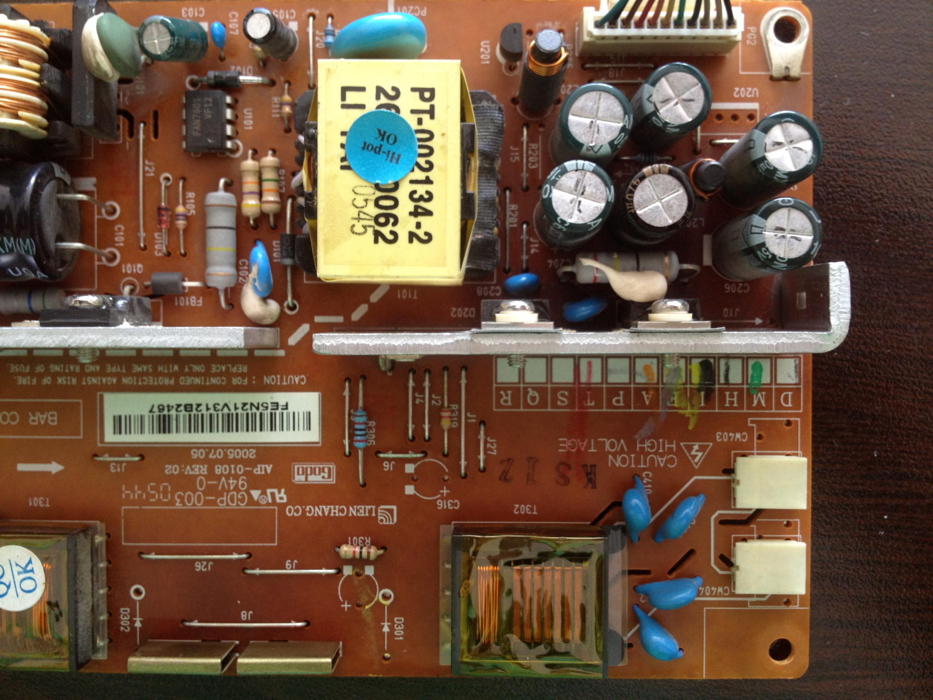

                                OK first of all great site! it's always good to have a place to look for help when things go bad.
                                My problem is my lcd went dead. it's a flatron pcb inverter board that i used with a microtek 17" lcd coz the microtek board died too.
                                caps removed:
                                c202,c206: 1000uf 25v
                                c203: 680uf 25v
                                c204,c205: 1000uf 16v
                                c207:470uf 25v
                                c103: 33uf 50v
                                c105: 0.47uf 50v
                                i've removed the big green caps although i just found 1 bulging cap(c204).
                                i also removed c103 & c105 and noticed a black carbon residue on the base of the caps.
                                the biggest cap measured something like 336Volts.
                                i'm buying the replacement caps first thing in the morning and see if i can make this thing work again.
                                look at that! a ferrite bead? FB101 blackened around the sides and some black carbon residue on the base..
                                is it toast? how can i replace that?

                                  Some members including myself would prefer pictures posted using manage attachments. Whilst yours load quickly they do not enlarge much.
                                  You can test a ferrite bead - same test as a fuse - meter on ohms 200
                                  should show the same as touching probes together.
                                  You can buy them? If it is open then perhaps you can take it to bits and then thread the beads onto a new wire.
                                    #57
                                    Woohooo! i replaced all caps and it works again!! thanks to all!

                                        The ferrite bead was alright, i think it's the heat that caused the residue on the board and it was originally black with orange paint on top.

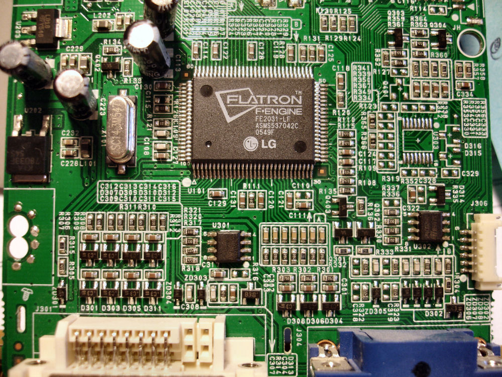

                                          However, I start to measure the logic board. I get too low voltages there (on U801 - KIA 78D33F - next to the 11 pin connector).
                                          The input against was showing 0.14Vdc and the output 0.01Vdc (0.01 could be an error into my tool).
                                          So because I was just curious, I measure the 11 pins once again with both boards connected to each other.
                                          I notice that the voltages at pins 6,7,10 and 11 was dropped and decreasing till I hold the probes on them.
                                          I disconnect the boards and measure the power board once again. All the voltages are with the same values as the first time. Then I connect the boards again and measure. I notice, that the voltages was increased with +2Vdc, but dropping again.
                                          So, in a minute to all these four pins I get 0.00Vdc.
                                          I'm not sure what's going on, but there seems to be issue with one of the boards and I'm not really sure which one. The power board is working great when it's standalone, but connected to the logic board it's dropping the power. I'm not sure if this is power board issue or the logic board create the dropping power issue.
