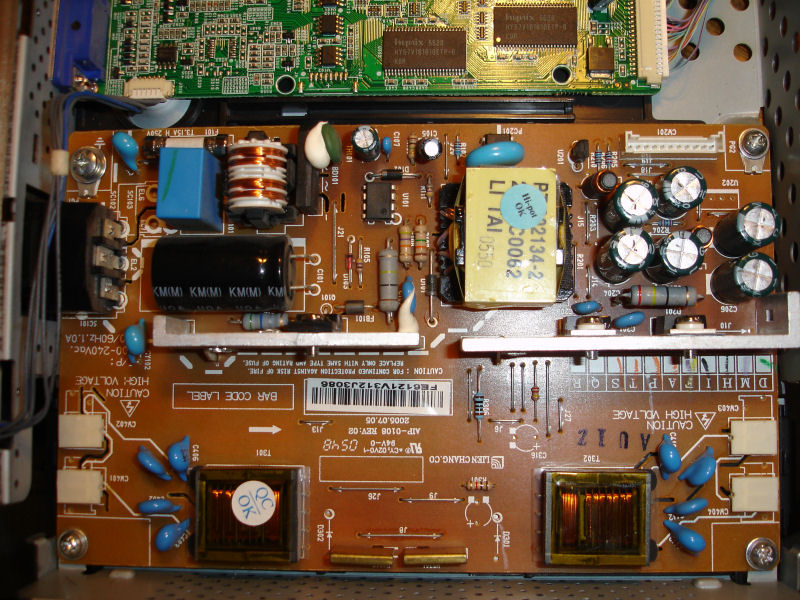

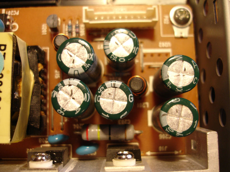

    Okay, so I finally got around to getting up the list of my caps.
    I'm not too familiar with the markings, so I'll include everything.
    There are 8 total, as you mentioned.
    They are all Samxon, all 105°C6, and all GF(M) unless otherwise noted:
    (2) 1000μf, 25v, V5A, 10mmx20mm
    (2) 1000μf, 16v, C6A, 10mmx20mm
    (1) 680μf, 25v, V4A, 10mmx20mm
    (1) 470μf, 25v, V4A, 10mmx15mm
    c103: 33μf, 50v, V5A, GF(M), 7mmx12mm
    c105: 0.47μf, 50v, V5A, KM(M), 5mmx10mm
    Does that give you what you need?
    I'm going to try looking them up again now, but I wasn't having much success last night, so your help would be appreciated.
    Thanks!
    Elmojo
    (2) 1000μf, 25v, P10278-ND EEU-FC1E102 @ $.87 ea
    (2) 1000μf, 16v, P12366-ND EEU-FM1C102 @ $.59 ea
    (1) 680μf, 25v, P12390-ND EEU-FM1E681 @ $.59
    (1) 470μf, 25v, P12388-ND EEU-FM1E471 @ $.50
    c103: 33μf, 50v, P10320-ND EEUFC1H330 @ $.27
    c105: 0.47μf, 50v, 493-1885-ND UPW1HR47MDD @ $.34
    The number that ends in ND is the Digikey stock number, the second number is the manufacturer's part number if you prefer to buy from another source. The dimensions don't exactly match, but none are higher (I think, double check when you order).

              Dimensions are non-critical, except for clearance. You will have to determine actual spacing, I felt from the pictures is should not be an issue. Both 10 and 12.5 mm caps usually have the same pin pitch.
              Replacing the caps is usually quite straight forward. I believe this is a single sided PC board, so there are few problems. Just make sure you check orientation before soldering in the replacements.
              I usually make a crude sketch showing where each cap goes, pull all the old caps and cleaning out the holes with a dissecting pick as I go. Then I insert all the replacements, then double check the orientation. Solder, trim the leads, scrub the board with alcohol, then check for solder shorts.

                  The behavior of the power supply is consistent with a bad Vcc cap for the SMPS controller. That is no guarantee, but that's the way to bet.
                  If it still doesn't work we troubleshoot for power supply problems.

                    Alright guys, we're making progress!
                    I got the caps from Digikey yesterday.
                    Tonight, I replaced all the caps, powered up the board, and measured the voltages on the 12-pin plug again.
                    This time, I got 2-5v sources and 2 13.xxV
                    Yay!

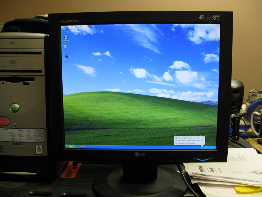

                        EEETS ALIIIIVE!!!!
                        I absolutely cannot believe it, but this thing is working 100%!
                        Bill, you should change your name from PlainBill to PlainAwesome!
                        I changed out the caps, reassembled everything, and it fired up first time.
                        I don't even see any dead pixels on this sucker.
                        I can't thank you enough for the time and effort you spent helping me through this repair.
                        Is there any way to award you stars or points or whatever on this site?
                        I only hope I can one day help someone else in the same way.
                        Thanks again!

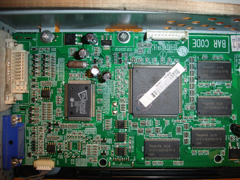

                                Plainbill i was wondering if you might help me out on my lg monitor it is the same exact setup you were helping Elmojoe i followed all of the steps and i have a working power supply but the monitor is still dead i did see once when i tried to hit the power button the leds flashed quickly once and thats it. thanks in advance

                                  Glad to help, it might take a couple of posts to get me up to speed. You say you have a working power supply. Just to give me a sense of security, how did you establish this?
                                  With a good power supply, the two places to look are the logic card, and the panel itself. Would you post pictures of the logic card, please.

                                      Well, one thing stands out. I don't see a cable connecting the power supply to the logic card.

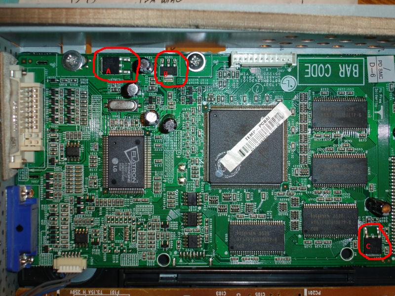

                                          A few points. I'm old and crotchety. Communication is important. Long sentences without punctuation confuse me. I compensate by moving on to the next thread.
                                          First, I'd like a definitive answer to an earlier question. How did you determine the power supply is working? Answers like 'and i have power at the points you pointed out so i didn't see anything else' don't really do much except give me a headache. Answers like "I measured 5.43 volts at pins 4 and 5 of the 18 pin connector on the logic card" tend to indicate someone knows what he is doing.
                                          Next, I have labeled three ICs on the logic card. What are the part numbers of these ICs, and what are the voltages on the pins of each? I suggest using the screw head next to the Ic labeled B as the ground point.
                                          For extra bonus points, post links to datasheets for them.
