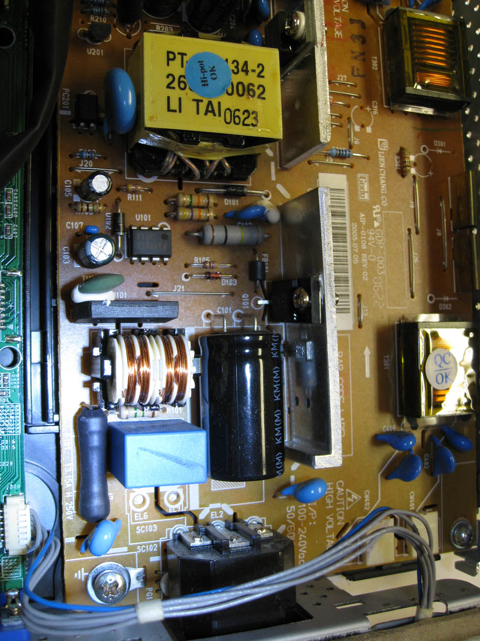

      1. Carefully measure the voltage across the large cap with the monitor plugged in. It should be about 1.4 times your nominal line voltage.
      2. If this is correct, measure the output voltages of the power supply.
      3. Attach a picture of the power supply / inverter board. It appears a couple of caps are bulging, but the small size of the picture makes it difficult to be sure.

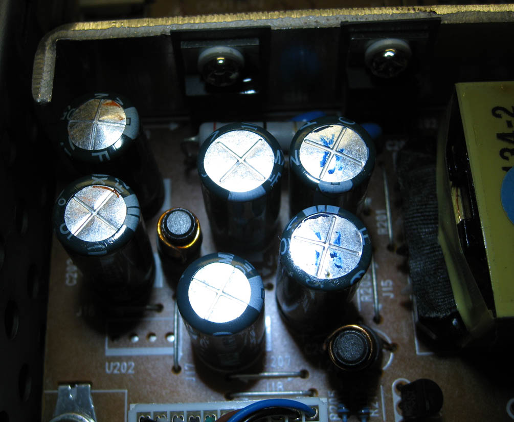

        PlainBill
        Agree. Look like we have some bulged Samxons

          PlainBill: When you say, measure across the large cap, do you mean between the 2 pins on the large black cap in the bottom center of the orange board on the second photo?
          As for the buldging caps, I assume you mean the greenish ones on the opposite side from the big black cap?
          I didn't even notice those until you mentioned it!

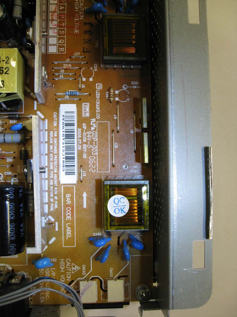

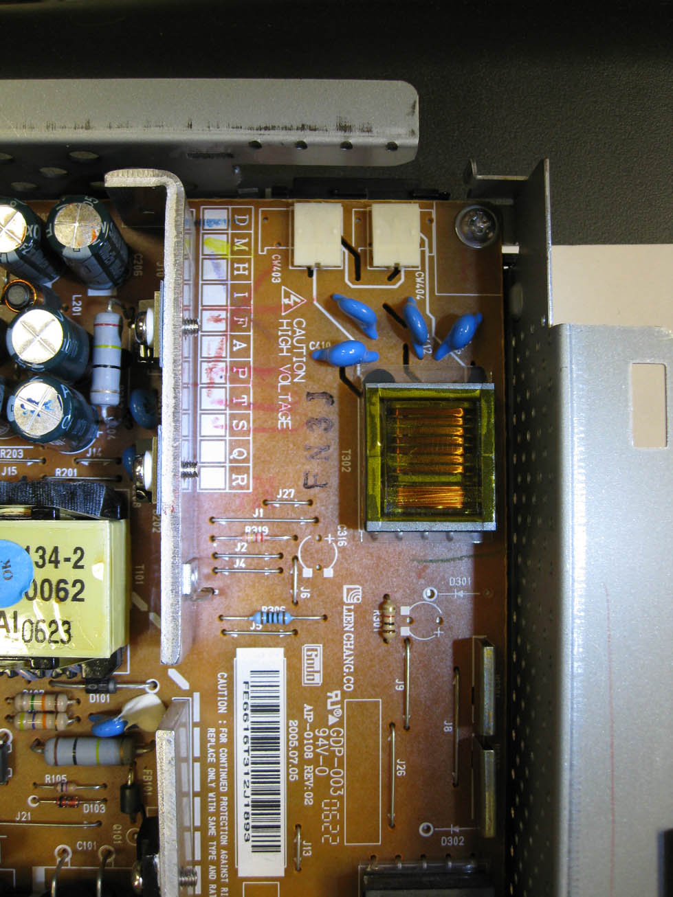

            Okay, I took some better photos.
            I hope these aren't too big, I chopped them down a lot in Photoshop, but they are still pretty detailed.
            I can clearly see at least 1 bulging cap. Anyone see any other suspicious areas?

                I see 1 cap that is definitely bulging, and a couple more that are suspicious.
                The bulging caps MAY be the cause of the 'no power' symptom, another cap may be responsible, or it may be on the logic board. Hang onto your hat, you are going to get a speedy tutorial in troubleshooting power supply problems.
                A short summary - all LCD monitors I have encountered use a similar concept. The power LED is controlled by the video processor on the logic card. A problem on the logic card MAY result in what appears to be a totally dead monitor.
                I prefer to use a 'divide and conquer' troubleshooting approach. Others use a 'walk through' approach; losers use a 'shotgun' approach (replace parts until you irreparably damage the board or it starts working).
                The first step of my approach is to CAREFULLY measure the voltage across C101 with the power cord plugged in. This should read approximately 1.4 times your nominal line voltage. In the USA this would be about 165 VDC. If this is correct we know the outlet, power cord, fuse, and bridge rectifier are all good, and the main filter cap is probably good.
                The next step is to switch to the 20VDC scale on your meter and hold the black lead on the screw labeled PG2 (near the 6 caps); then probe each pin on the 11 or 12 pin connector immeadiately below PG2. If any pin reads either 5V or 12V you probably have a working power supply. If you measure both 5V and 12V you definitely have a working power supply.
                If NONE of the pins show a voltage of 5V or greater, you have a bad power supply. In that case, the likely suspects are C103 and C105.
                At this point you have to make a decision. Do you recap the power supply at a cost of approximately $10, or do you give up.

                              Look at the very first picture you posted. They're the 6 electrolytic caps at the left end of the power supply and the two small electrolytic caps near U101.
                              PlainBill

                                        Okay, so I finally got around to getting up the list of my caps.
                                        I'm not too familiar with the markings, so I'll include everything.
                                        There are 8 total, as you mentioned.
                                        They are all Samxon, all 105°C6, and all GF(M) unless otherwise noted:
                                        (2) 1000μf, 25v, V5A, 10mmx20mm
                                        (2) 1000μf, 16v, C6A, 10mmx20mm
                                        (1) 680μf, 25v, V4A, 10mmx20mm
                                        (1) 470μf, 25v, V4A, 10mmx15mm
                                        c103: 33μf, 50v, V5A, GF(M), 7mmx12mm
                                        c105: 0.47μf, 50v, V5A, KM(M), 5mmx10mm
                                        Does that give you what you need?
                                        I'm going to try looking them up again now, but I wasn't having much success last night, so your help would be appreciated.
