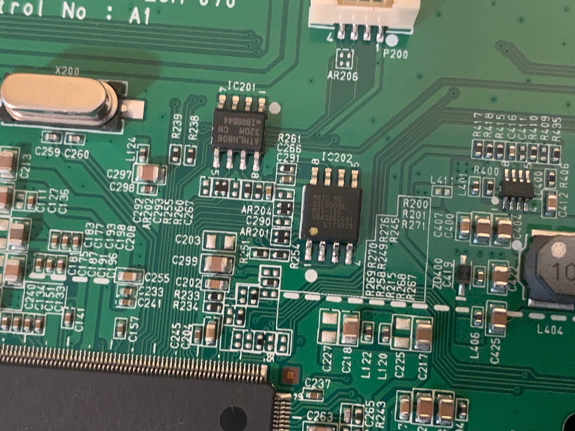

    Hello! im new im trying to repair my 34um95-C, i cant find the EEPROM is the hdmi EEPROM? Click image for larger version

        Could you describe/provide a diagram of how you connected CH341a to IC205 (mx25l8006em2i-12g) ?
        • ptk2024
          • Sep 2024
          • 2
          Does anyone have a dump file for the LG34UM88-P? Or advice on where to find it? I tried flashing with the UM95 at the top of this thread but no luck restoring the monitor yet. On my board it appears that IC202 is the EEPROM. Thanks for any insight!

                  I had a bit of trouble getting the clip to attach. It took me 5 or 6 worrisome tries before the MX25L8006E was detected. I used the binary from the zip in post #3.
                  FWIW, the SPI EEPROM on my board wasn't completely dead and flashrom (under Ubuntu 20.04) was able to read the contents. There was enough info to notice that the original binary contained source code files from July 30, 2014 while the binary in post #3 contained source code files from Jan 17, 2014, so it's not the latest version. Not a big deal. My monitor is back working.

                    hello everyone
                    my 34UM95P gives me a black screen
                    I have the backlight
                    I bought the CH341 and programmed the IC205 with the 3 .bins I found
                    with the lg34um95 and the lg34um95-p, I have the backlight, but nothing with the 34um95
                    I checked the 10V panel which is ok
                    any idea?
                    thank you everyone
                    • partition
                      • Jun 2025
                      • 2
                      • france
                      #30
                      I add that when I programmed the chip (and checked of course), when I turned on the monitor and when I read the chip again, there was new data on it
                      is this normal?
