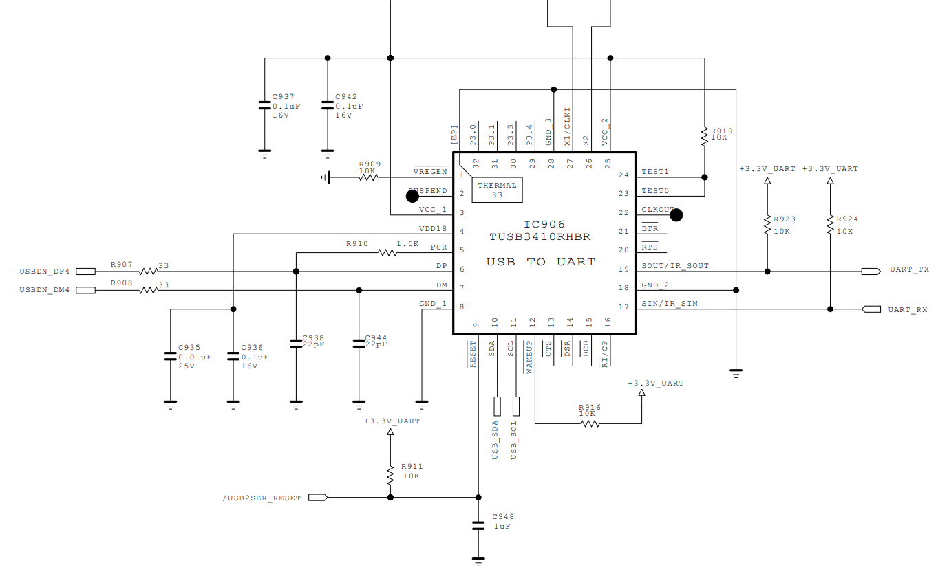

              My board is LM94Q/34UM95C/EAX65360307 (1.1) and has the IC906 on short circuit.
              On it is written 3410I TI 51K D2KH G4.
              I can't find anywhere information about this chip or where I can buy it.
              Please if someone can help me.
              Many thanks in advance.

                IC906 - TUSB3410RHBR - Texas Instruments USB Interface
                  Yes thank you very much!
                  I also find out that is an usb controller chip and I just took it out and the monitor works now.
                  I don't really need the USB on this monitor.

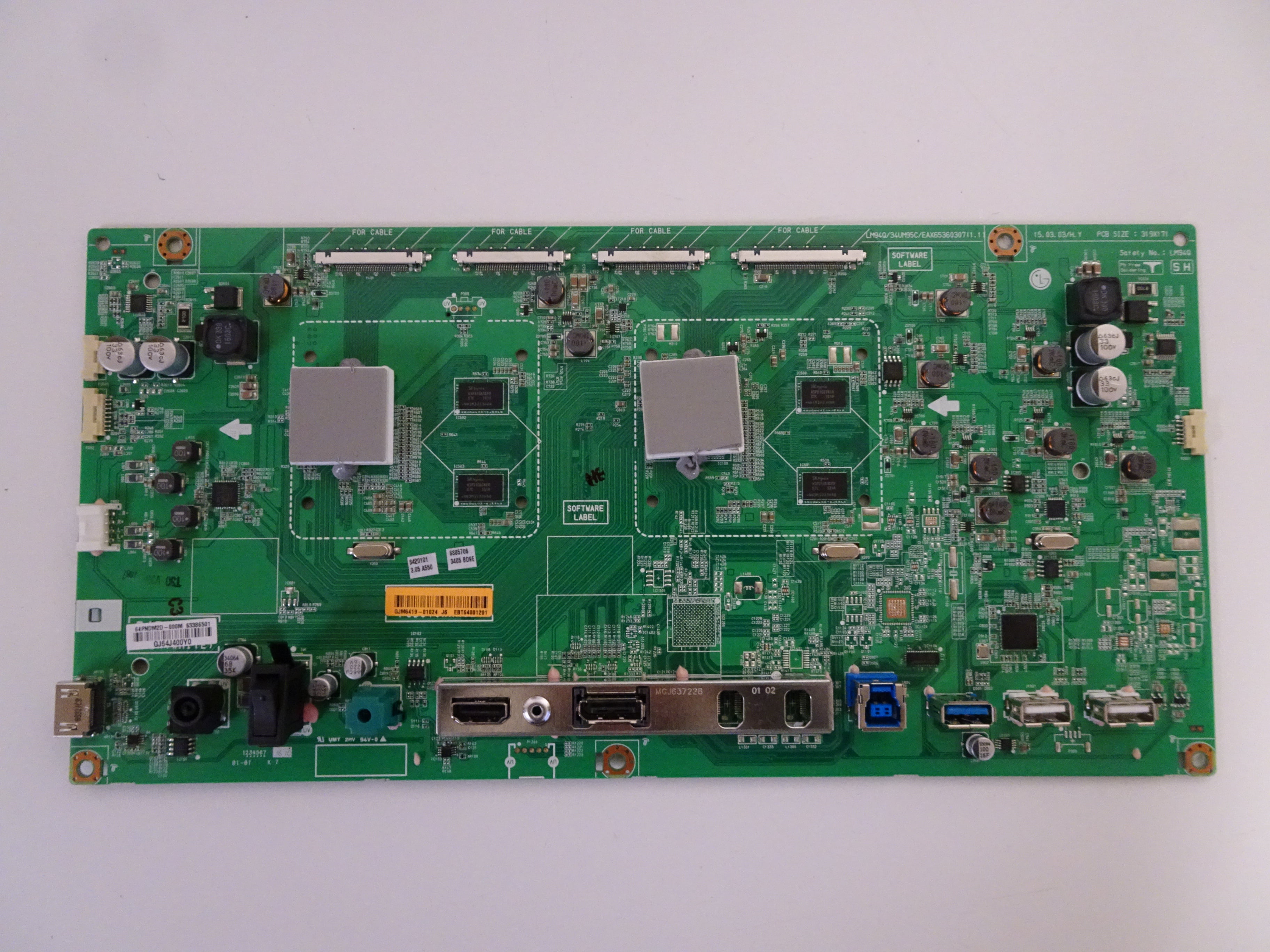

                    Hello guys, I cant start a topic yet so I want to try it here. Maybe someone else needs it as well.
                    I bought a 34UM95-P. With the same EAX65360307. Someone already played around with a repair and they did not fix it. IC102 was shorted on pin 6 and 7. And they knocked of a capacitor CB11/C811.
                    I flashed the bios back and now the screen does give a sign of life. The power led turns on for 10 seconds and turns back off.
                    IC102 was short so I assume that the controller is damaged or the file on it is corrupted. Can someone send me a copy of the rom on that chip? And can someone tell me what the capacitor is on CB11.
                    Thanks in advance!

                      Is not IC 902 actually ? You write IC 102 ? If yes I have the file, I will give you.
                      And for capacitor if is a small ceramic smd I guess you can put any, it will work.

                        Yes its IC 102. I dont know why they touched it when they tried a repair but I am guessing they thought it was the reason the monitor would not turn on.
                        It's the one really close by the green audio jack.

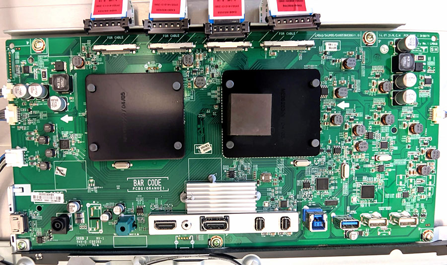

                          Hi there, I'm new to the forum, I'm here to try and fix my 34UM-P.
                          Once in a while it would just "crash" half the screen would go black, 2nd half would show scrambled image. Usually a power cycle would fix the issue, then once it did not..
                          I've tried to find a board to buy/replace, but I don't see any available.
                          I have the LM94Q/34UM95/EAX65360306 (1.0)
                          I didn't know I could try and reflashing the board to fixing the boot up issue.
                          Is there a tutorial somewhere that shows how one can try to flash the chipset with the originally attached bin?
                          This is the board.

                                If you get half screen scrambled You might have to reflow the processor under the radiator that send signals to that part of the screen, this doesn't seems to be a firmware issue.
