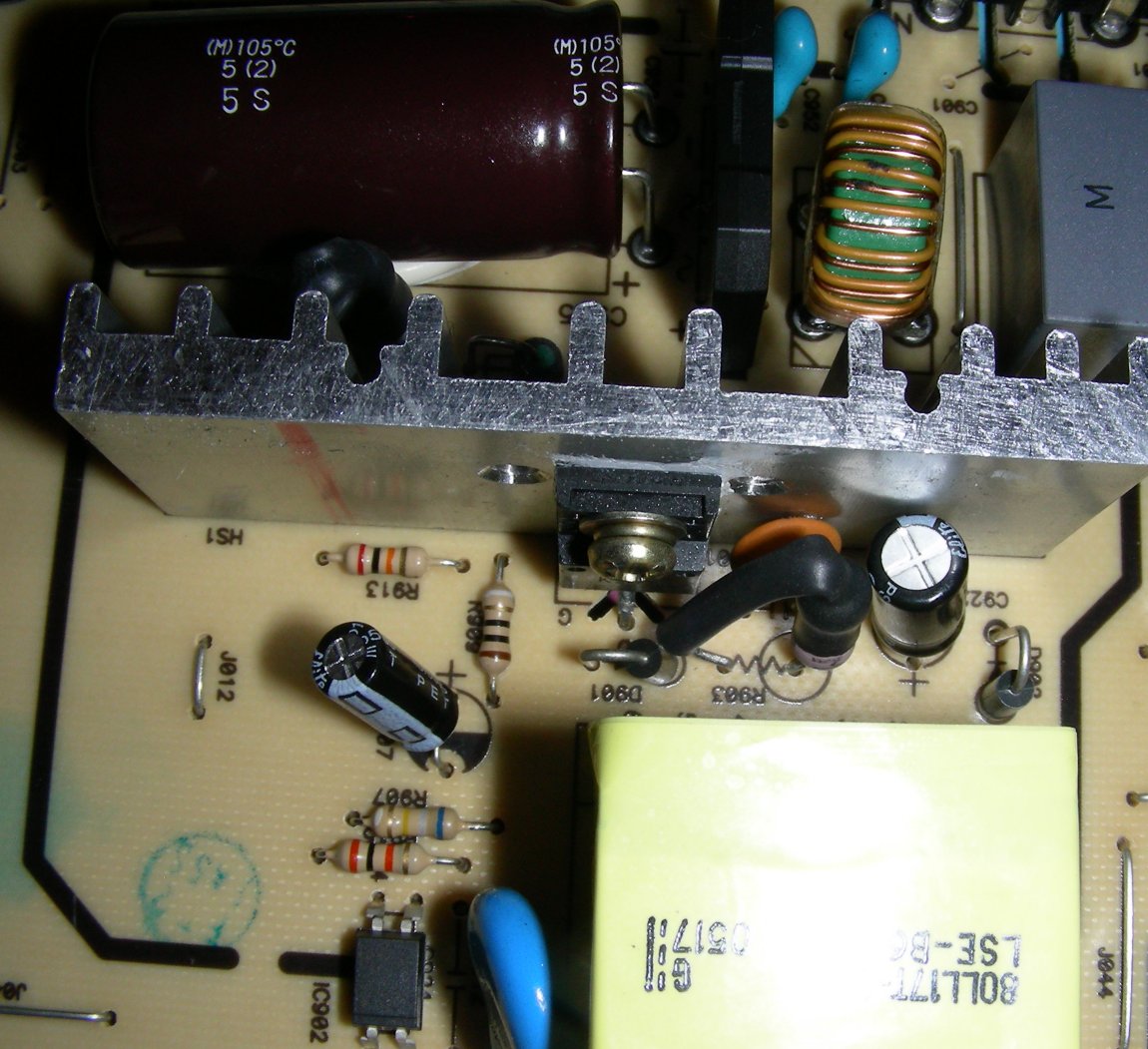

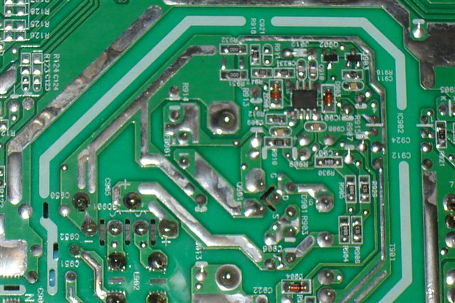

    AOC LM2028 - no voltage
    I repaired one AOC LM2028 - there were problem with display connector - backlight and control OK - but no display.
    When I completed it, monitor stops working.
    There is problem with power supply, I think. There is no voltage at output.
    I checked voltage at big capacitor - there is 320V=.
    At secondary circuit of transformer there is 0V~
    Then I checked voltage at MOSFET(Q901) S-D - there is also 320V.
    It looks like FET is dead.
    Have I to replace PWM controller IC901, too?

    I think you are getting ahead of yourself. Note that the FET won't do anything until the PMW controller starts. What is the part number of the PMW controller? Download the datasheet and make sure it has the proper voltage. Depending on the PWM controller, a bad capacitor can cause this problem. Pictures of both the top and bottom of the power supply will help.

      I replaced this K2996 FET - no change.
      Even worser thing is, that I'm not able to read PWM type number.
      Power board type is PWPC19625FJ1 - no info available.
      I try to ask my friend at AOC authorized service here in Slovakia - to get more info.

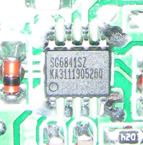

        The PWM controller (SMD in the left) is SG6841
        I try to exchange it, but I have to collect more items for the next order.

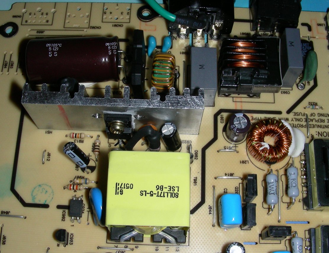

              I have a dead LM2028 here, which seems to show exactly the same symptoms on the power board as you described here, e.g. 0 volts on secondary side of the transformer, 320VDC on the primary side but Q901 seems dead.
              1) Please start by posting pictures and the location of Q901. The pics in dondrusco's posts are a bit small and hard to make out the details.
              2) Post clear focused pictures after reading

                @momaka: Thanks, this forum seems like a gold mine, I'm sure I'll spend hours and hours reading here. Regarding the cap you're talking about, I'm not quite sure which cap you are referring to, maybe the pics I've attached now can help you point it out to me using the board marking, so I can measure it.

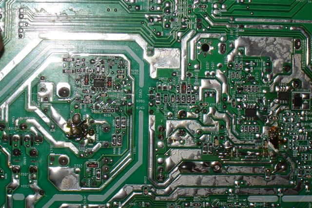

                @retiredcaps: Hi, and thanks for the hints re pics. I've taken some pics now, unfortunately I had to use the flash, light in here is not very optimal to say the least. Q901 is the main switching MOSFET, you can see it marked (text upside down) in the middle of solderside_pwmcircuit.jpg, its Gate, Drain, Source are marked there as well.
                These are pretty sharp close-up pics (sorry for the flash glare though), hope they help.

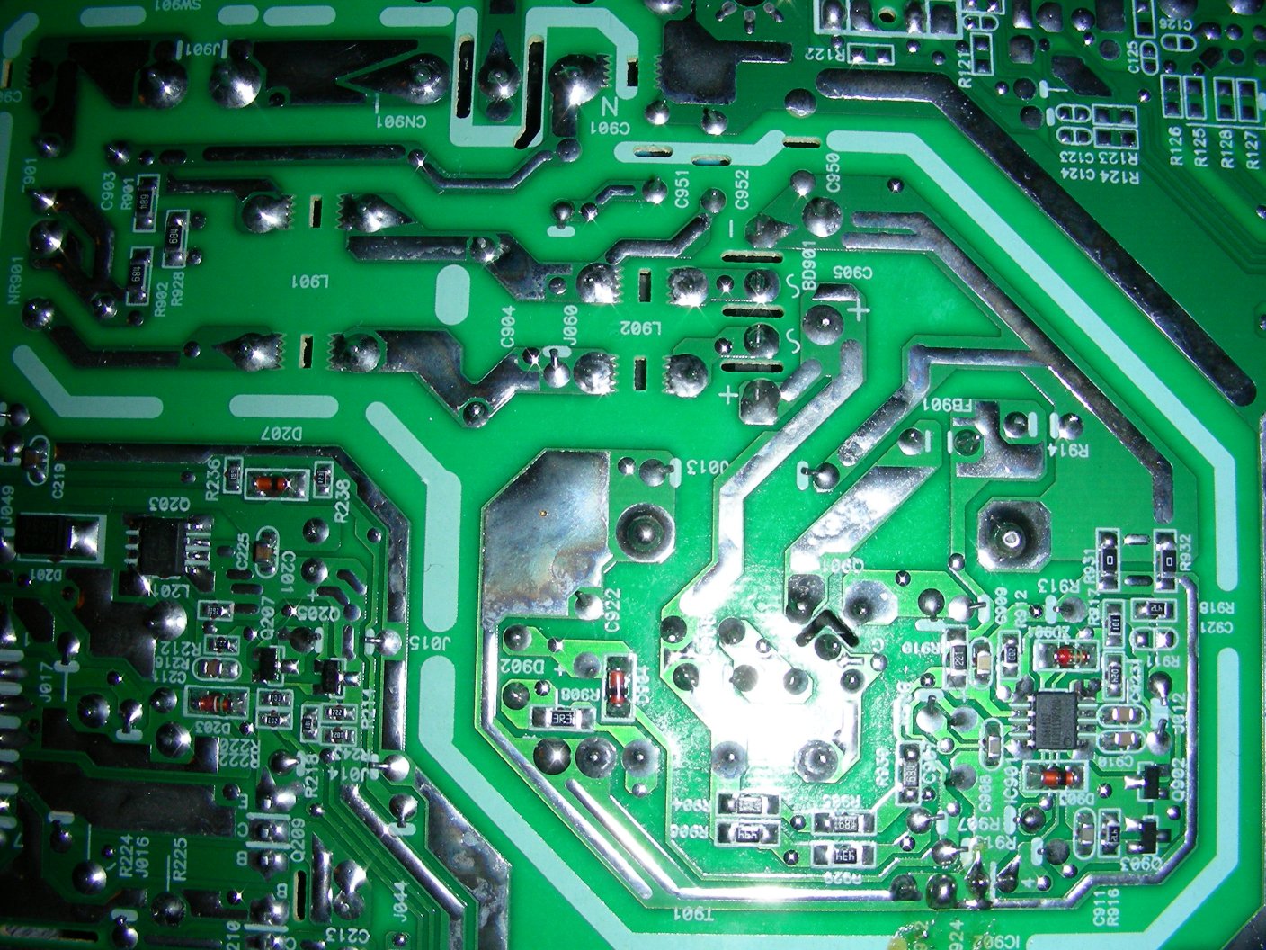

                edit: momaka, could it be C922 (cmpside_hivolt_area.jpg, right above the upper-right corner of the switch transformer) you are referring to?

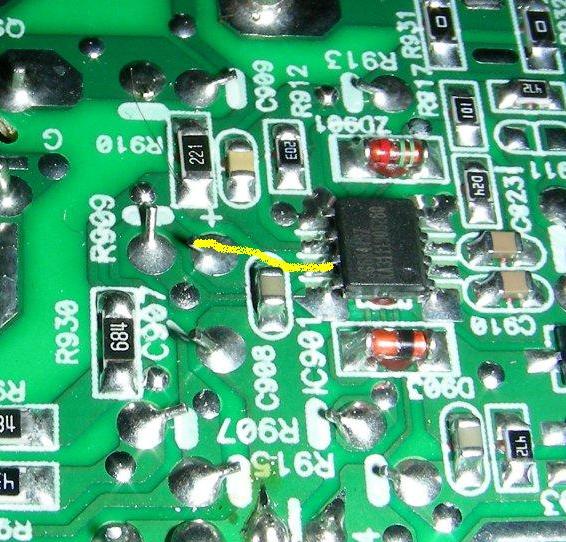

                  It is either C907 or C922.
                  I don't know if it is the lighting or not, but there seems to be a lot of ring cracks on the solder side.

                    From tracing pin 7 of the SMPS controller, it looks like C907 is the one.
                    See yellow line on pic showing pin 7 to C907.
                        I read 11.3 volts between the + side of C907 and negative on primary side. I'm checking out the Daytek F19AH thread, thanks for the pointer!
                          From the datasheet, pin 1 is GND, and pin 7 is VDD. So put your black probe on pin 1 and red on pin 7. What is the voltage measurement?
                          edit: While you are measuring these pins, you might as well measure and report them all. Watch out for pin 3 (VIN) it is mains * 1.4 so be CAREFUL.
                                  Hi, sorry for the delay, my internet went down shortly after I posted my message yesterday and didn't come back until a few hours ago.
                                  Yes the cap I was talking about is C922 indeed. Check the voltage on it.
                                  If you get a voltage, what is it? If you get none, test diode D902 with the diode check on your multimeter.

                                    Didn't have time to get a new cap today because I worked too late, but I did some more probing now, and I think the fluctuations I saw yesterday may have been the fault of my digital multimeter. I turned the voltage selector back and forth a couple of times and then measured again:
                                    Between pin 1 and 7 on the SG6841 controller, I read stable 13.4 volts.
                                    Between + side of C922 and primary -, I read 14.1 volts, also seems stable.
                                    I checked diodes D902 and D904 (right where C922 is, D904 is on solder side), they are both okay according to my diode check function.
