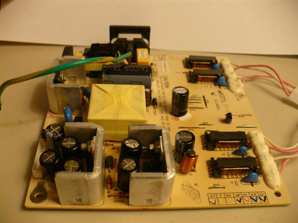

    Greetings,
    I have a Sceptre 22" monitor that I have replaced the Caps on. They were Capxon Good stuff?. Before I attempted to replace them the monitor would not turn on. The led would blink off and on.
    Now I have replaced them and the monitor turned on bright. After 5 minutes it turned off. I then turn it back on and after 5-10 minutes it shuts off. I have lowered the brightness which did not help. I checked both the VGA and DVI connections and they work.
    Before I gave up I thought I would give you guys a shot at my problem. I am leaning to the Transistors or the MOSFET's. Do any of you have a solution? I have attached Photos.
    Any help appreciated

    What brand and series of caps did you use as replacements? Does the LED stay on or turn off when the monitor 'shuts off'? Is there anything showing the function of the pins in the upper left corner of the picture of the top?

            I know that. Is there any indication of the function of the individual pins? Something like GND, 5V, BL_ON, etc? I'm trying to establish if the power supply is shutting down or if the logic board thinks it's not getting any signal.
            When you say 'Turn off, then on', do you mean the by On / Off button on the front of the monitor, or are you turning the AC power off, then on?
            Nichicon is a good brand, but they make different series of caps, depending on the application. What series?
            What is the history of the monitor? Is this something that you have been using for a couple of years before it failed, or did you find it in a dumpster last week?
            And a reverse angle view of the power supply / inverter board would be nice, as well as an overall shot of the entire inside of the monitor.

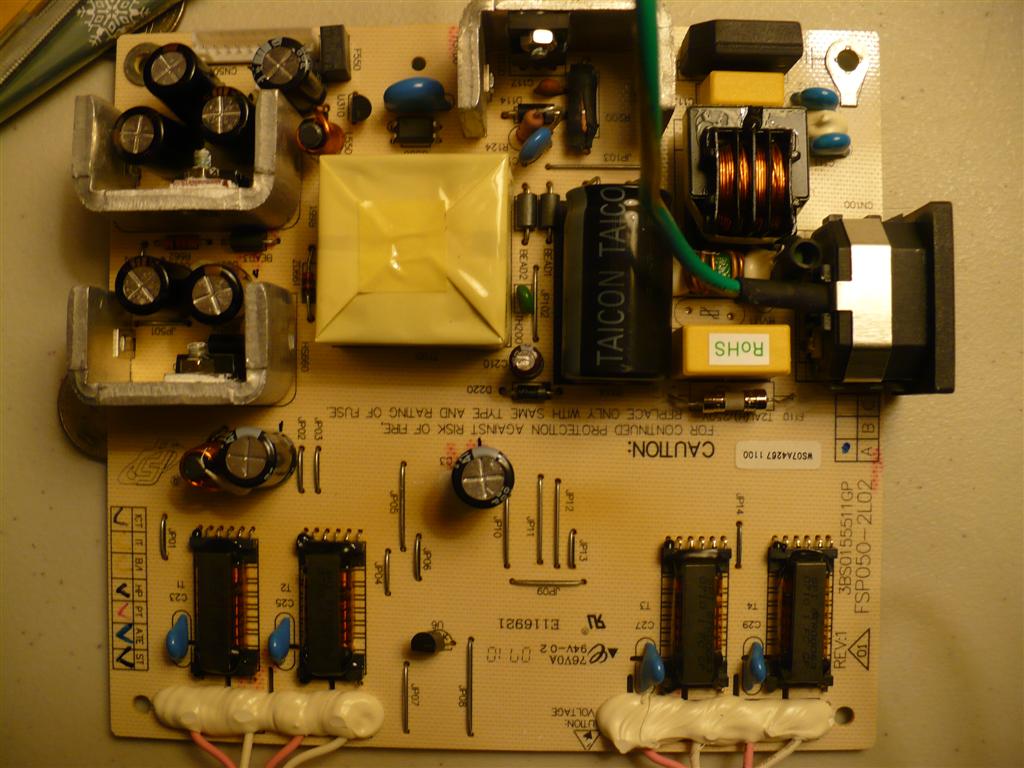

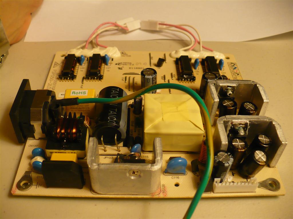

              Sorry, I'll get the Specs on the pins. I used the monitor for about 2 years then it just went black. I stumbled across this forum and thought I would give it a try. I will get pictures and post them. Thank you for our help.
              • Logos077
                • Nov 2009
                • 13
                Re: Sceptre X22 WG Gamer With Replaced Caps Turns off after 5-10 minutes
                I cannot find the indications of the functions on the connector Pin at the top of the Board.
                I turn off the monitor using the buttons on the front of the monitor.
                I used nichicon Caps series B8035 and MERITEK no series numbers.
                I took some more pictures of all sides of the board.
                Thank you again.

                  Shoot!!! It looks like this is what I call a 'top loader' design. The housing for the electronics is attached to the back of the case. The power supply / inverter and what appears to be the audio amplifier are mounted into the housing, then the LCD panel goes on top of that. And this is one of those where the logic board is integrated into the panel electronics. I suspect there is no way to check the output of the power supply with the LCD panel in place.
                  There are two possibilities:
                  1. The rebuilt power supply is working perfectly, but something is wrong with the logic card / panel electronics. If that is true, the monitor cannot be economically repaired.
                  2. The replacement caps have too high an ESR, allowing electronic 'noise' to get into the panel electronics. That is your last hope.
                  B8035 is not a Nichicon series; it's probably a production date or lot number. The Meritek web site is not encouraging ("New Web Site Launch Soon"). Where did you buy the capacitors? Do you have part numbers from either the vendor or the manufacturer?
                  And one more question that was never answered. When the monitor shuts down after 5 minutes, what do you have to do to get it turned on? Do you press the power button on the side of the monitor, or do you have to unplug it (or otherwise turn off the power) to get it to restart?

                    I purchased the Caps at a local electronic shop not Radio Shack. I did use some caps rated at 470uf 35v, Rather than the 470uf 25v. The tech at the shop said it would not be a problem.
                    To turn the monitor back on I push the Power button.

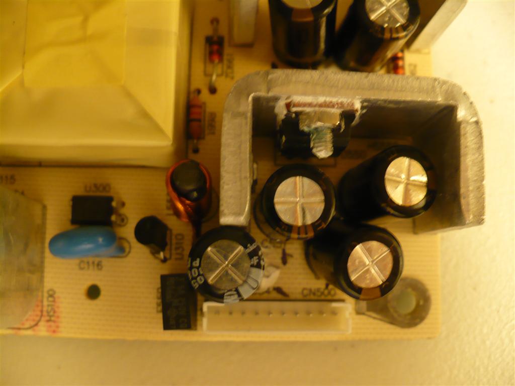

                        That's the story. VZ is a general purpose Nichicon cap, not designed for use in switching mode power supplies. They are so far from having the desired qualities they aren't even on the good caps list.
                        A quick (and not particularly expensive if you are in the US) fix is to make up a list of the original caps. Make sure you know the maximum height and diameter you use for each cap. It is NOT necessary to replace the large cap, particularly if you have already replaced it.
                        This post has a step by step process for identifying suitable replacements. I prefer Panasonic FM or FC series, but other vendors (including Nichicon) also have excellent low ESR caps. If you are outside the US the 'Frequently Asked Questions' section has suggestions for reputable vendors. From Digikey the cost for a complete set of replacements would be under $10, including shipping by First Class mail.
                        NOW for a warning. I can't promise this will work. The monitor may have other problems. But in my opinion it's your best chance of getting it working again. If someone else disagrees with me (in particular Wizard or PC BONEZ), listen to them.

                            Good News!!
                            The I ordered Low ESR Caps from Digikey, Panasonic Fm series. These new Caps proved to be the difference. The monitor works again. Thank you for all of your help.
